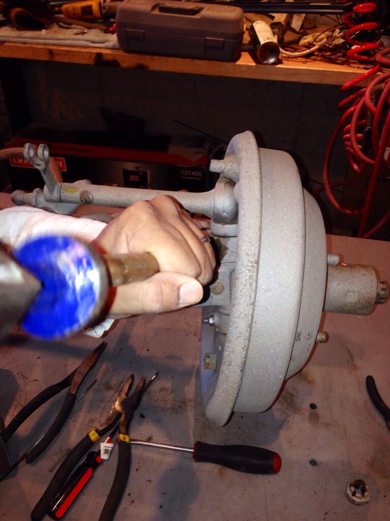

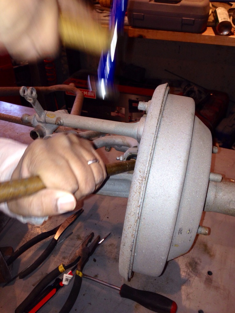

  4. pennafxu
    Joined: Aug 20, 2010
    Posts: 2,263
    pennafxu
    from Kentucky
    Knocking out the steering linkage...

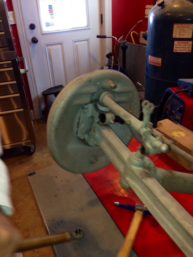

  5. pennafxu
    Posts: 2,263
    pennafxu
    from Kentucky
    ImageUploadedByH.A.M.B.1392491734.427641.jpg ImageUploadedByH.A.M.B.1392491750.315057.jpg ImageUploadedByH.A.M.B.1392491768.781746.jpg
    Almost out...

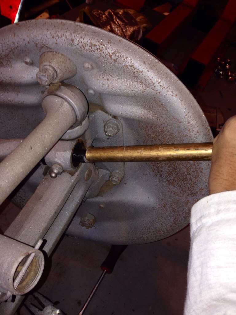

  6. pennafxu
    Posts: 2,263
    pennafxu
    from Kentucky
    And out she comes...

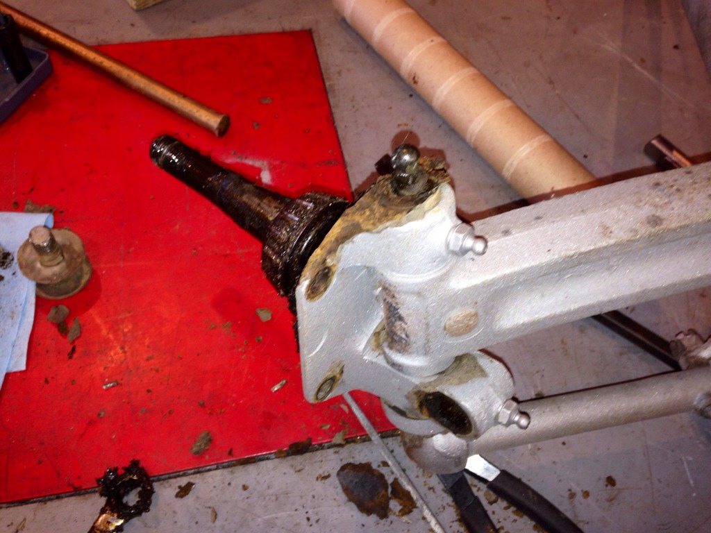

  9. pennafxu
    Posts: 2,263
    pennafxu
    from Kentucky
    ImageUploadedByH.A.M.B.1392492191.568890.jpg ImageUploadedByH.A.M.B.1392492201.361283.jpg
    Removing the mechanicals...

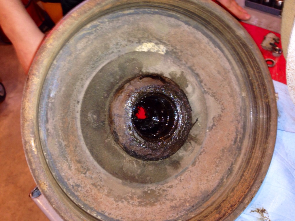

    Other drum removed.
  16. pennafxu
    Posts: 2,263
    pennafxu
    from Kentucky
    Stack of greasy old parts. Yuck! Better than a stack of rusty parts tho... :)

    So I tried loosening the bolts that hold the perches in place... No dice after overnight with PB Blaster. Time to pull out the oxyacetylene torch!
  20. when pulling my front end apart I used oxyacetylene to heat the nut a power bar and a piece of 2 foot long 1-1/2 pipe to get enough leverage to crack the nuts loose, after that I used the rattle gun.
  21. pennafxu
    Posts: 2,263
    pennafxu
    from Kentucky
    I think this is where I will end up. Cherry red?
  22. Cherry red or there about.

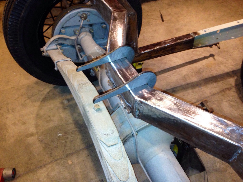

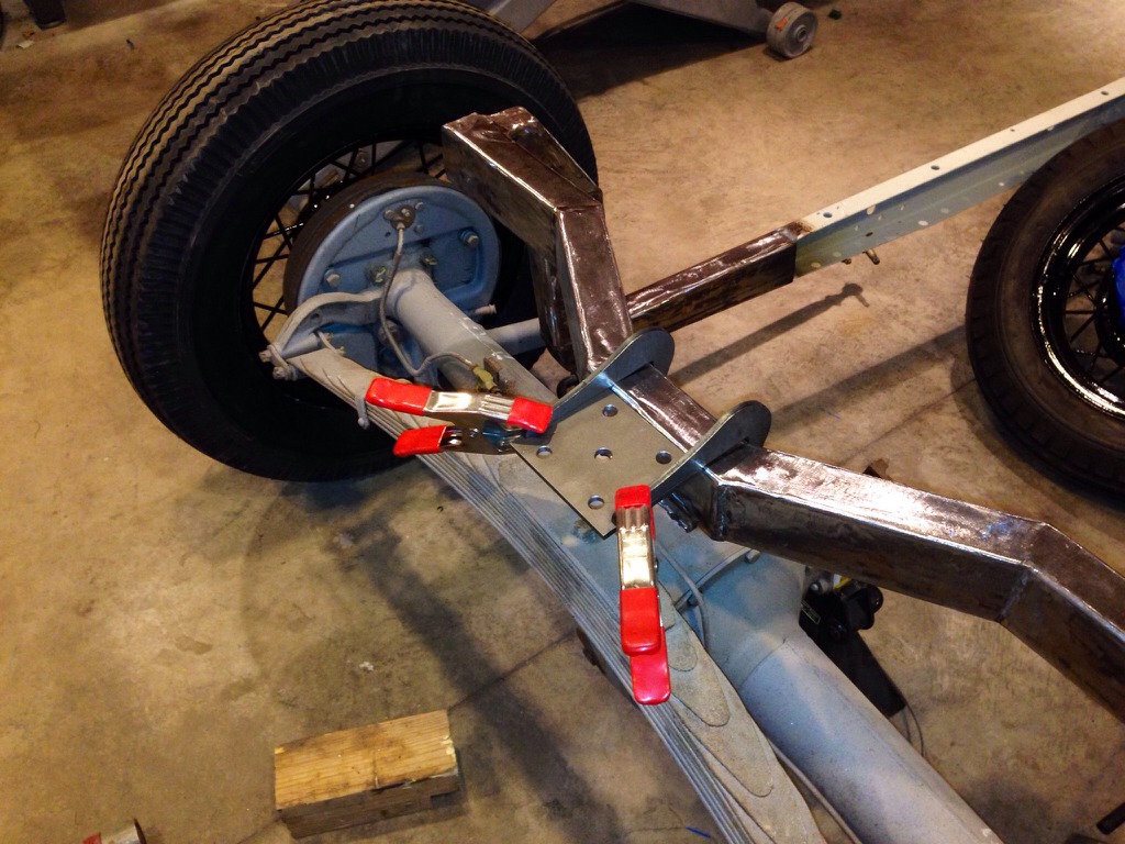

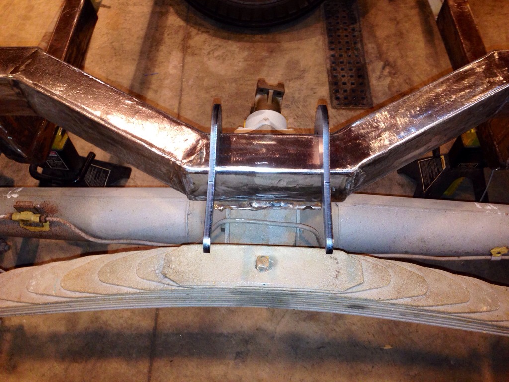

    Rear suspension bracket... ImageUploadedByH.A.M.B.1392860336.202299.jpg ImageUploadedByH.A.M.B.1392860344.273965.jpg ImageUploadedByH.A.M.B.1392860363.017711.jpg
  24. pennafxu
    Posts: 2,263
    pennafxu
    from Kentucky
    ImageUploadedByH.A.M.B.1392860397.498361.jpg ImageUploadedByH.A.M.B.1392860405.508501.jpg ImageUploadedByH.A.M.B.1392860415.012147.jpg ImageUploadedByH.A.M.B.1392860424.085013.jpg
    Need to really beef up this bracket... With gussets, fish plates and the like...
  25. pennafxu
    Posts: 2,263
    pennafxu
    from Kentucky
    Would u set pinion angle with this bracket? Or weld it straight, and use the ladder bars to set pinion angle... After seeing where the driveline angle ends up?
  26. Outback
    Joined: Mar 4, 2005
    Posts: 3,624
    Outback
    from NE Vic, Oz
    Not really sure, but my thinking says that the fewer parts that bind the better, the spring and bushes/shackles will cope with some miss alignment however it'd be better in my opinion to set the pinion angle first then get the spring Mount dialed in.... my 2c

  28. pennafxu
    Posts: 2,263
    pennafxu
    from Kentucky
    Ok, but I am ditching bones for ladder bars as bones aren't even close for correct pinion angle... I mean I will need a 12" bracket! Unless they are adjustable? Would u go with 3 deg bracket as a starting point? Or drop in flatty with intake level and work backward, with pinion angle shared between bracket and ladder bar, or ladder bar or bracket individually?
