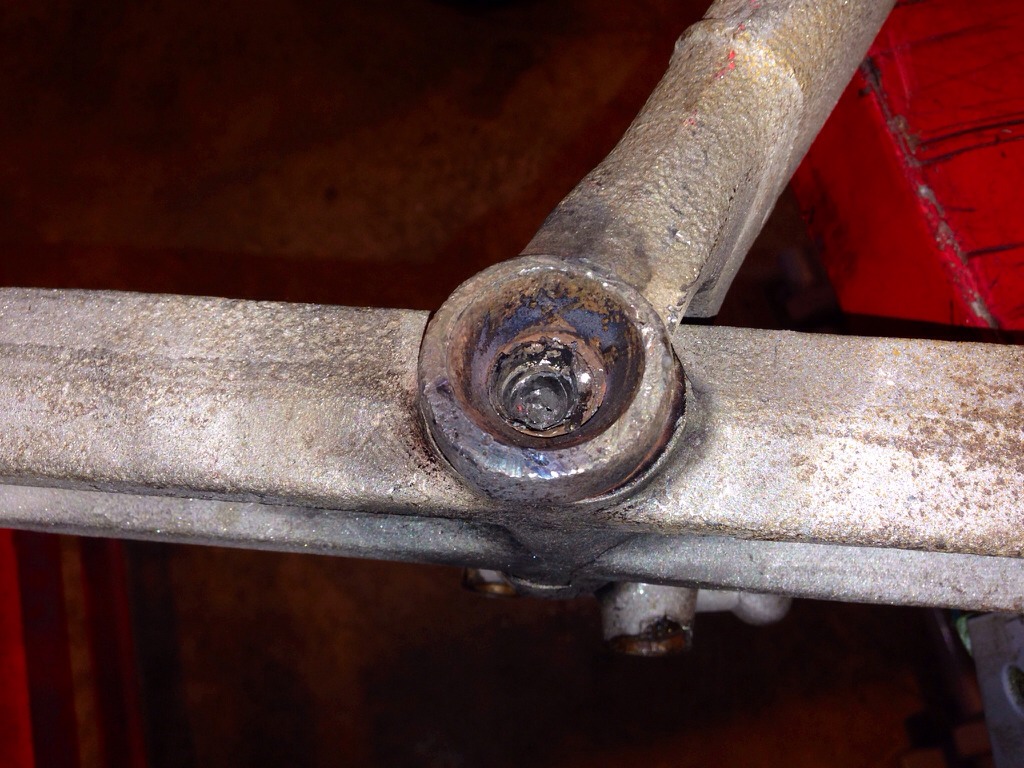

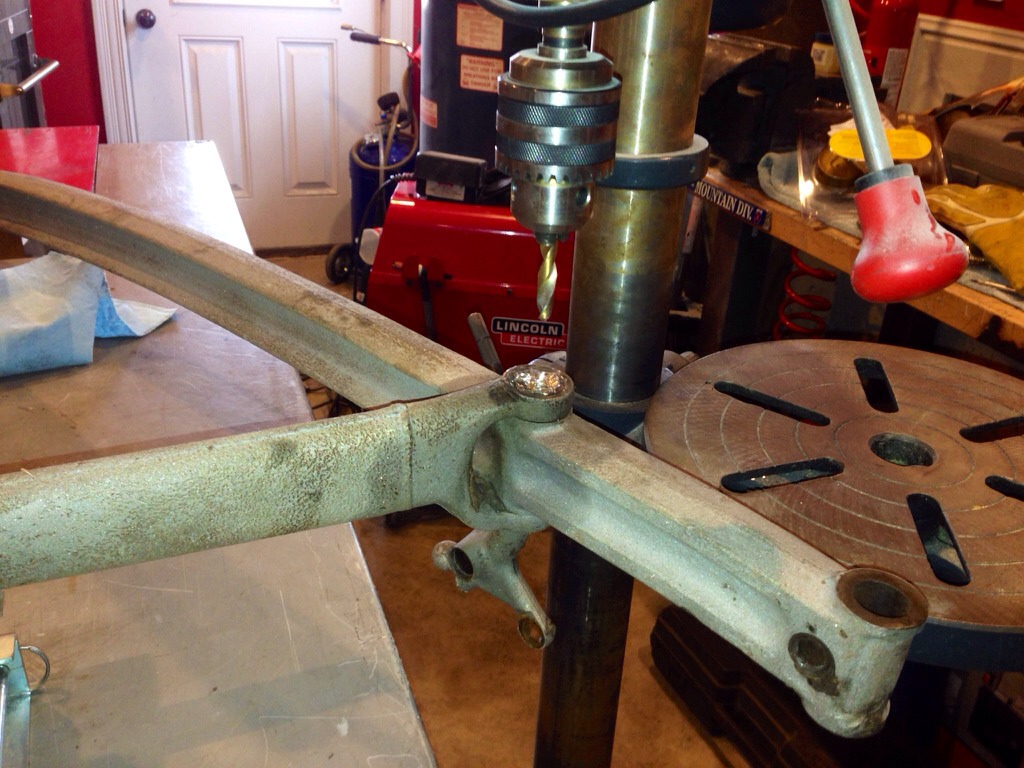

    But still no purchase on the real issue... ImageUploadedByH.A.M.B.1393584539.911728.jpg

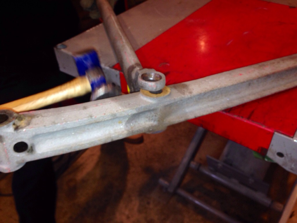

    Well a little more progress... ImageUploadedByH.A.M.B.1393703988.733137.jpg ImageUploadedByH.A.M.B.1393704005.922127.jpg ImageUploadedByH.A.M.B.1393704031.945473.jpg
    This has turned into a nightmare scenario... Time to ream the bolt out...

    Air chiseled what was left and hey Presto the bolt finally came loose

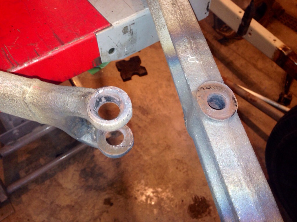

    Used the press to knock out this...
    And ended up with this...
    ImageUploadedByH.A.M.B.1393704230.431568.jpg ImageUploadedByH.A.M.B.1393704242.380425.jpg

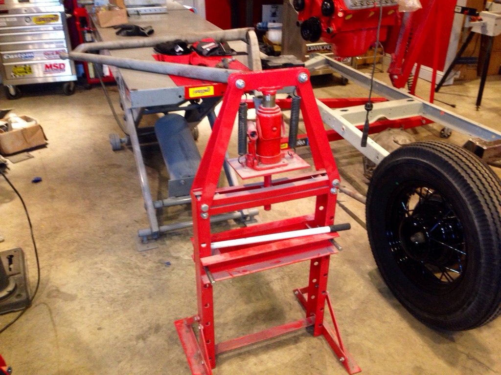

    from Kentucky
    Went to press the other side and realized the force of the last attempt actually broke my press 12 ton press :(

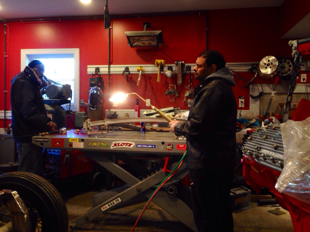

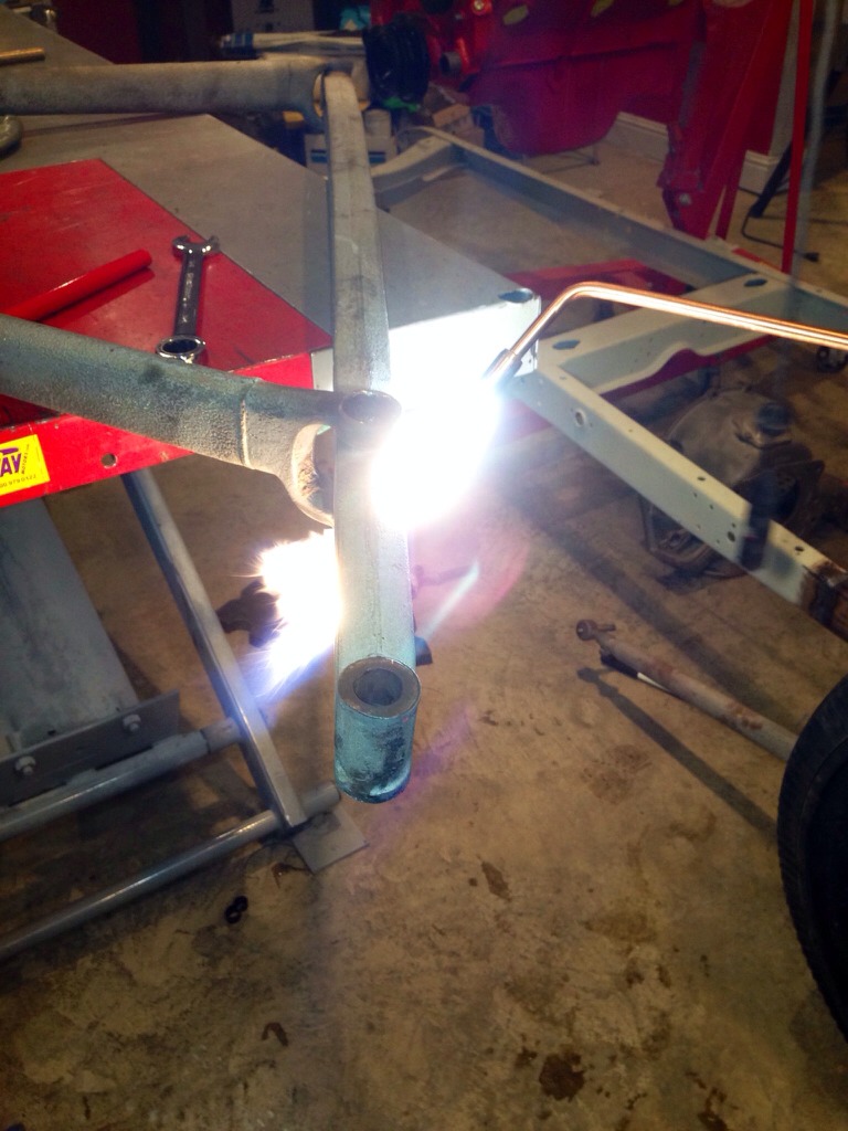

    Got a new hat!
    Then fired up the torch... With a #4 rosebud tip... ImageUploadedByH.A.M.B.1393870735.596755.jpg ImageUploadedByH.A.M.B.1393870745.495937.jpg ImageUploadedByH.A.M.B.1393870760.660195.jpg ImageUploadedByH.A.M.B.1393870773.379914.jpg

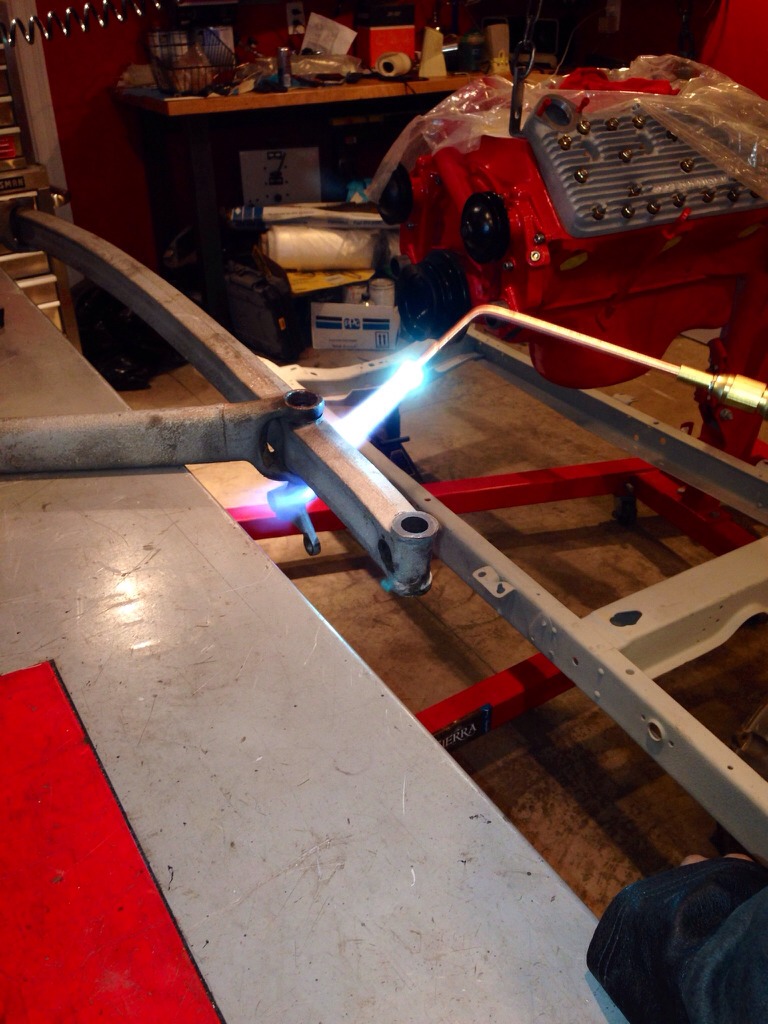

    Some cherry red...
    And air hammer...

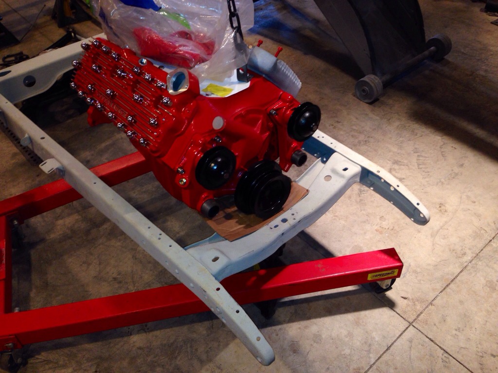

    Test fitting engine... ImageUploadedByH.A.M.B.1393871227.550040.jpg ImageUploadedByH.A.M.B.1393871239.530731.jpg
    Sitting at frame height...
