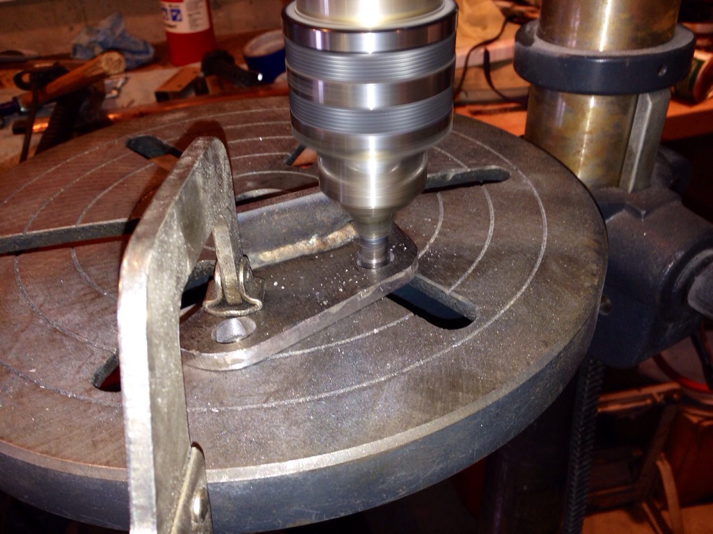

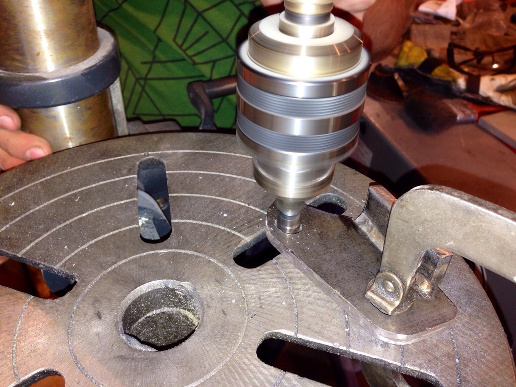

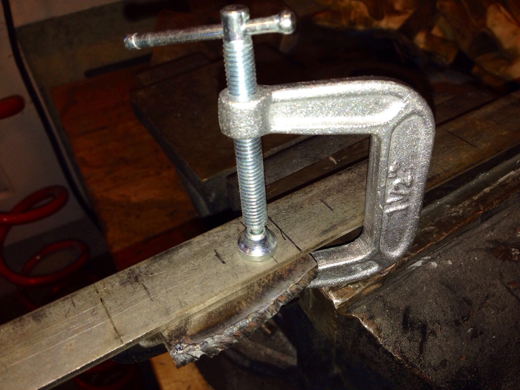

    On with the mounts... Found 2 fender struts from an old chopper build 3/8" thick steel. ImageUploadedByH.A.M.B.1394234874.549708.jpg ImageUploadedByH.A.M.B.1394234885.183516.jpg ImageUploadedByH.A.M.B.1394234893.777004.jpg ImageUploadedByH.A.M.B.1394234902.801027.jpg ImageUploadedByH.A.M.B.1394234915.783780.jpg

    ImageUploadedByH.A.M.B.1394234959.642501.jpg After some grinding

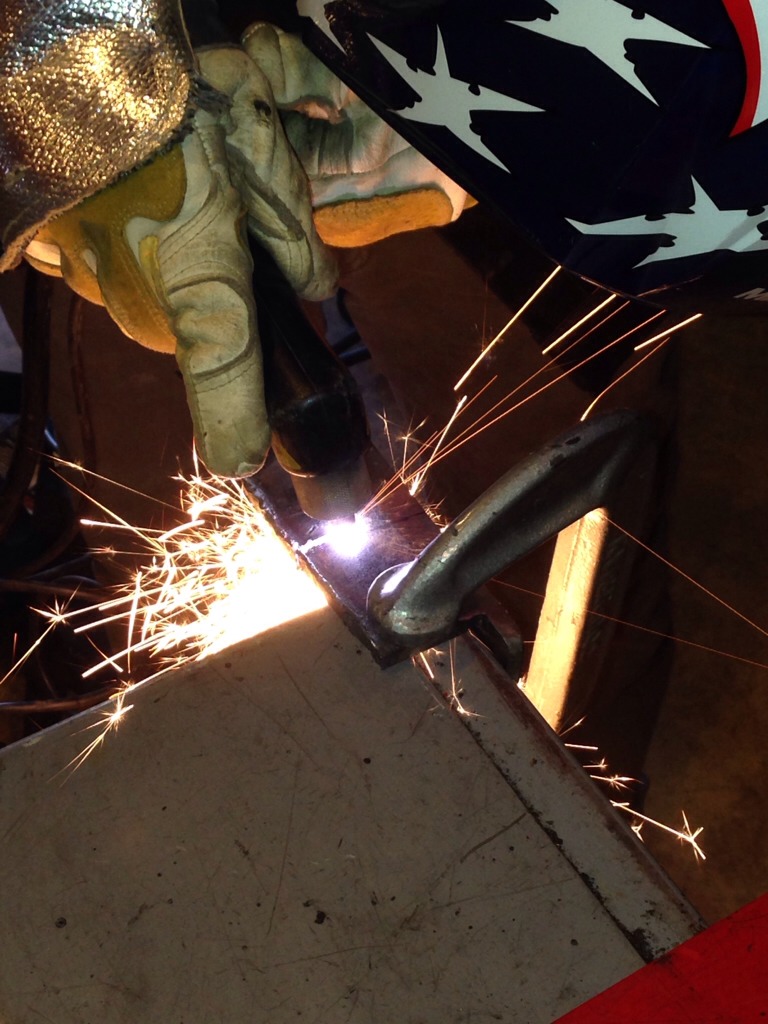

    More plasma work...

    ImageUploadedByH.A.M.B.1394235029.932060.jpg some drilling... ImageUploadedByH.A.M.B.1394235046.224988.jpg

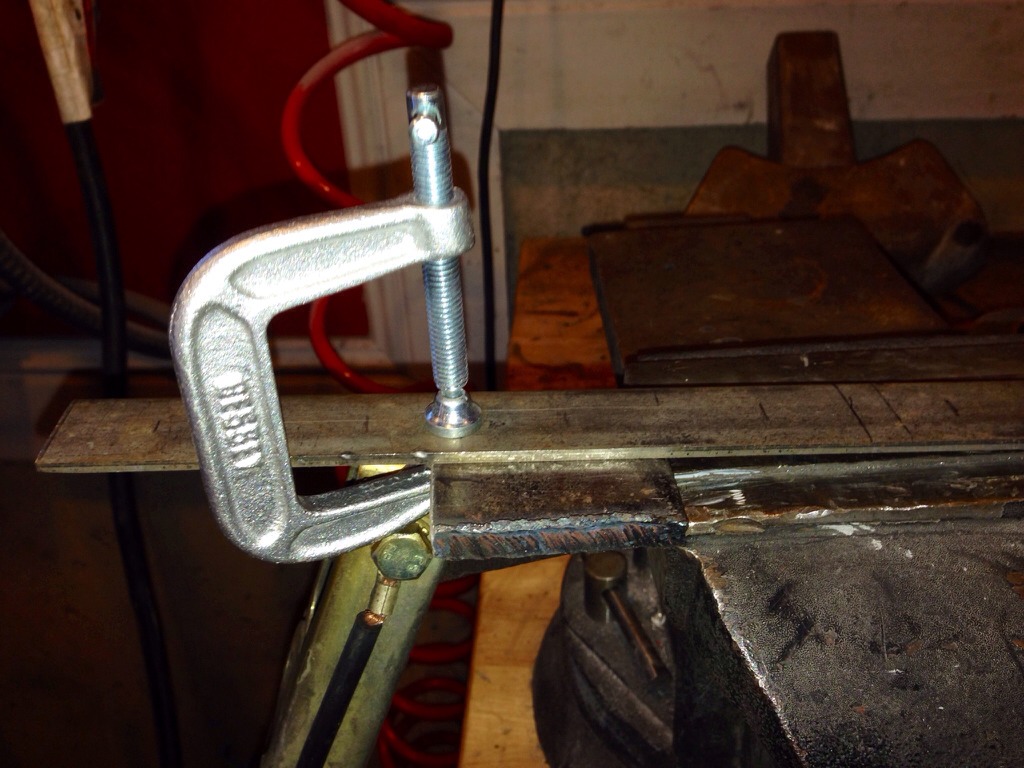

    After 30-40 mins of grinding, belt sanding and rolloc disks...

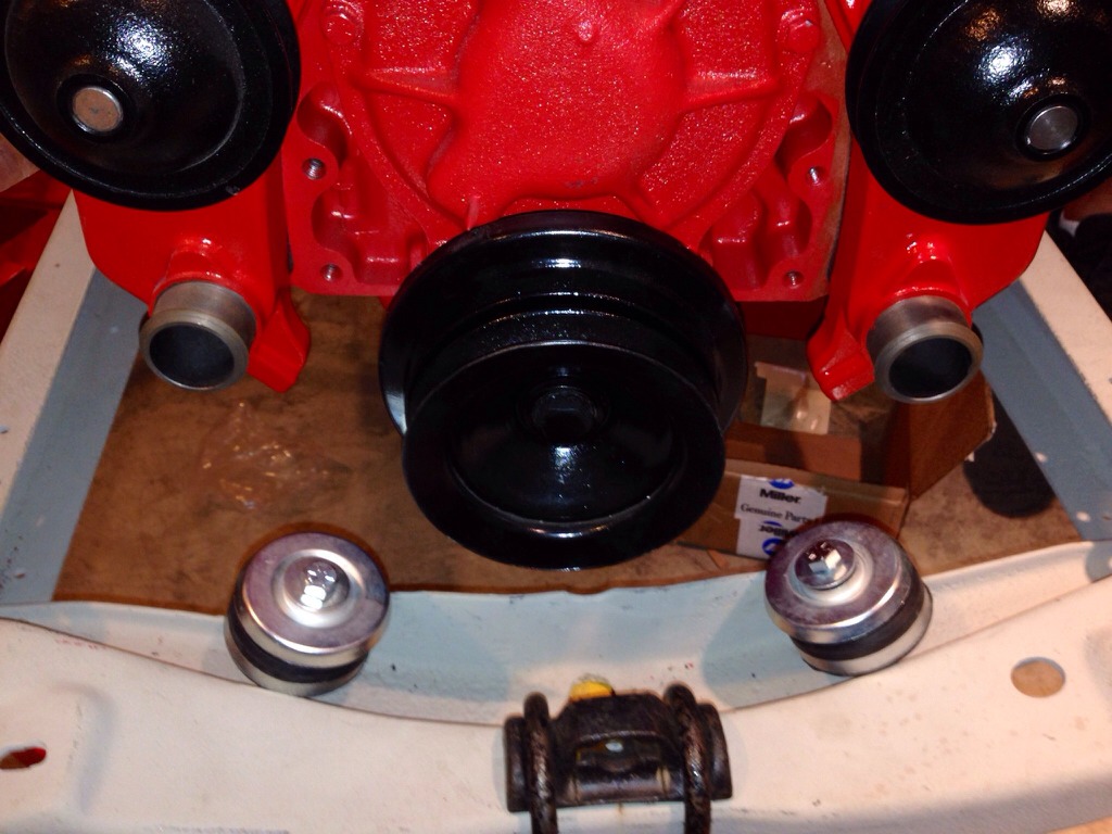

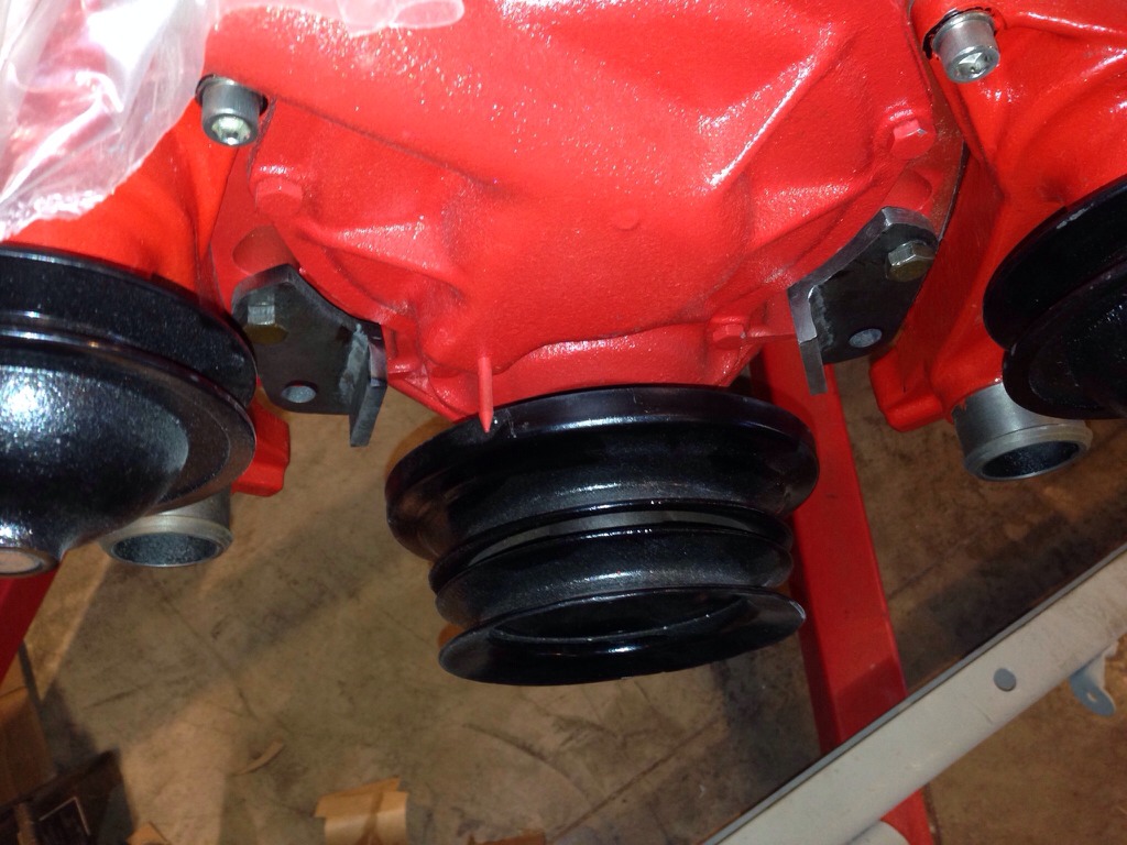

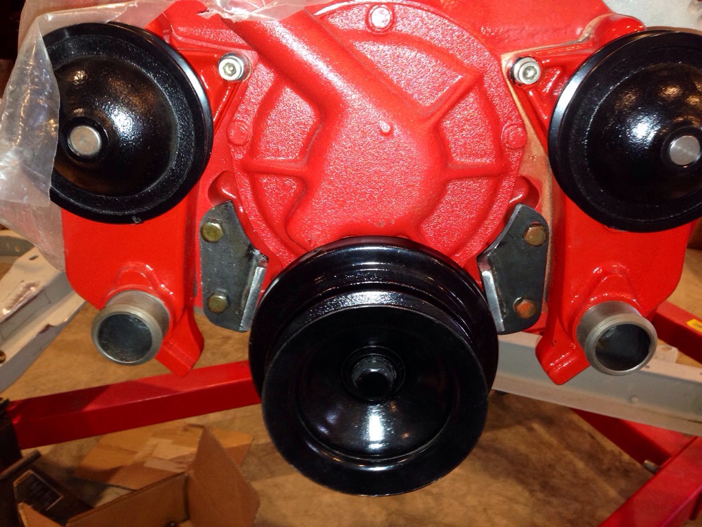

    Finished bolting up the motor mounts (part 1) ImageUploadedByH.A.M.B.1394310495.425330.jpg
    But really need my transmission to go any further setting up the pinion angle etc... More to follow on that.

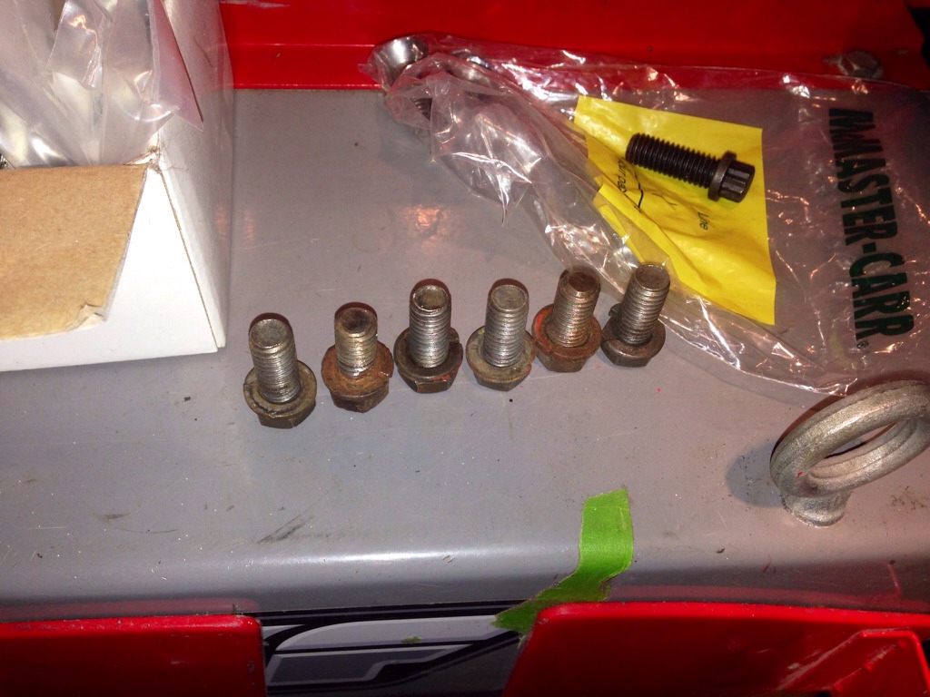

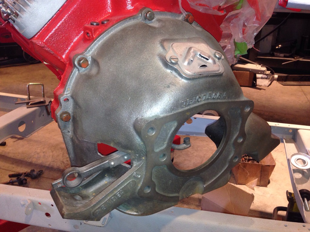

    In the meantime I cleaned up the bellhousing with scotchbrite green pads...
    ImageUploadedByH.A.M.B.1394310725.879984.jpg the bolts...
    And attached... ImageUploadedByH.A.M.B.1394310748.653202.jpg ImageUploadedByH.A.M.B.1394310758.287318.jpg

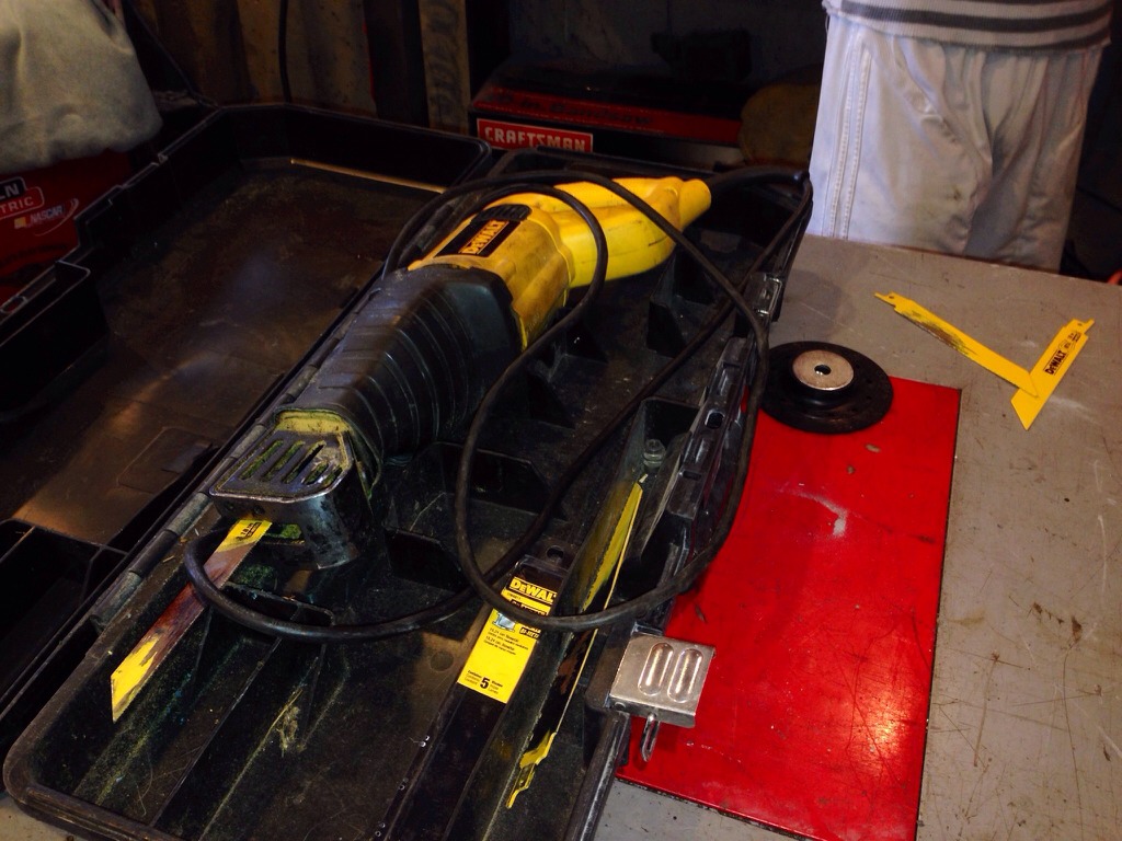

    Weapons of choice...

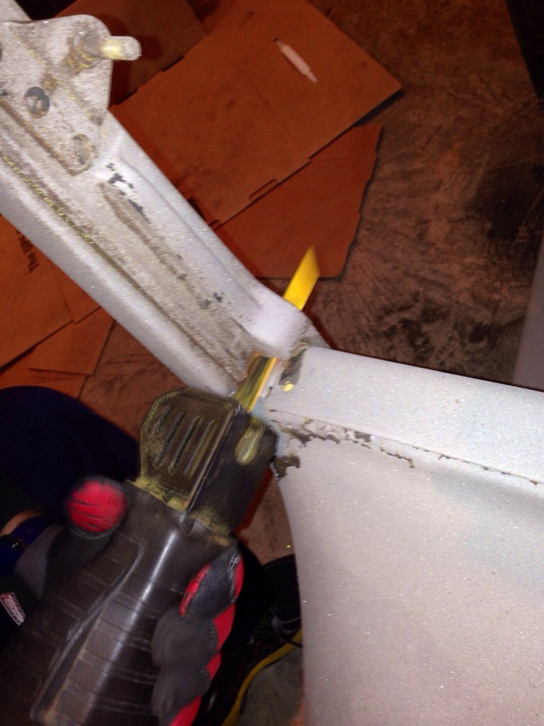

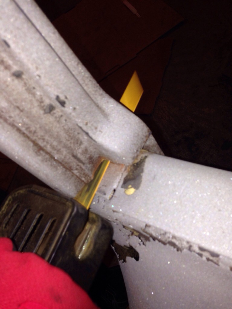

    Started at the drivers A pillar...

    ImageUploadedByH.A.M.B.1394311105.014528.jpg on to the B pillar...

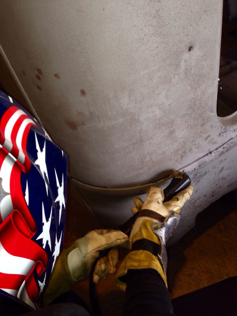

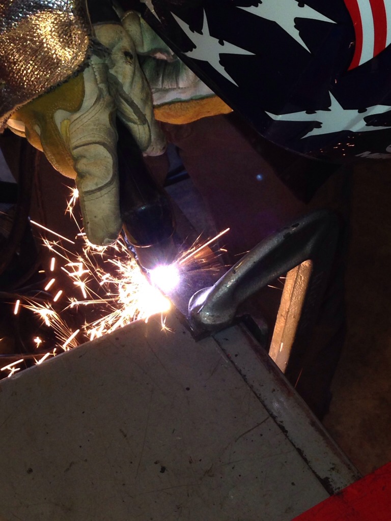

    ImageUploadedByH.A.M.B.1394311175.081178.jpg switched to the plasma cutter... And then went back and forth between the PC and reciprocating saw... ImageUploadedByH.A.M.B.1394311210.739487.jpg ImageUploadedByH.A.M.B.1394311225.154273.jpg

    Off she came...

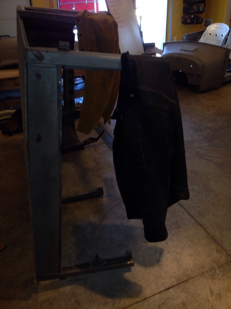

    The body will have the tail grafted on along with the fenders... Lot more fabbing to come... I can't believe how rusty this body is/was and how much work it still needs!

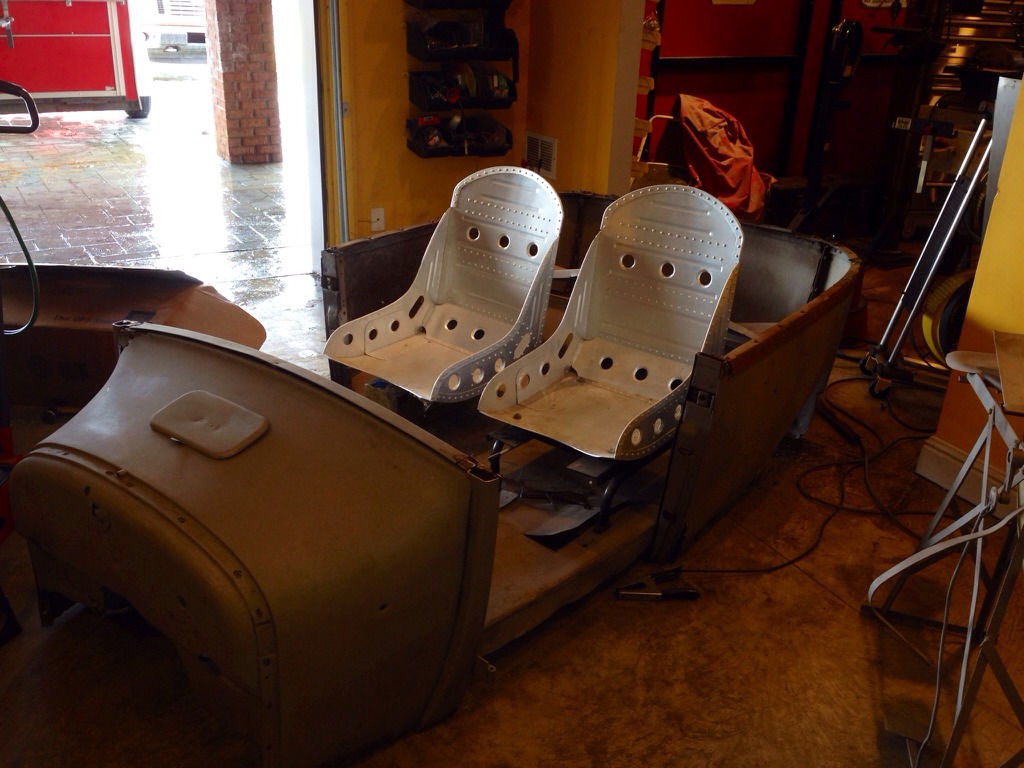

    Got in the seat for a little "cruise"

    ImageUploadedByH.A.M.B.1394311712.736515.jpg in the interim the top of the body is being used a coat hanger... Lol
