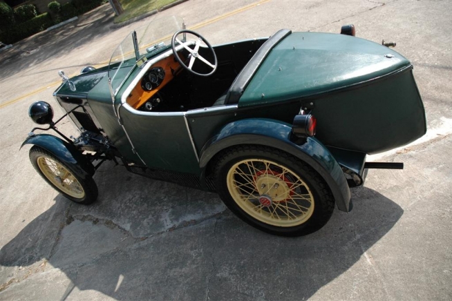

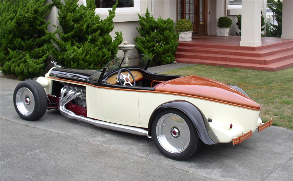

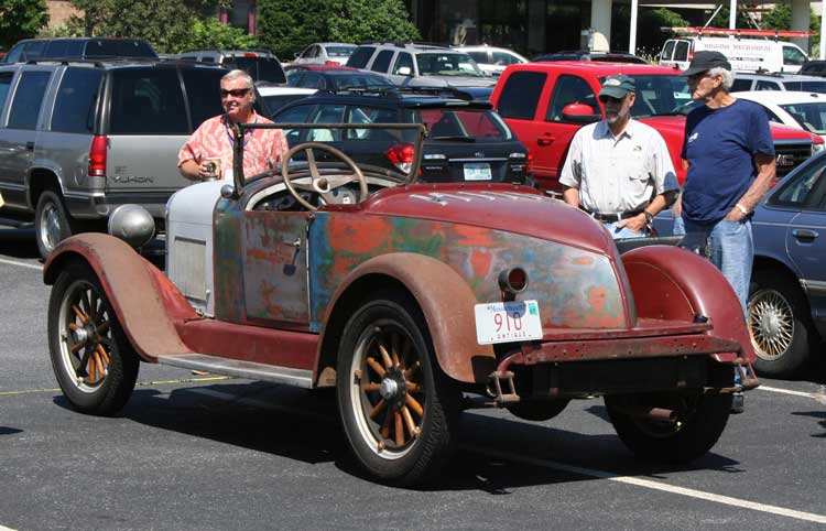

  8. harley jim
    Joined: Mar 12, 2012
    Posts: 591
    harley jim
    I agree, for a boattail you need the longer wheelbase the rear end was way too close in your mock up pics. other boattails have a longer wheel base. The rear fender situation goes both ways.
  9. pennafxu
    Joined: Aug 20, 2010
    Posts: 2,263
    pennafxu
    from Kentucky
    Thanks for the reply HJ... So wheelbase seems bout right? Also started on the body work on the body dolly.

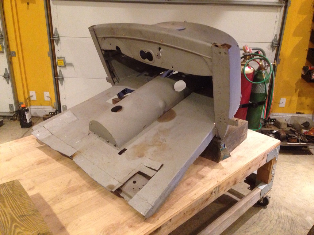

    Body on the dolly...

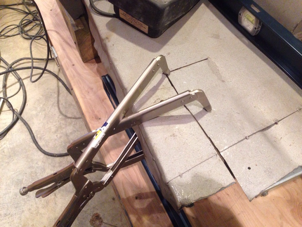

    ImageUploadedByH.A.M.B.1395791344.714353.jpg hammer and dollied as I went, and cleaned the weld just a little... Not too much grinding needed here as this will be covered.

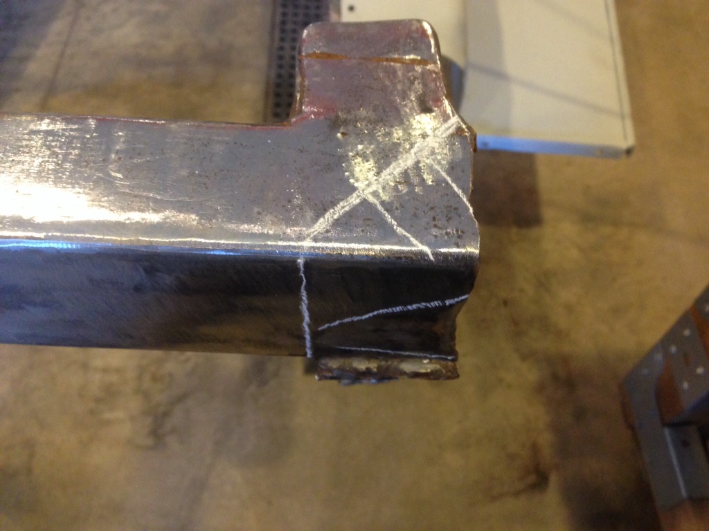

  18. pennafxu
    Posts: 2,263
    pennafxu
    from Kentucky
    Modified frame a touch today... ImageUploadedByH.A.M.B.1395884082.295194.jpg ImageUploadedByH.A.M.B.1395884128.275164.jpg ImageUploadedByH.A.M.B.1395884144.929152.jpg
    Marked off angles with a metal pencil and gage
  19. pennafxu
    Posts: 2,263
    pennafxu
    from Kentucky
    ImageUploadedByH.A.M.B.1395885626.854993.jpg ImageUploadedByH.A.M.B.1395885638.723272.jpg ImageUploadedByH.A.M.B.1395885649.223439.jpg ImageUploadedByH.A.M.B.1395885660.546324.jpg
    I will extend this section with 3x3 3/16" tubing for the 121" wheelbase

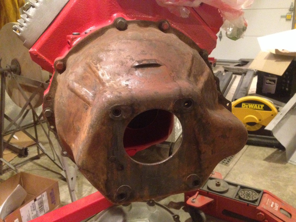

    pennafxu
    from Kentucky
    My new to me bell housing came in today... Slapped it on real quick, but will get it blasted prior to paint. Seems no where near as stout as the truck bh!

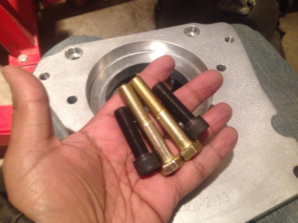

  23. pennafxu
    Posts: 2,263
    pennafxu
    from Kentucky
    Just a minor hiccup...MDL sent co**** bolts and this bh takes fine bolts...?? This is weird as the truck bh took co**** bolts... Either way off to McMaster Carr... ImageUploadedByH.A.M.B.1395886408.839641.jpg

  25. mink
    Joined: Oct 4, 2007
    Posts: 1,331
    mink
    from CT
    If I could suggest a tip to you, it would be to consider switching to a smaller diam filler rod. I use .030 mig wire with sheet metal . This change would help reduce any current panel warpage. Less current need to melt smaller wire compared to larger,from the looks of it it seems your grinding a good amount of your bead off on those floor panels.
  26. pennafxu
    Posts: 2,263
    pennafxu
    from Kentucky
    Nice pick up... I got lazy and welded with the 3/32 tungsten! The only sharp one in the bin! I spent a good hour dressing various diameter tungsten today to ameliorate that... Plus that gap was 3-4 mil and at 35 amps I was on the edge with high freq to prevent blow through vs dipping at an un fathomable rate with the thin stuff as u astutely pointed out. I also cannot find my copper heat sink. I just started tacking at first, but just kept going, corrected with h and d, finished and dressed the weld (which in this case non-structural can essentially be ground flush as penetration is not an issue, compared to looks...) In hindsight complete overkill as I am just patching and bracing in anticipation of replacement... I think the po used steel from lowes! Which was a tuff weld also, seemed kinda high in zinc or something from the colors I was getting, along with arc instability! Purdier welds ahead I promise and thanks for keeping me honest (read no more laziness :))
  27. pennafxu
    Posts: 2,263
    pennafxu
    from Kentucky
    ImageUploadedByH.A.M.B.1395944523.180463.jpg ImageUploadedByH.A.M.B.1395944530.604027.jpg correct bolts and voila!

  30. pennafxu
    Posts: 2,263
    pennafxu
    from Kentucky
    Slicing the body for a fitment
