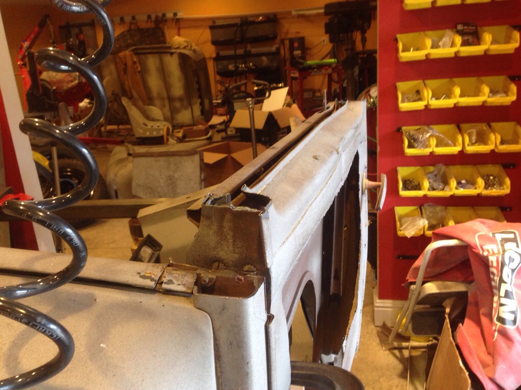

    Braced rear portion... ImageUploadedByH.A.M.B.1395961067.556820.jpg ImageUploadedByH.A.M.B.1395961080.021424.jpg
    Door is flush...

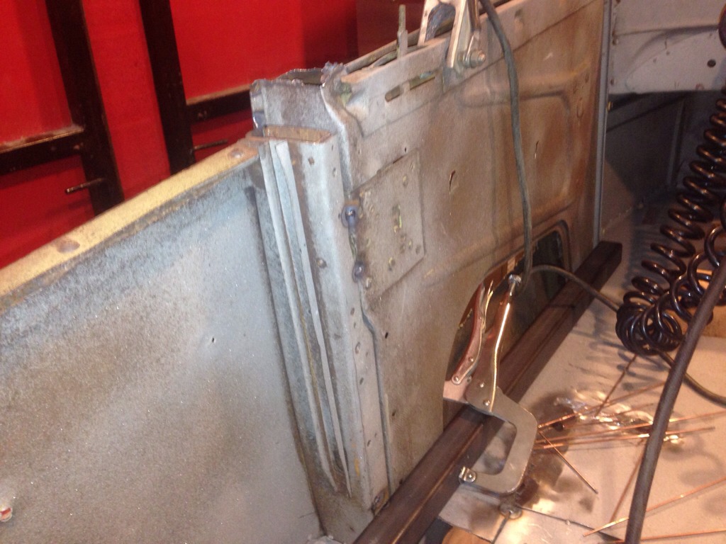

    Joined: Aug 20, 2010
    Posts: 2,263
    pennafxu

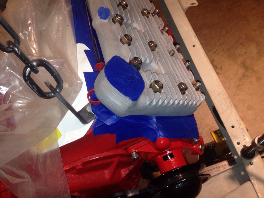

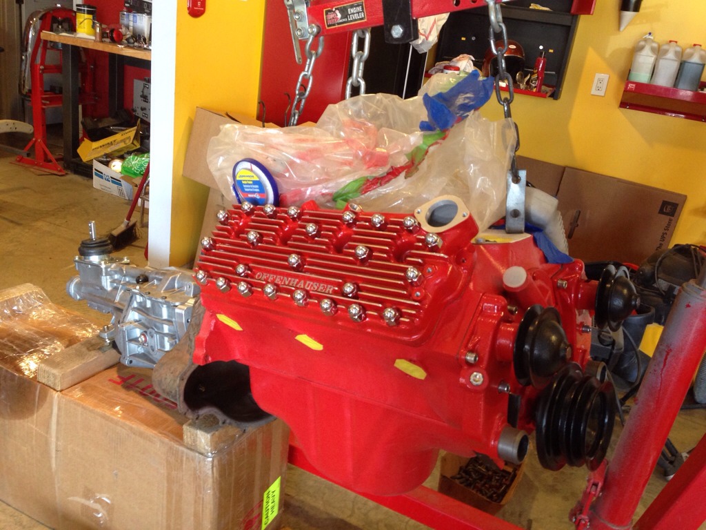

    Dropped engine in...

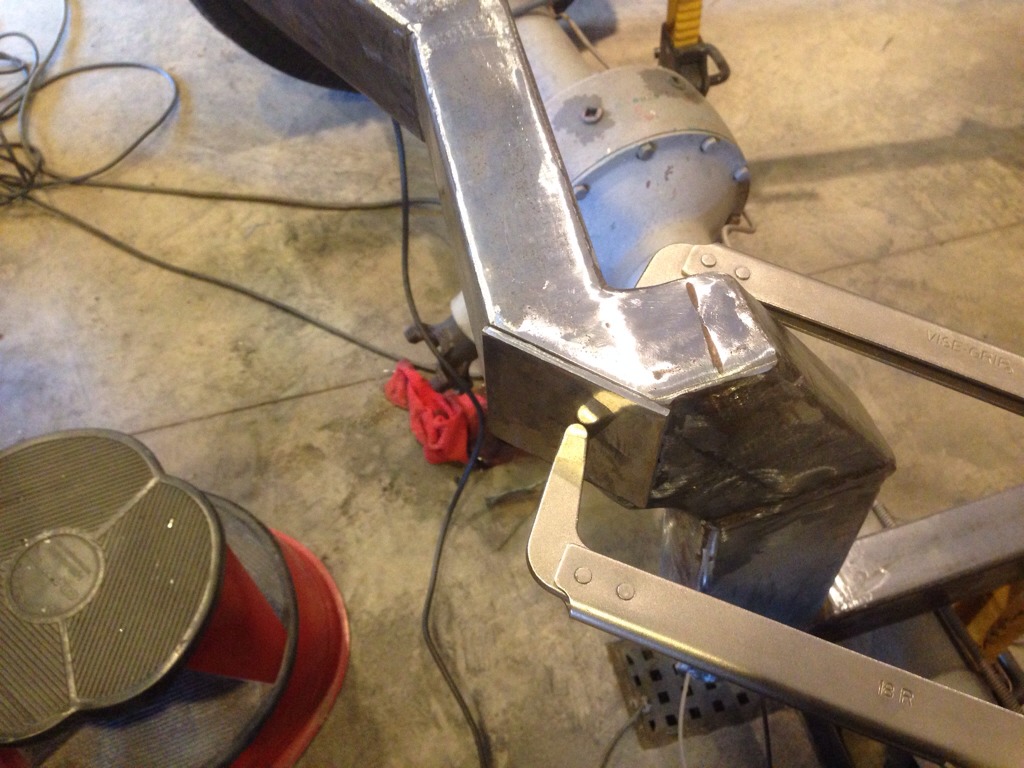

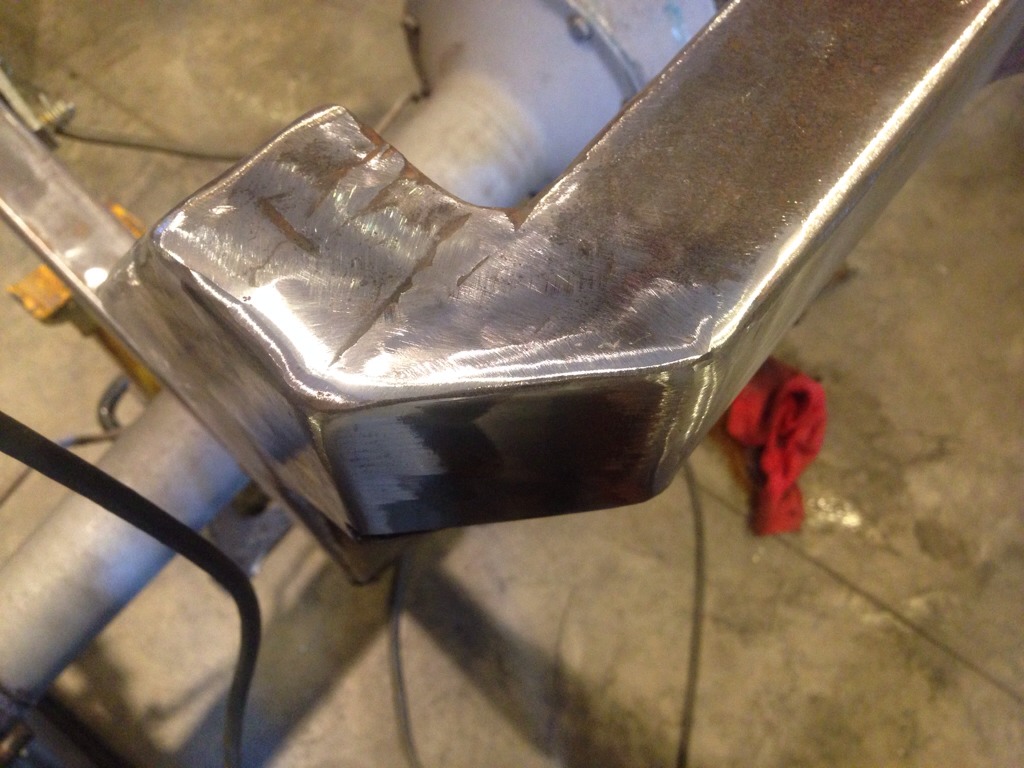

    I will fab a x-member from 4x4 tubing and 1/4" plate. ImageUploadedByH.A.M.B.1395962757.425004.jpg
    Needed this block to space the engine correctly...

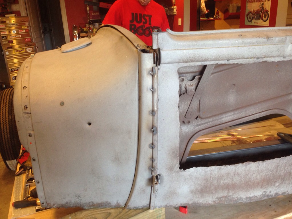

    ImageUploadedByH.A.M.B.1396128551.461085.jpg ImageUploadedByH.A.M.B.1396128560.884316.jpg

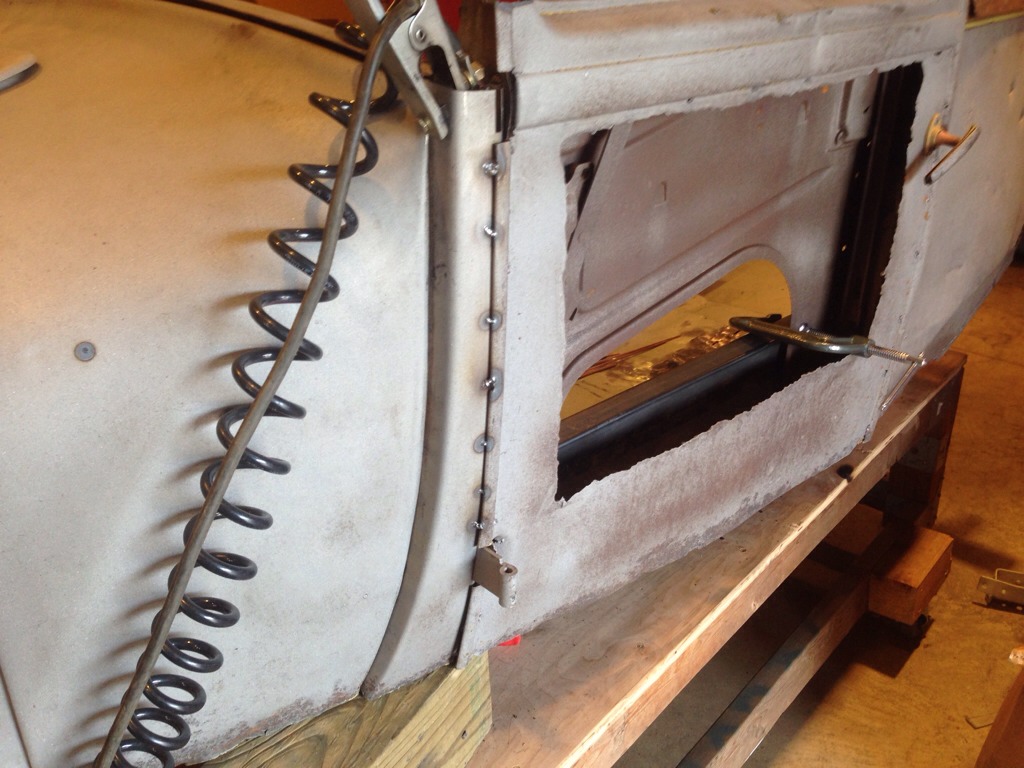

    Doors tacked...
    ImageUploadedByH.A.M.B.1396128581.067503.jpg ImageUploadedByH.A.M.B.1396128594.272710.jpg

    P***enger...
    Boat tail test
    ImageUploadedByH.A.M.B.1396128688.109109.jpg ImageUploadedByH.A.M.B.1396128698.877489.jpg ImageUploadedByH.A.M.B.1396128713.865361.jpg

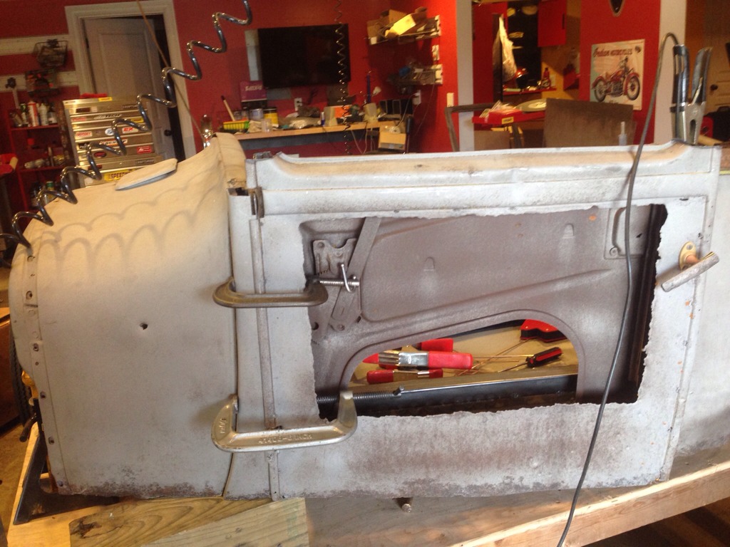

    Clamped...
    ImageUploadedByH.A.M.B.1396295686.749897.jpg ImageUploadedByH.A.M.B.1396295692.973299.jpg
    Welded...
    Lightly dressed...

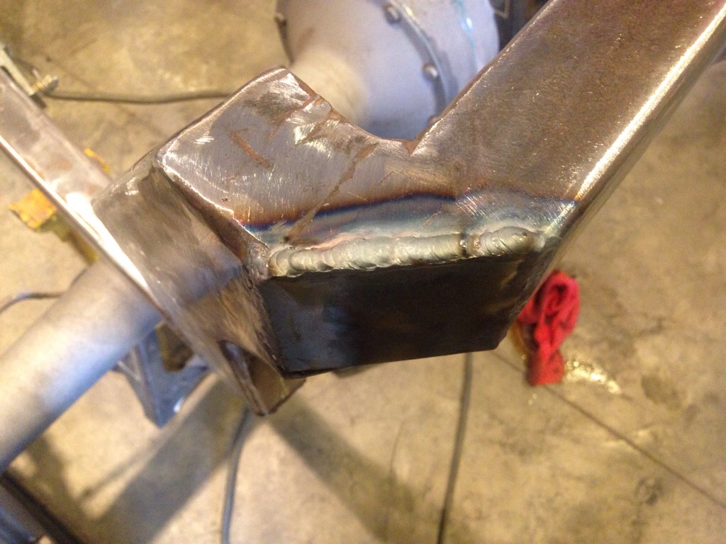

    Got some great welds in today! Had to switch left handed which always ****s... But good work nonetheless... My welding had been off recently... Turns out I had a small argon leak. I feel good now...

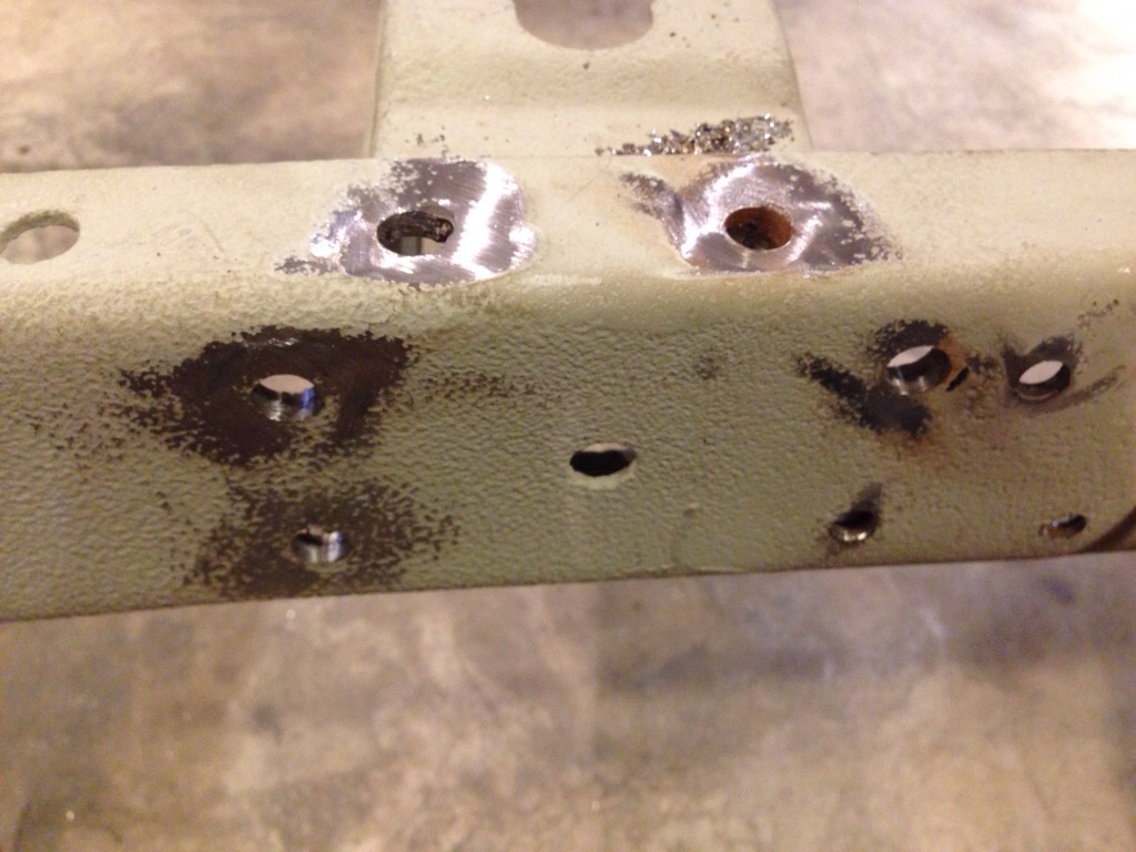

    ImageUploadedByH.A.M.B.1396482525.532188.jpg ImageUploadedByH.A.M.B.1396482533.038142.jpg

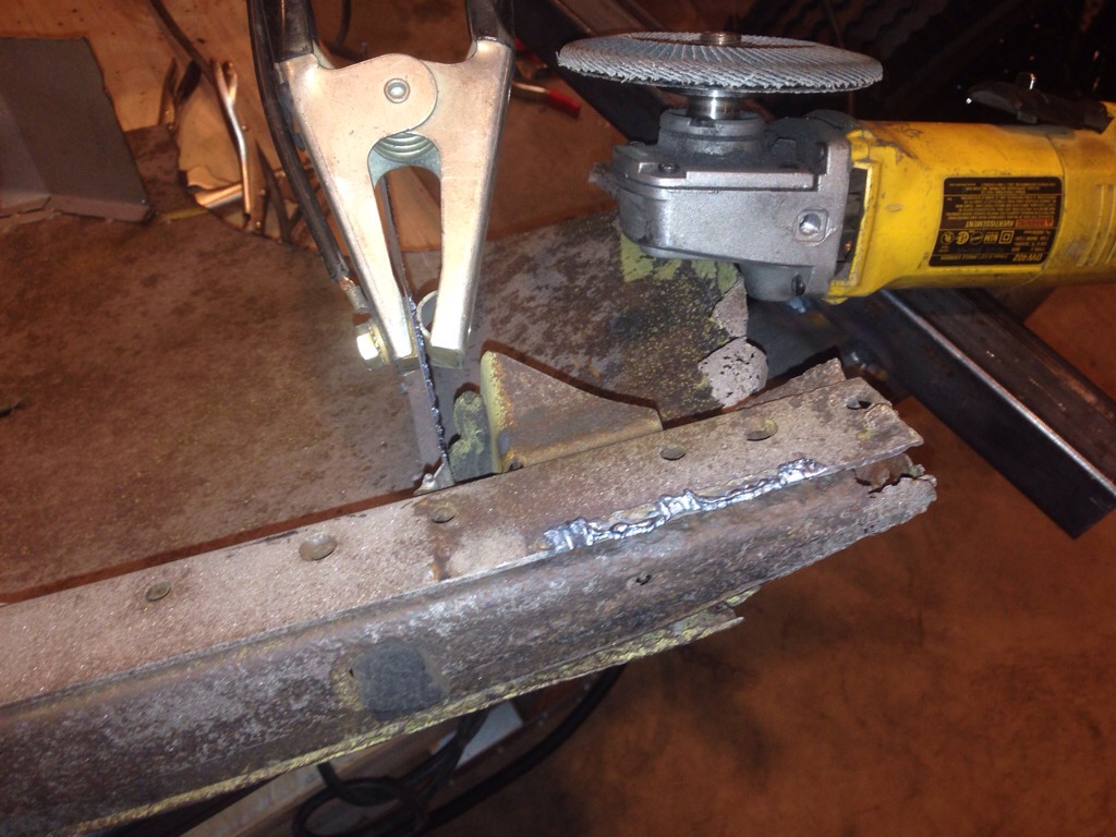

    Grinding rivets ImageUploadedByH.A.M.B.1396482549.468606.jpg ImageUploadedByH.A.M.B.1396482557.677299.jpg ImageUploadedByH.A.M.B.1396482563.983115.jpg
    Removing this is a pain!!
    Must refrain from using plasma...Must refrain from using plasma...Must refrain from using plasma...

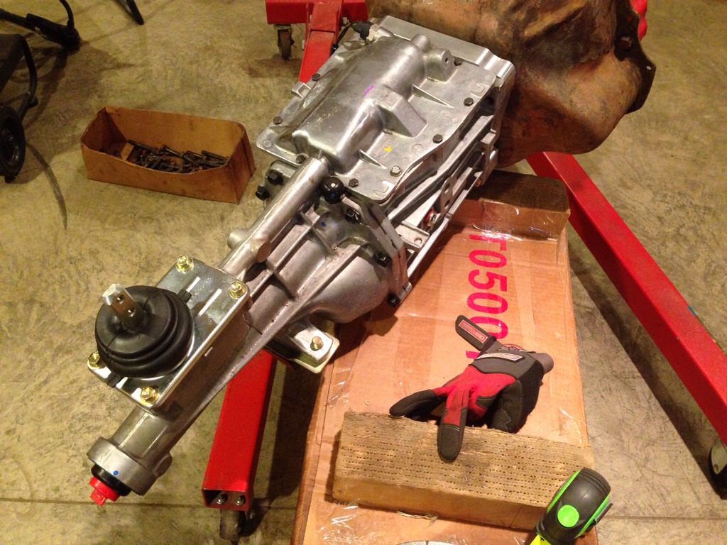

    Transmission bolted up!
    Woohoo!
