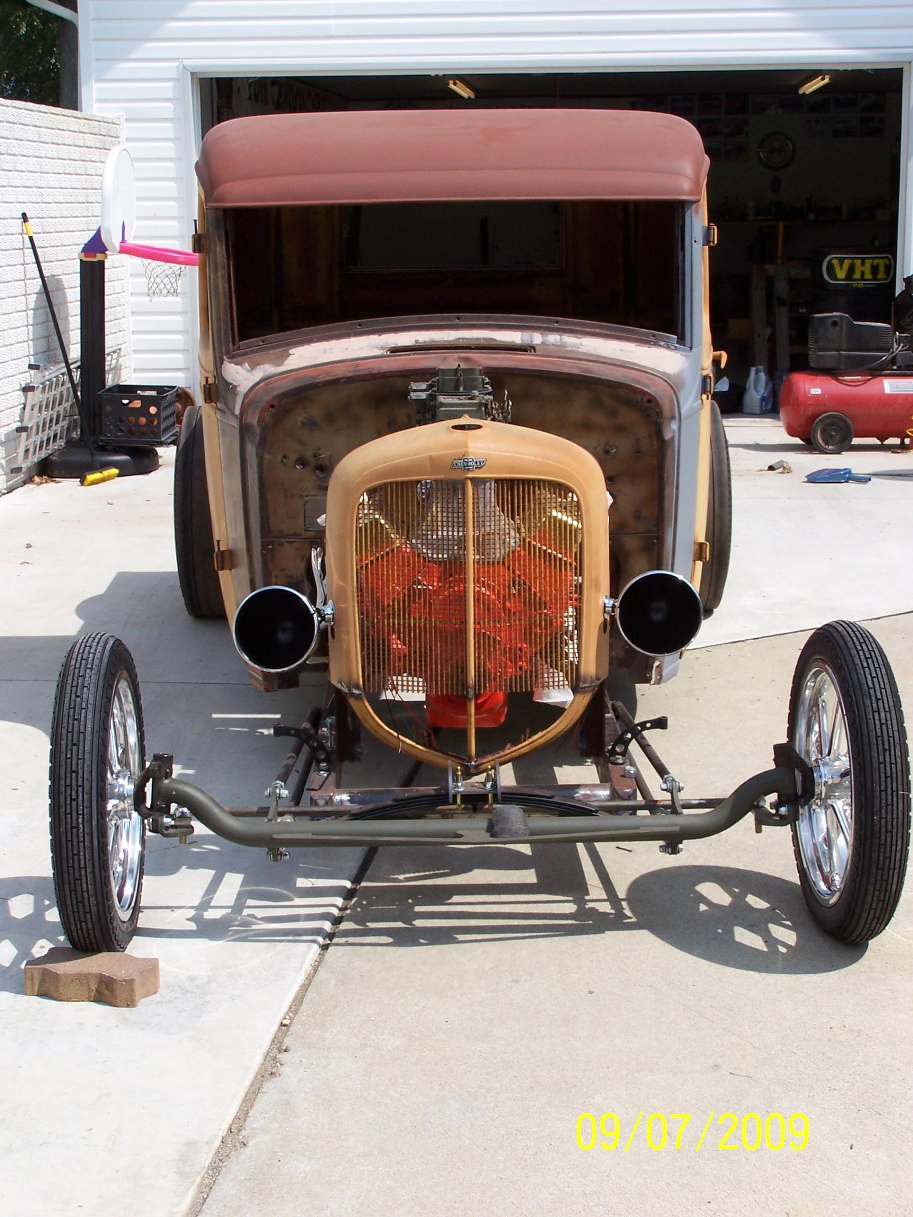

    OK so more progress... I spent about an hour cutting welds and used a jack to make sure this body was loose. I then had to put the wheels back on to have a rolling ch***is...
    This went rather smoothly, seeing as it was only me...
    [​IMG][​IMG][​IMG][​IMG]
    [​IMG][​IMG][​IMG]
    [​IMG][​IMG]
    Ah yes, the sweet victory salute:D
    More pictures to come...

    got it into the garage...
    So what's salvageable? Ideas, opinions? rants? I will take better shots tomorrow, but the frame actually doesn't look too bad...
    [​IMG][​IMG][​IMG][​IMG][​IMG][​IMG][​IMG][​IMG][​IMG][​IMG][​IMG][​IMG]
