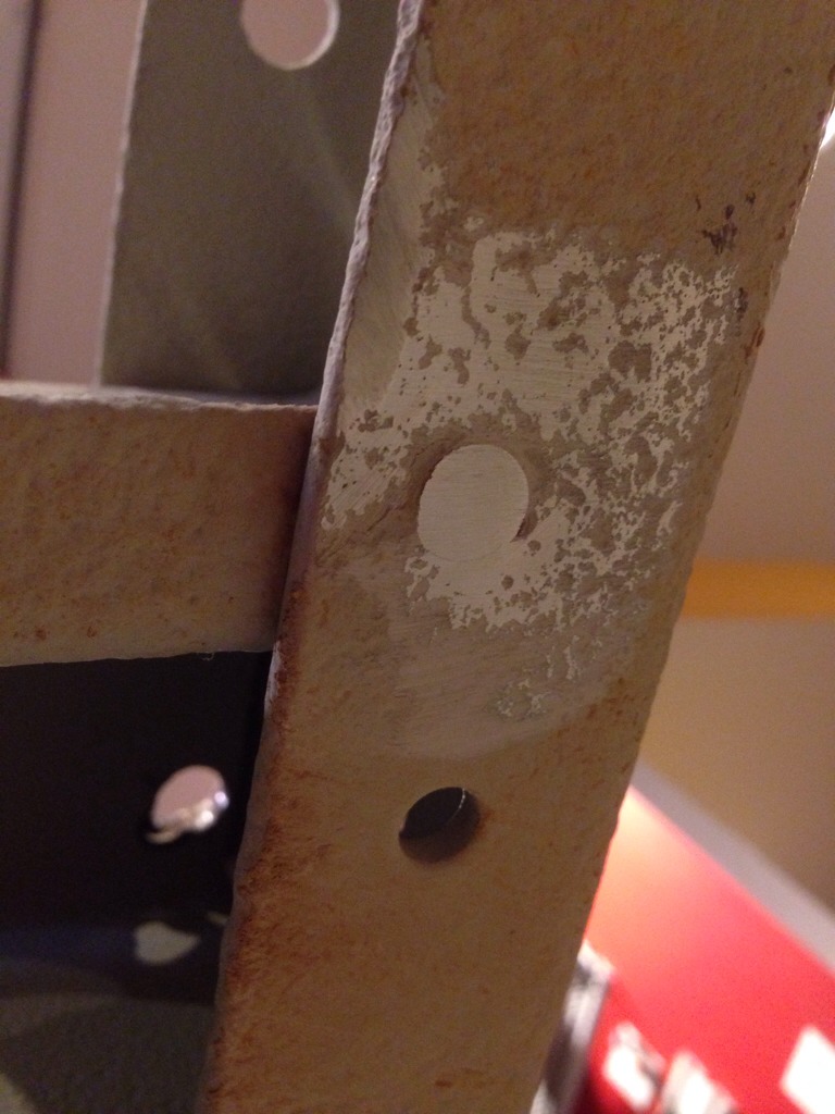

    I also noticed my rear end is menstruating... Lol ImageUploadedByH.A.M.B.1396566198.438769.jpg

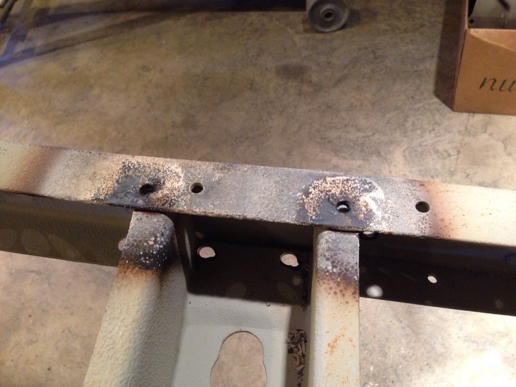

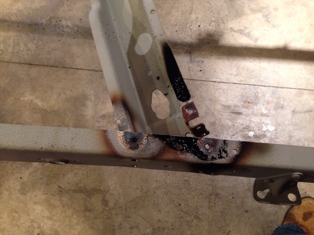

    Flipped frame over... To get to those pesky rivets!

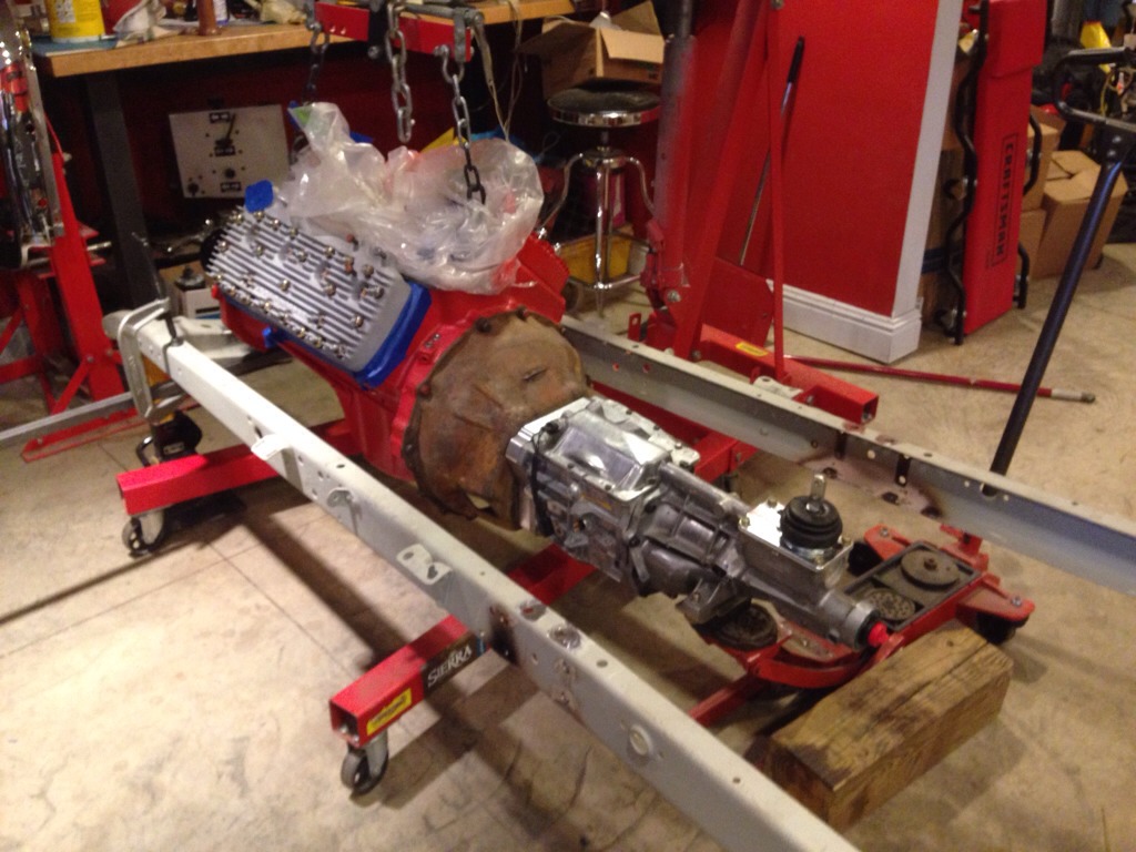

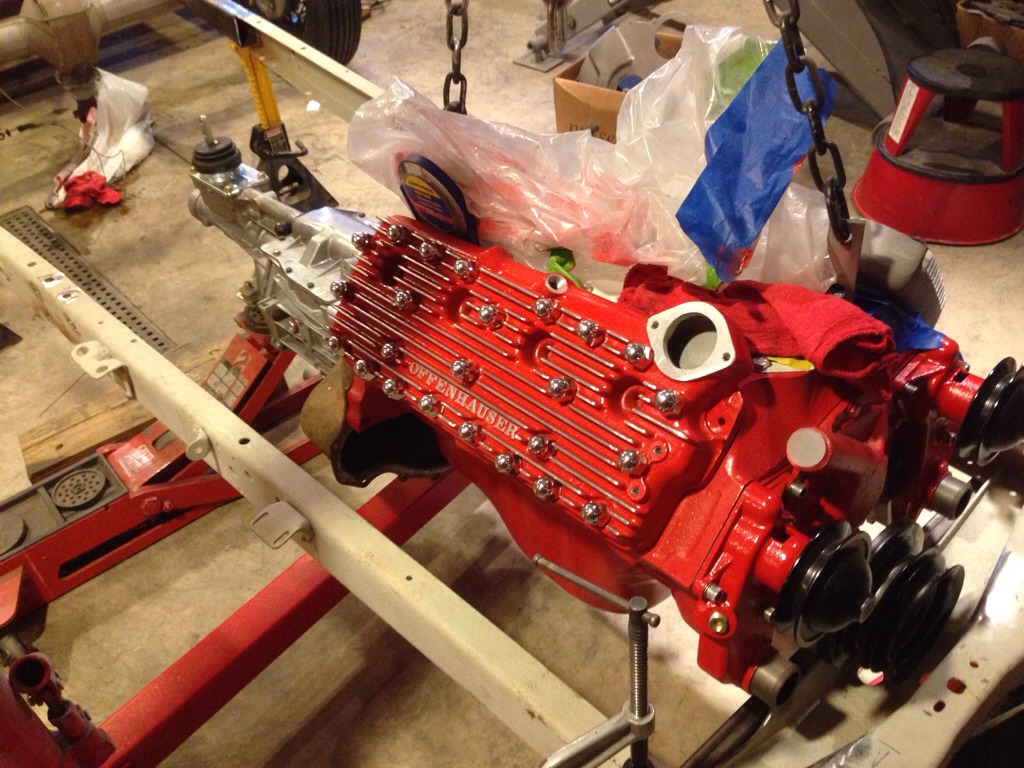

    Drivetrain maneuvered in place...
    ImageUploadedByH.A.M.B.1396740410.197999.jpg ImageUploadedByH.A.M.B.1396740422.519315.jpg ImageUploadedByH.A.M.B.1396740434.372884.jpg
    A touch off, but it was the first maneuver...
    My dainty wife even helped!!

    ImageUploadedByH.A.M.B.1396740513.862817.jpg ImageUploadedByH.A.M.B.1396740527.248296.jpg

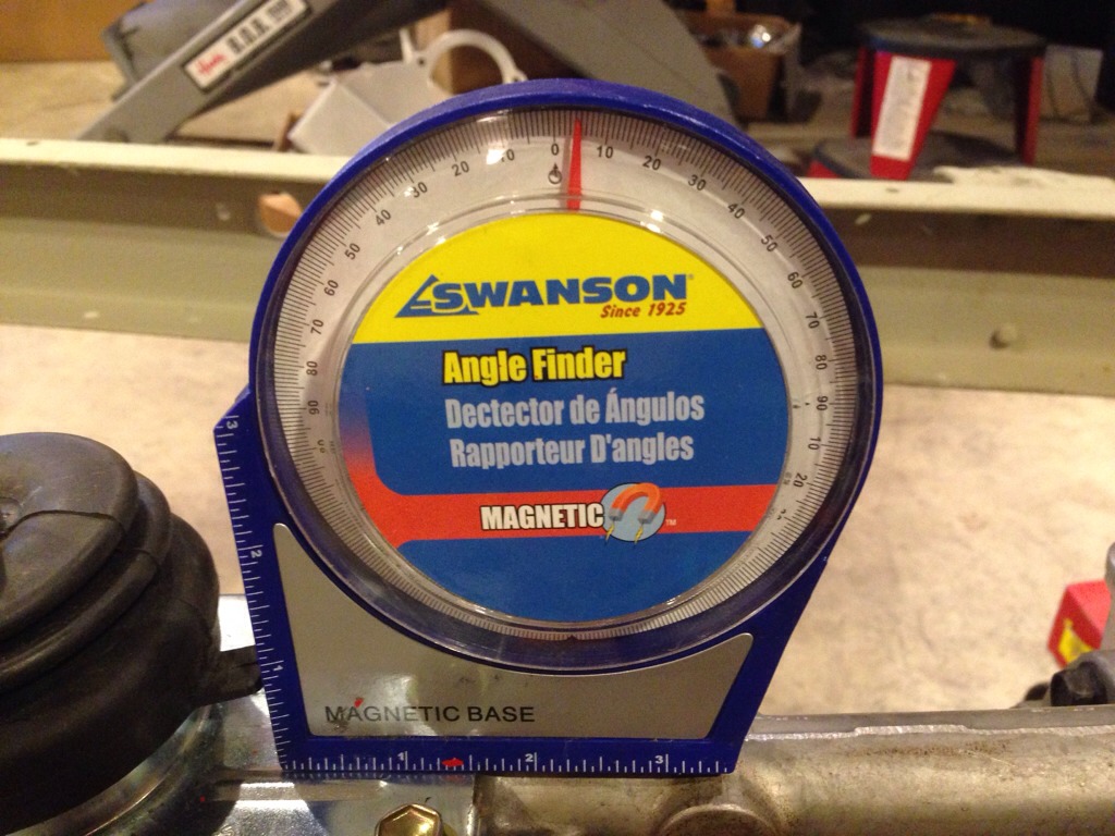

    Around 4 deg pinion angle... Will switch to 3 deg after the front and rear end are set... Getting closer nonetheless!

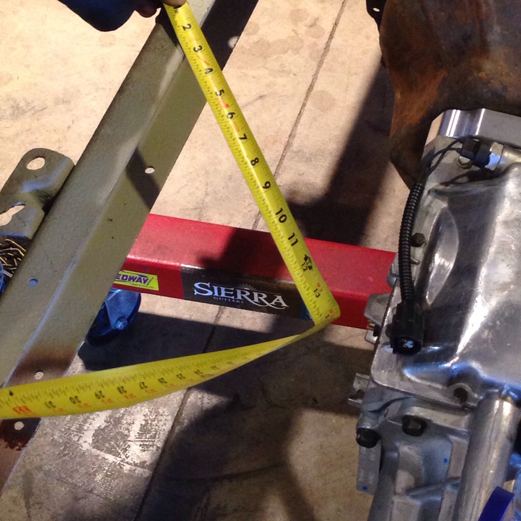

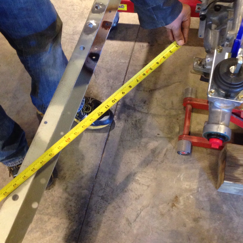

    Getting the measurements right... ImageUploadedByH.A.M.B.1396818979.244061.jpg
    13 1/8" front

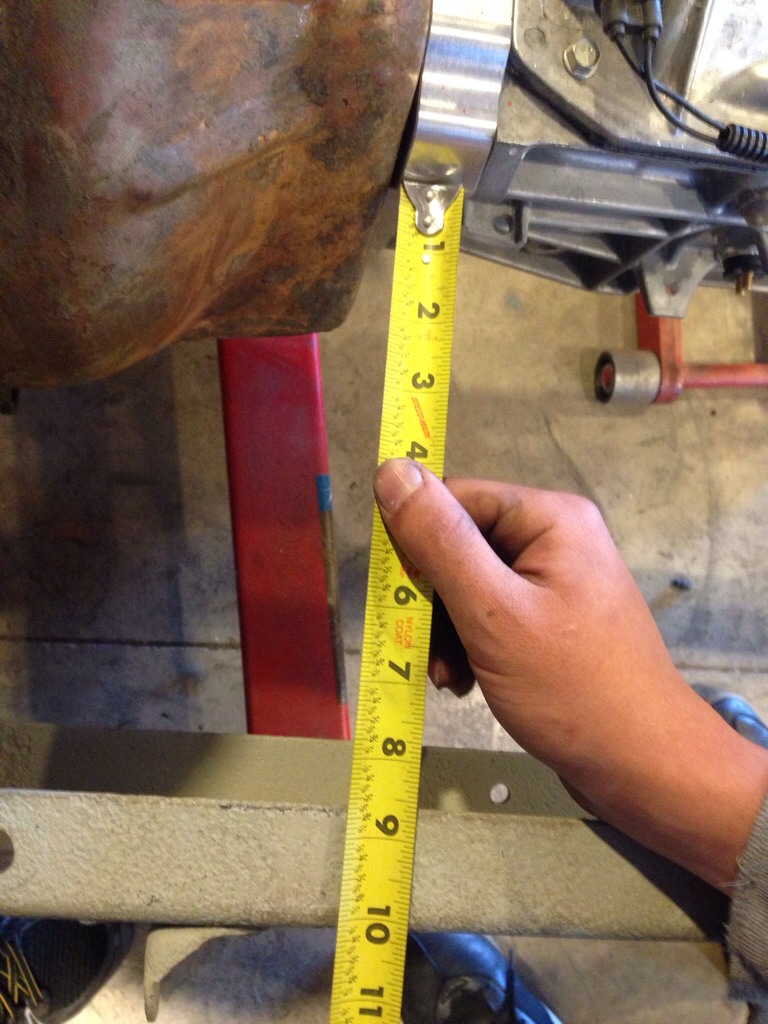

    Engine pulley center to center... ImageUploadedByH.A.M.B.1396832448.013187.jpg

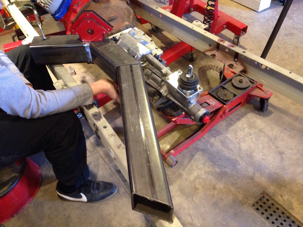

    Mocked up...
    Will half this and lighten it up...

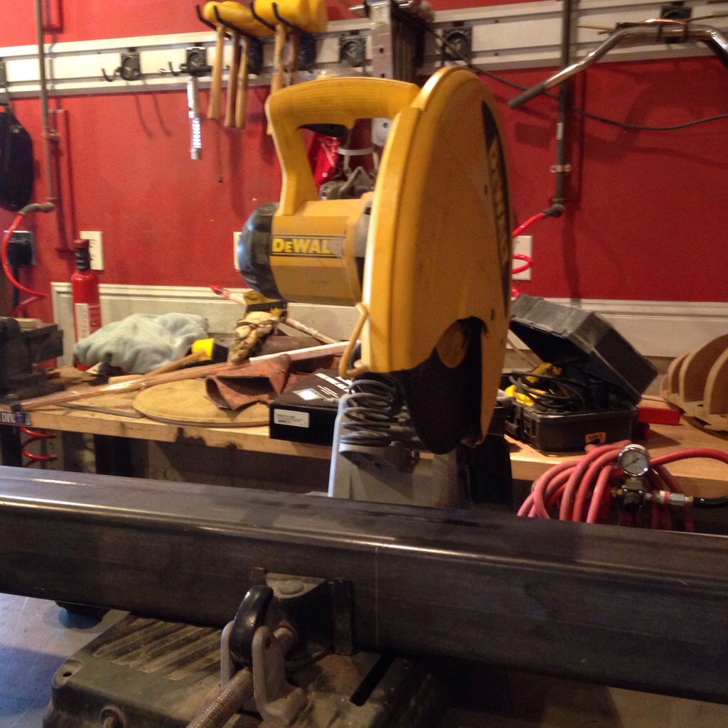

    Started choppin the beams... 👀 ImageUploadedByH.A.M.B.1396910538.023058.jpg ImageUploadedByH.A.M.B.1396910546.200066.jpg

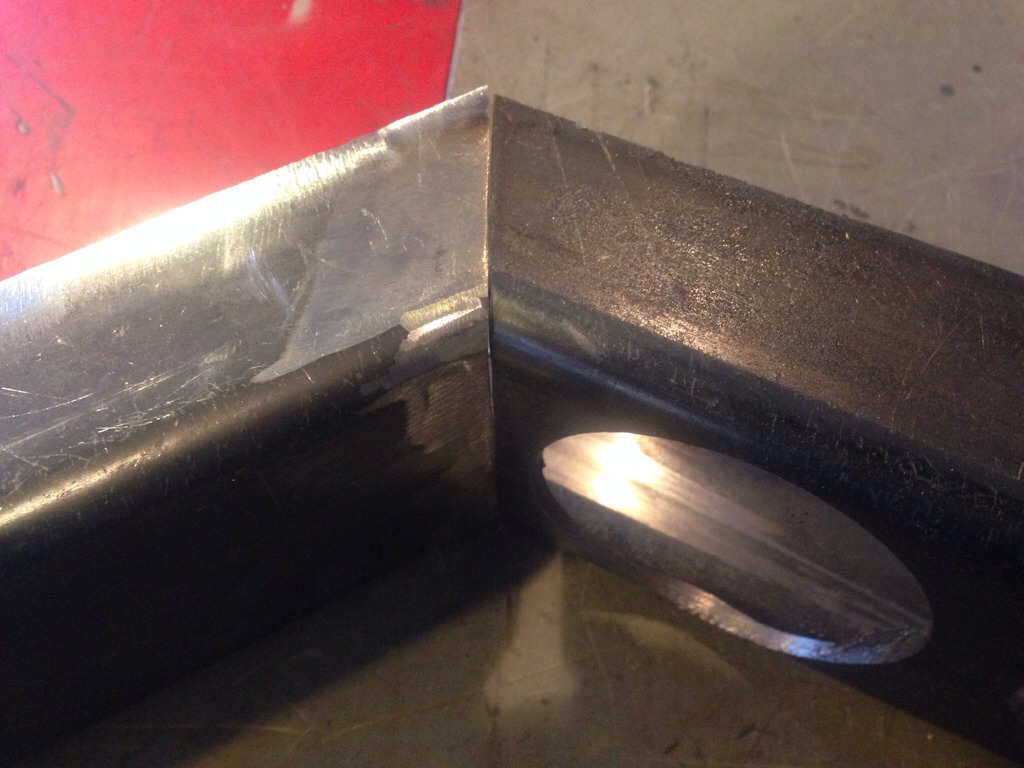

    Edges were plasma cut throughout the process and clamped as such.
  28. pennafxu
    Joined: Aug 20, 2010
    Posts: 2,263
    pennafxu
    from Kentucky

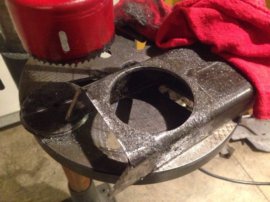

    Drilling some go fast holes... 3.25"
    This is fun 😃
    But really messy and oily! 😝
    1 down... 10 million to go... 😜
  29. patmanta
    Joined: May 10, 2011
    Posts: 3,882
    patmanta
    from Woburn, MA
    Man, that looks a little wide to me. It should be OK for your K member on this build, but I'd personally be more comfortable with just a little more meat between the OD of the hole and the edge of the beam. A half-inch smaller hole saw would be my pick to get an extra quarter inch on each side... might cut quicker too.
  30. pennafxu
    Posts: 2,263
    pennafxu
    from Kentucky
    Yes. Thank you. I pondered this back and forth... The beams are so thick (3/16" plate) that it doesn't seem to make too much difference... I used a 3.25" bit, but you are right however and I will take your advice and switch to 2.75" for the rest of the pieces... In the interim I drilled the center pieces only...
