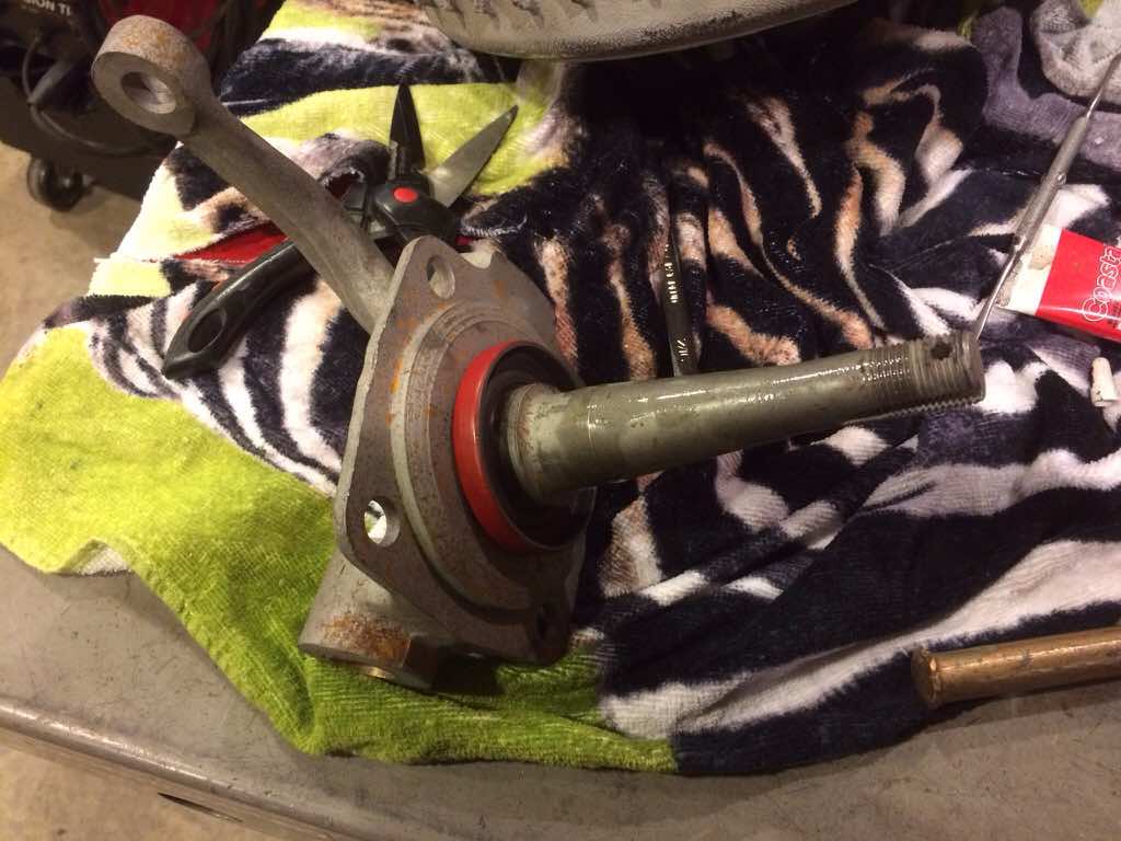

    Test fit the brake ***y to the drum and spindle
    Used the old 3/8" hex head drilled shank bolts with the ***ociated castle nuts...
    Suffice it to say I think they are not big enough so I ordered the 7/16-20 ones...
    A certain order definitely needs to be followed here, as the king pin will not fit with the brake ***y together like this... More to follow as I'm done for tonight

    I hope you greased the lip on the grease seal and the spindle too. Doesnt look like it. You can add the self adjusters to those Lincoln brakes. Those keep the brakes adjusted evenly and you dont have to do it yourself

    What is a self adjuster? And this is just a mock fit and I did use a thin film of grease! But thanks for lookin out Many!
