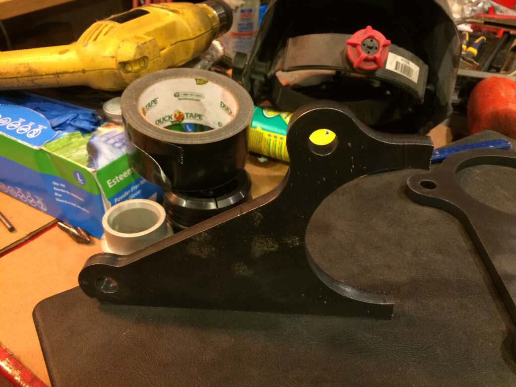

    Jigged up...

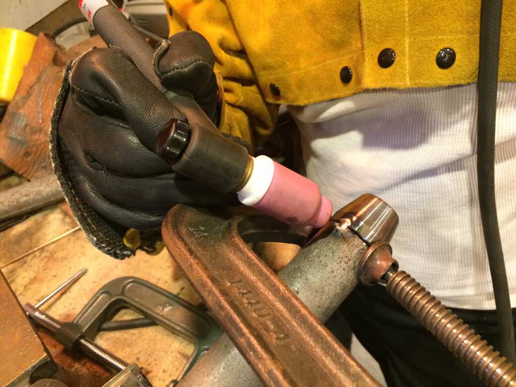

    Need to change out tungsten...
    #8 cup
    Just used grips to flip the tungsten as I always sharpen both ends for double duty! ImageUploadedByH.A.M.B.1418084526.320809.jpg gas lens is the best set up!
    Whisky is back!

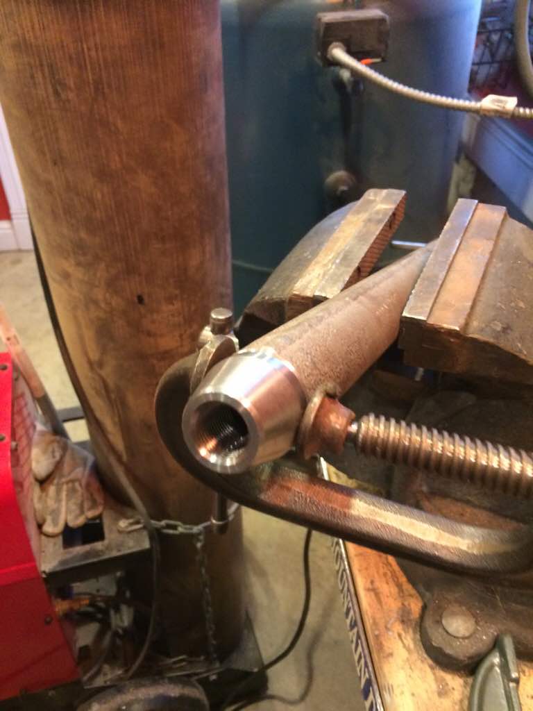

    Next bone...
    All welded up! Not bad for 6 months of inactivity... ImageUploadedByH.A.M.B.1418084638.833878.jpg tie rod ImageUploadedByH.A.M.B.1418084660.899224.jpg grease zerk is 9/32"
    Whisky is back!

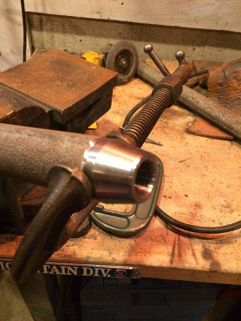

  10. pennafxu
    Joined: Aug 20, 2010
    Posts: 2,263
    pennafxu
    from Kentucky
    ImageUploadedByH.A.M.B.1418084719.873570.jpg finished! ImageUploadedByH.A.M.B.1418084736.456121.jpg just a little dressing...

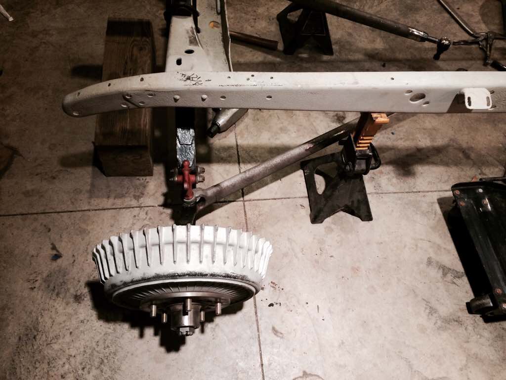

    Front end on front x-member
    ImageUploadedByH.A.M.B.1418089980.655107.jpg rear view of an almost roller...

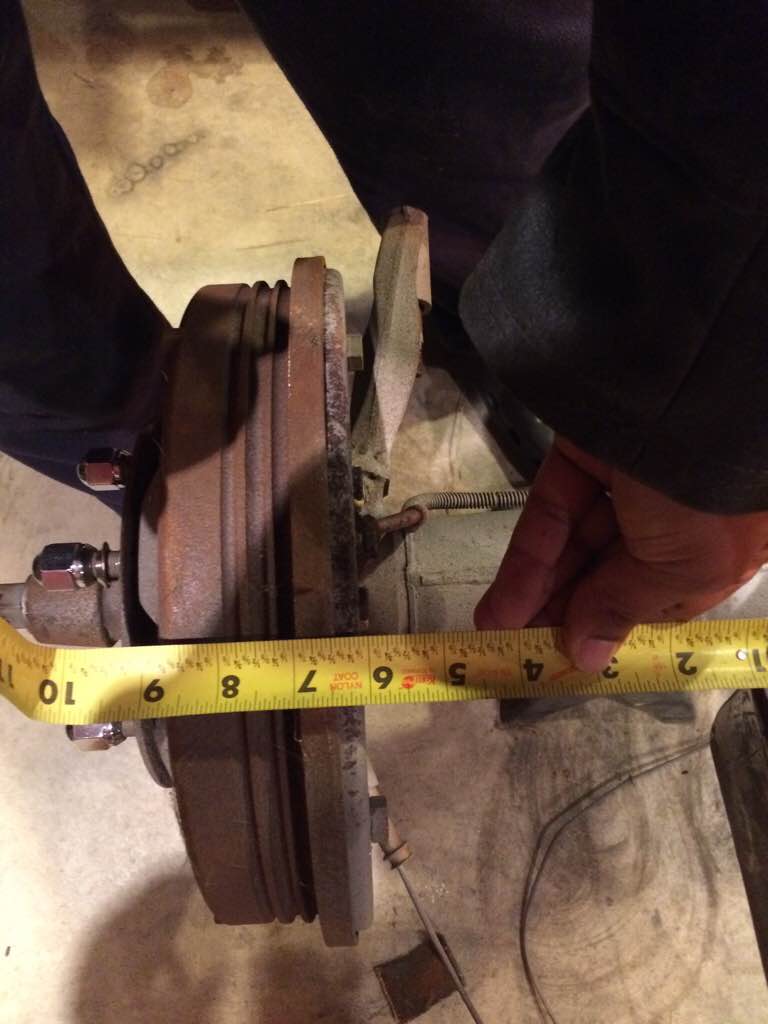

    Both drums ImageUploadedByH.A.M.B.1418090091.316960.jpg ImageUploadedByH.A.M.B.1418090124.420488.jpg left wheel chocked up... ImageUploadedByH.A.M.B.1418090163.291073.jpg wheels straight... ImageUploadedByH.A.M.B.1418090191.823346.jpg turning left...

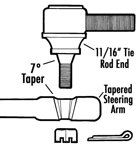

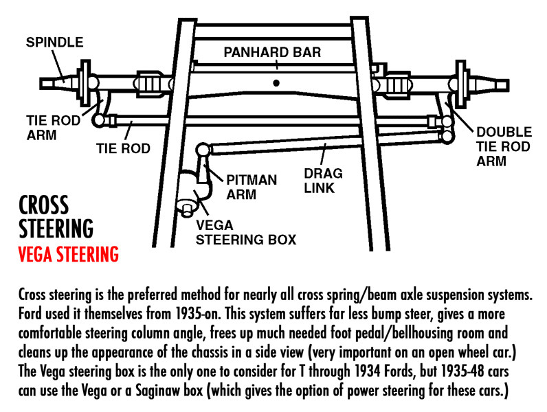

    Some of this too....

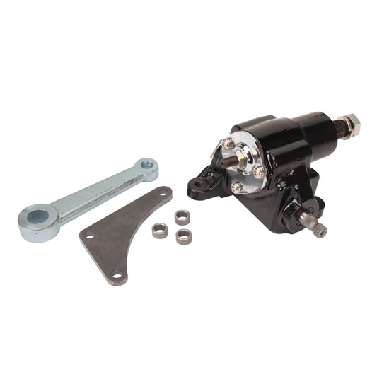

    This is the kit I will go with... Unless there is summit better out there??? Also I ***ume it mounts to a specific frame area???
    9163220~2_L_189e7d4b.jpg 9163220~1_L_189e7d4a.jpg 9163220_L.jpg 9163220~2_L_189e7d4b.jpg 9163220~3_L_189e7d4b.jpg

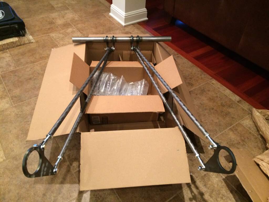

    Looking to start the rear end ***y... Waiting on the front spacers...
    Courtesy of P and J my favorite rod shop by far!
    I just still cannot believe the service!

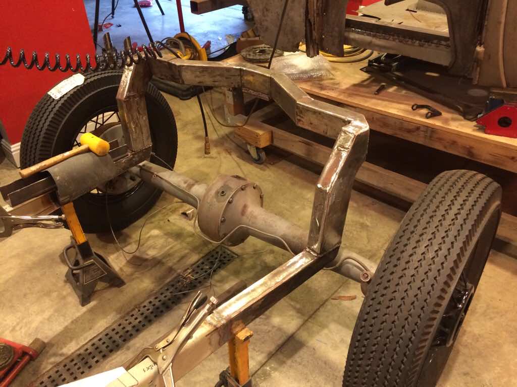

    Had some time to throw this together real quick... ImageUploadedByH.A.M.B.1419203705.061282.jpg
    Went fairly smooth
    Other side ImageUploadedByH.A.M.B.1419203739.615424.jpg wanna see how this works with my homemade x- member
    ImageUploadedByH.A.M.B.1419203751.098158.jpg ImageUploadedByH.A.M.B.1419203787.467635.jpg

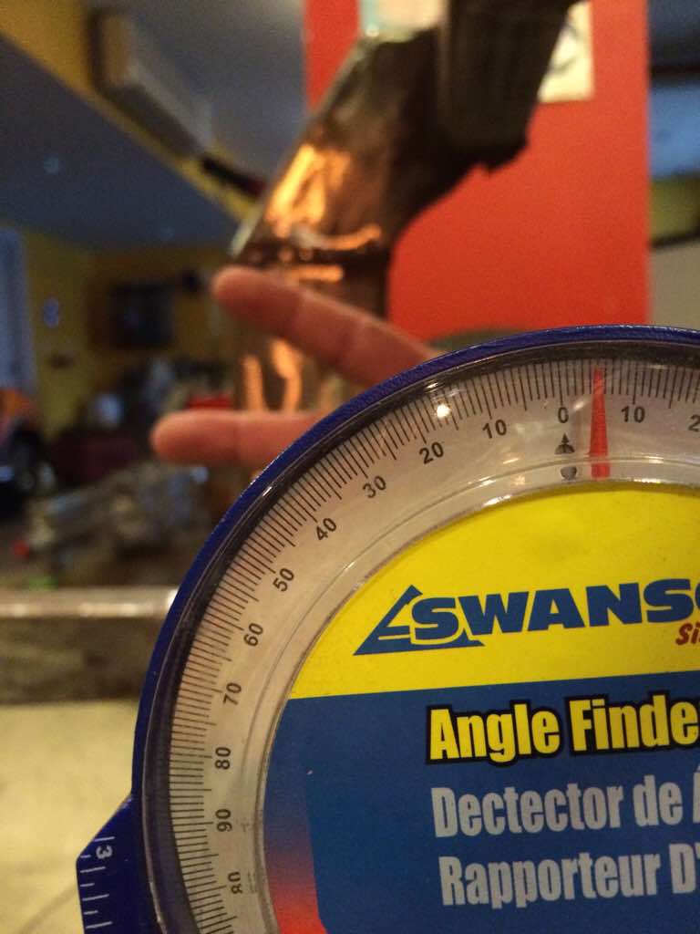

    Per instructions I need to be 4" below my rear cross member, and 1/4" fore of the center line... ImageUploadedByH.A.M.B.1419290897.472573.jpg
    Looks good... ImageUploadedByH.A.M.B.1419290943.723356.jpg about 4 deg
    Side view ImageUploadedByH.A.M.B.1419291027.897025.jpg back view
