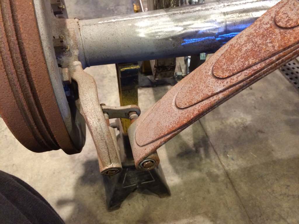

    from Kentucky
    Got three days off in a row to get a roller! Let's see what happens... Only thing I don't have is the rear shackle ***y but will figure out something temporarily... ImageUploadedByH.A.M.B.1419611092.853249.jpg rear hanger ImageUploadedByH.A.M.B.1419611113.018995.jpg looks like the little elfs even carved writing into them... So sweet! ImageUploadedByH.A.M.B.1419611156.406251.jpg shock slugs ImageUploadedByH.A.M.B.1419611178.642273.jpg goes together like this... ImageUploadedByH.A.M.B.1419611197.394944.jpg side view ImageUploadedByH.A.M.B.1419611214.276734.jpg looks like Darth Vader's helmet!!
    Only annoying thing is that the writing the elves carved just for me is upside down in the final set up... ;(
    Whisky is back!
