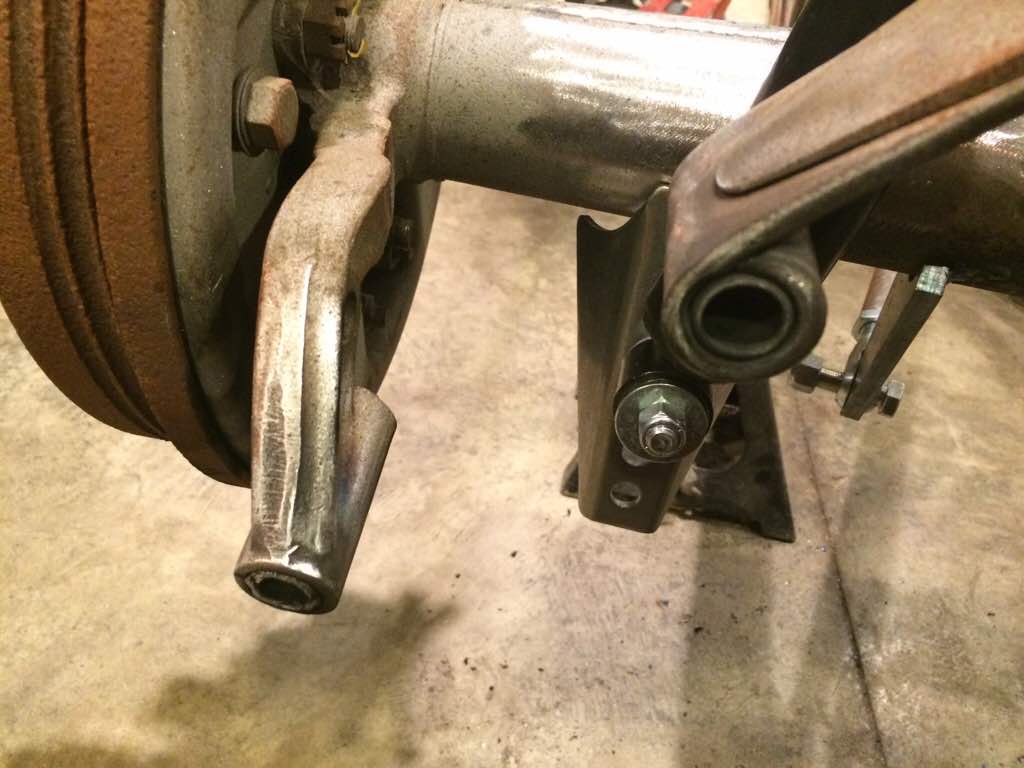

    Pulling the other shock arm off... ImageUploadedByH.A.M.B.1420333618.951406.jpg this was frozen! ImageUploadedByH.A.M.B.1420333641.018197.jpg new arm ImageUploadedByH.A.M.B.1420333660.487007.jpg hooked up ImageUploadedByH.A.M.B.1420333685.891670.jpg but compared to the other side, is 30 deg off??? Is this because the shocks are frozen and immobile, or the incorrect shock? I.e not the correct position as I ***ume there are/were 4 shocks?

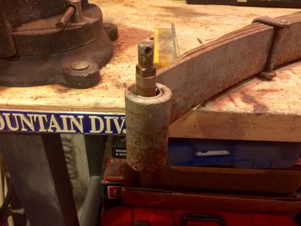

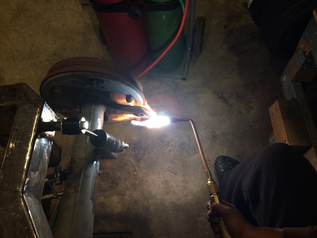

    Anyways... Moving on... ImageUploadedByH.A.M.B.1420334320.699474.jpg time to remove the shackle pins... These will not budge! Hmmmm... ImageUploadedByH.A.M.B.1420334466.762297.jpg rosebud tip time! ImageUploadedByH.A.M.B.1420334515.549368.jpg came out without a fight ImageUploadedByH.A.M.B.1420334590.905427.jpg

    Other side ImageUploadedByH.A.M.B.1420334635.593506.jpg clamped ImageUploadedByH.A.M.B.1420334650.228173.jpg really clamped! ImageUploadedByH.A.M.B.1420334684.380140.jpg the bfh zone... ImageUploadedByH.A.M.B.1420334736.802258.jpg acetylene first... ImageUploadedByH.A.M.B.1420334771.270966.jpg slowly introduce oxygen until neutral flame... ImageUploadedByH.A.M.B.1420334840.214298.jpg barely need much heat here ImageUploadedByH.A.M.B.1420334934.934983.jpg hammer time ImageUploadedByH.A.M.B.1420334970.221568.jpg tap tap tap ImageUploadedByH.A.M.B.1420335020.075430.jpg and out she came!
