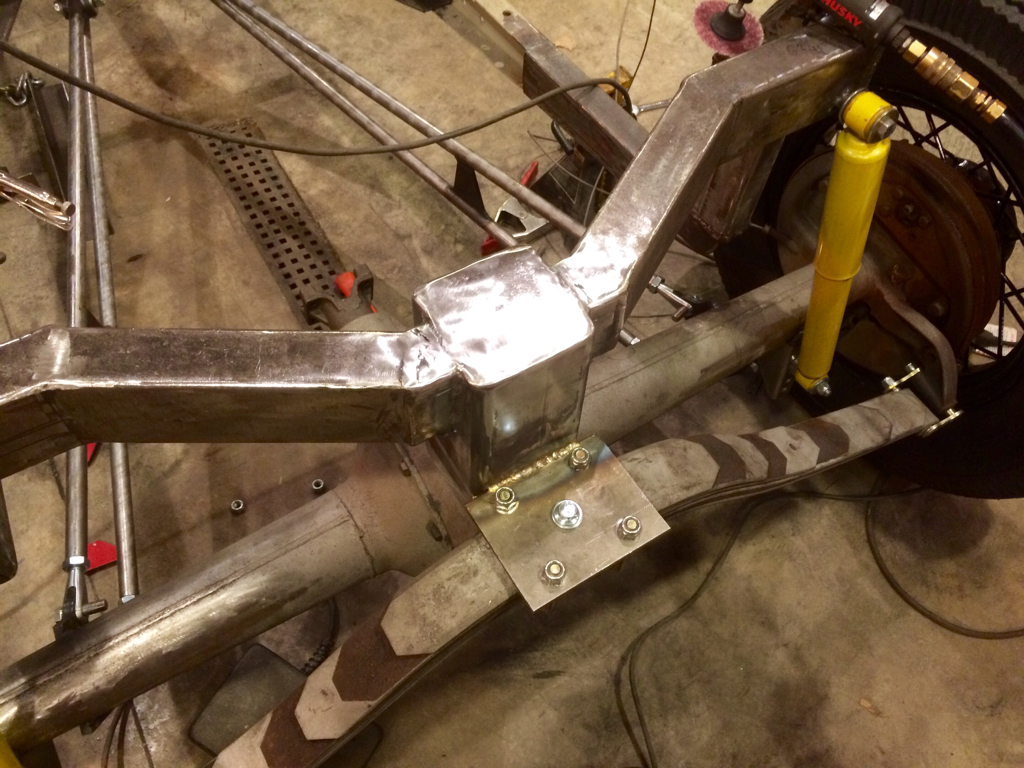

    ImageUploadedByH.A.M.B.1423957642.783591.jpg Spring plate welded on also ImageUploadedByH.A.M.B.1423957664.251715.jpg ImageUploadedByH.A.M.B.1423957681.402668.jpg ImageUploadedByH.A.M.B.1423957698.603839.jpg

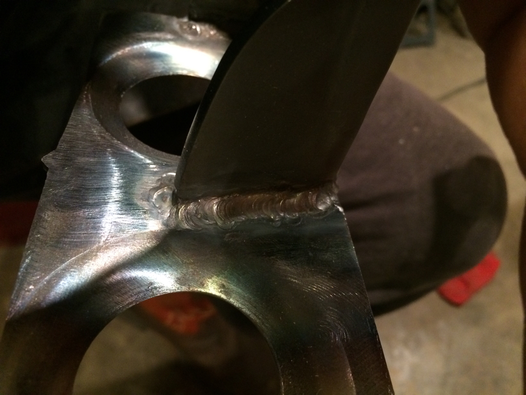

    ImageUploadedByH.A.M.B.1423957836.199965.jpg for those of you into welding mechanics, on the main member I did a root p***, along with three hot p***es, at 140Amps...I will be using this technique on all of the frame intersection areas...

    ImageUploadedByH.A.M.B.1423958173.395835.jpg at this angle you can see the quadruple p*** where the member meets the pillar...

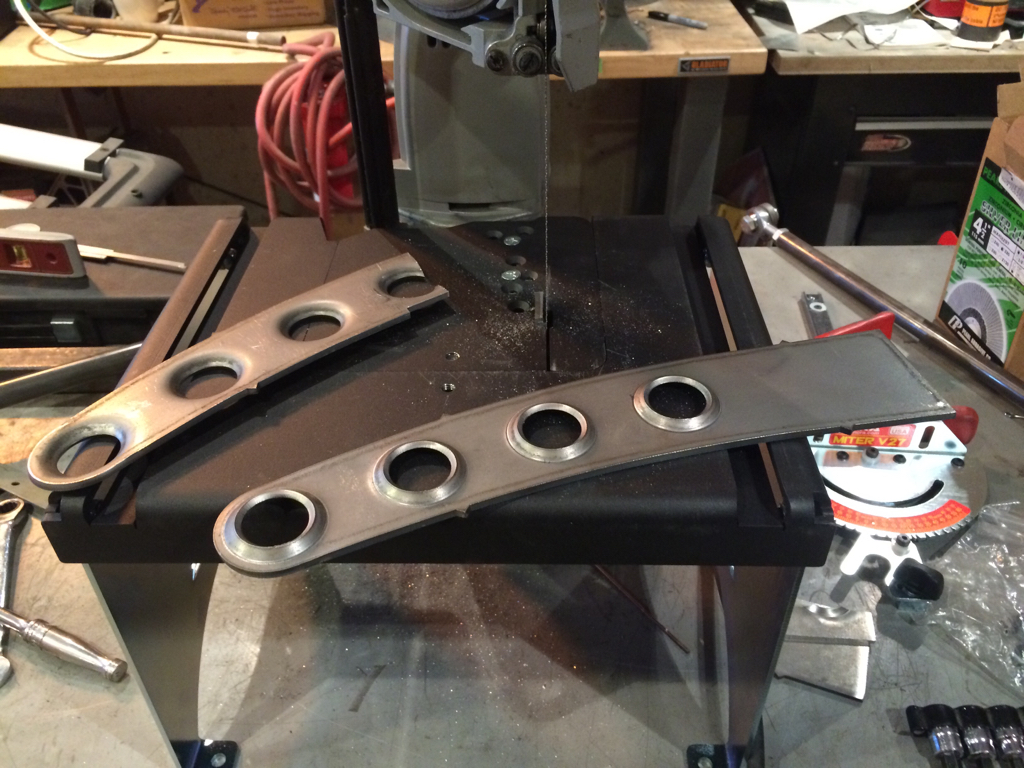

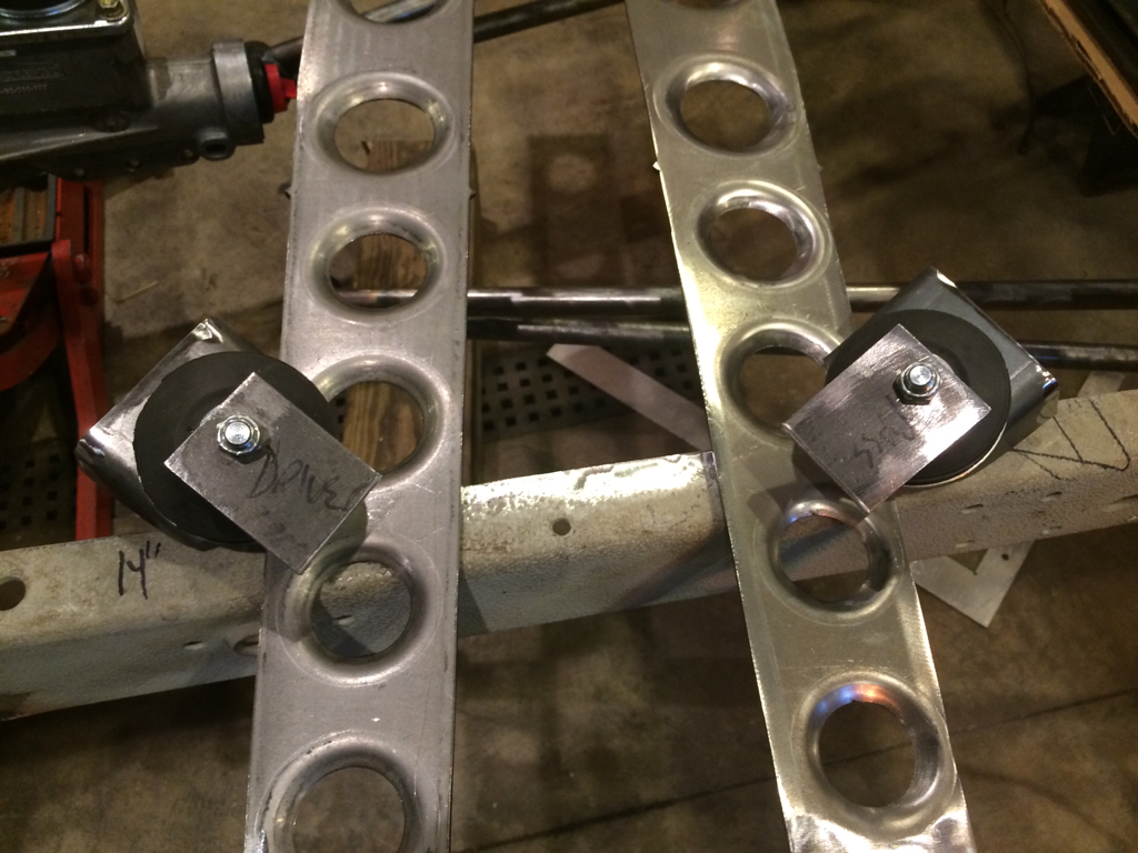

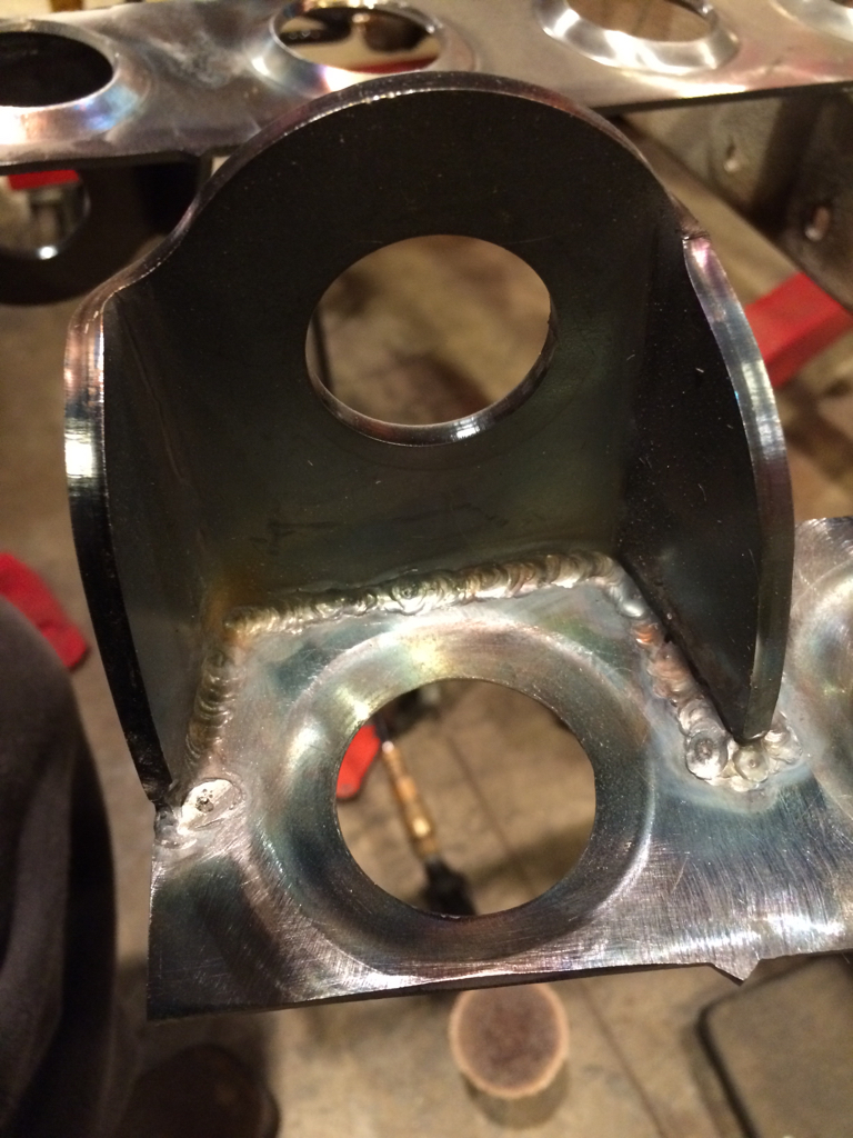

    Little bit of progress today... ImageUploadedByH.A.M.B.1425414552.192829.jpg front horn box plates ImageUploadedByH.A.M.B.1425414573.045345.jpg cut to size ImageUploadedByH.A.M.B.1425414589.446765.jpg transferred... ImageUploadedByH.A.M.B.1425414605.880152.jpg clamped ImageUploadedByH.A.M.B.1425414640.983787.jpg welded ImageUploadedByH.A.M.B.1425414657.652503.jpg top... This was not fun to weld, lot of impurities in Henry's steel!

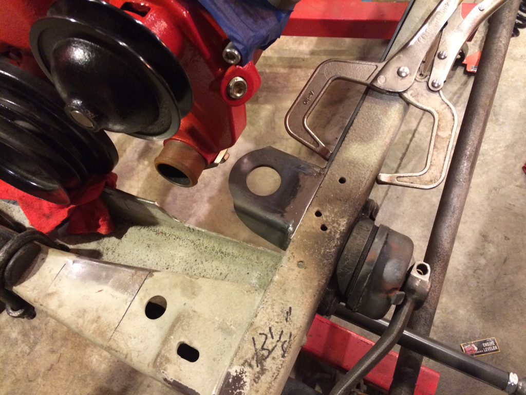

    Some more progress with getting the engine mounted... ImageUploadedByH.A.M.B.1425508436.823777.jpg cleaned up boxing rails ImageUploadedByH.A.M.B.1425508458.907958.jpg chopped up stock for biscuit mounts... ImageUploadedByH.A.M.B.1425508485.643958.jpg mocked up ImageUploadedByH.A.M.B.1425508503.612468.jpg tacked ImageUploadedByH.A.M.B.1425508526.662796.jpg using 2% lanthanated tungsten instead of thoriated... ImageUploadedByH.A.M.B.1425508645.023239.jpg Hit and miss so far... ImageUploadedByH.A.M.B.1425508659.759295.jpg was also hard to clean some of these areas well :( ImageUploadedByH.A.M.B.1425508695.660445.jpg a little hot at the base... But felt impure... ImageUploadedByH.A.M.B.1425508739.714737.jpg a little better ImageUploadedByH.A.M.B.1425508770.033897.jpg tungsten was out 3/4" here to get into the corner! ImageUploadedByH.A.M.B.1425508818.788379.jpg

    ImageUploadedByH.A.M.B.1425509599.465245.jpg clamped in place ImageUploadedByH.A.M.B.1425509653.838709.jpg other side ImageUploadedByH.A.M.B.1425509681.022802.jpg front ImageUploadedByH.A.M.B.1425509703.741368.jpg p***enger ImageUploadedByH.A.M.B.1425509728.927167.jpg driver ImageUploadedByH.A.M.B.1425509749.295572.jpg 135deg weldment here ImageUploadedByH.A.M.B.1425509802.549679.jpg step back ImageUploadedByH.A.M.B.1425509823.017988.jpg
