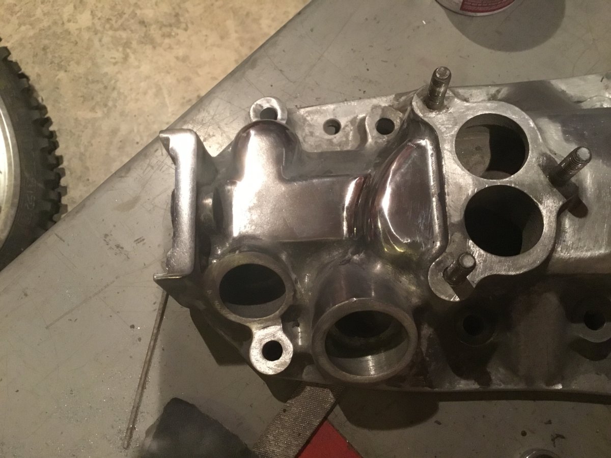

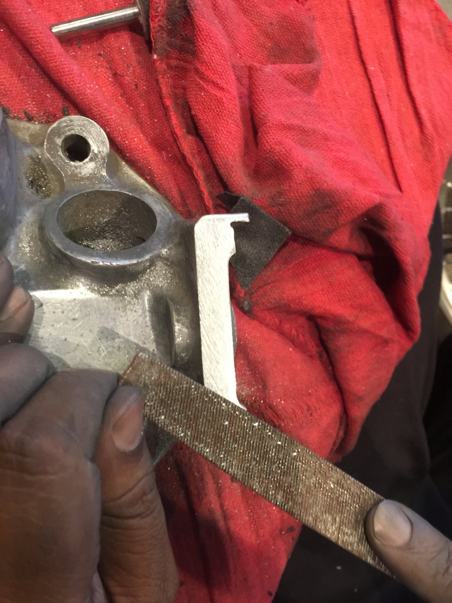

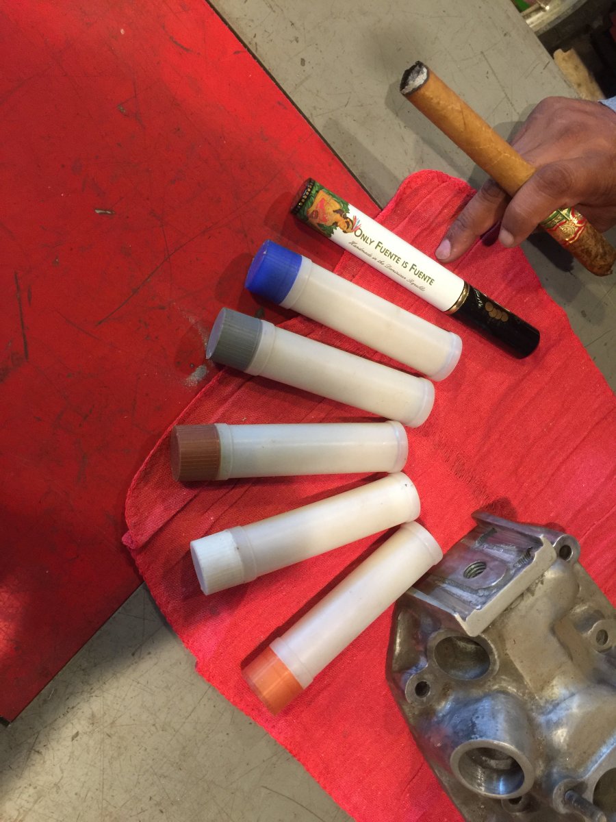

    pennafxu
    from Kentucky
    139E41FB-2A20-4D48-B419-3482DD553AF7.jpeg 5AA81756-8DC8-48BC-8F7B-99F049A0E254.jpeg 6F4F61DA-18A0-4821-8C20-C7104D680D9C.jpeg 42CEB9DB-2E69-440C-B80D-E724C6990ED0.jpeg D8546508-53CA-4EED-85D3-6AB76055ED59.jpeg DE57365B-2C00-40B6-B16F-1A3C716C2F2D.jpeg 9EE33E9A-04CF-4B40-80C0-82127CB6E5AD.jpeg 46D6C6FF-43BE-46A6-8995-C4E626160838.jpeg Yes it’s been two years... Will dip my toes in easy with some polishing...
