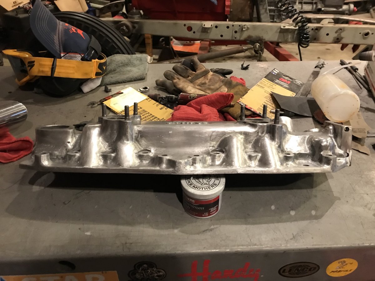

  3. pennafxu
    Joined: Aug 20, 2010
    Posts: 2,263
    pennafxu
    from Kentucky

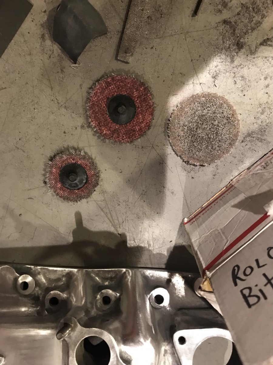

    So back to polishing...
    Always have a plan in mind and the correct tools.
    This is an older piece so I don’t wish to remove too much material. I can get away with a pretty nice luster with very minimal pitting... I could work it for years for perfection but it’s not that important
    daddio211 likes this.

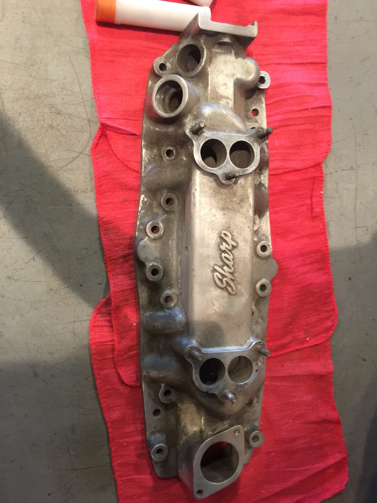

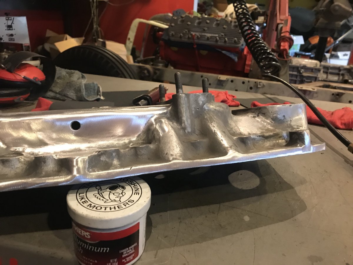

  4. pennafxu
    Posts: 2,263
    pennafxu
    from Kentucky

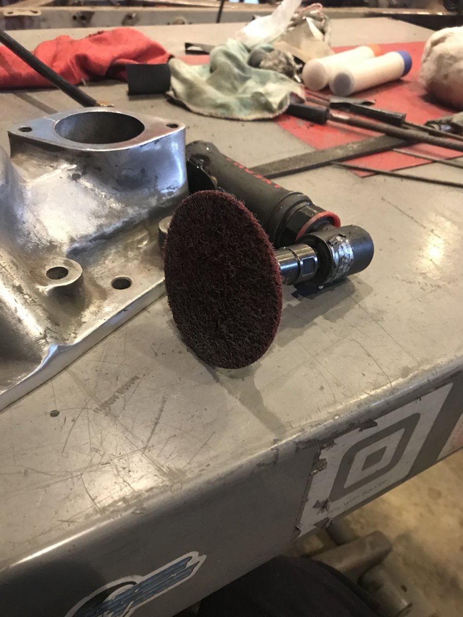

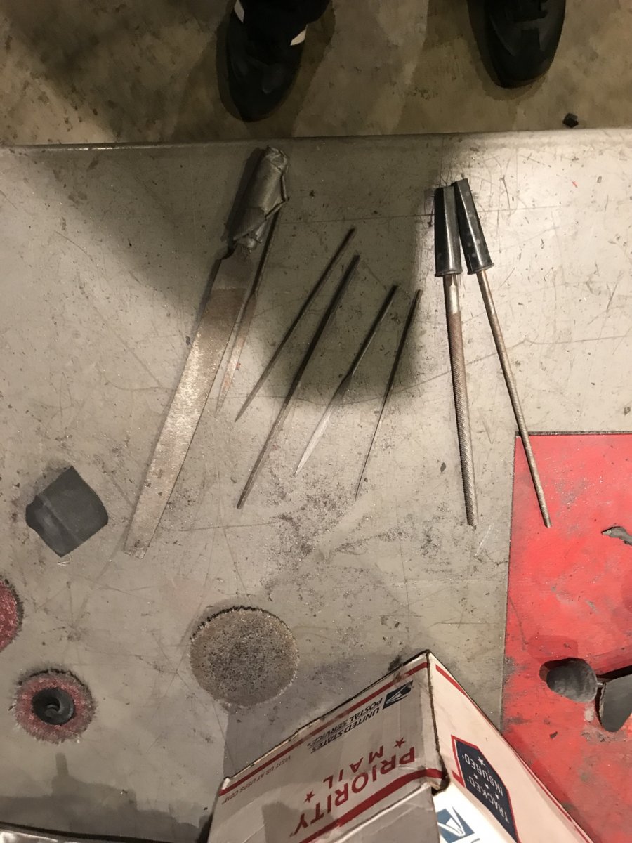

    I use the files to knock off the major casting flash... I prefer to use air and roloc scotch brites proceeding very cautiously... I don’t like paper disks as they catch on every edge... IMG_0938.JPG IMG_0946.JPG

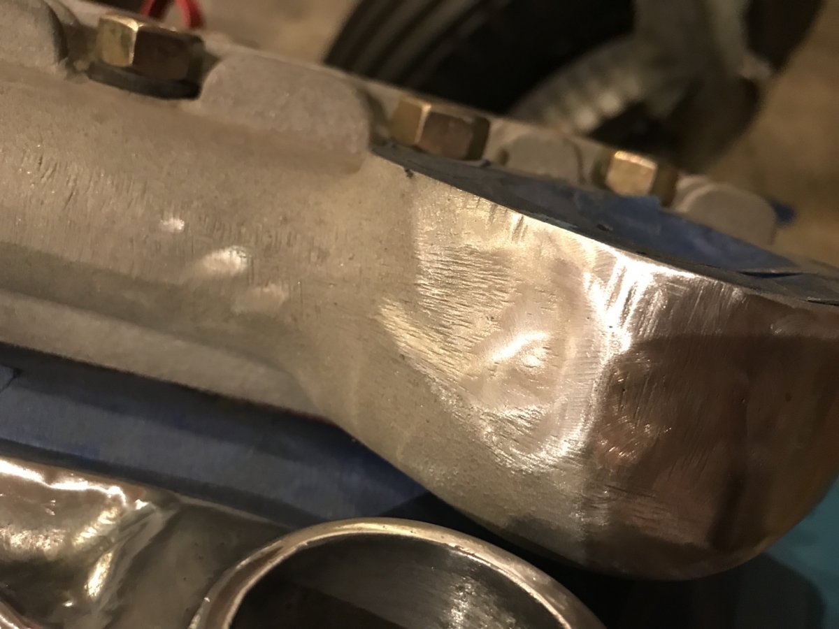

  5. pennafxu
    Posts: 2,263
    pennafxu
    from Kentucky
    Preparation is everything... you need to get up to 1500-2000. Because polishing a dog turd still leaves you with a dog turd
    Oxidation is hard to remove manually... the nearer hole needs working

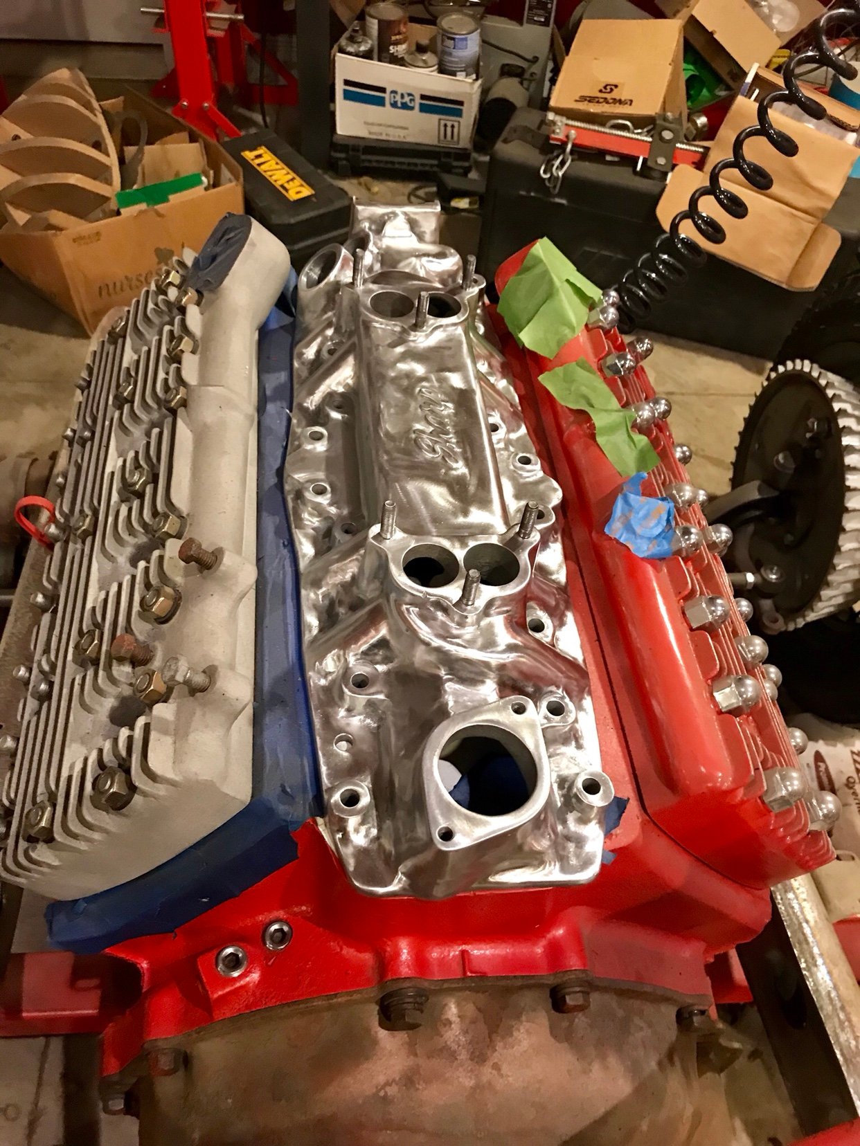

    I worked some more on the intake today with fine 3” roloc disks. It’s looking really nice... I need to hit the other side then go over it with the very fine disks... [​IMG][​IMG][​IMG]

    90% of the pits and rough areas have been vanquished. The last 10% needs to be done by hand going through the different grades up to 2000. The disks don’t fit in all the tight spaces also.[​IMG][​IMG]

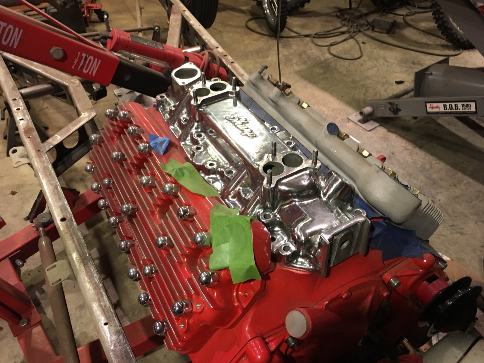

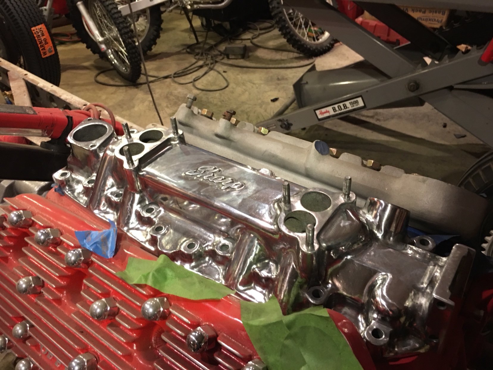

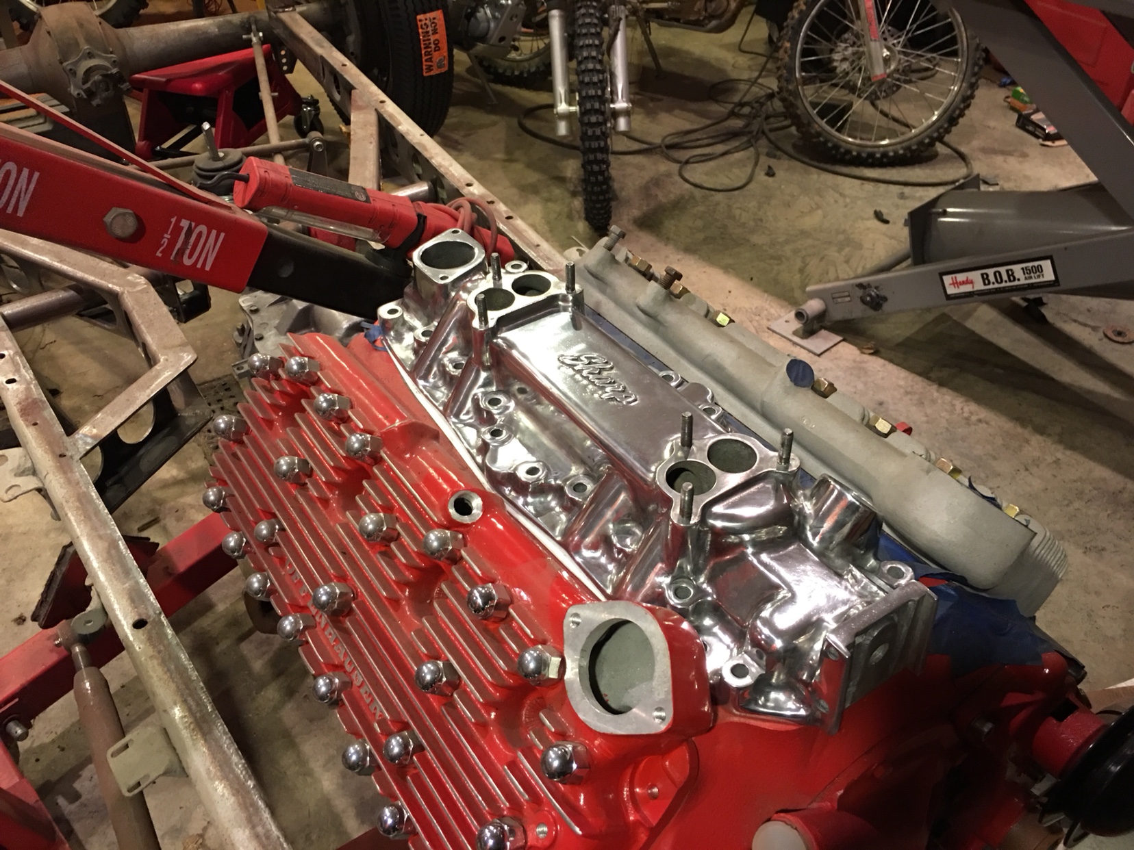

    I couldn’t resist a test fit![​IMG][​IMG][​IMG][​IMG]
    This is not bad for how unfinished this part is... it will look like chrome when fully show polished. I will shoot a protective clear over it. I also need to order the mounting bolts in stainless.

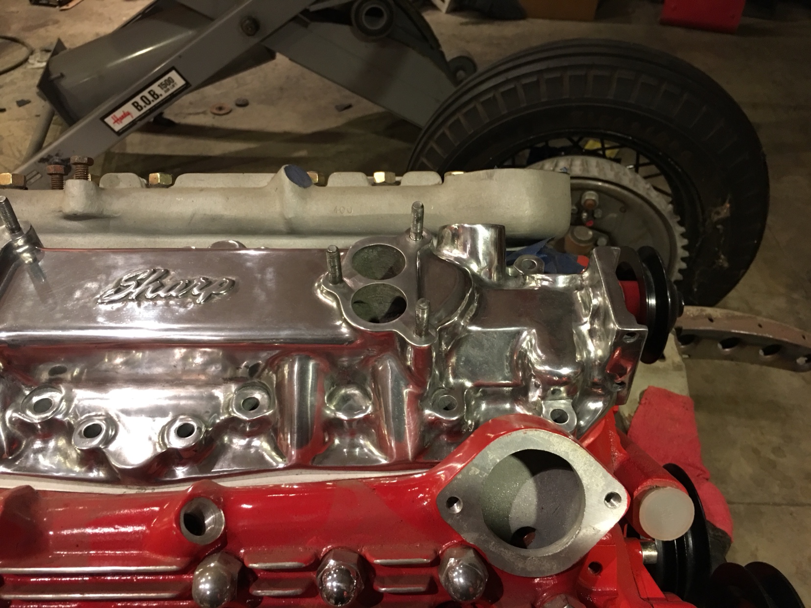

  23. pennafxu
    Posts: 2,263
    pennafxu
    from Kentucky

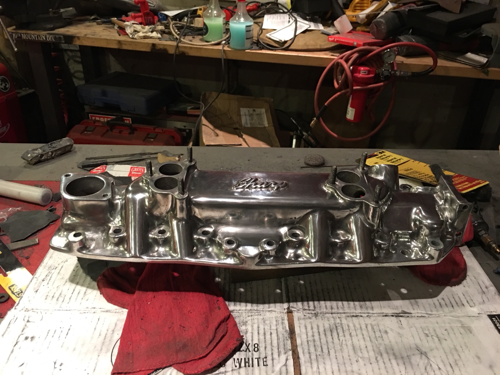

  25. pennafxu
    Posts: 2,263
    pennafxu
    from Kentucky

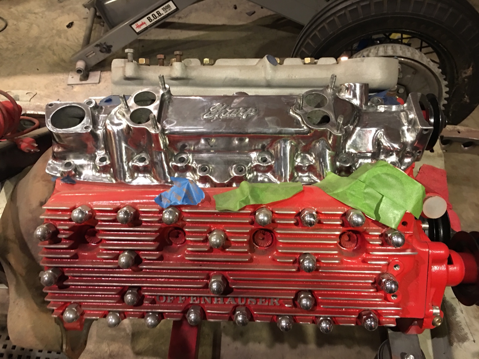

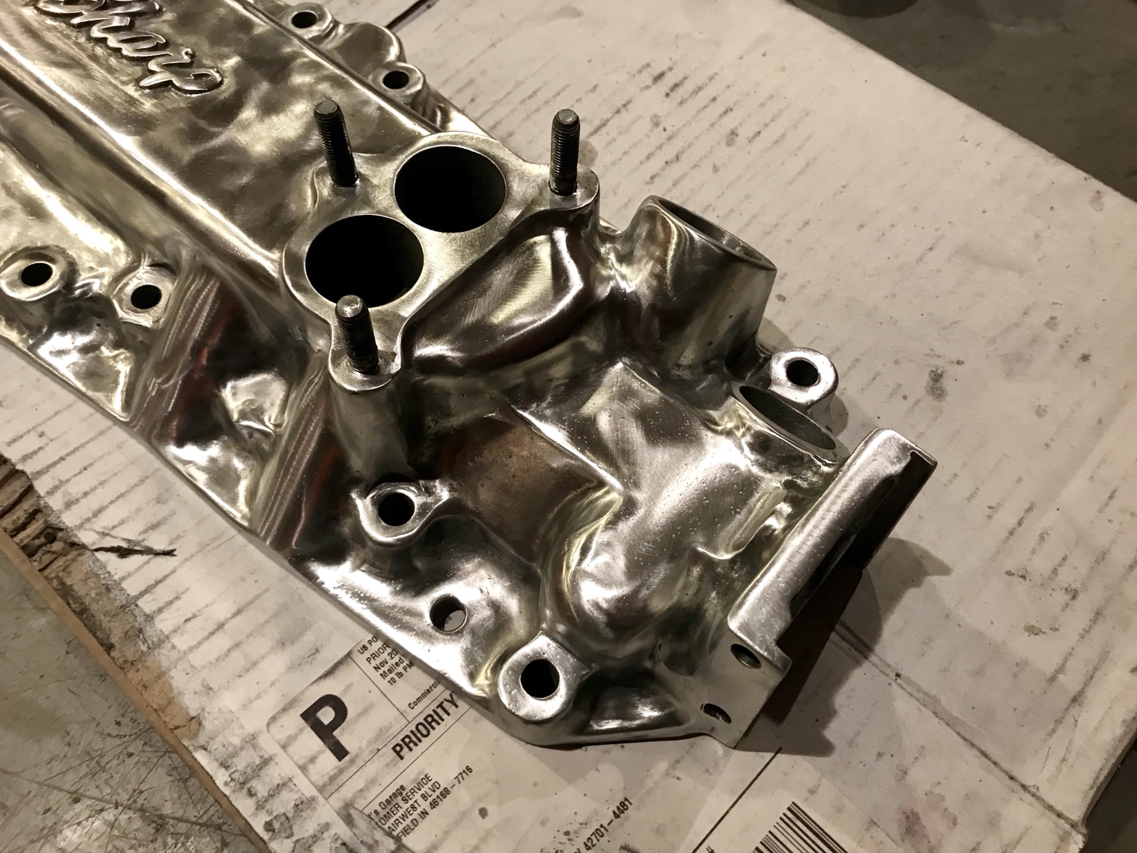

    Ok Guys,

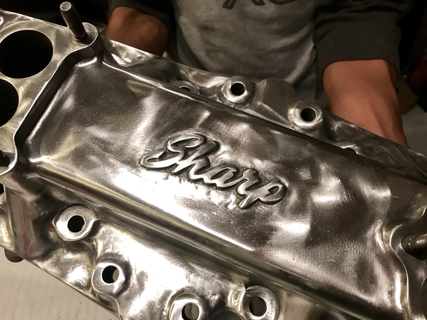

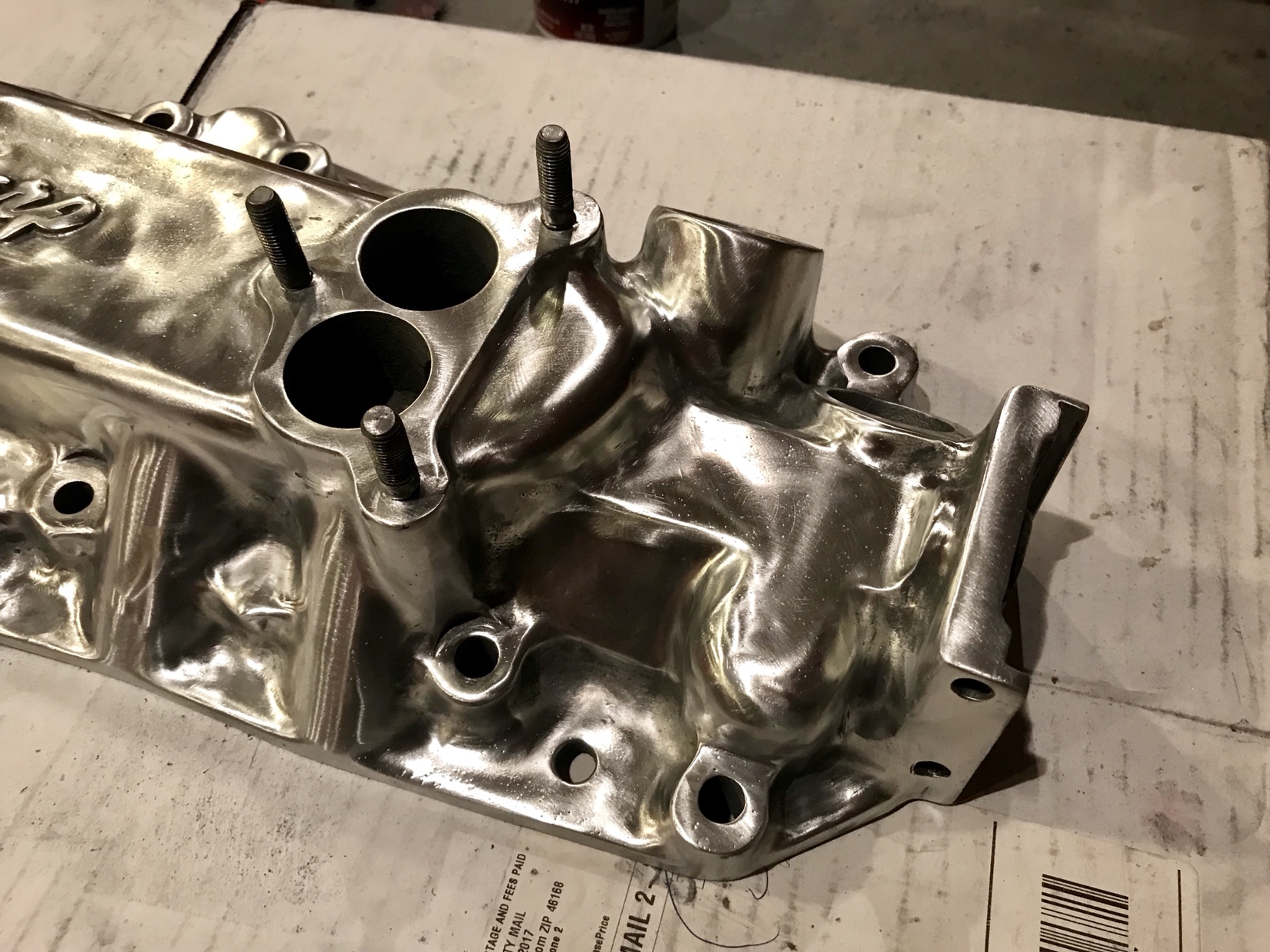

    Bling level 10 achieved! (Or as far as I’m gonna take it anyways) you can see the reflections in the polished aluminum...[​IMG][​IMG][​IMG][​IMG][​IMG]
    patmanta and daddio211 like this.

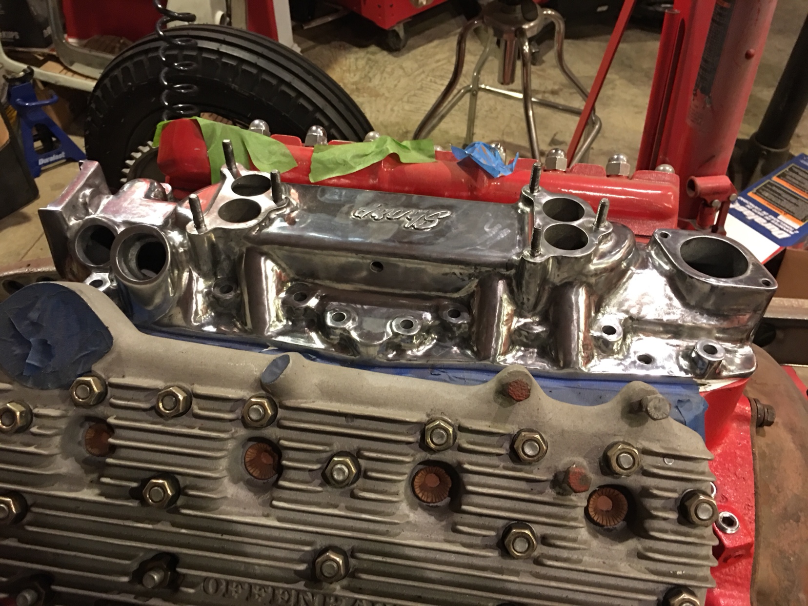

    Final comparison time... That is a big difference in my opinion. I think I’m going to paint the other side of the engine next...
    [​IMG][​IMG]

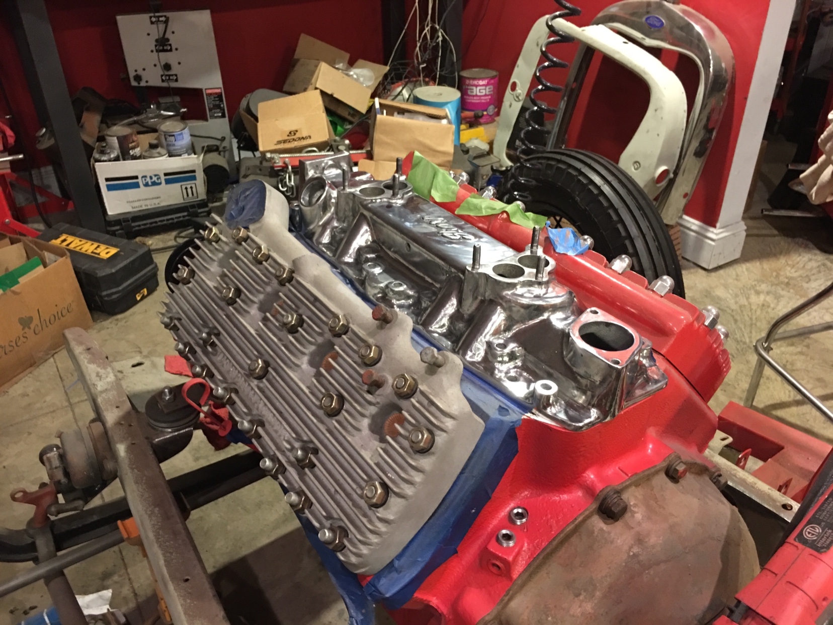

  27. pennafxu
    Posts: 2,263
    pennafxu
    from Kentucky

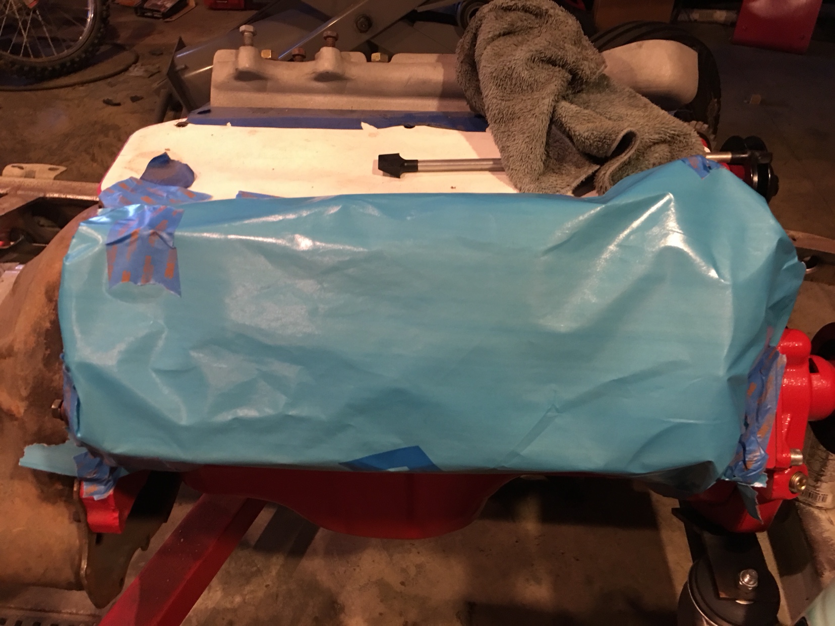

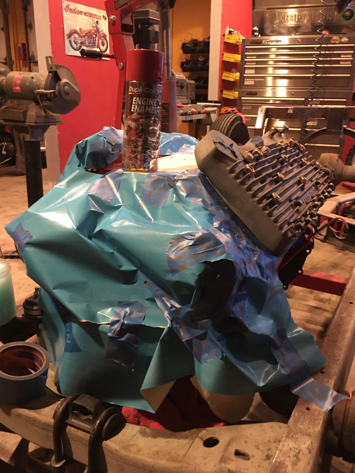

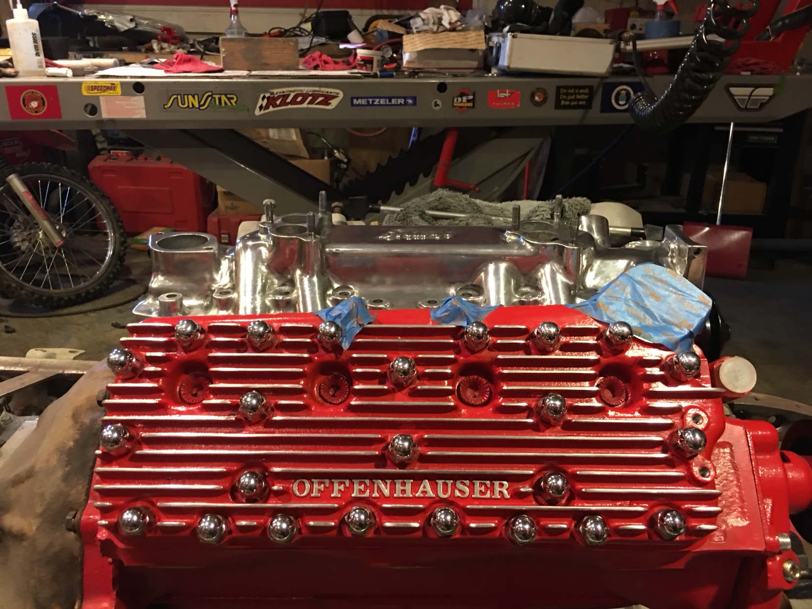

    Getting the opposite head covered to protect against overspray...
    [​IMG][​IMG][​IMG]

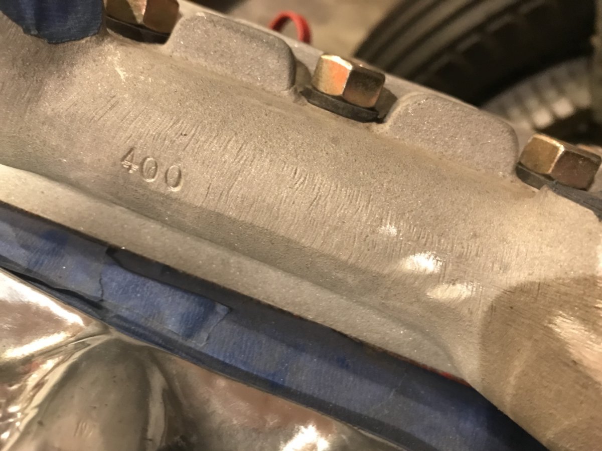

    Gonna use the very fine disk
  29. pennafxu
    Posts: 2,263
    pennafxu
    from Kentucky
    Switched back and forth between medium, fine and very fine...
    About 15% done...
