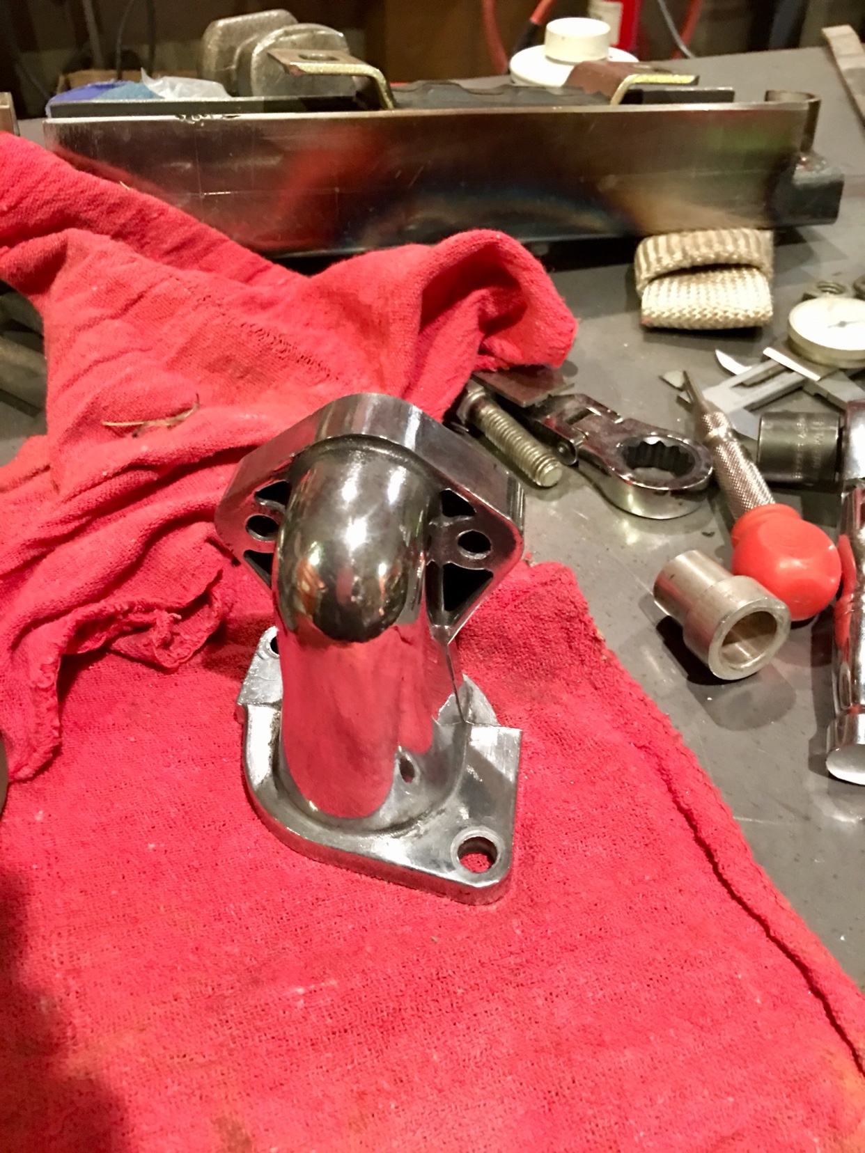

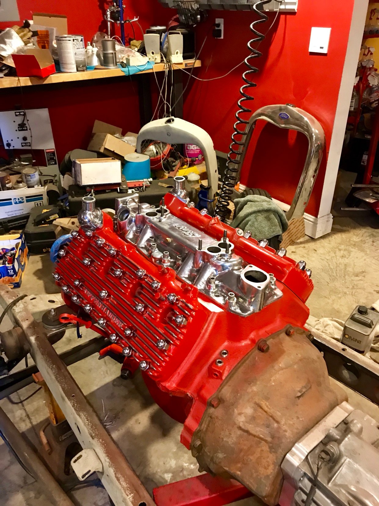

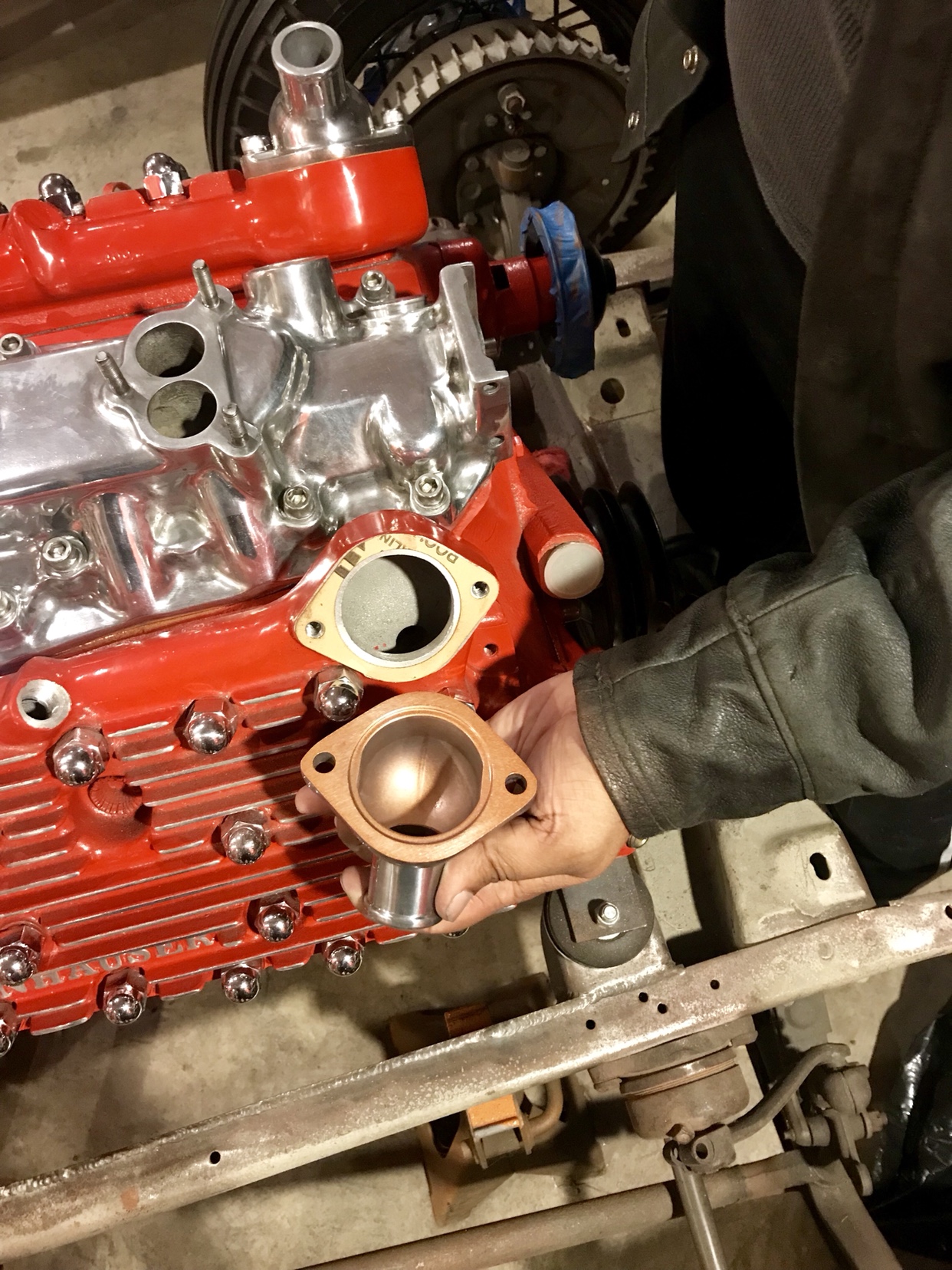

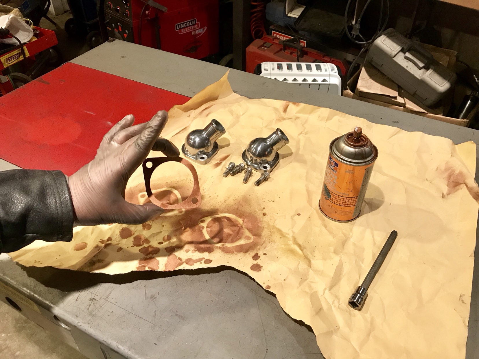

    Finally put the water necks on for good, forgot to put in the thermostats! Took off the necks and finally torqued them to 20ft-lbs...
    [​IMG][​IMG][​IMG][​IMG][​IMG]

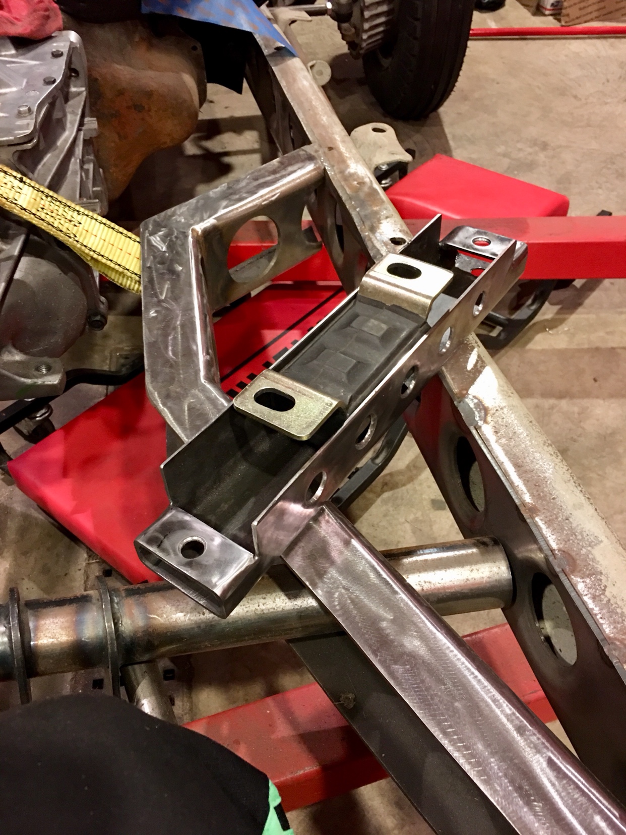

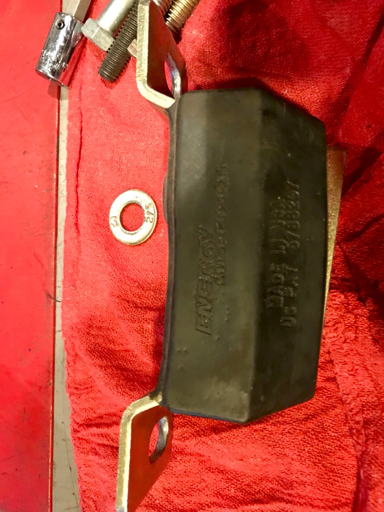

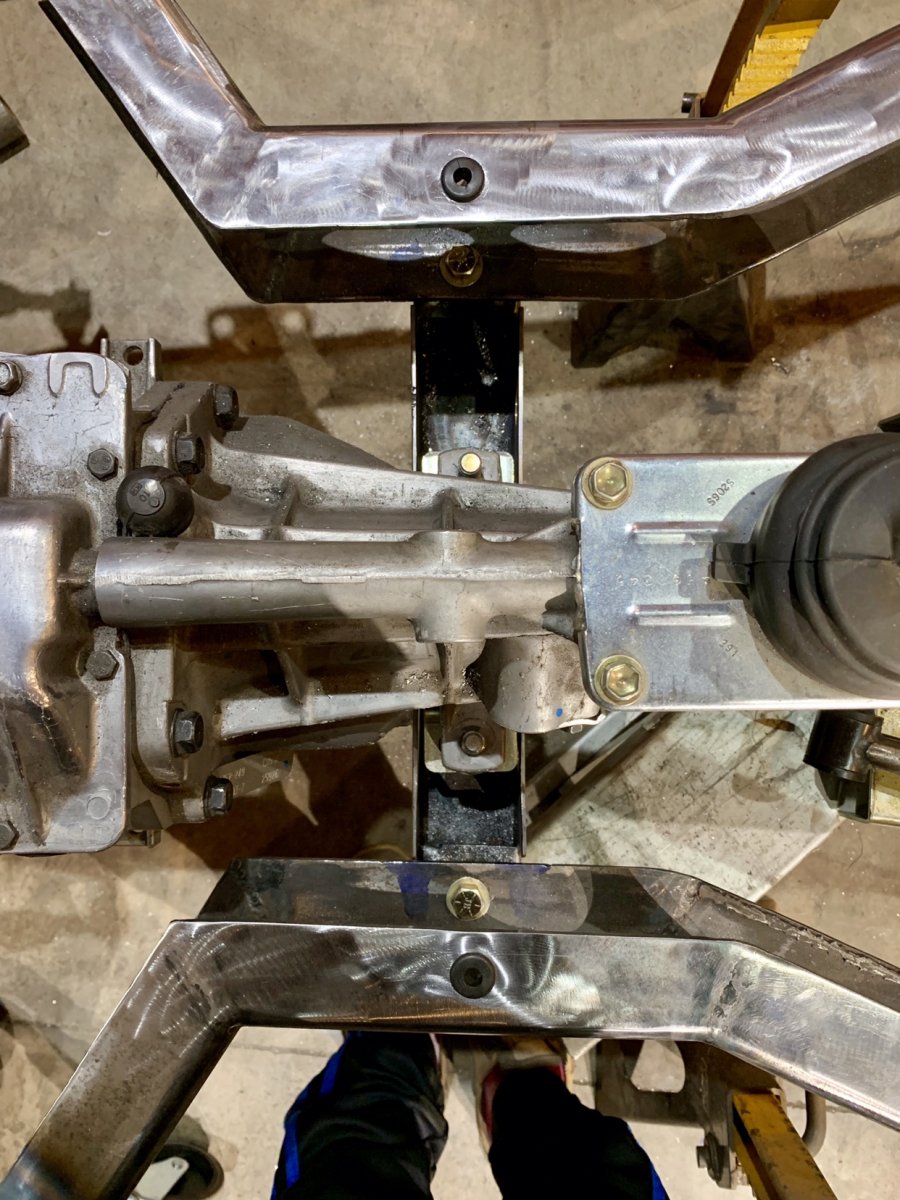

    On to the transmission cross member...
    The rubber mount takes 3 bolts... it was however ****ed to one side, so I took it off the tail housing
    [​IMG][​IMG][​IMG]
    I used the vise to press the metal back in place
    [​IMG][​IMG][​IMG]

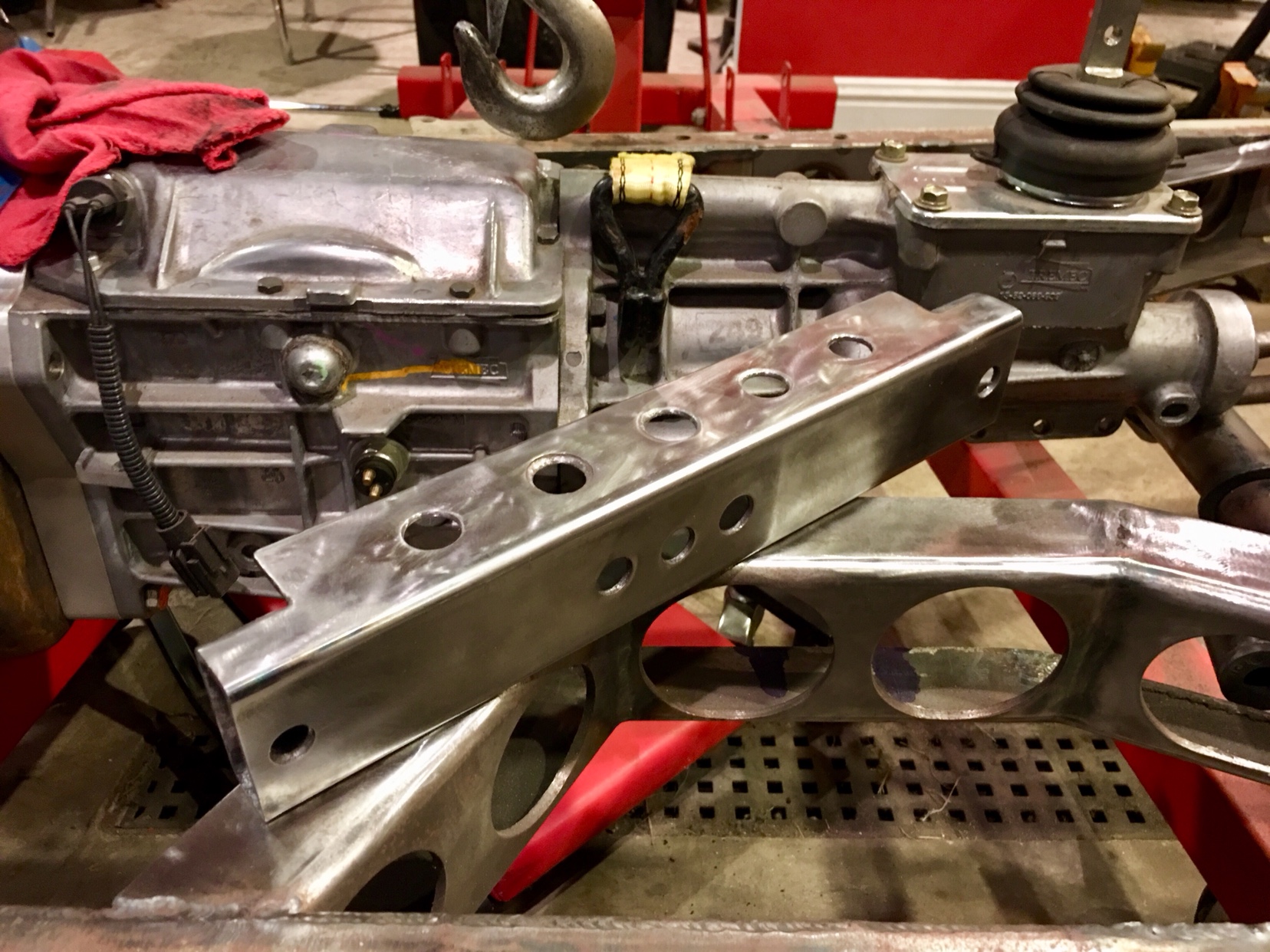

    I measured various points on my x-member
    [​IMG][​IMG]
    [​IMG][​IMG]
    16 1/8”
    [​IMG][​IMG][​IMG]

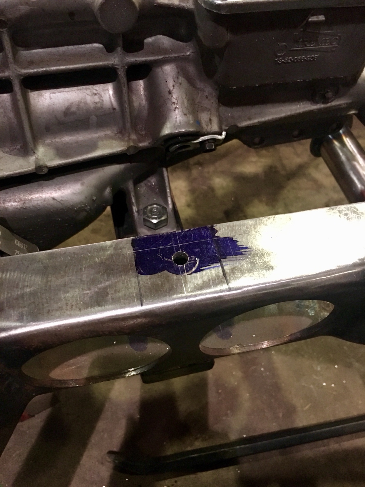

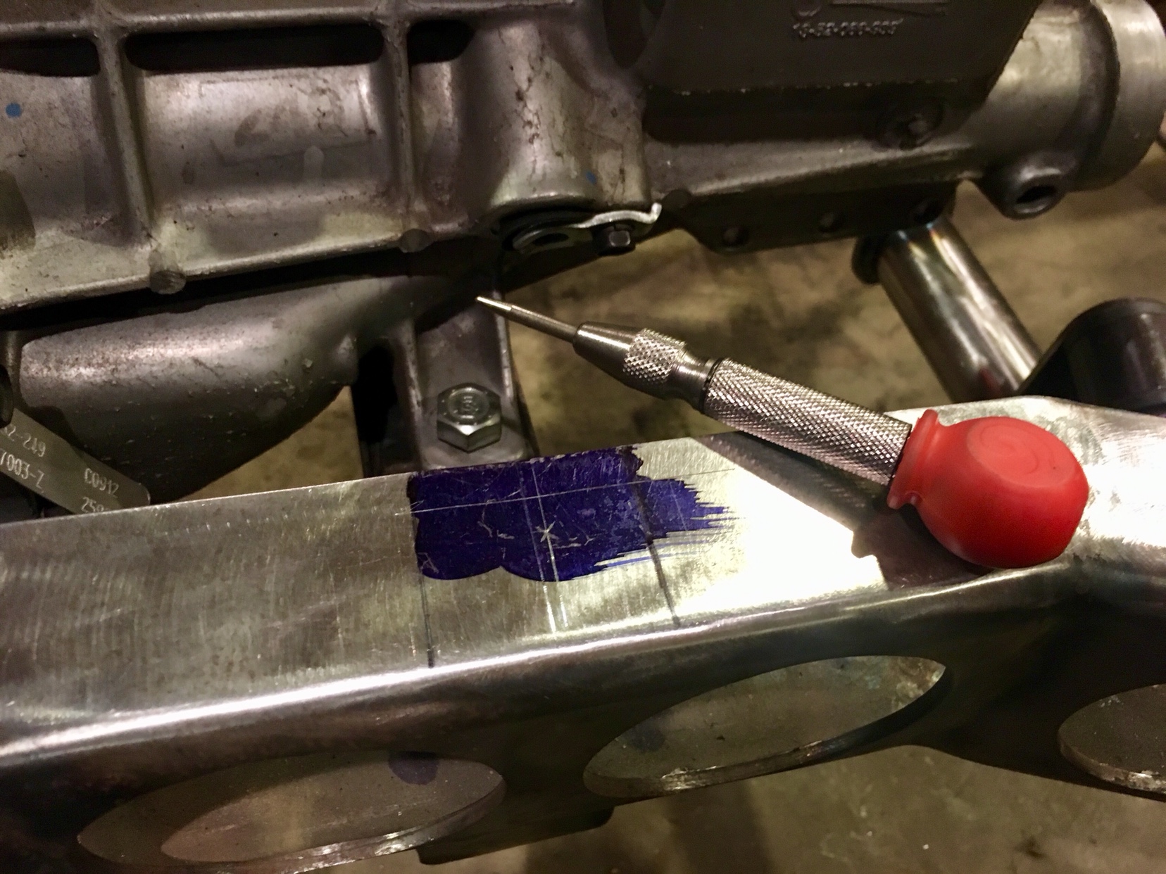

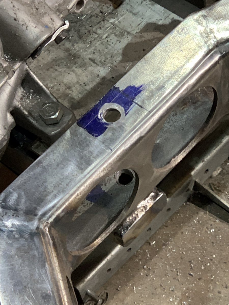

    Next task was to lay down some scribe lines for my cuts...[​IMG][​IMG][​IMG]
    I used the band saw on this for a clean cut
    I then laid out the marks for the three holes...
    [​IMG][​IMG]

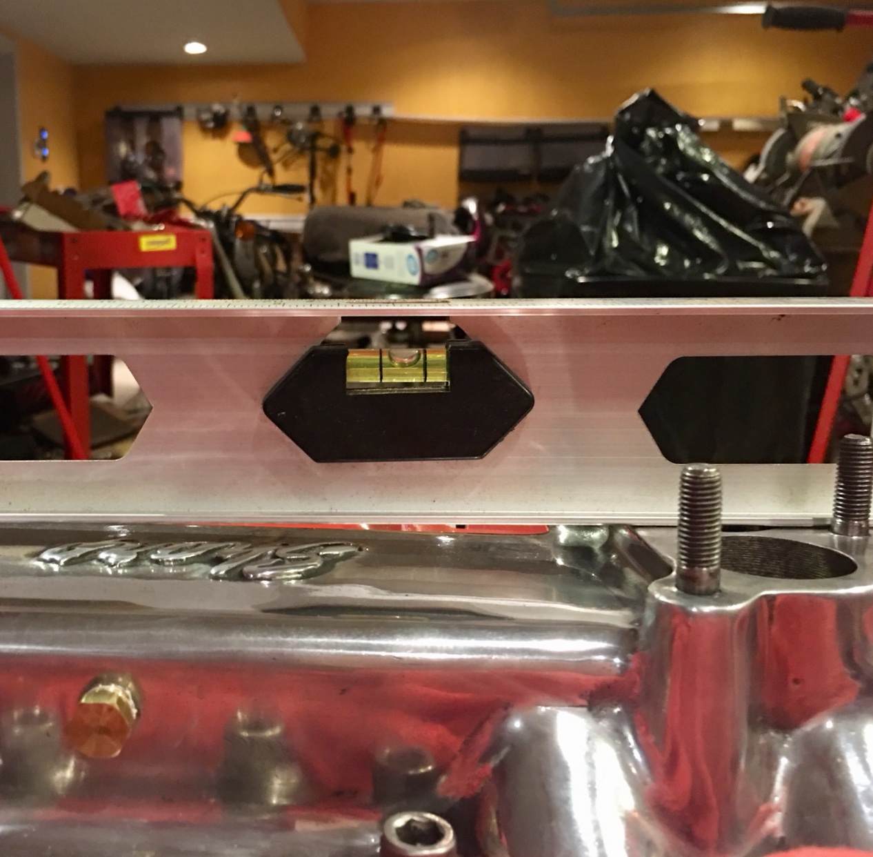

    Carb surface is zeroed out with car under its own weight sans body...
    It’s tricky trying to find out the trans pinion angle as there isn’t much real estate to attach my angle finder to, and it’s aluminum. I’m going to attach the pinion u-joint and hopefully measure from that.

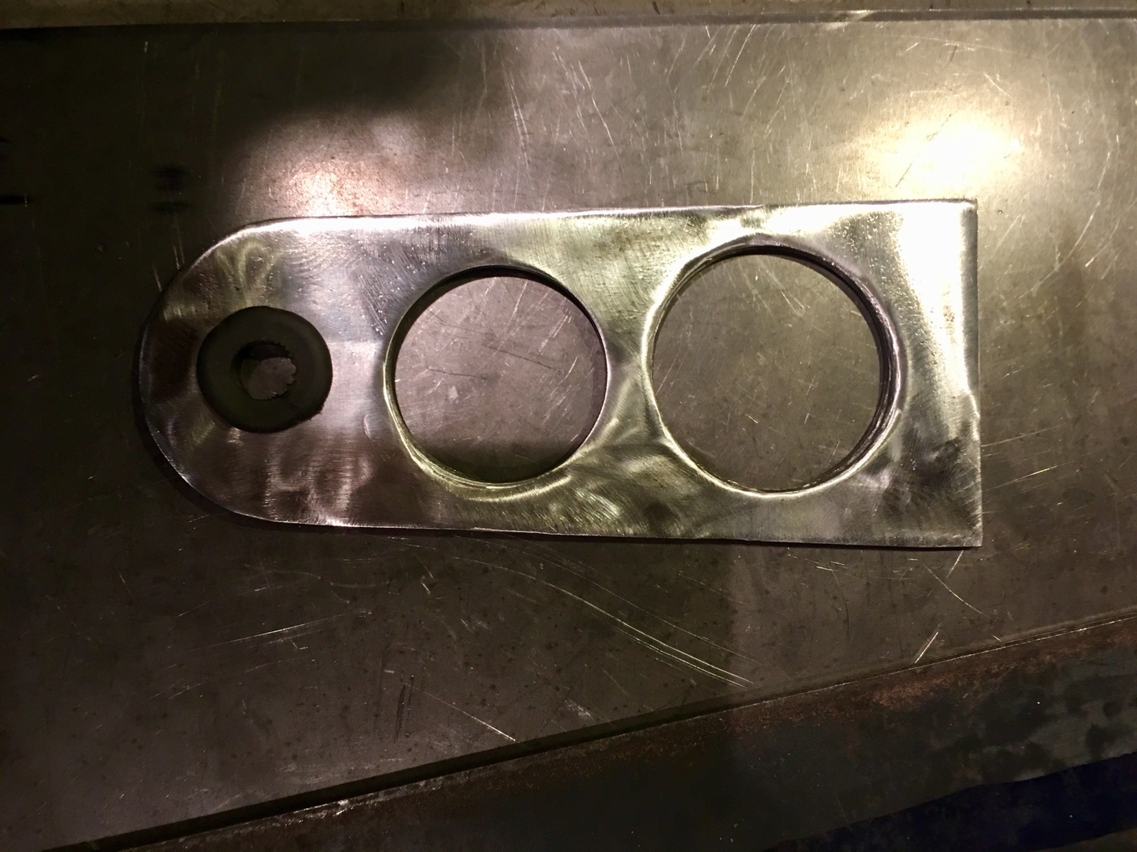

    from Kentucky

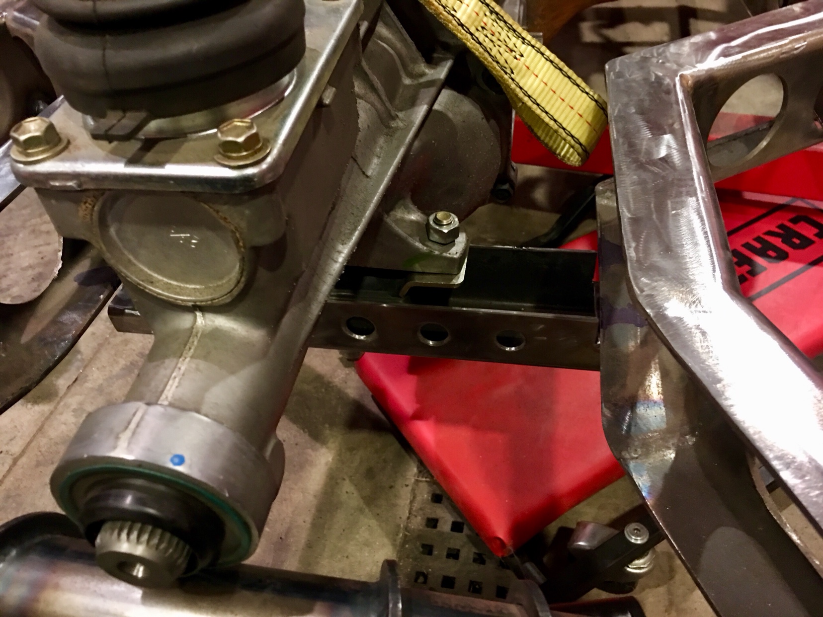

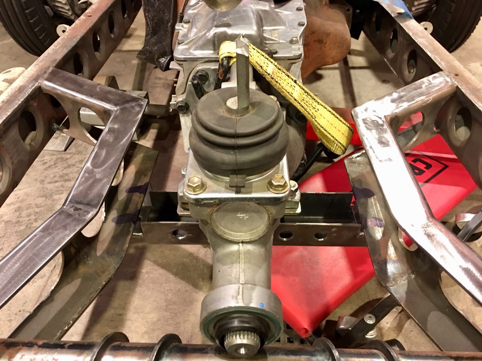

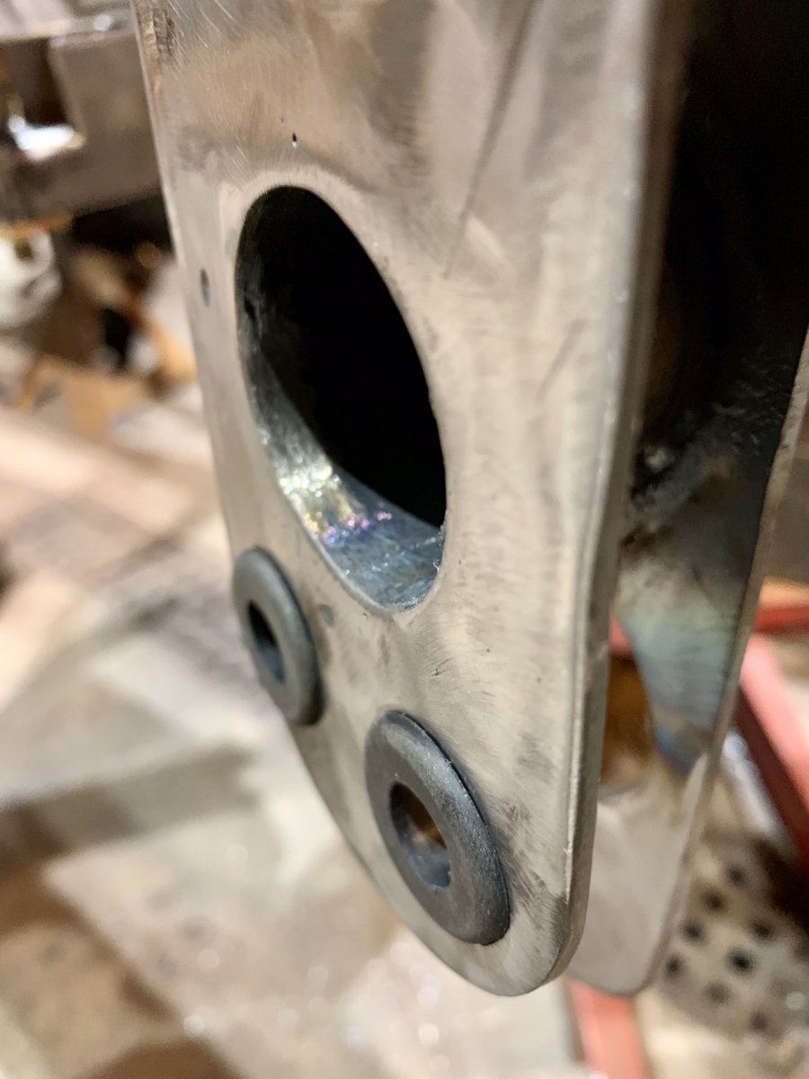

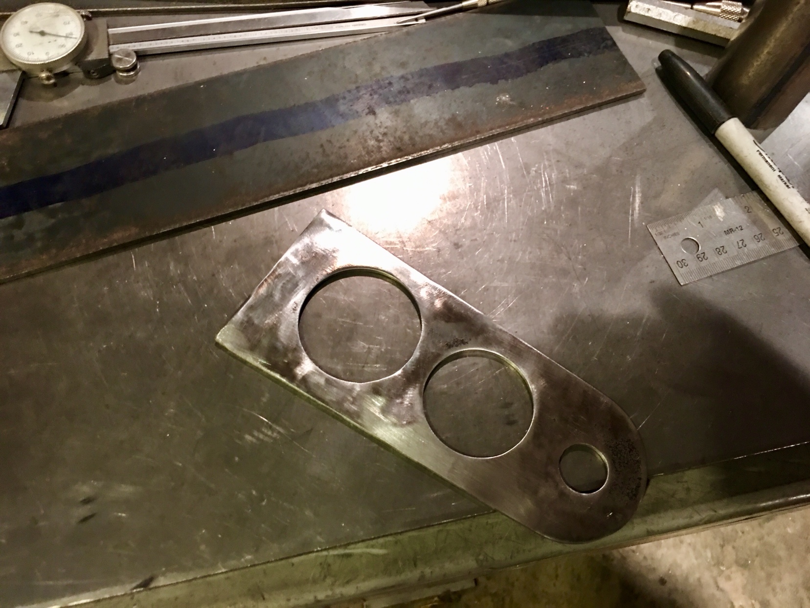

    Worked for about 5 hrs on the cross mount...
    Punched a couple lightning holes...
    Cut down the edges and welded them up...
    Rubber mount fits in nicely
    Need to drill through the side cross members to bolt the “removable” crossmember... This will aid in any future work that might be needed on the trans without having to pull the body.

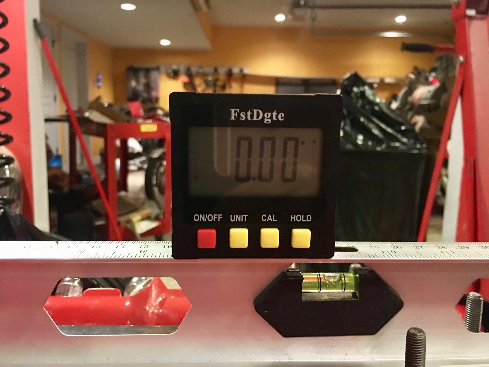

    Trans rear spline Angle is 1.2deg[​IMG]
    This is a shot of the final setup... now I need to focus on the rear end... [​IMG]
    Making sure the rear diff yolk is zeroed out... I will then set the rear end at 1.2deg and then tack weld the ladder bars...

    Rechecked zero once again [​IMG]
    Off by 3.6deg
    [​IMG][​IMG]
    The green arrows demarcate where material needs to be removed so the rear angle can be dropped

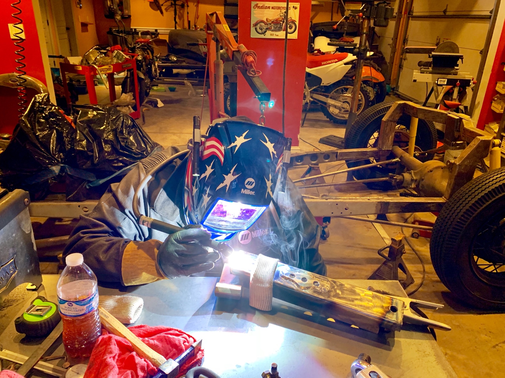

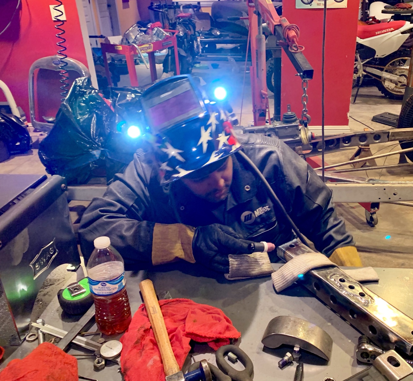

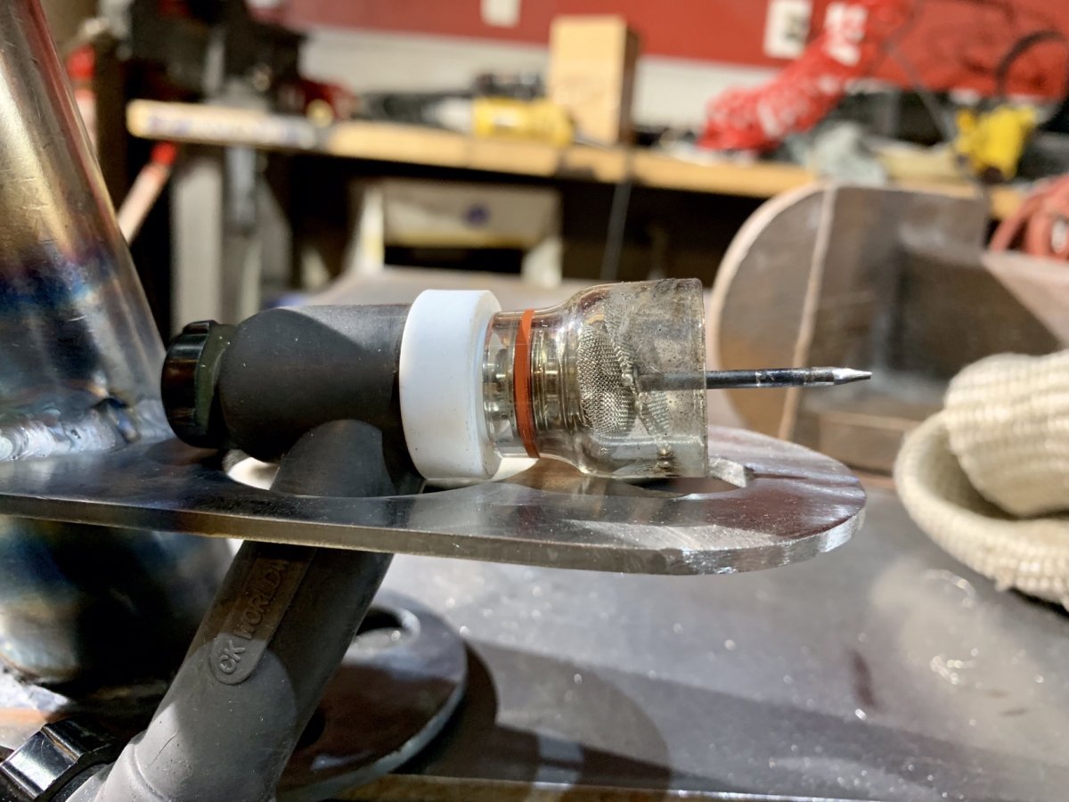

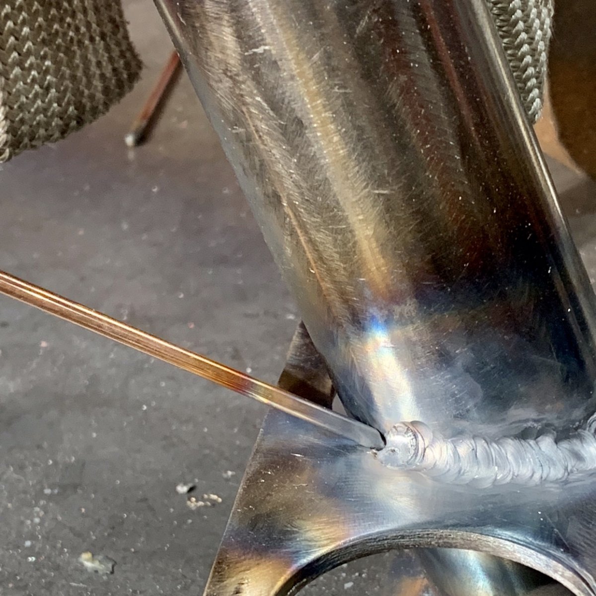

    Next I had an issue with spacing on my transmission mount. I needed to raise the area by 1/8”. So instead of using individual spacers I came up with another solution. [​IMG][​IMG] I used the cut section from the bolts to hold this piece in place for tack welds...[​IMG] I then zipped it up [​IMG][​IMG]Here you can see where the bolts are now taken up...[​IMG]
    Welding is a perishable skill, and this was more of an exercise in getting back on the bicycle. I have miles of welding ahead of me but the more you do it the better you get!

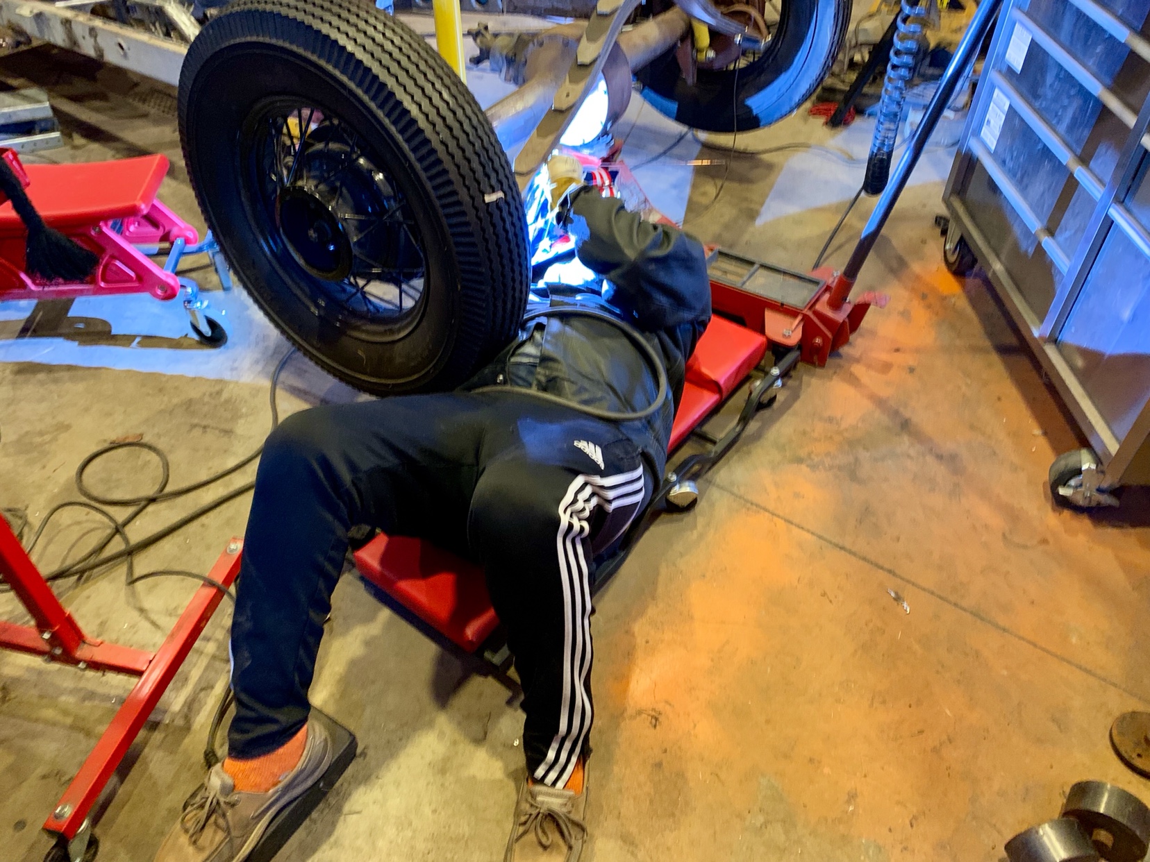

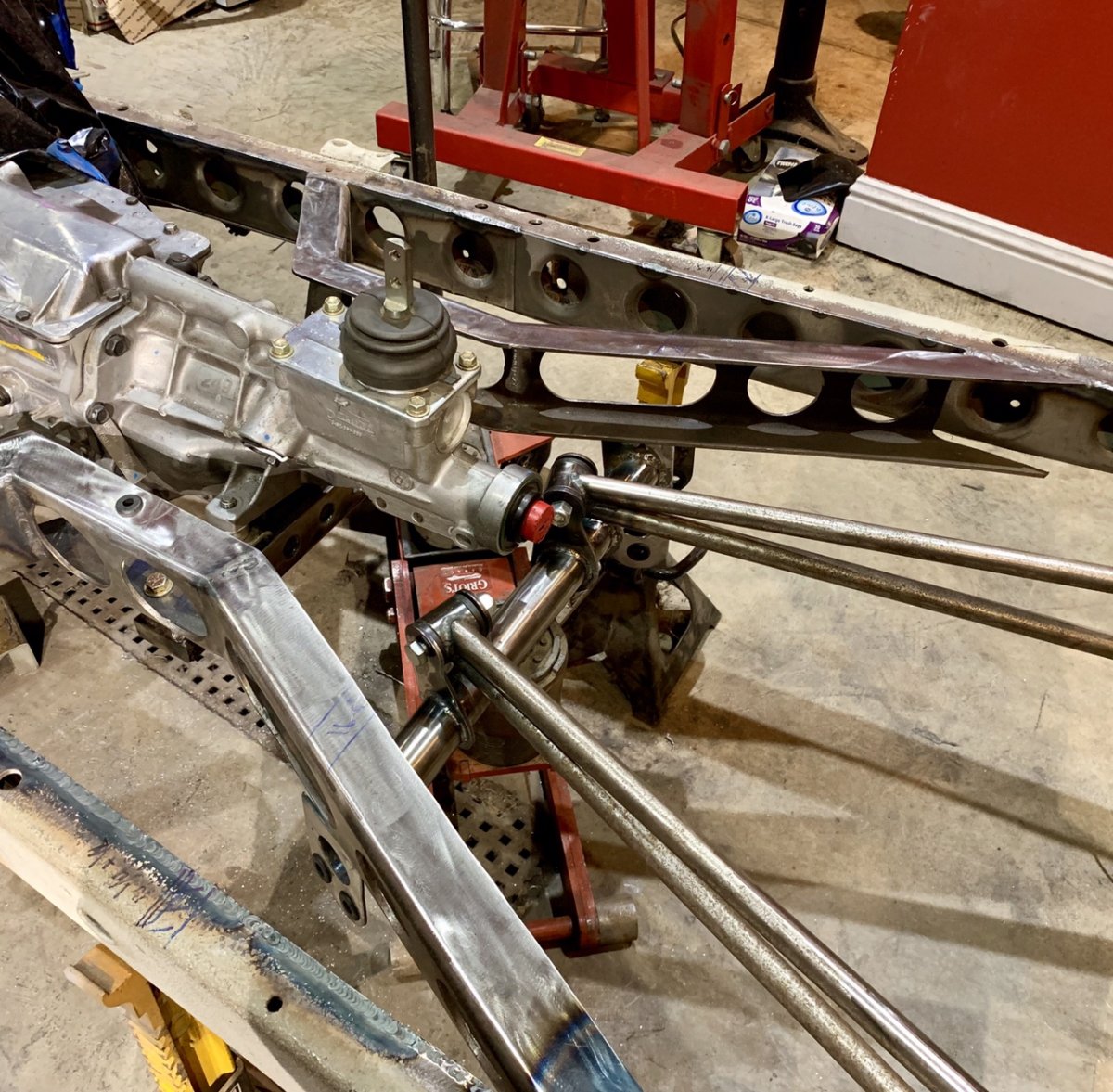

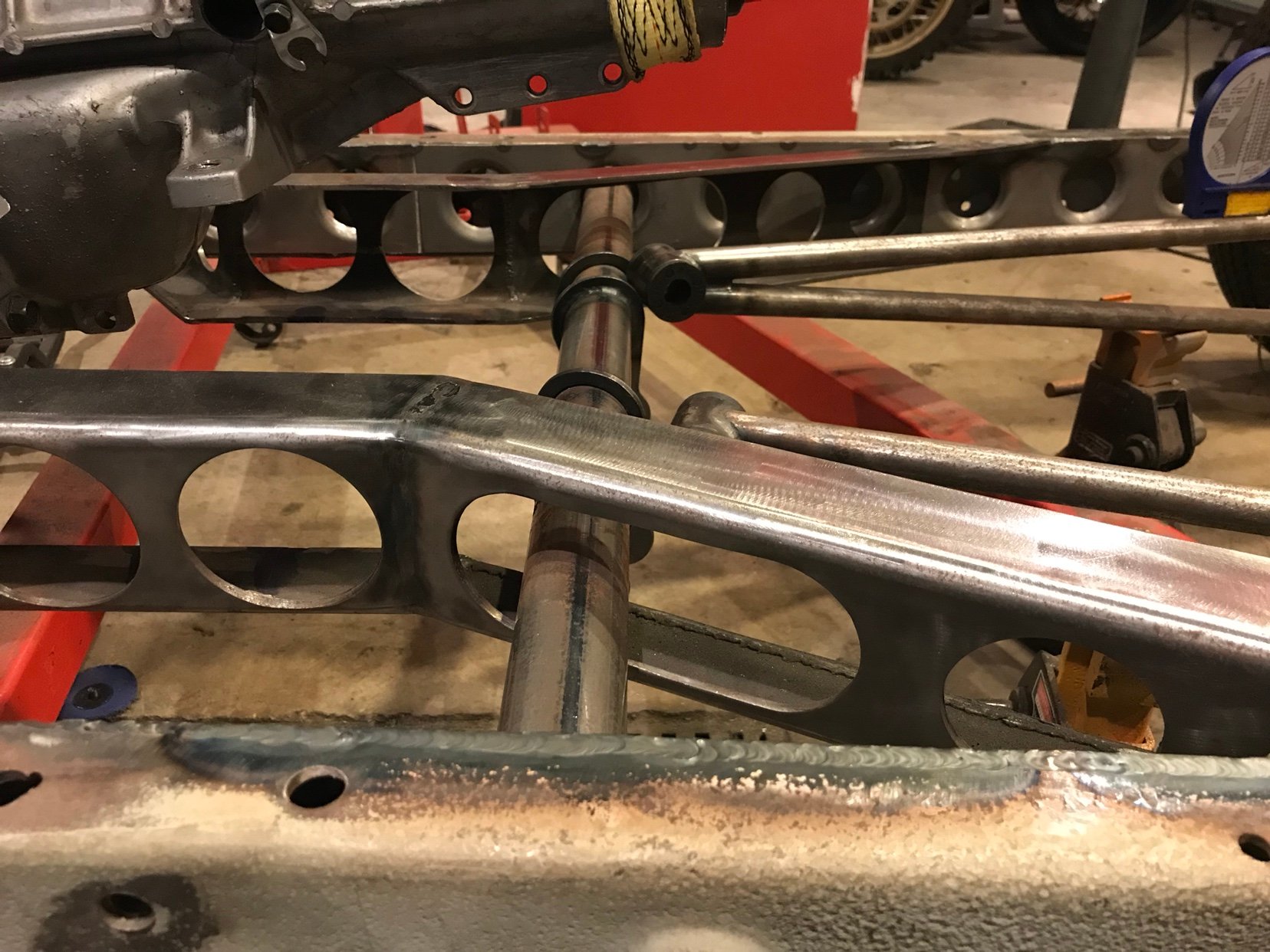

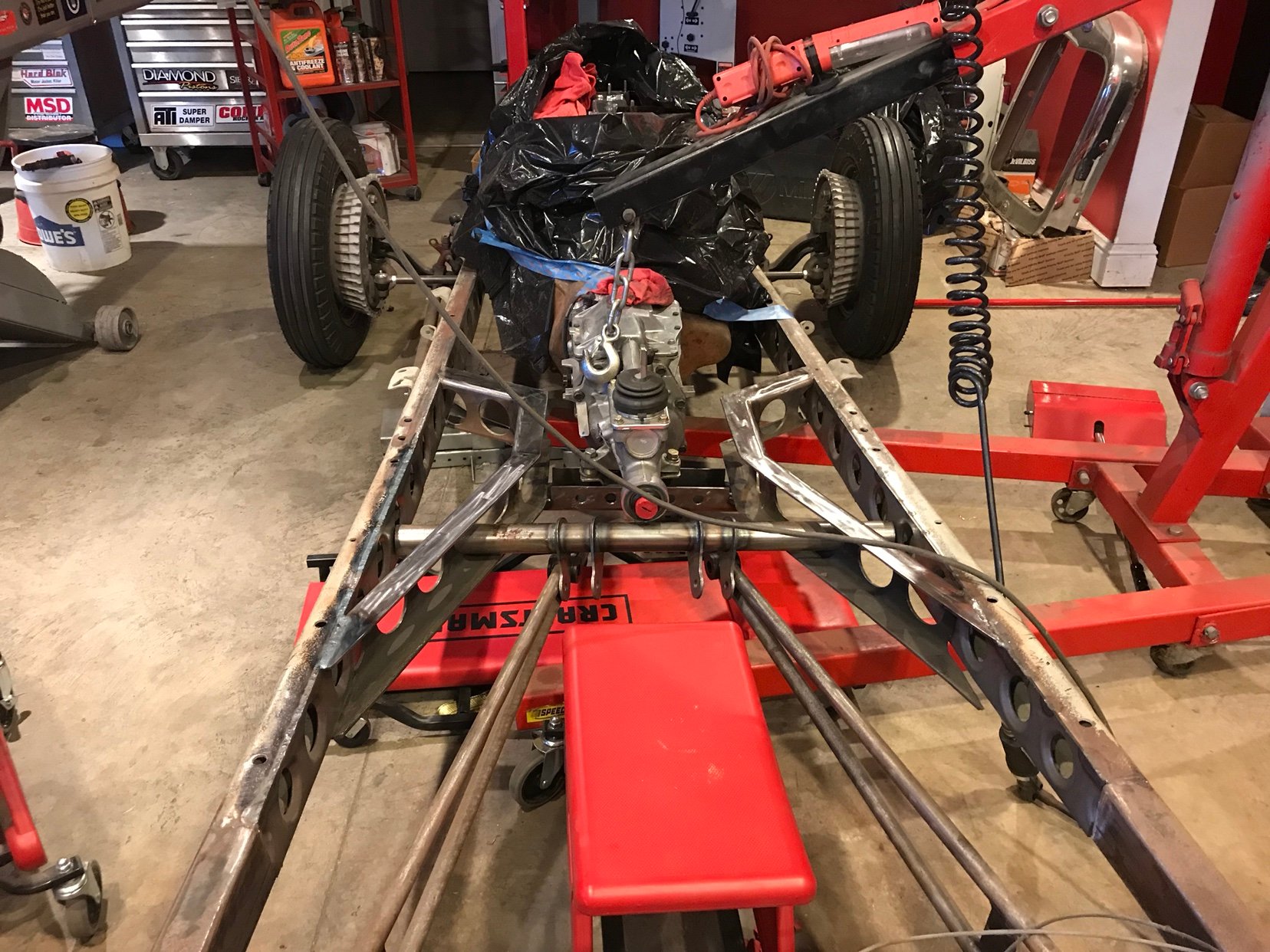

    Tackling the rear ladder bars and anti-squat setup
    The rear end will not handle well like this as the ladder bars are actually pointing down. Elevating the ladder bars to get them at zero would increase my pinion yolk angle to 15deg. Neutral or slightly upward is the preferred angle for ladder bars per my reading. [​IMG] So we got to cutting tack welds and cleaning the area to set the angles and re-tack [​IMG][​IMG][​IMG][​IMG][​IMG]
    Everything was set in place and tacked up again...
    I re-checked the angles once again [​IMG][​IMG]
    Both sides looked good
    Now I need to set the yolk angle with the center cross member.[​IMG]
    I added one of my tags to the transmission mount... [​IMG][​IMG] I welded an area around the oval and riveted it down... I think I’m going to do this to all my major parts with a part number stamped on the piece that will be linked to a parts diagram and digital manual for future reference.
    Stogy and patmanta like this.

    [​IMG] Ladder bars tacked at 8.5 deg... [​IMG] Crawling under the rear end is so much fun...[​IMG][​IMG] They are jutting up
    [​IMG] Set back to zero when the axle was rotated forward
    [​IMG] finally the yolk angle was set to 1.5-2 deg by lowering the center mount. [​IMG] It seemed my cigar cases were the perfect spacers to get the yolk angle. Who said smoking’s bad for you! [emoji4] [​IMG][​IMG]
    [​IMG][​IMG]
    Next up is the rear panhard setup, and final welding of the PJ brace to lock in the yolk angle. I also need to drill in the crossmember so the trans cross mount can attach. Stay tuned!

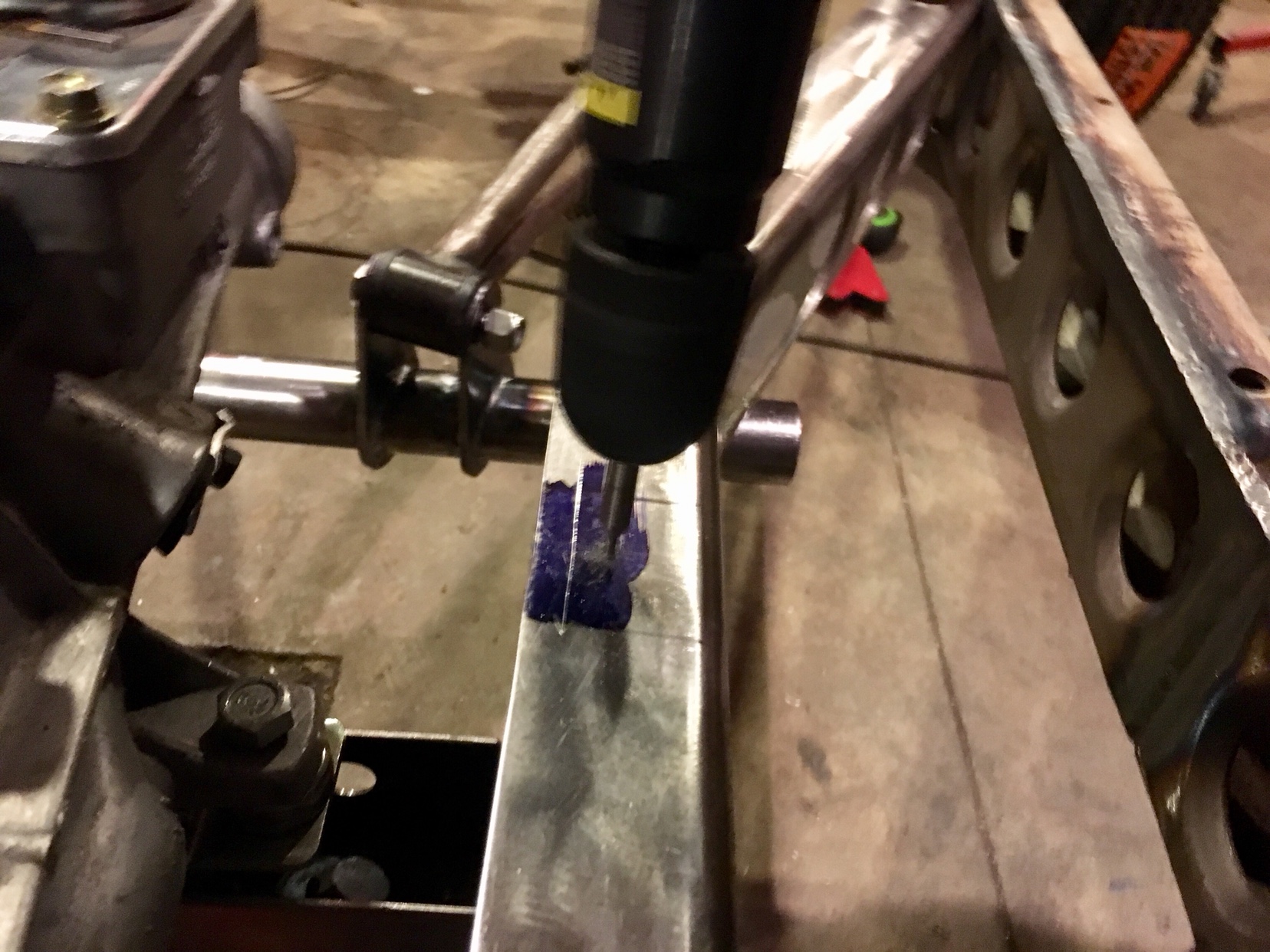

    Drilling side members...

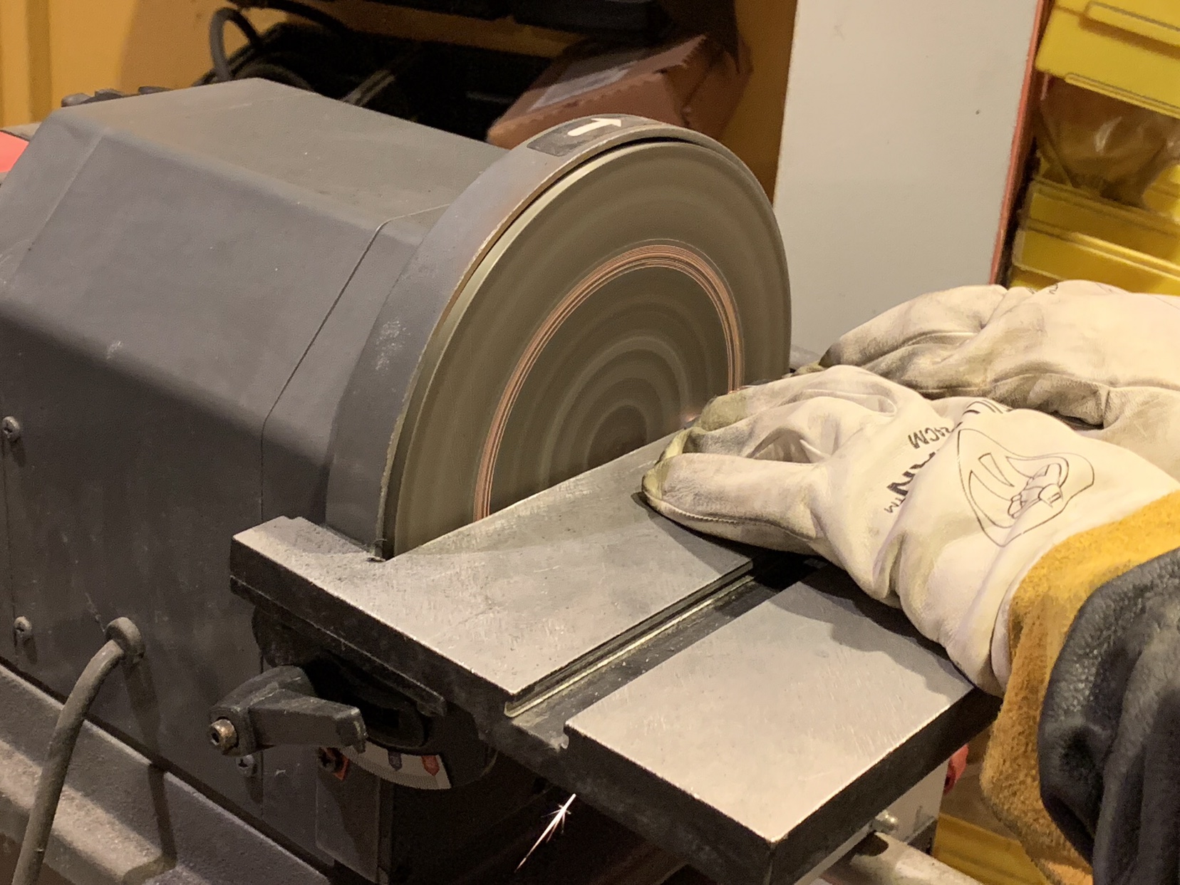

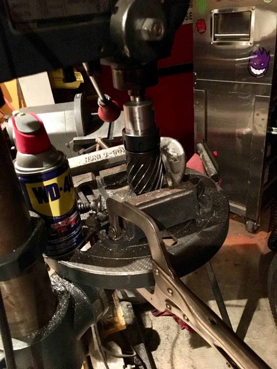

    New measuring tool on my phone
    [​IMG][​IMG]
    Center drill for accuracy
    [​IMG][​IMG][​IMG]
    Unpolished, partially polished and show polished

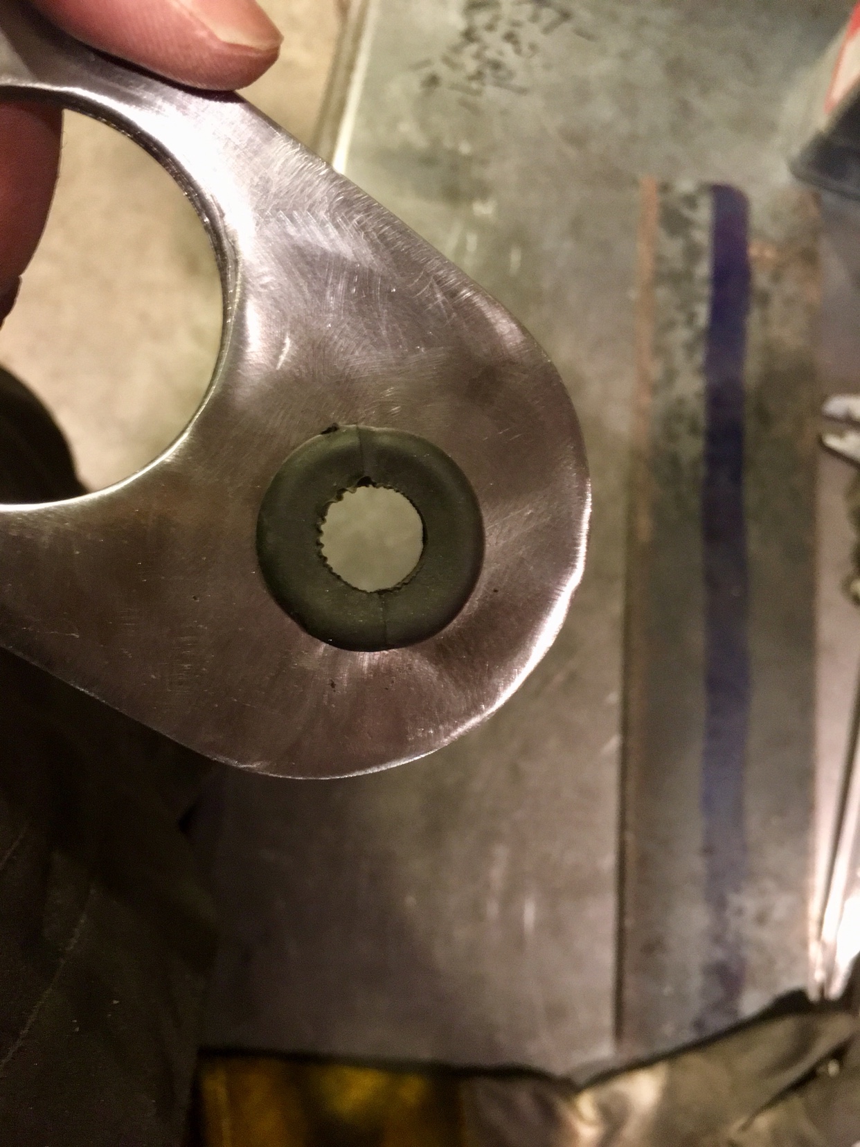

    The rear ladder center mount bracket will double as the exhaust hanger mount... one down three to go...[​IMG]
    Test fit[​IMG]
    This one piece took 3 hrs
    [​IMG][​IMG][​IMG][​IMG]3/4” rubber grommet to receive the hanger
    Stogy likes this.

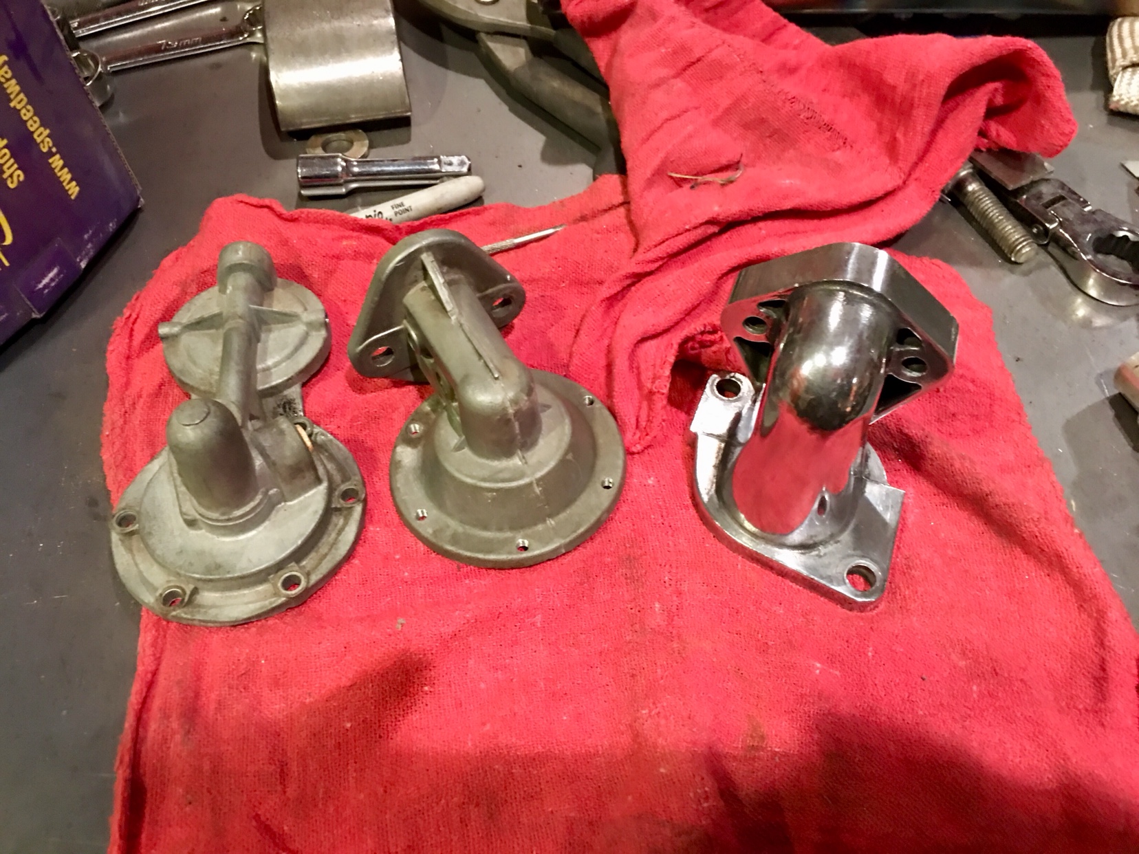

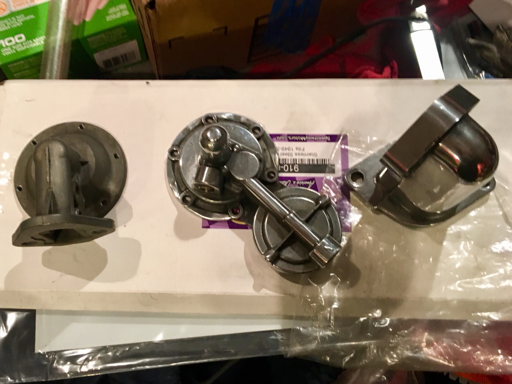

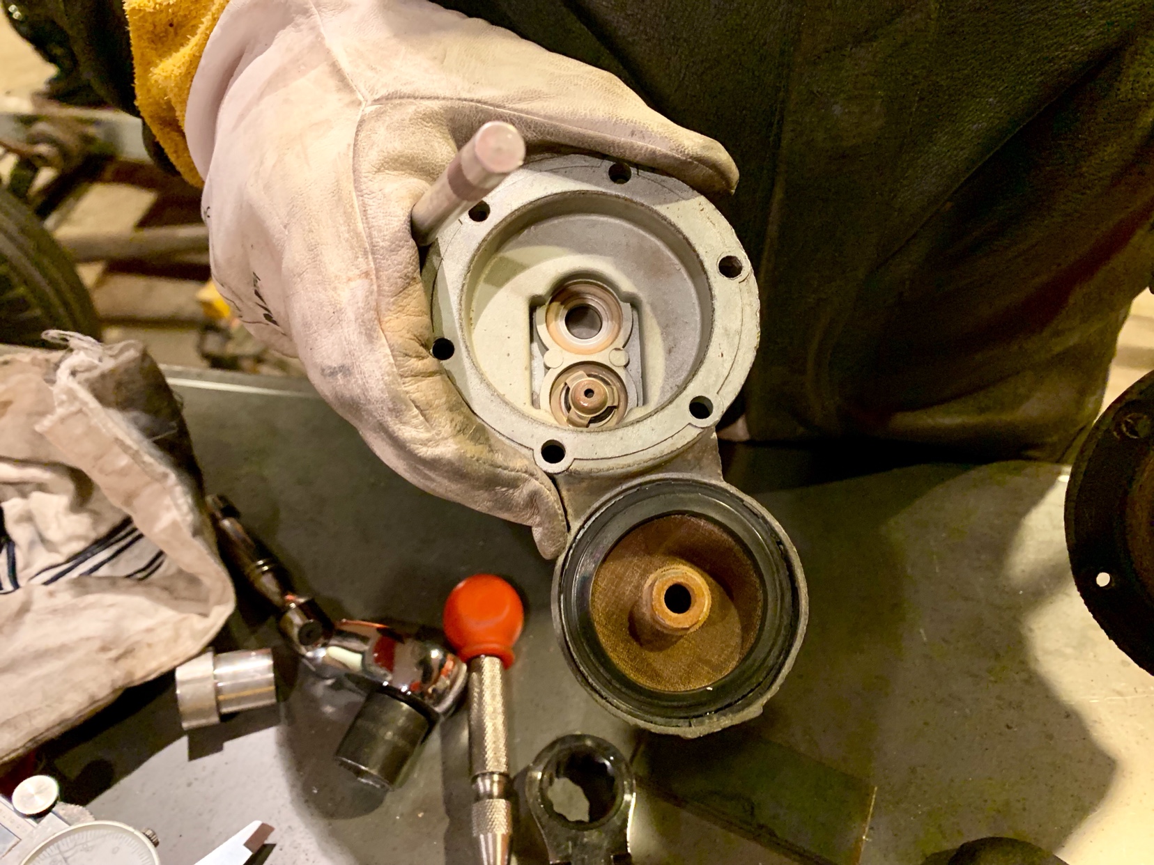

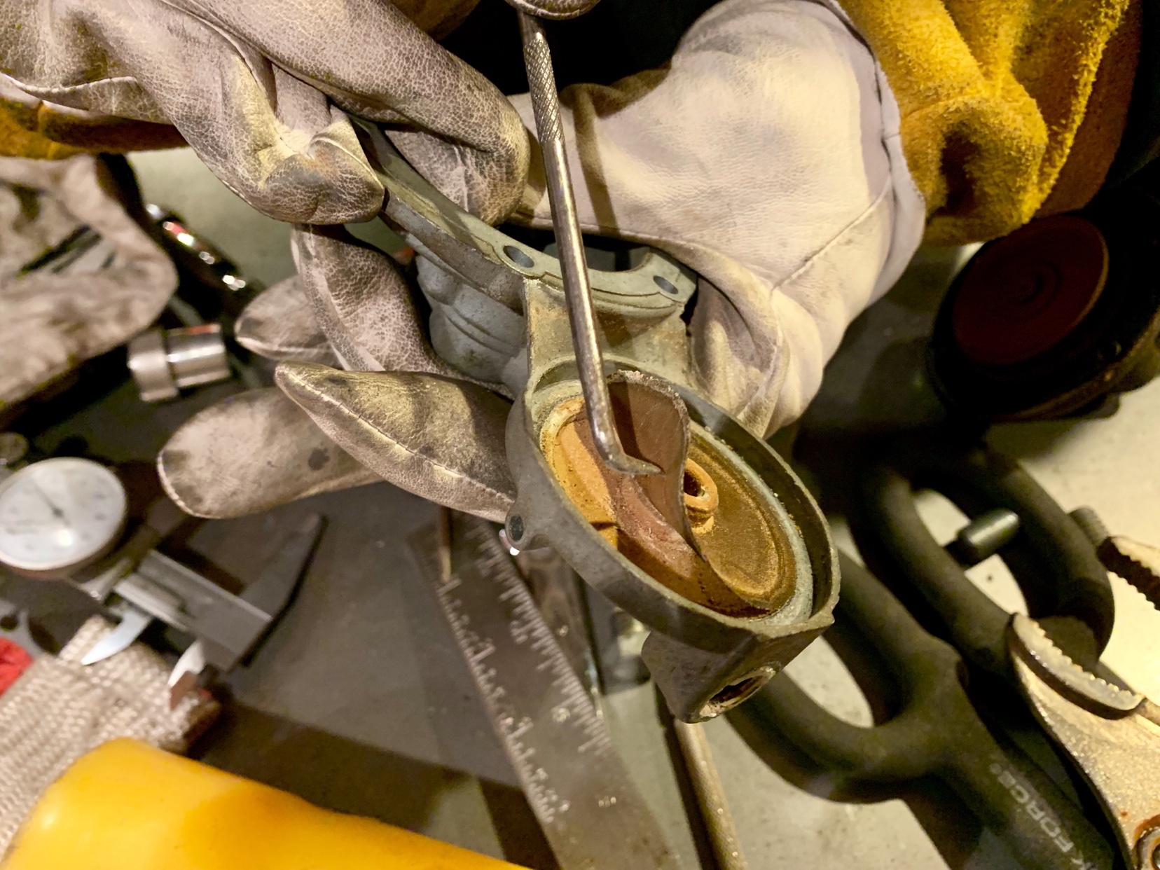

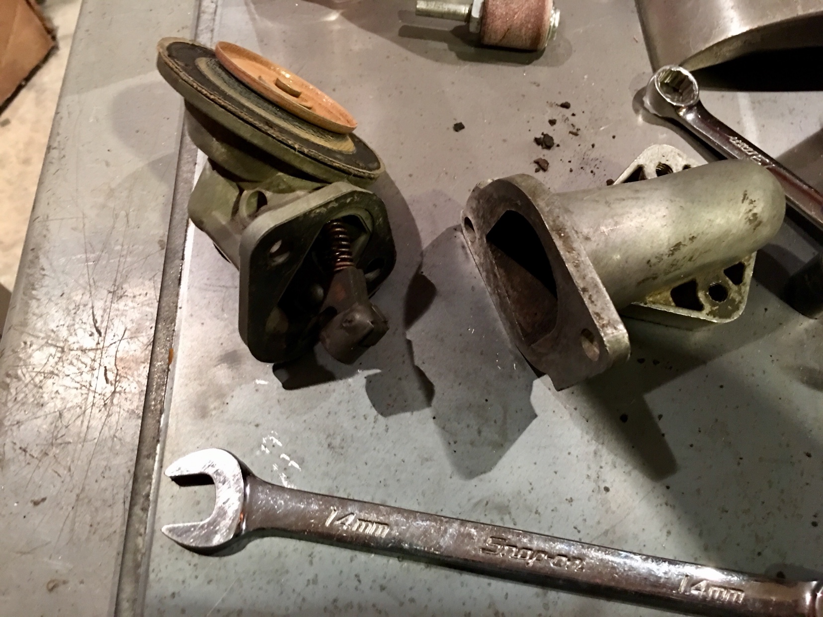

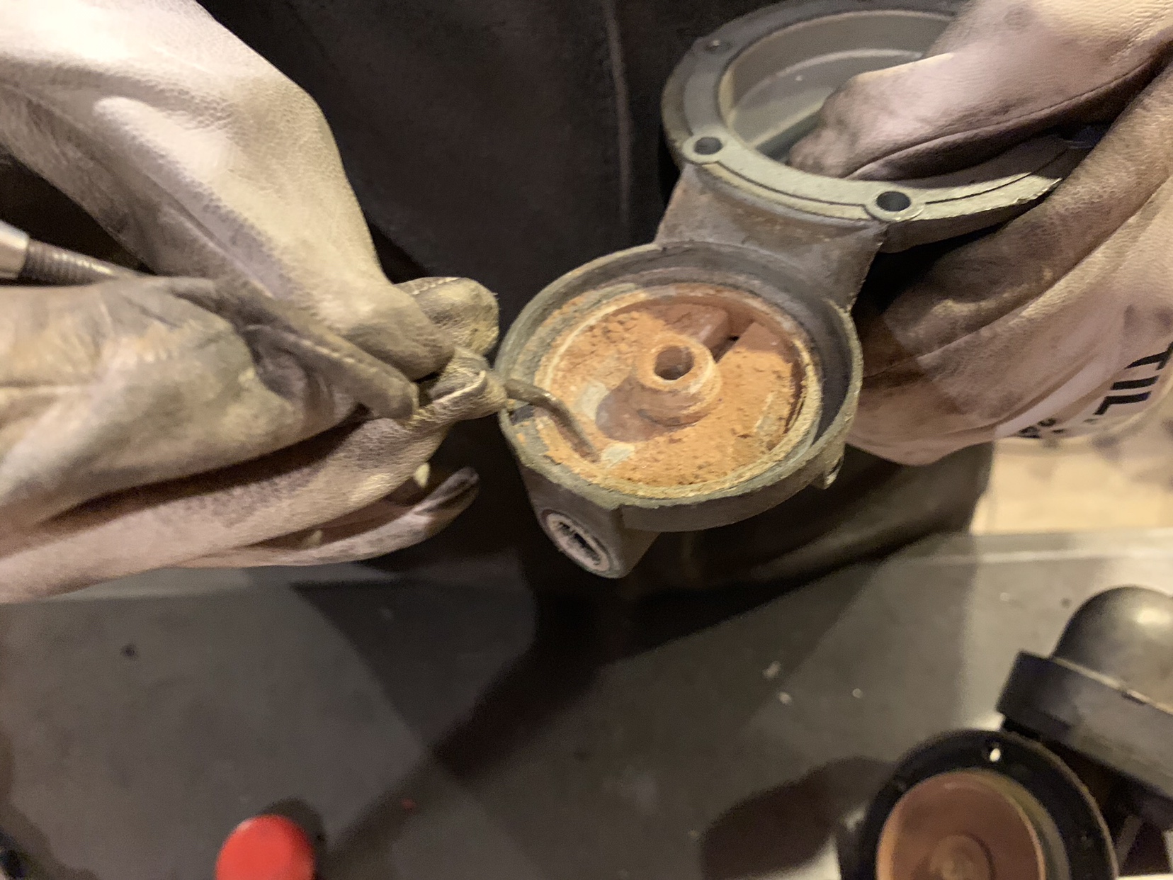

    I went ahead and finished polishing the fuel pump... I washed the gl*** bowl with pumice soap and did a test fit to the intake...[​IMG]
    [​IMG][​IMG][​IMG][​IMG][​IMG][​IMG][​IMG][​IMG][​IMG][​IMG][​IMG][​IMG][​IMG][​IMG][​IMG][​IMG][​IMG][​IMG]
    I really like the way this turned out. I need to order a rebuild kit. Tomorrow I’m going to finish up my ladder bar mounts and weld up

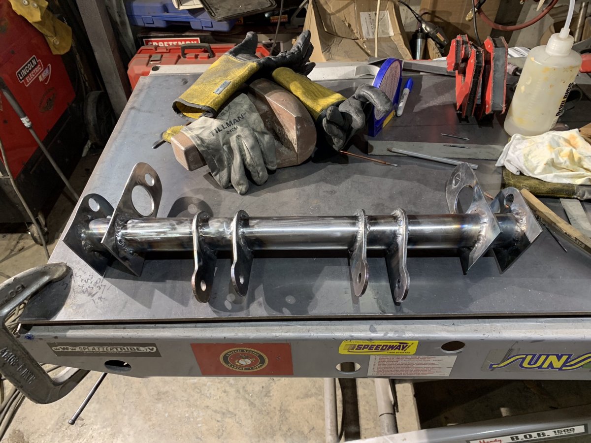

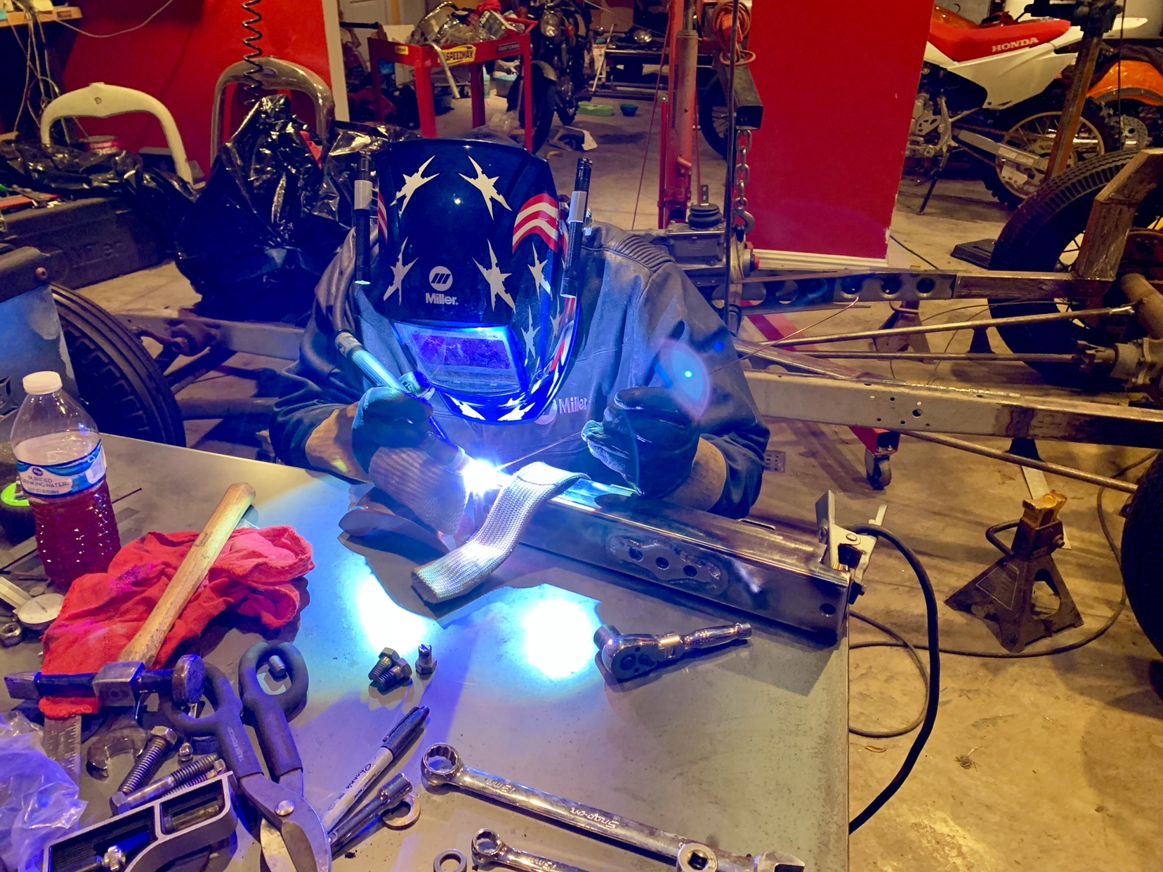

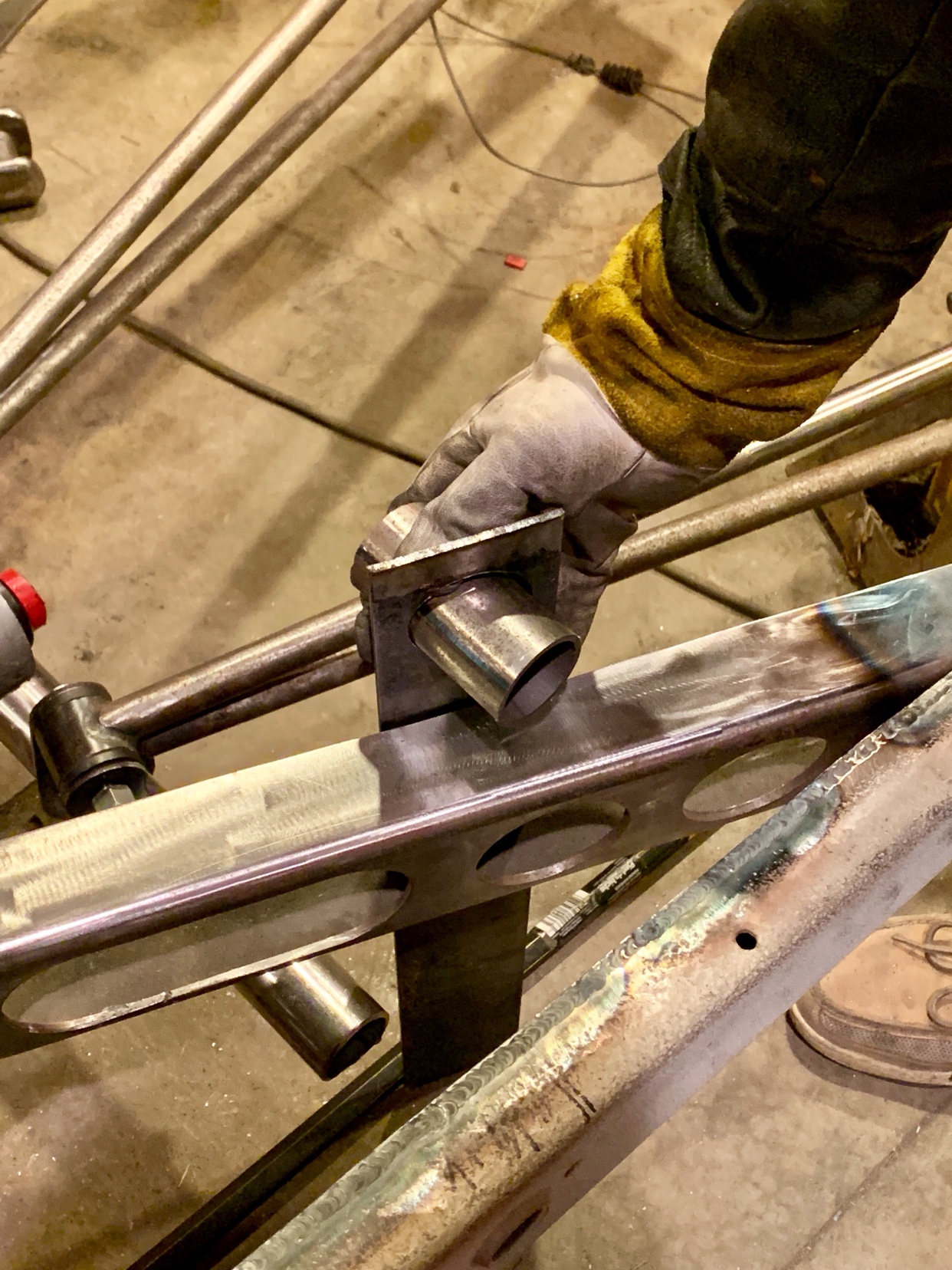

    Got the ladder mounts finished. The top holes are for the cross member to tie into. The middle hole is for show and the 1/2” holes are for the exhaust hanger and gas/brake lines to go through via robber grommets... More to follow on that later [​IMG][​IMG][​IMG][​IMG][​IMG][​IMG][​IMG][​IMG]
    I tacked up the fitment on the frame first
    [​IMG][​IMG][​IMG] I then took the fitment to the table to finish welding it up... [​IMG][​IMG][​IMG][​IMG]

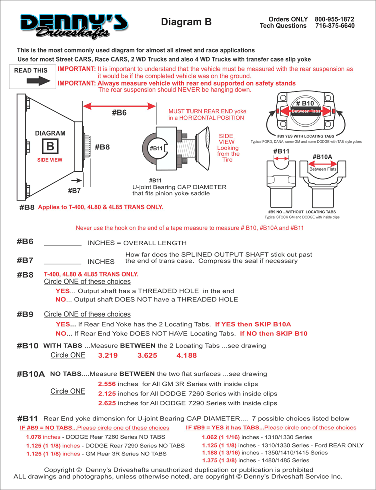

    Got the ends lined up ready for the driveline. Will order that from Denny’s driveline. IMG_0079.JPG Continued welding up the cross member. This is called the lay wire technique, where you weave back and forth across both base metals and run across the welding rod being careful not to contaminate the electrode... I’ve been using the 2% lanthanated recently again. The electrode was out almost 3/4” on some of these p***es with the argon turned up to 25-30%. 20 pps at 120v IMG_0080.JPG This technique is helpful when there is a slight gap in fitment. The rod was pretty much the same size as the gap. IMG_0082.JPG IMG_0083.JPG
    I clamped the weldment to my table IMG_0084.JPG IMG_0085.JPG IMG_0086.JPG IMG_0087.JPG It’s peanut ****er grommet time! Peanut ****er grommet time! IMG_0088.JPG IMG_0094.JPG IMG_0096.JPG IMG_0089.JPG
    Still at 2.5 degrees IMG_0090.JPG IMG_0091.JPG IMG_0092.JPG IMG_0098.JPG IMG_0100.JPG IMG_0101.JPG
    Need to tack in the cross member and finish welding during final weld up...

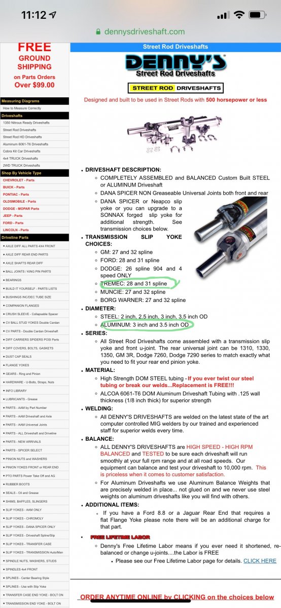

    Will call tech support for some clarification on this... will also check on prices of steel vs. aluminum and thicknesses.
    IMG_1404.gif I have the 28 spline output

    Will use this info for the rear end conversion. Talked to speedway and Dennie’s driveline who were very helpful.
    Need go figure out 6 vs 10 spline...
