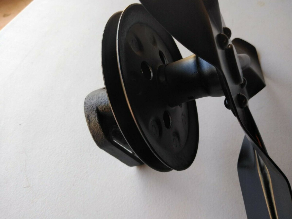

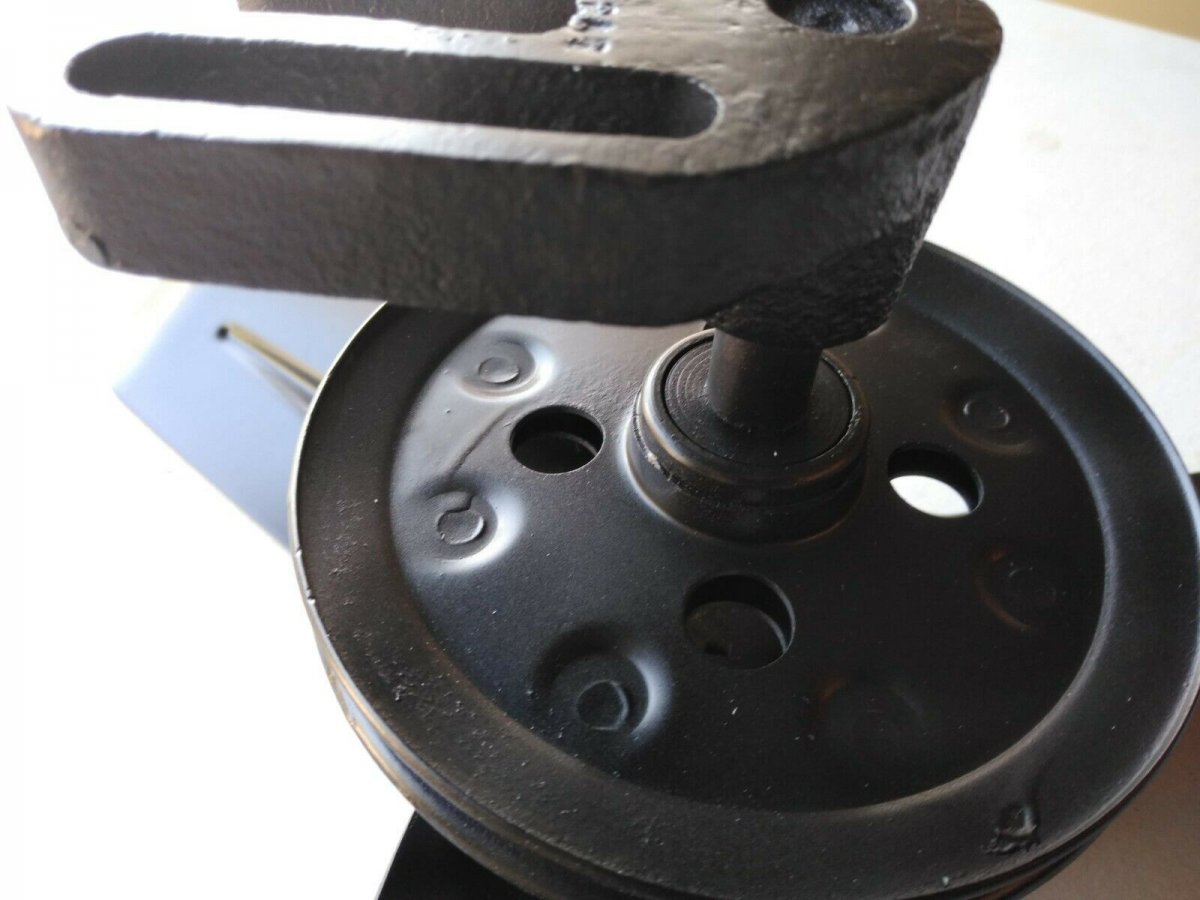

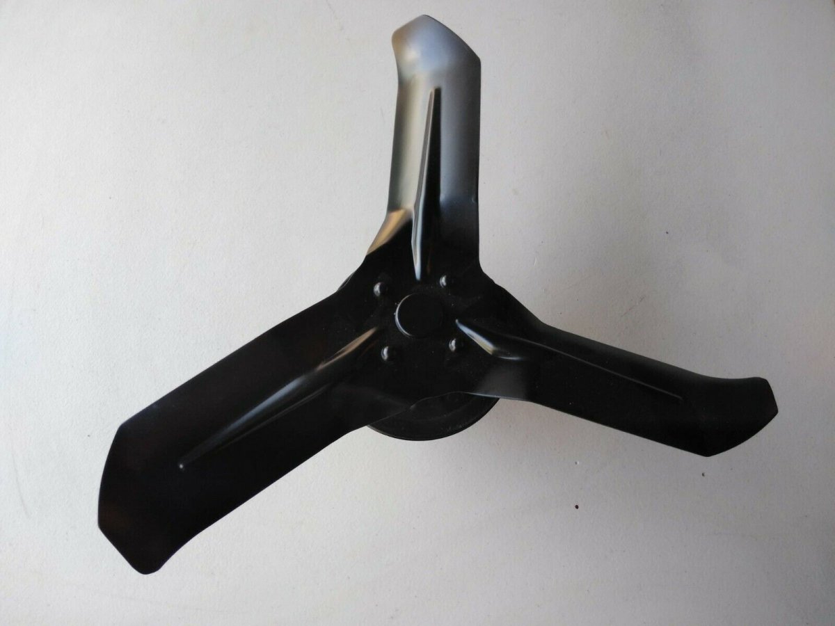

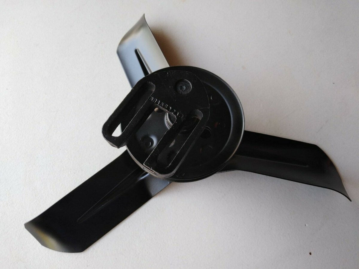

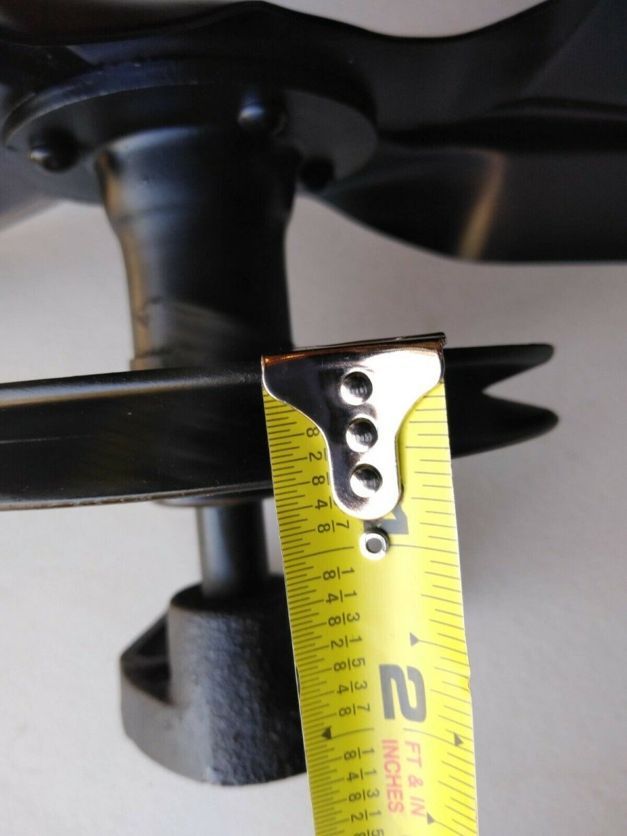

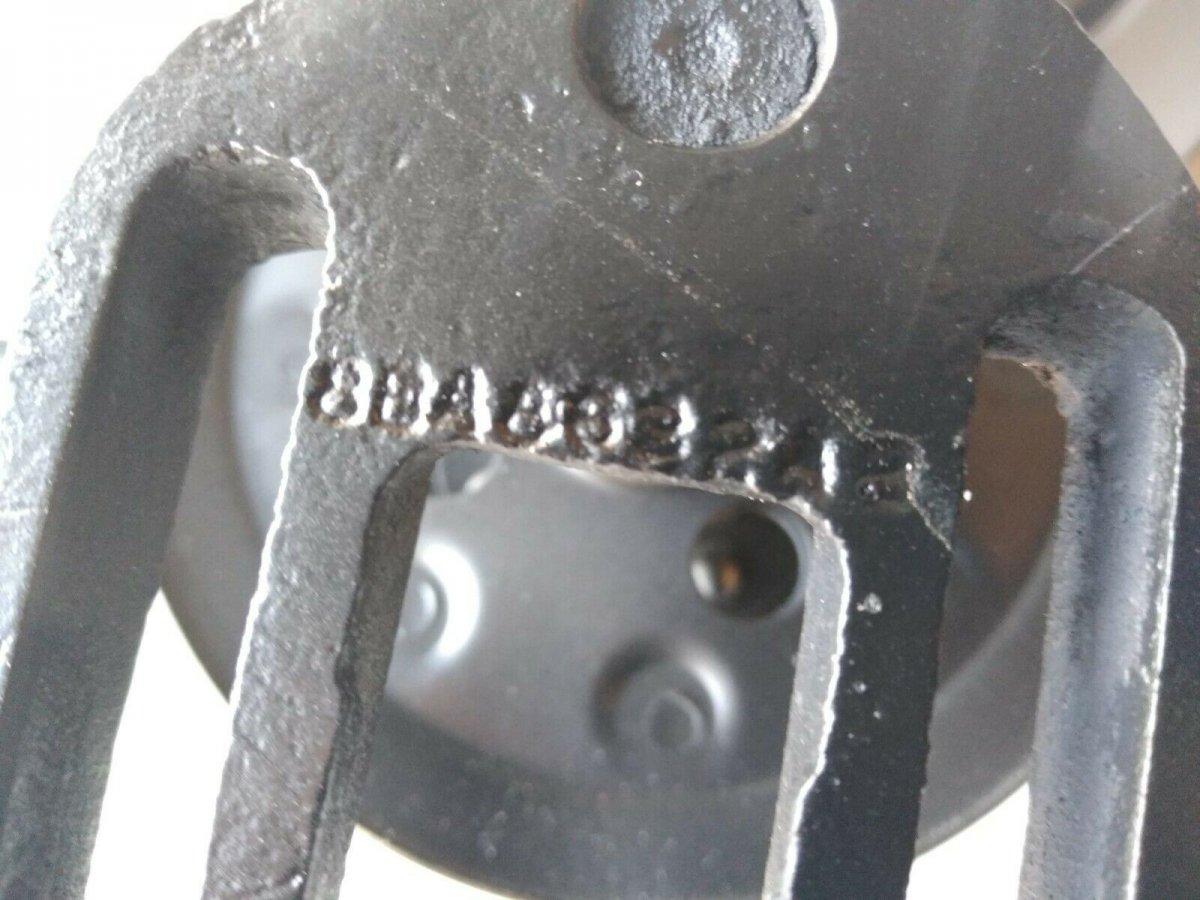

    I am slowly buying engine bits too, to hopefully fire up my flatty... other take off parts are strewn all over the garage... :confused:
    A19332FB-53DB-4698-A98E-AE5B3ABC1287.jpeg 6DAA44EE-4F20-4931-A51D-08FEA60AC559.jpeg 0CCDA6C1-3AC1-4B40-8391-270F43AF0586.jpeg 1586EB2C-BA78-48BD-A6A0-32C6B5A44D2F.jpeg E0B6DBE8-DFAC-482E-BC68-D69F846BE68F.jpeg 7D2EF5A8-5923-4301-8C48-E053109DB63A.jpeg F8EFE54A-8062-49E1-B871-C99DD5CDC407.jpeg
    This is an original 8ba fan...
    patmanta and Stogy like this.
