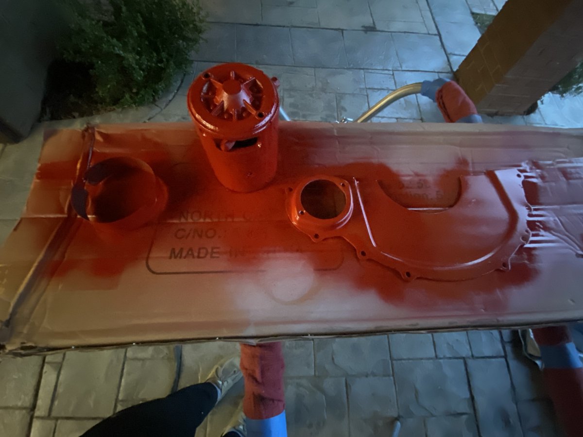

    Final primer coats and then engine enamel...

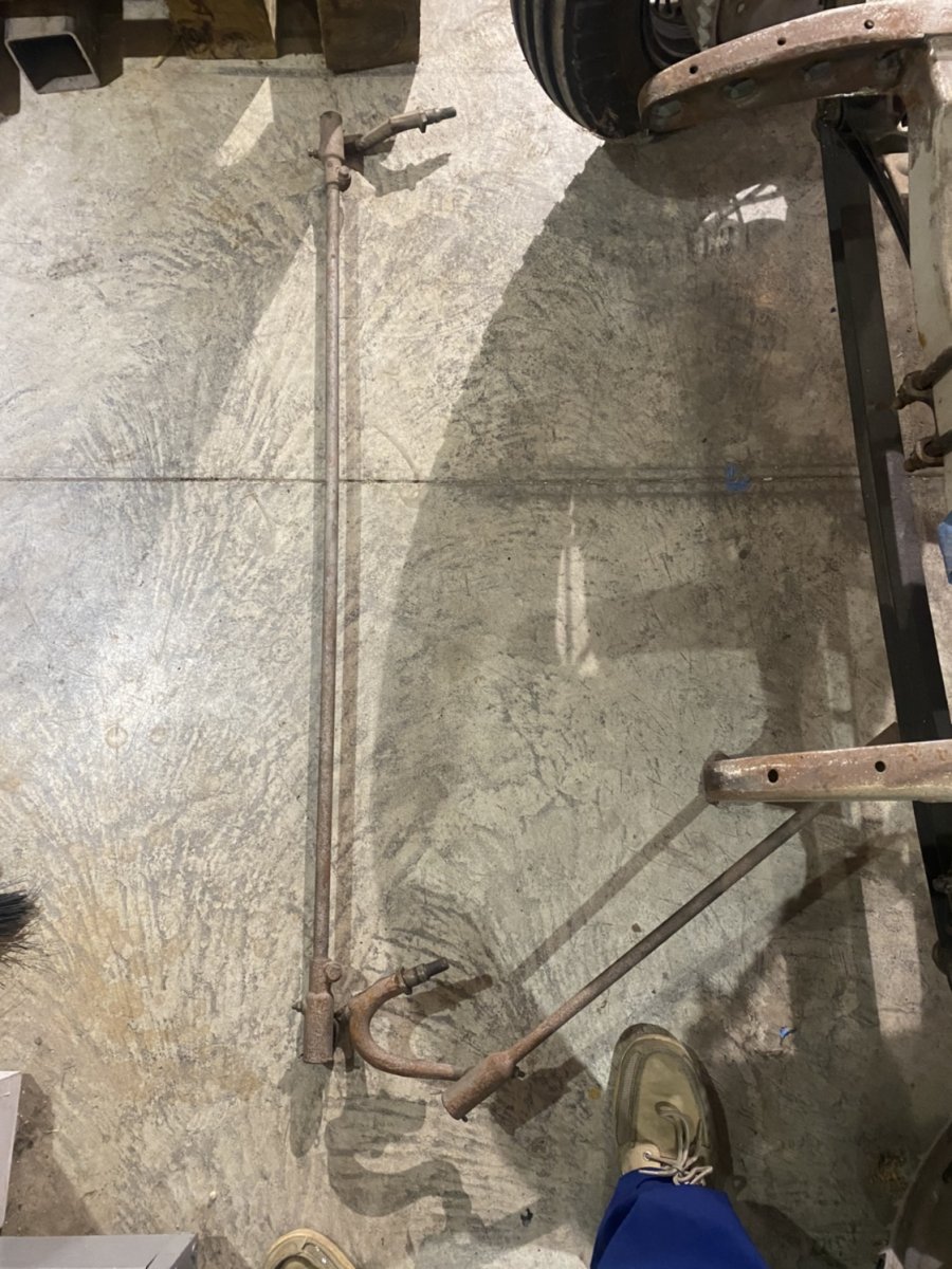

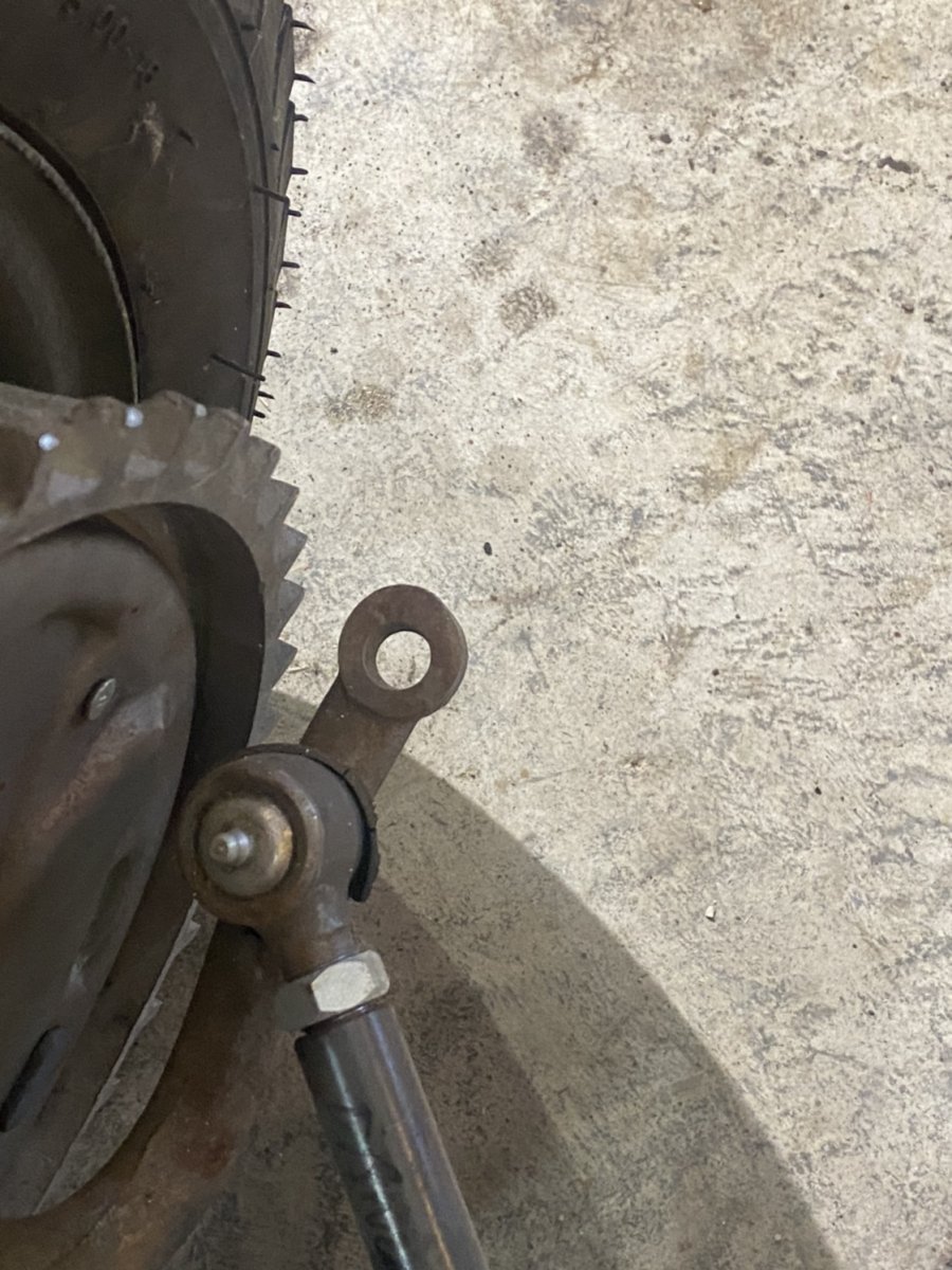

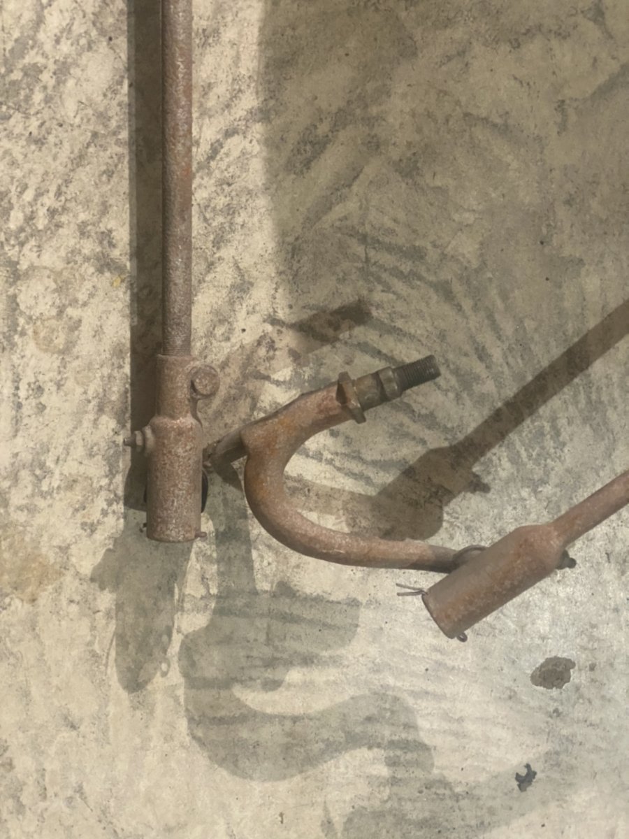

    This is my steering linkage... I’m going with cross steer. My question is what happens to the hook on the drivers side that on the p***enger side goes in the hole with a castle nut I ***ume?
    kidcampbell71 likes this.
  15. patmanta
    Joined: May 10, 2011
    Posts: 3,882
    patmanta
    from Woburn, MA
    Unless you want to spend a bunch of money on screw in ball studs to use that Model A tie rod, just get a new tie rod and new drag link with later style ends and be done with it. I would shelve the Model A stuff for another project; I don't think the hook (which is indeed the steering arm for the Model A, similar to a F1 setup) will be of any use to you.

  16. pennafxu
    Joined: Aug 20, 2010
    Posts: 2,263
    pennafxu
    from Kentucky
    Is this a custom set up from scratch, or does someone sell a kit?

  20. patmanta
    Posts: 3,882
    patmanta
    from Woburn, MA
    This is all just catalog parts and an original 35-48 Ford cross steer box.
    My particular setup is a So-Cal dropped axle with some stainless drop arms with tie rod and drag link I ordered from Speedway off the measurements once I set the car up. My tie rod is stainless but the drag link is just painted steel.

  24. patmanta
    Posts: 3,882
    patmanta
    from Woburn, MA
    Well if you pulled that Model A tie rod and steering arms off them, put those on the shelf too and just buy some repops from Speedway with the kingpins and bushings installed and reamed to save time and keep it simple. Alternately you could shop around for a nice set of 37 up spindles and recondition them. What are you doing for brakes?
