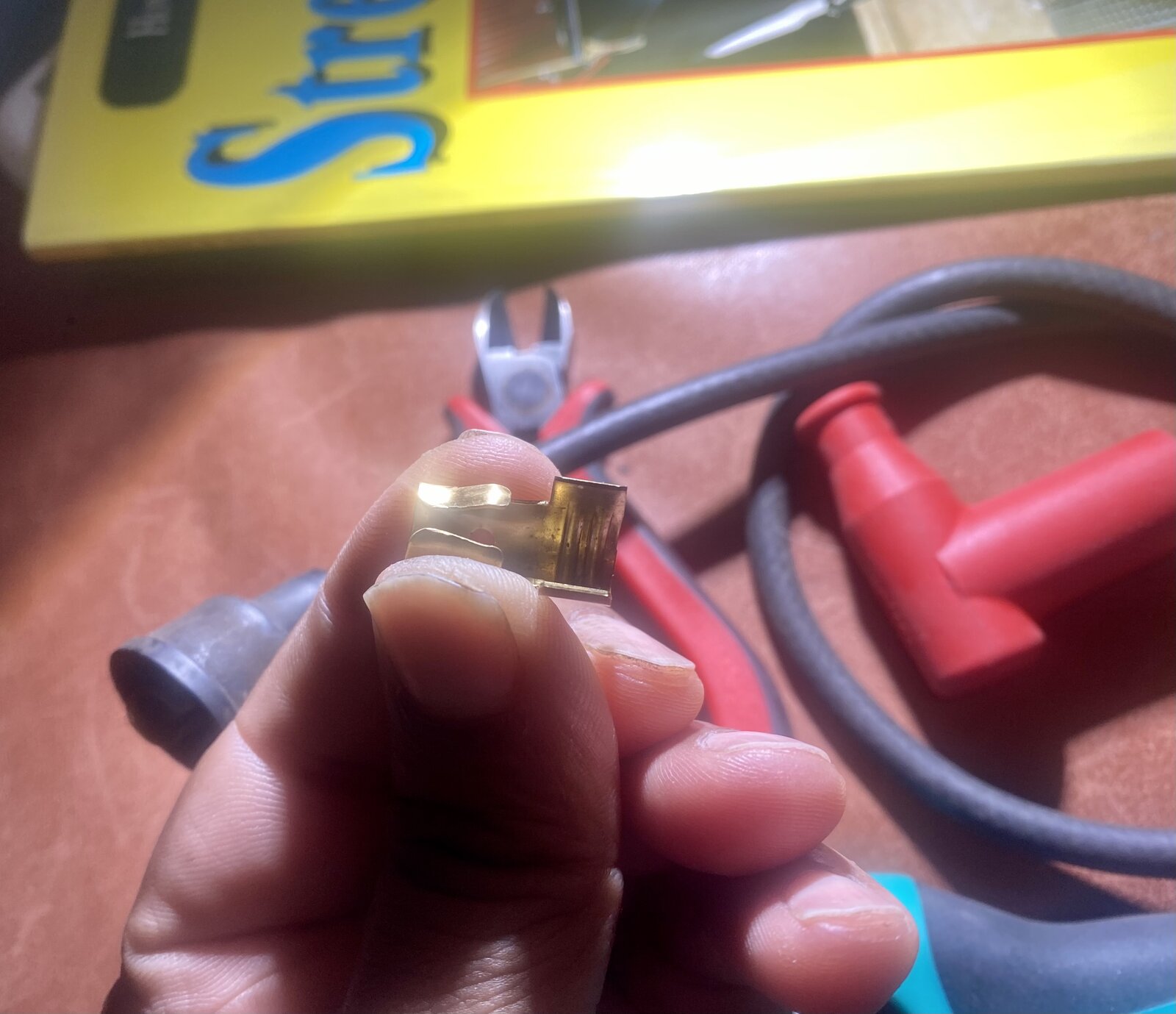

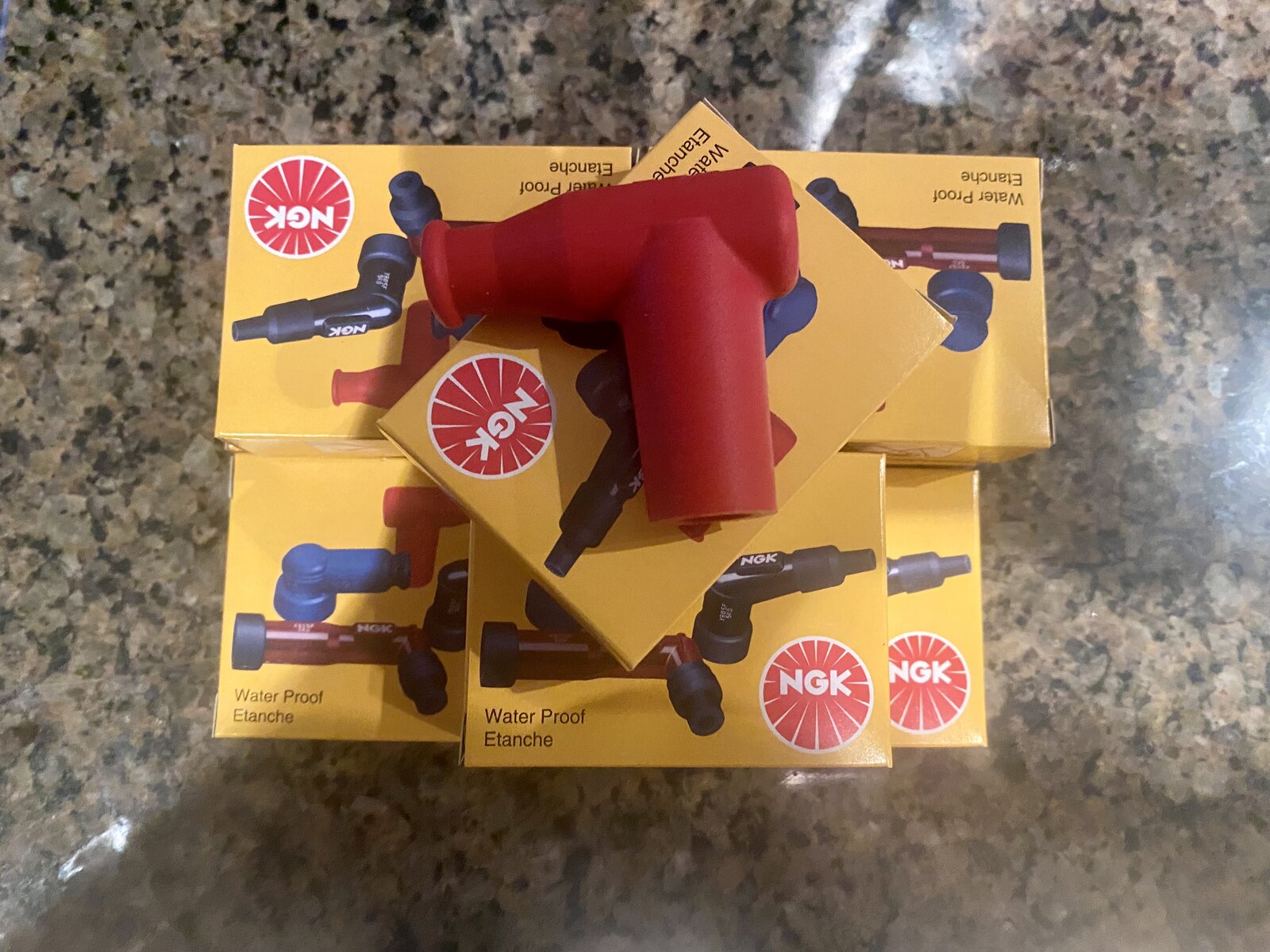

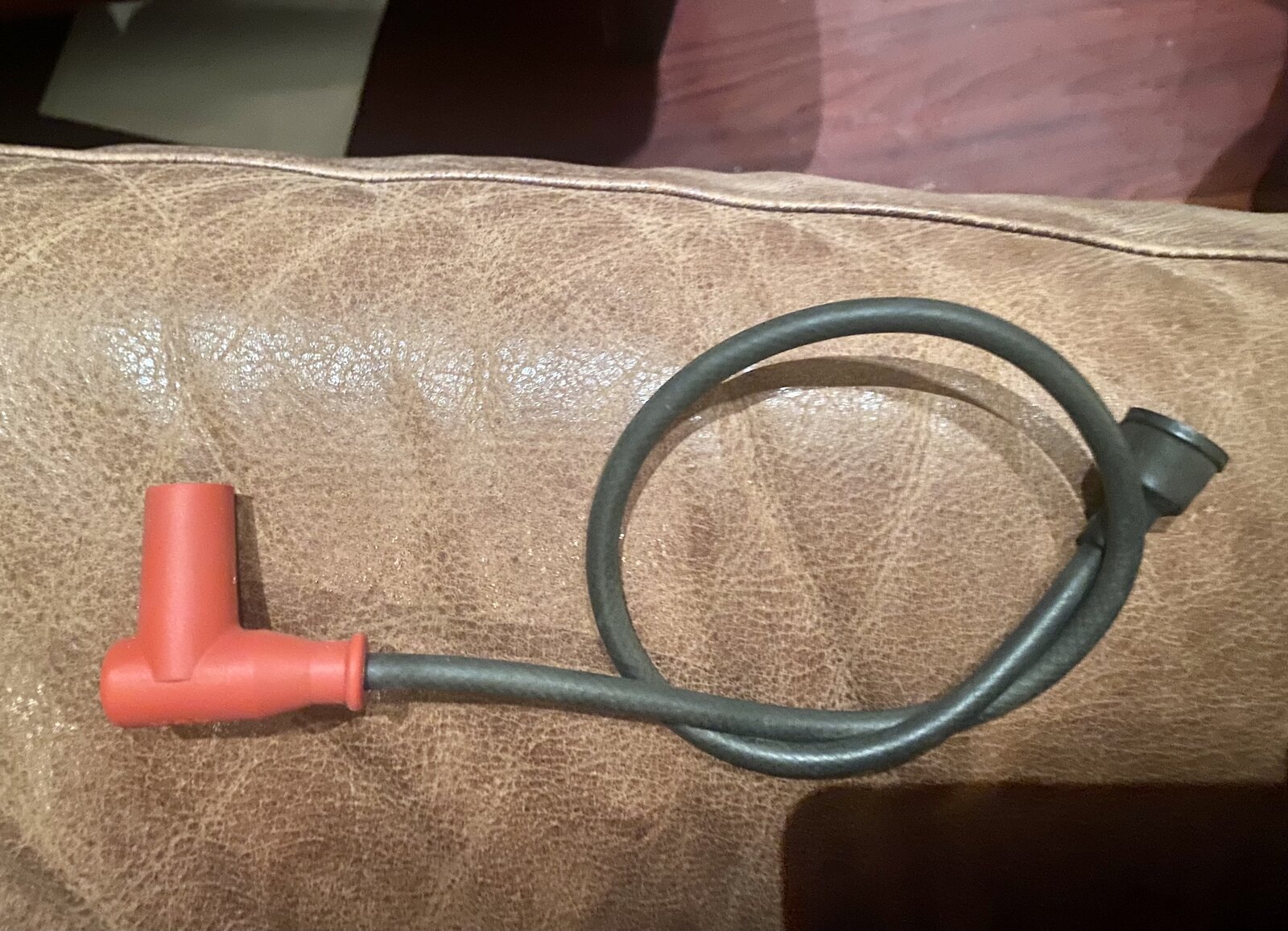

    Plug caps came in… It seems I will need to pull the rubber part off… BFC92B1C-CED8-40EC-A330-7878E5EB8E36.jpeg 57055686-ED47-4DB9-8458-7BFAD5E7609C.jpeg 04233E97-1BBA-4EDD-B7CB-6C7B589B55FD.jpeg 84605B8F-19A8-4CE5-9221-B339387C04C0.jpeg

    Got 25’ of 7mm suppression core. Just how @alchemy likes it…

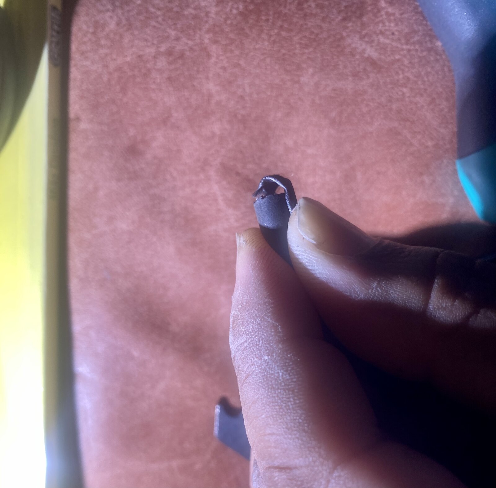

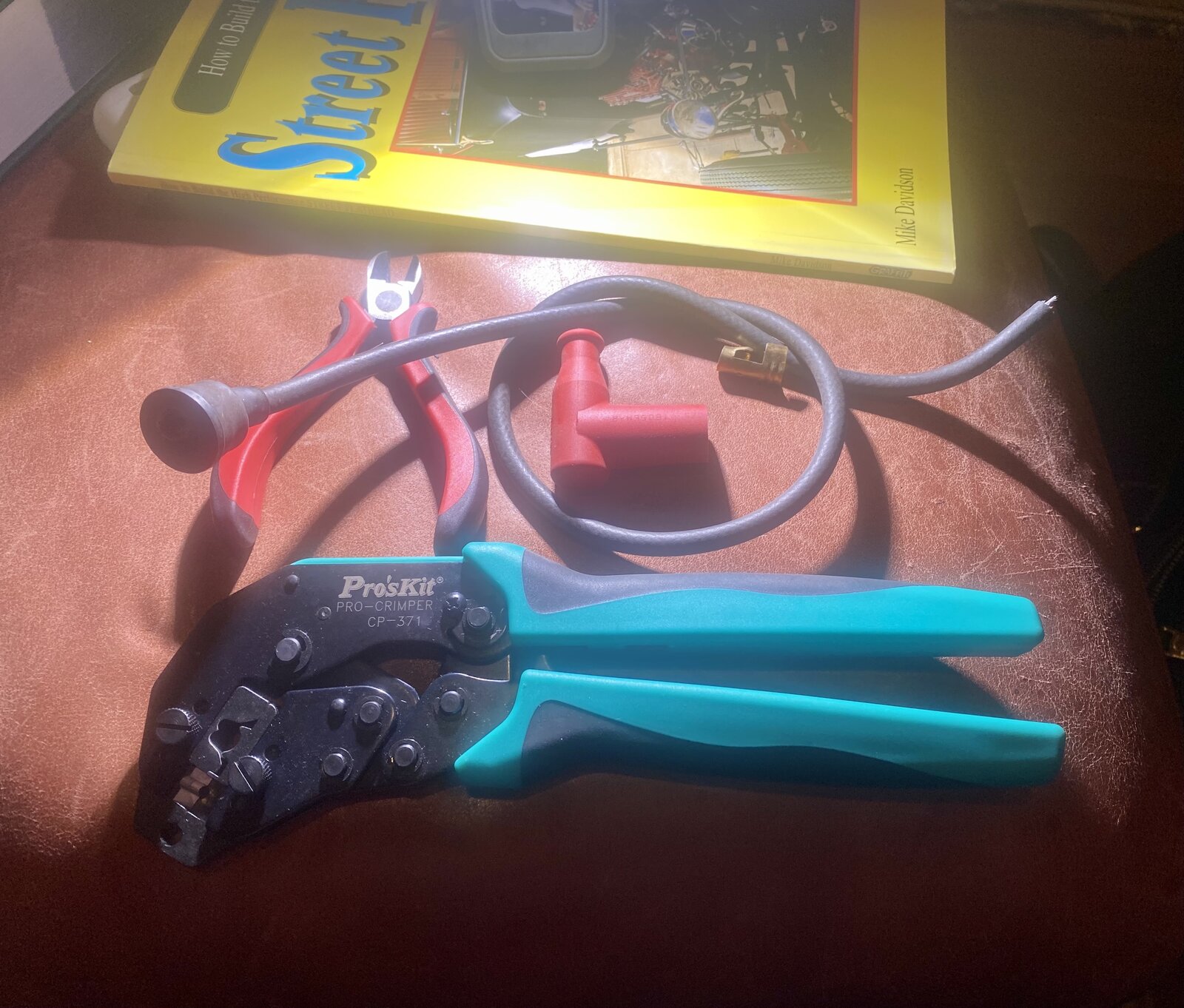

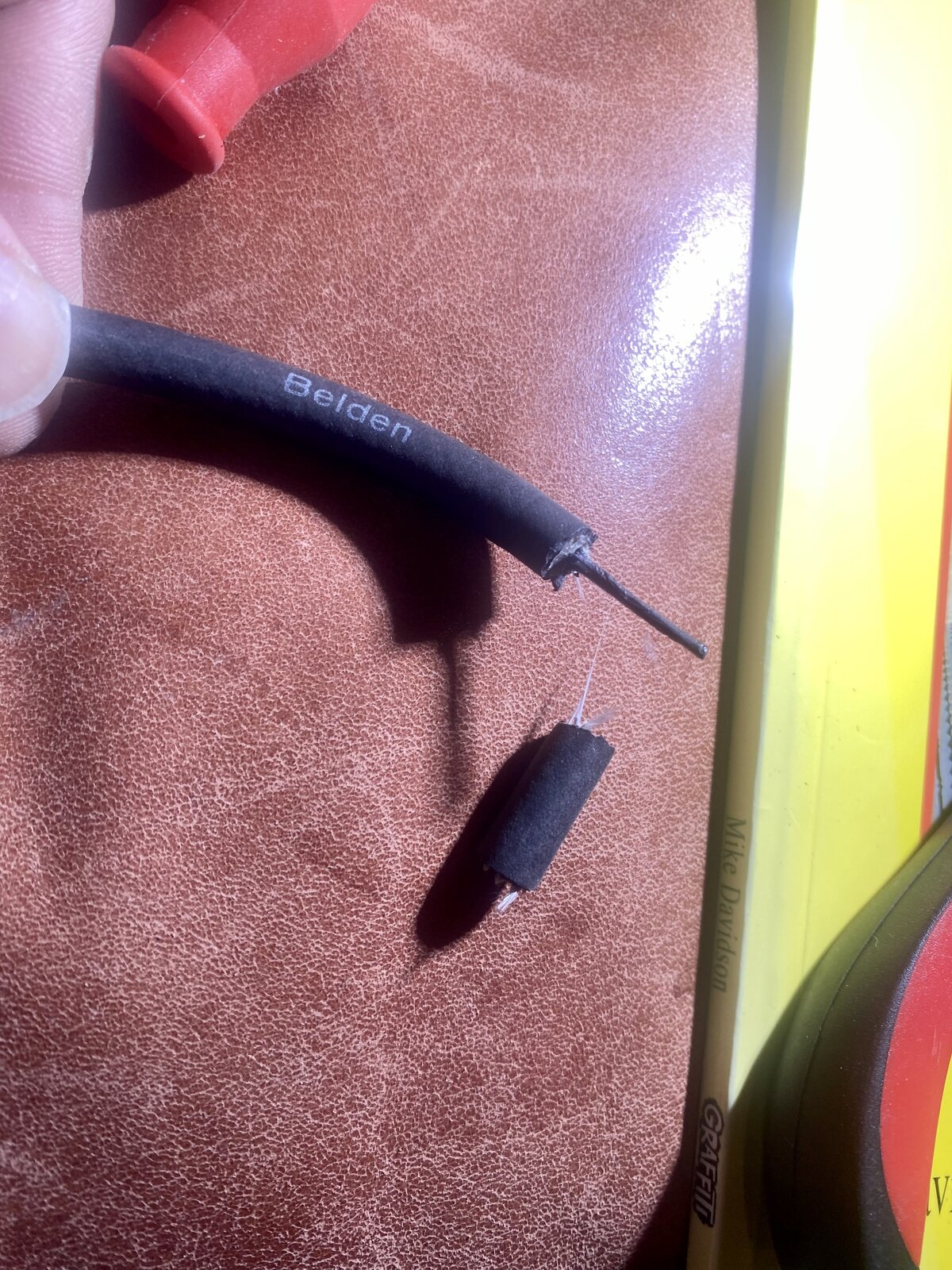

    Trying to recycle as many old wires as possible… BBDE0887-7D5E-45D1-B02B-B303CC59E028.jpeg grabbed a test end. BBDE0887-7D5E-45D1-B02B-B303CC59E028.jpeg 2A44C646-676C-4BFE-B34F-5D9907F2DB58.jpeg 8017CB78-A5F0-4E0D-B8B6-2DC5D1266BBF.jpeg 5D3478D9-92C4-488C-9997-6834D6BF5B8E.jpeg
    bent 90 deg wings whilst holding in the dedicated crimper

    From my reading, they recommended a little gap like this… 270B0E4D-5CBF-406D-868F-D3A84431CFB3.jpeg 58261D00-0291-4237-8F65-23F0F05C0CB4.jpeg FD4A11BD-4C80-4E65-98EE-7D560C2CE94A.jpeg

    One down and 7 to go! I need to review the firing order again to make the correct lengths. Will also wait after the alternator and belts are fitted. I will also check for continuity

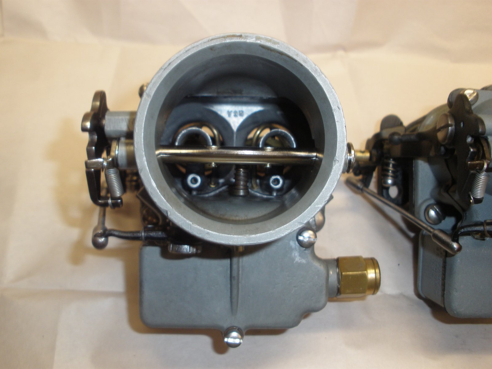

  21. patmanta
    Joined: May 10, 2011
    Posts: 3,882
    patmanta
    from Woburn, MA
    Sure, whatever I can do! I'm not sure how much help I can offer other than encouragement and to say that your 2 to 1 intake is probably going to want to run straight linkage and not progressive. I usually see progressive come in on triples and that is a dual to one adapter so it might get wonky but I am no expert. I do have one of those in my bin earmarked for the 59ab I have in pieces somewhere for later though so I am going to be very curious how this works for you.

    That is a stock pic… mine is a sharp intake.

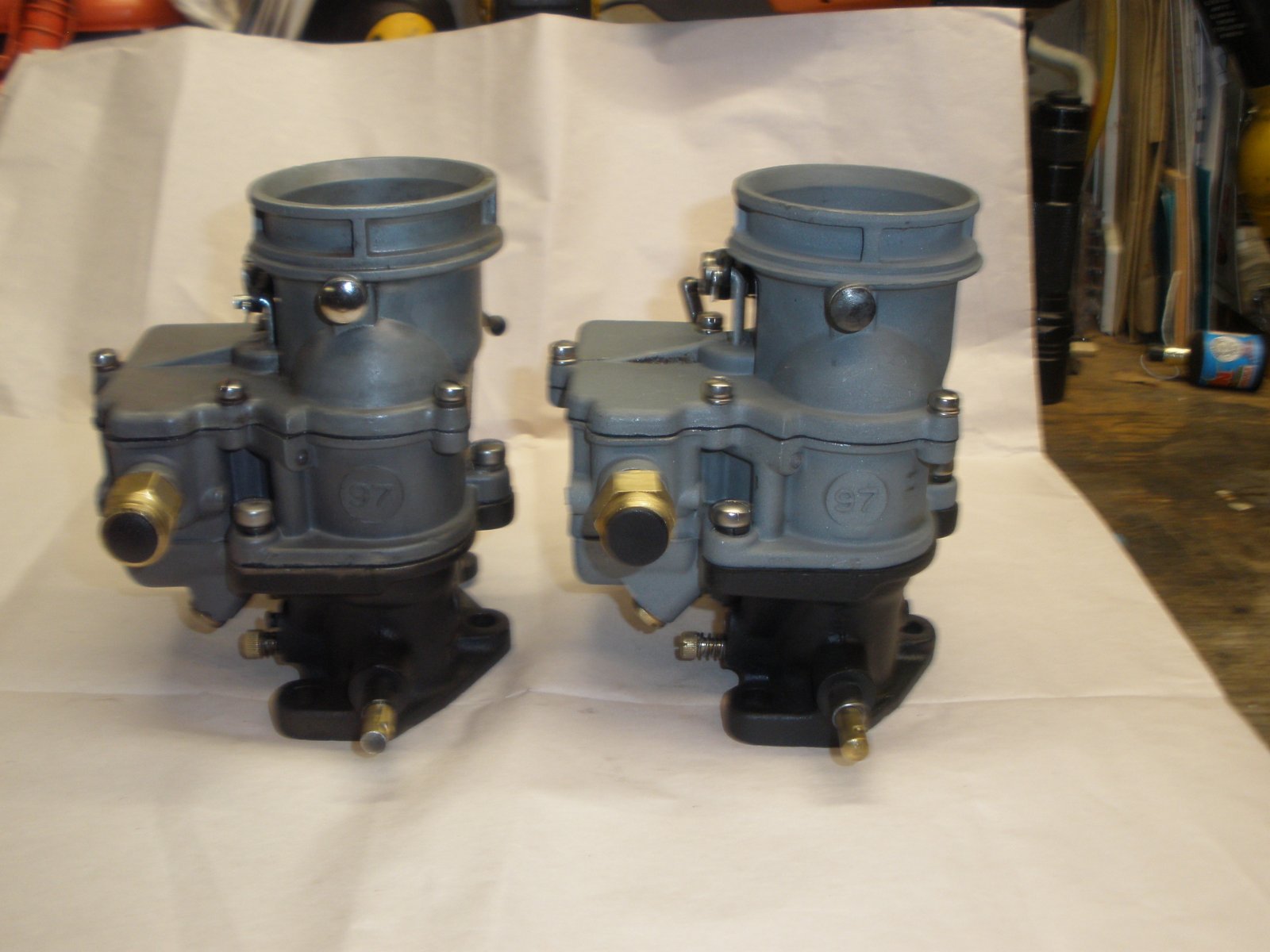

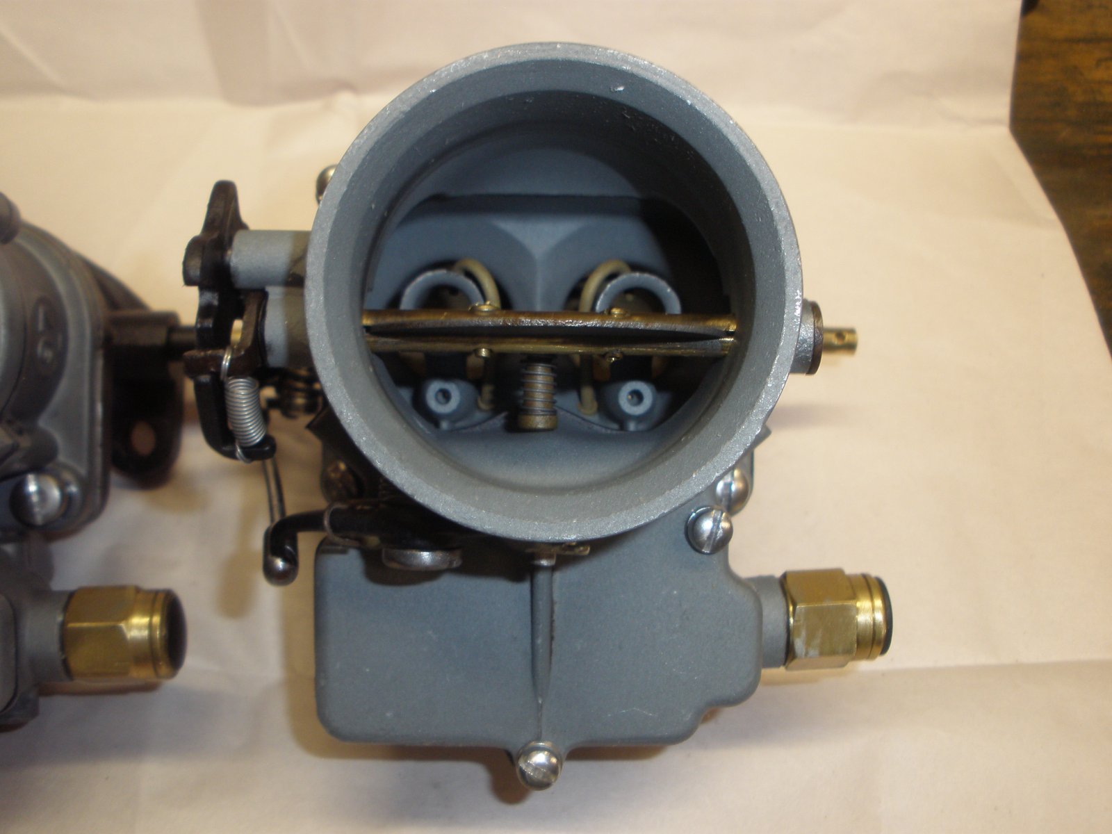

    I picked up my carbs…. @alchemy :) what thread pitch is on the intake studs??
    6F5FA43B-72E1-4936-B5D8-176A00AA3EEE.jpeg 50A9B2B8-8C88-40D6-9699-8F9E2218F554.jpeg 57B31DB8-1566-41E8-A0E6-E031D55614A2.jpeg FFECFA80-2320-4AD9-BA33-194958091691.jpeg E142EEA8-AF5C-4C28-8A2A-F9191CF83554.jpeg 0EE78CF3-A485-4F46-ADDF-D173522D8317.jpeg 6926FC02-B124-4C57-87FD-DC7098618E65.jpeg 9DA89E11-B029-441F-8EEA-7DA94C215C5E.jpeg

    Most aluminum intakes use 5/16" co**** threads. You can find studs with co**** on both ends, or fine on the top.

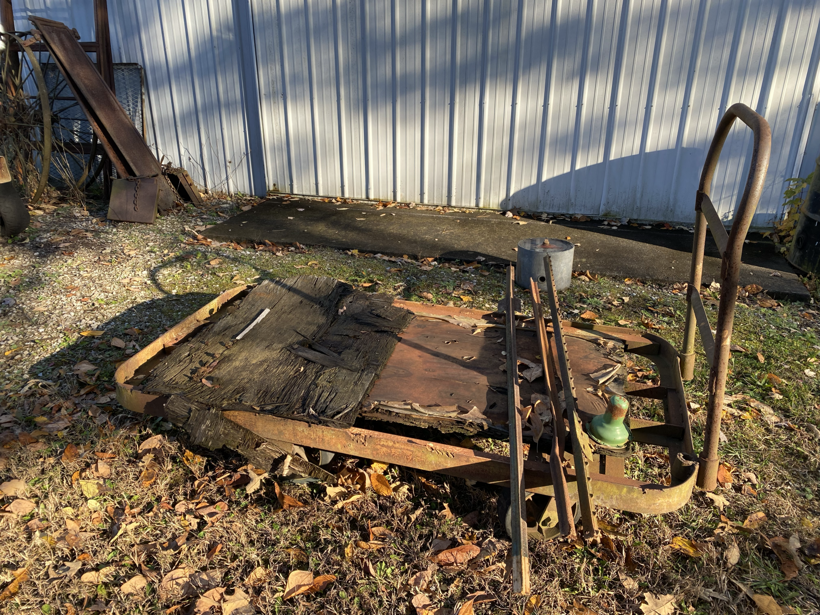

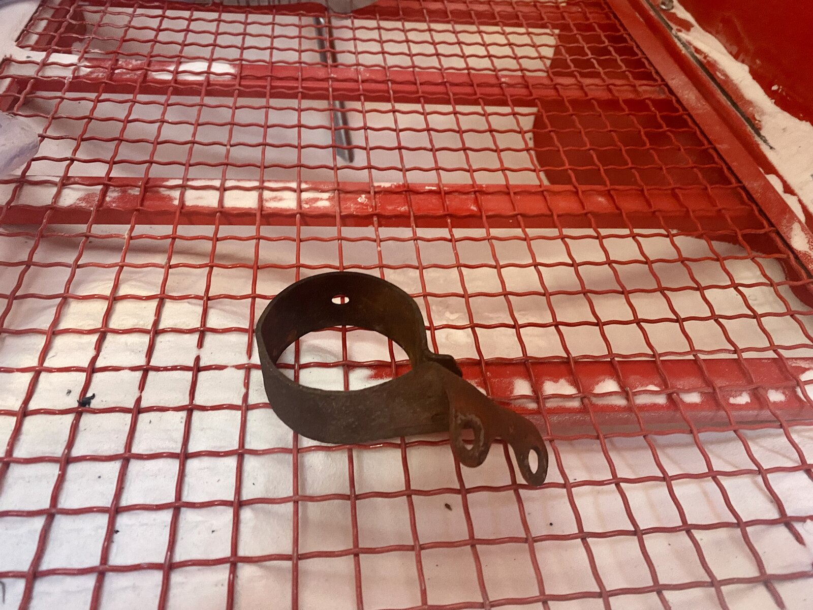

    tempImageF6qcHf.png tempImageXLnEDQ.png tempImageSLNpe0.png tempImage1rBCJ7.png tempImagenHNkLx.png tempImagelNGYsr.png tempImageF6qcHf.png tempImageXLnEDQ.png tempImageSLNpe0.png tempImage1rBCJ7.png tempImagenHNkLx.png tempImagelNGYsr.png

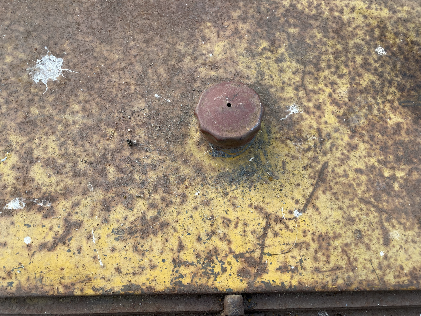

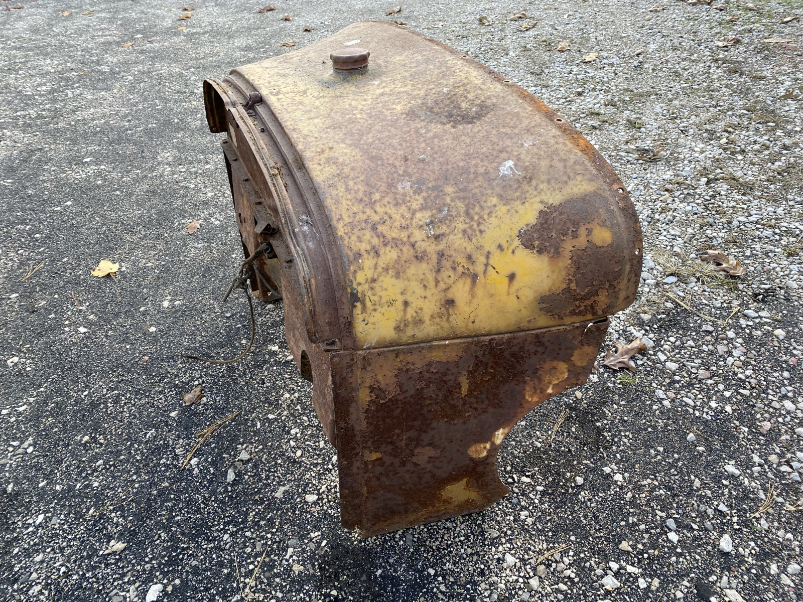

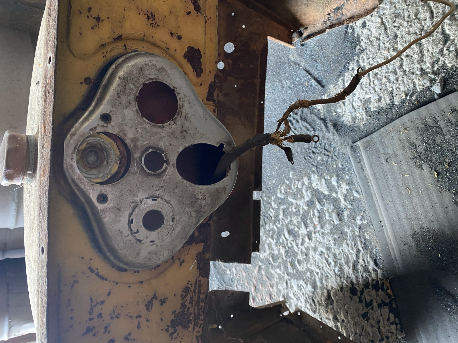

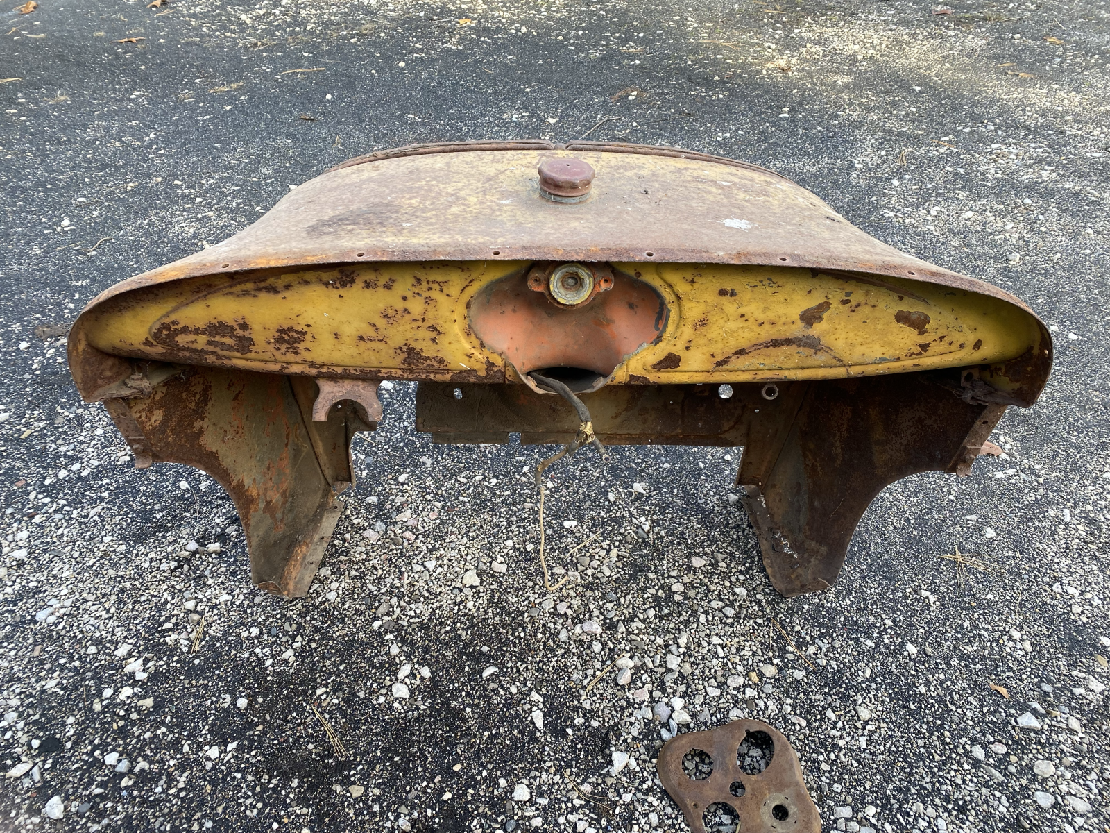

    Cowl is from a model A air compressor... I will put a cylindrical gas tank where the semicircles are.
    Will polish up the nickel plate and drill holes for my gauges. This is a very heavy duty trolley. I will weld the back end of the flathead engine stand on one end.

    I will fabricate and elevate this front frame with flathead engine mounts
