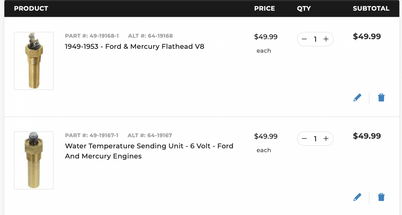

    Here are my temp sensors for each side... Does this look correct? What is left? looking out the car while driving? or looking fore to aft? What about the 6 volt situation here? Do I need the reducers to get to my 12 v gauges? Do I plug the 3rd hole, or is there another sensor out there? I understand somewhat the left to right byp*** deal on overheating...
    @alchemy @patmanta

    I don’t remember exactly but my lines are either 5/16 or 3/8. Run from boss on back of block to the side of the canister. Then from bottom of canister to the oil pan. Don’t forget the restrictor fitting on the side of the canister.
    Outback likes this.

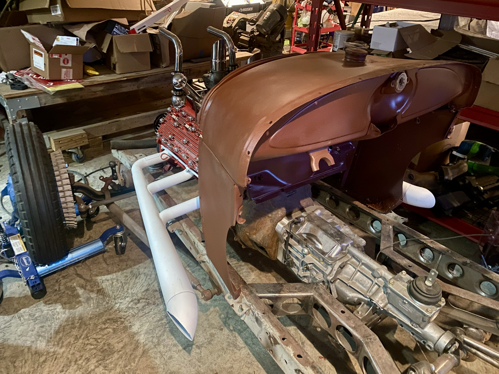

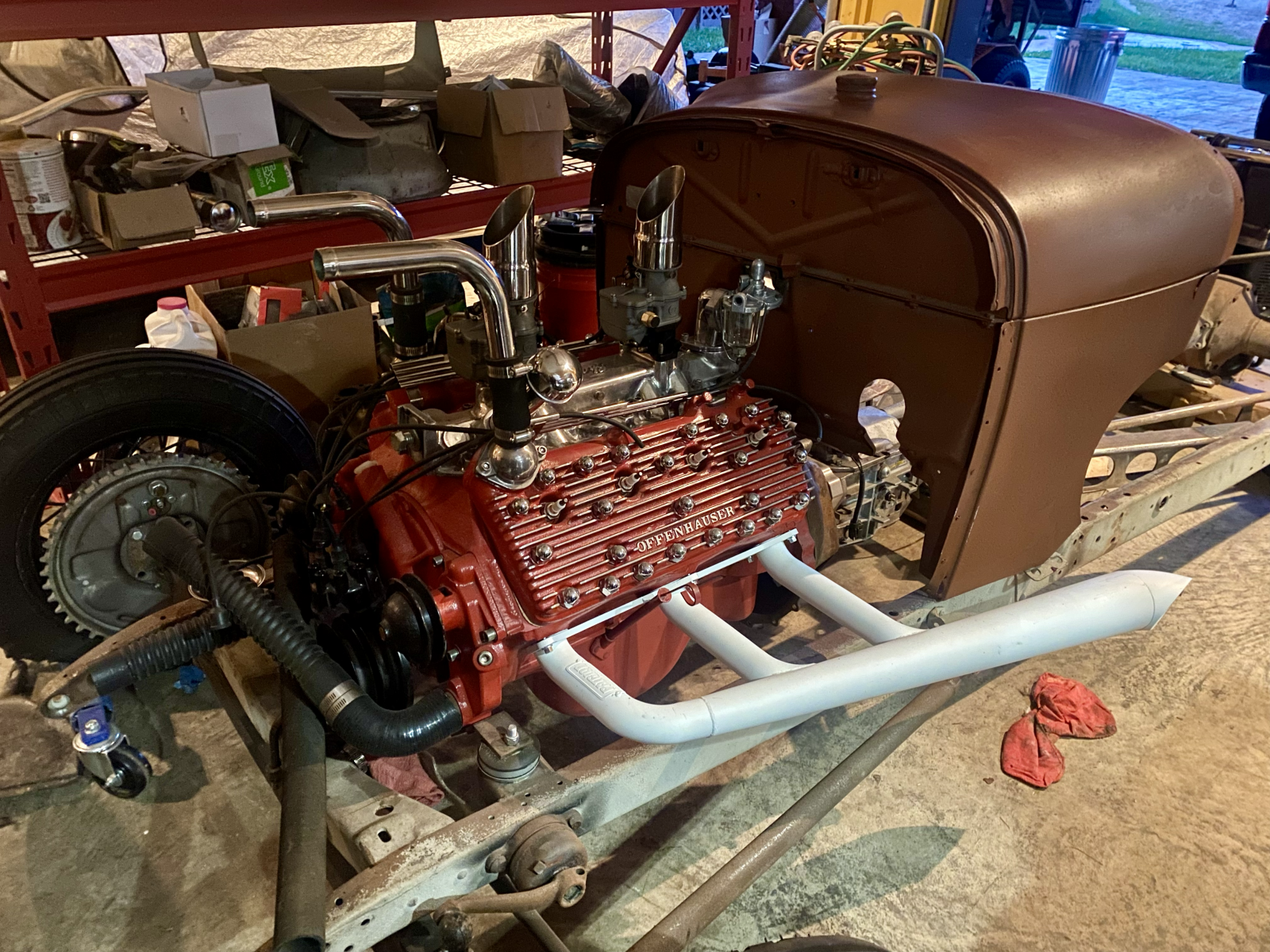

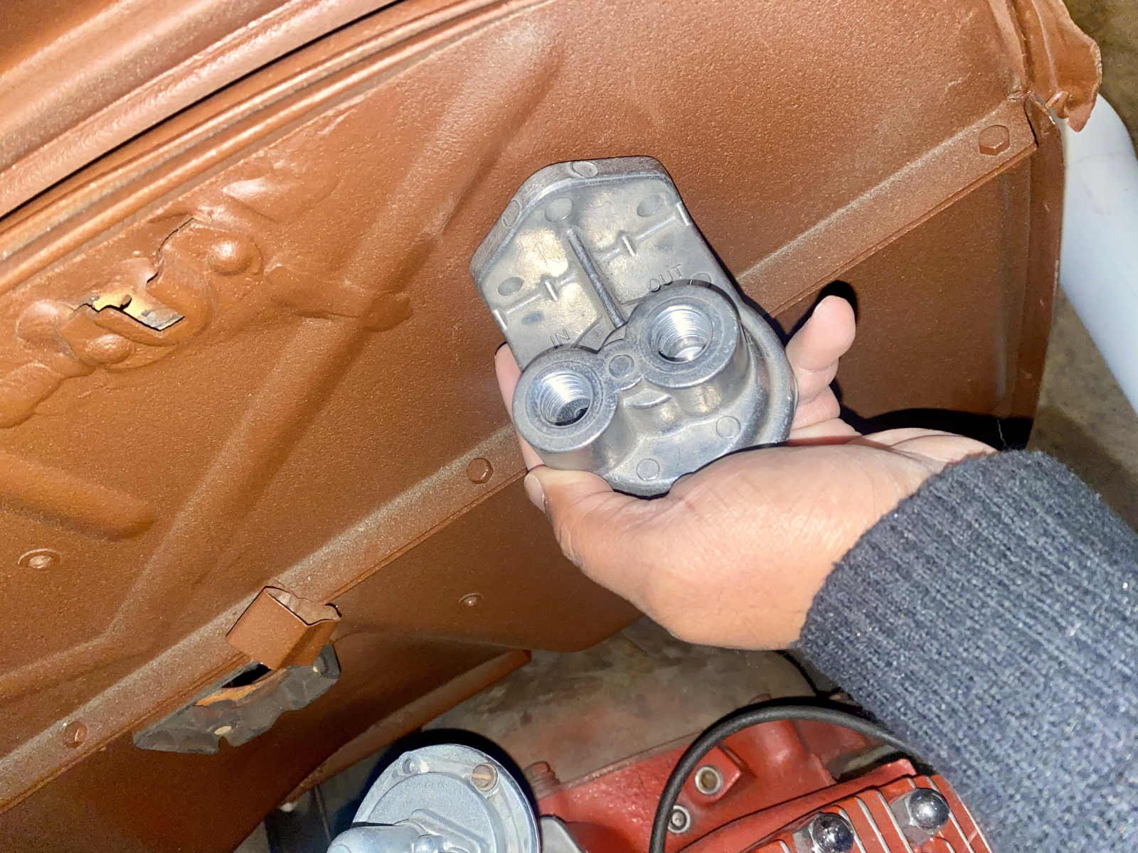

    Did some minor work today…
    Oil filter mount will attach to firewall
    threaded area on block
    D8B1BE36-0B2A-4652-B0E2-759A2CEED072.jpeg 9C9FA17F-5BAE-4D30-B5CF-D92C9CD49D7E.jpeg
    stainless oil filler/breather
    steering mount
    electronic fuel pump
    7B94912B-9AB8-4BEA-9331-655F68EA7631.jpeg 1A553644-7242-4C02-92D1-456C4DA8544F.jpeg

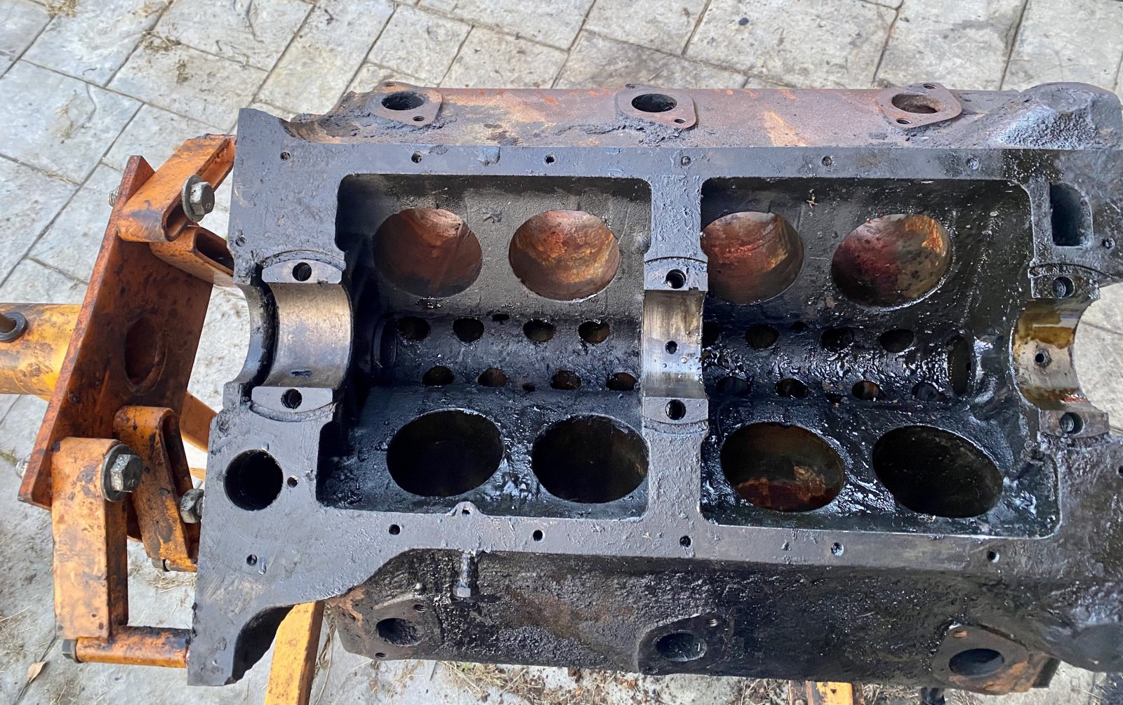

    3rd block had cam and all stuck valves removed
    57202091-3B02-4263-91EA-92D0DD4E1153.jpeg C3D3F088-3B2E-43B2-B310-65A82B88319F.jpeg A185652D-8919-4833-BCA6-42211B73BFC3.jpeg
    CF4FDB81-65BD-40A8-AABC-BB16D6006F59.jpeg 06B60337-0404-4A4D-8024-03BB2AD005F3.jpeg
    DDE00C01-2D62-41CA-ABBA-8C2D1354F7CD.jpeg 9F14457A-7562-42AE-B432-11AD828B1EBD.jpeg 05198944-3692-4E80-A1FE-8ED34152F4B5.jpeg

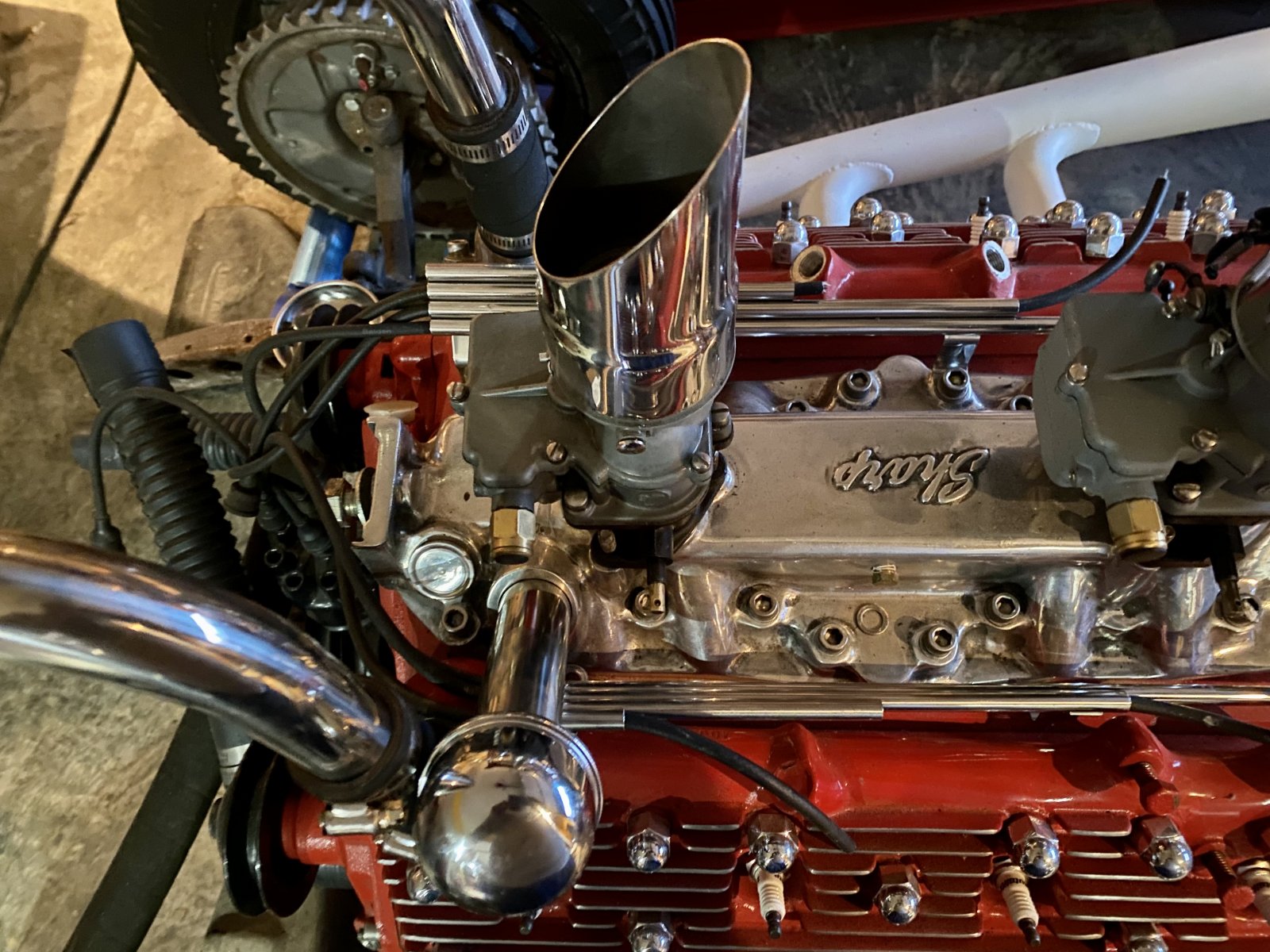

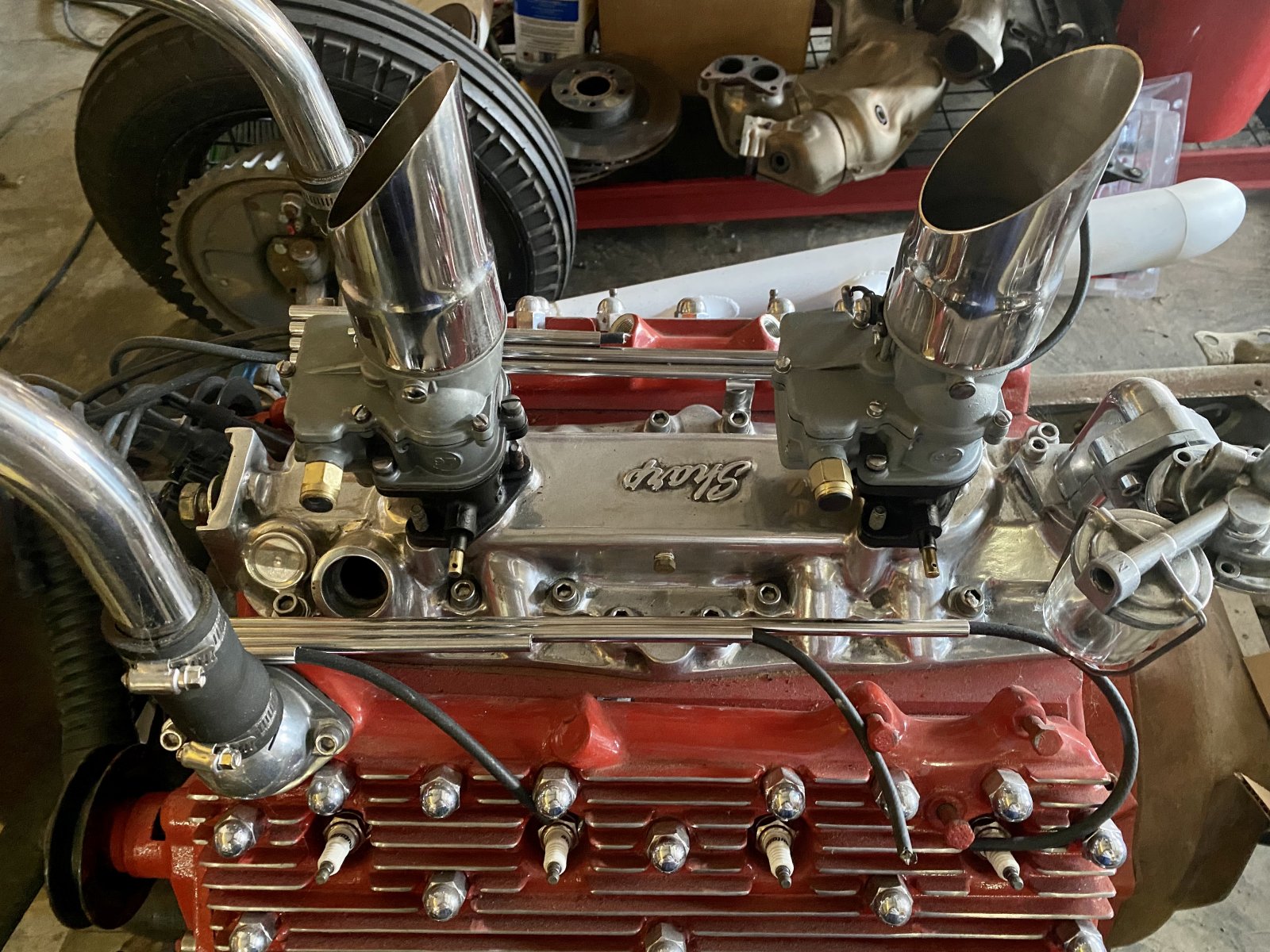

    Carbs/intakes
    brEad, OFT, Outback and 5 others like this.

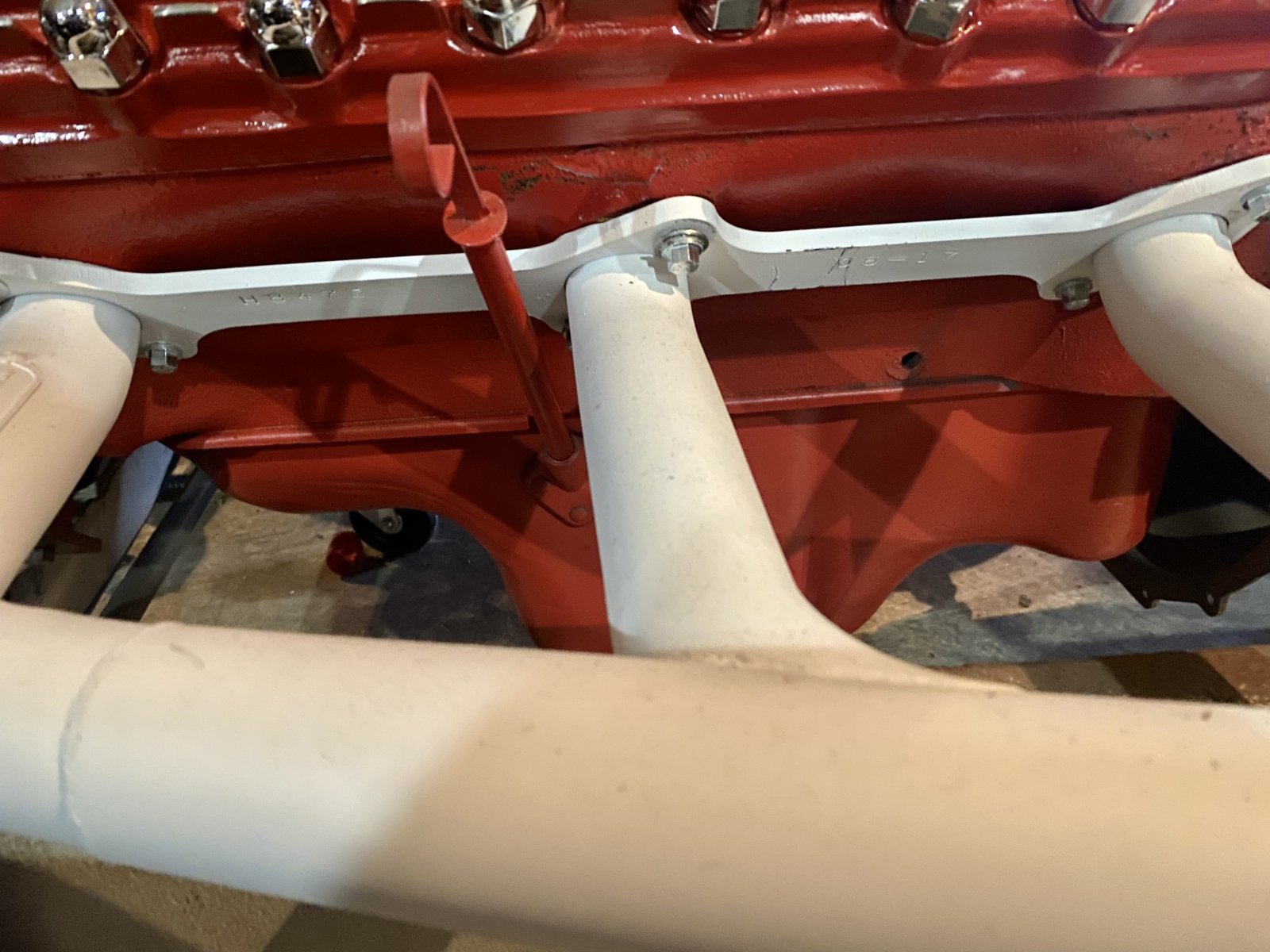

    Well, if you have an oiling system designed by someone other than Henry Ford, you should probably ask that guy what he wants for sizing. Who did it for you?
    Outback and patmanta like this.
  13. pennafxu
    Joined: Aug 20, 2010
    Posts: 2,263
    pennafxu
    from Kentucky

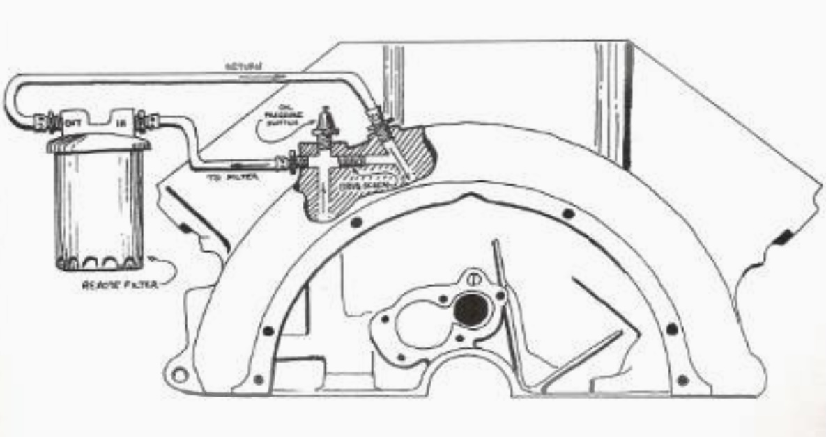

    The local machine shop but they went out of business due to covid. They drilled in the boss for the accessory oiling. I tracked this image down. Do I block the boss on the side of the engine?
    Outback likes this.
  14. patmanta
    Joined: May 10, 2011
    Posts: 3,882
    patmanta
    from Woburn, MA
    I don't know, I am not that far along with my flathead yet. I would suggest using NiCop line though, not pure copper. It is stiffer and resists damage better without being difficult to form.
    I think you can get chopped 32 stanchions like those off the shelf.
  15. pennafxu
    Posts: 2,263
    pennafxu
    from Kentucky
    ok... NiCop then. I will block off the boss on the side of the engine.

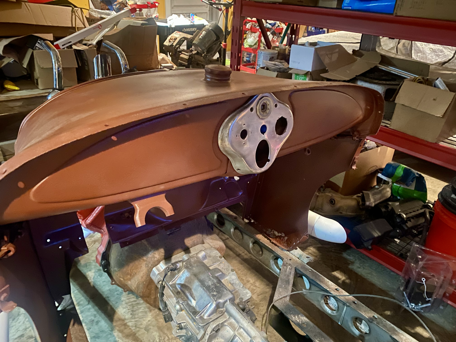

  17. pennafxu
    Posts: 2,263
    pennafxu
    from Kentucky

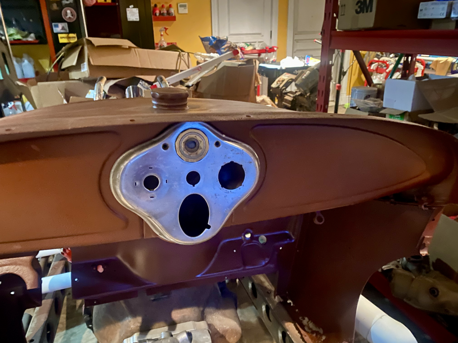

    Test fit the "engine break-in" cowl. I might channel this 6"... What tabs on the frame need to come off to secure a channelled body? I polished up the gauge panel with steel wool...
    tempImageLofmco.png tempImage8oQkPH.png tempImageUcBpCb.png tempImageZ4d8MY.png tempImageLBPGSC.png
    patmanta, brEad, Outback and 2 others like this.

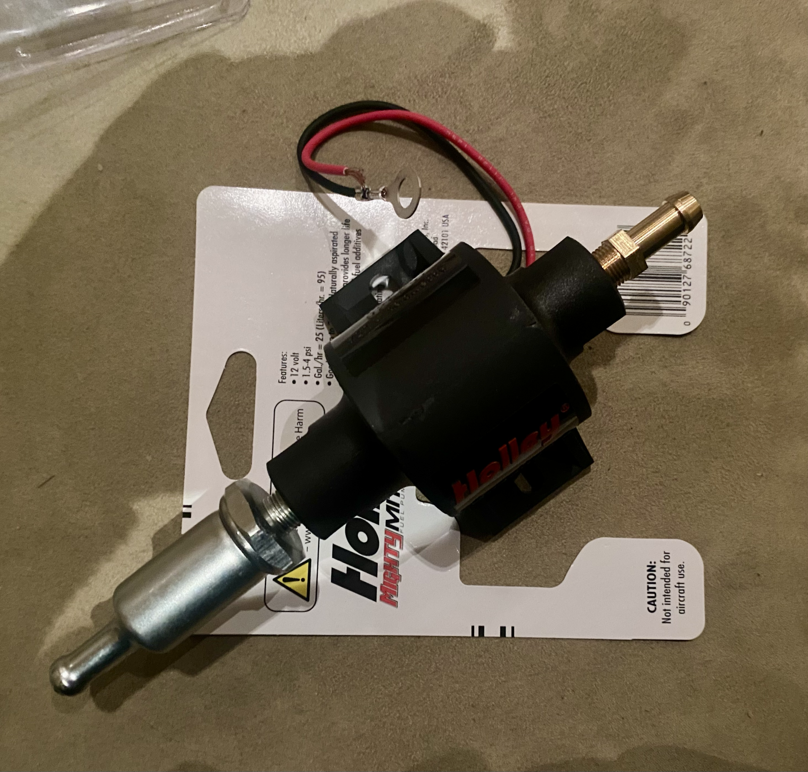

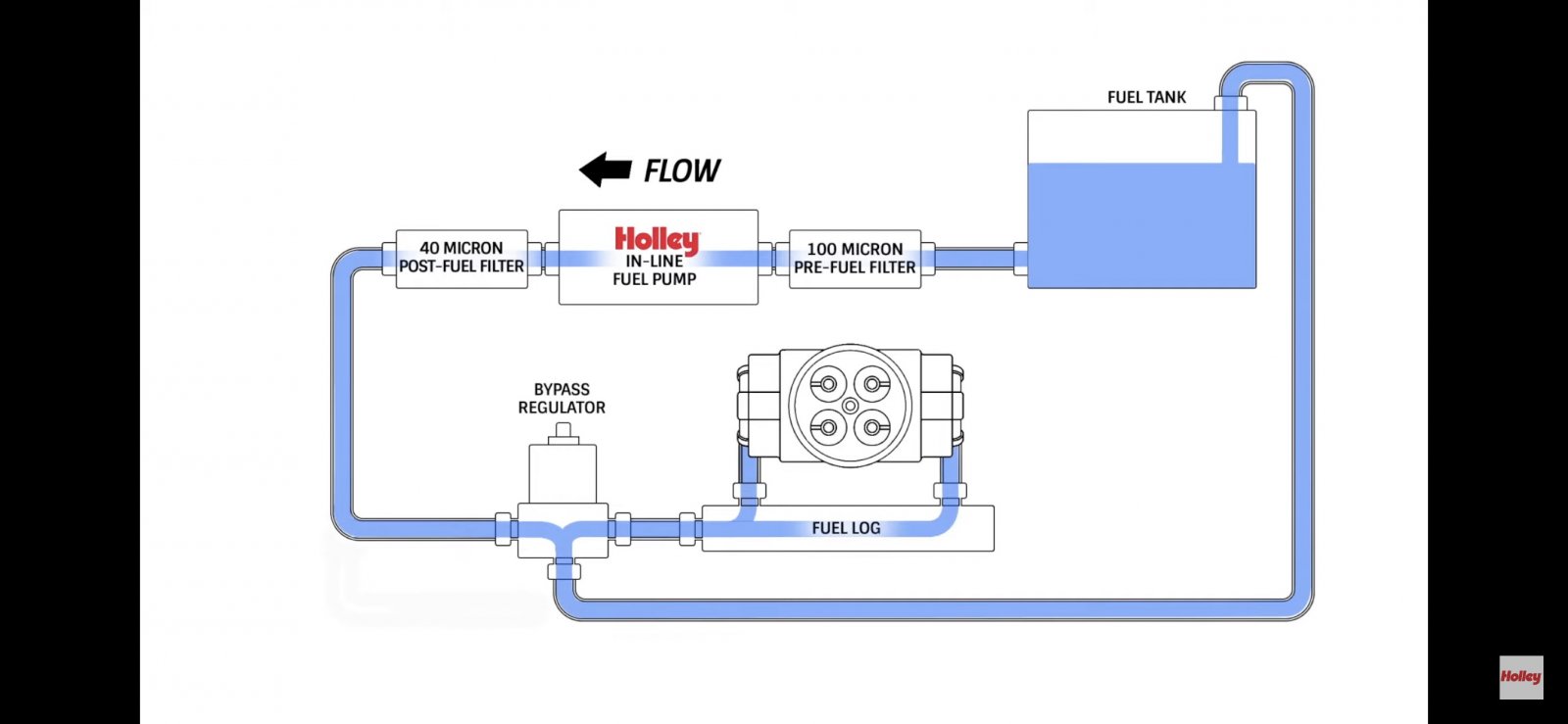

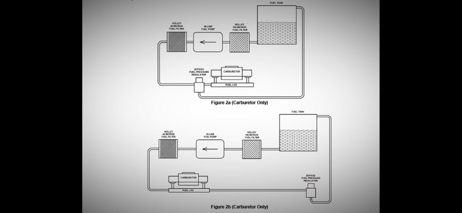

    This is the approximate position of my "push" type fuel pump... I ***ume I will need to block off my mechanical pump? This needs to sit 12" under the gas tank per instructions, and near to the tank... Do I need another fuel filter? It already has a 40 micron one... also should I go return or not? 46EC1C1C-44E4-4A8D-96E9-7467ED29B07F_1_101_o.jpeg
    patmanta and loudbang like this.

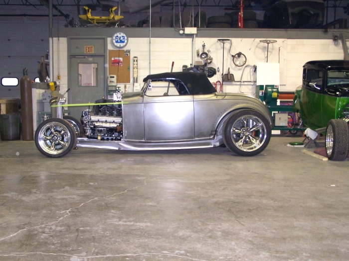

    How do they achieve this side stance? Have they pie cut the frame? I am in love... :rolleyes: @alchemy @patmanta

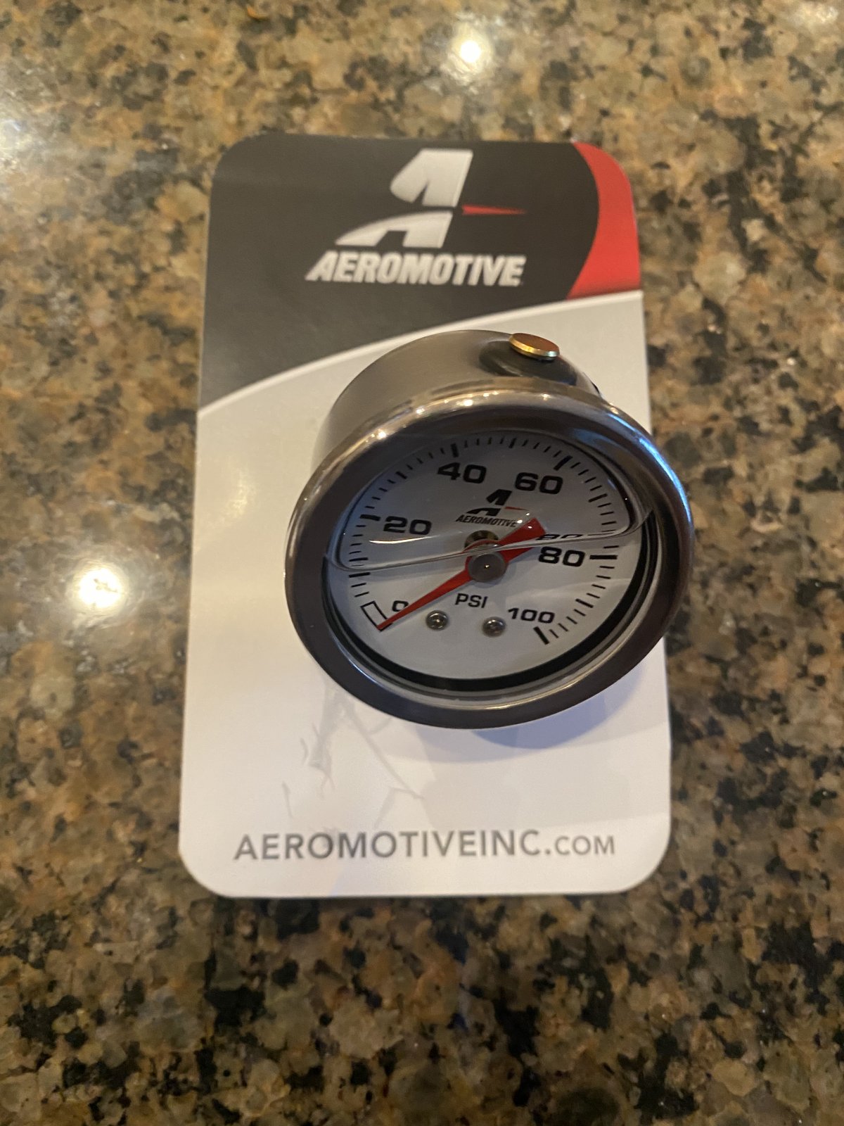

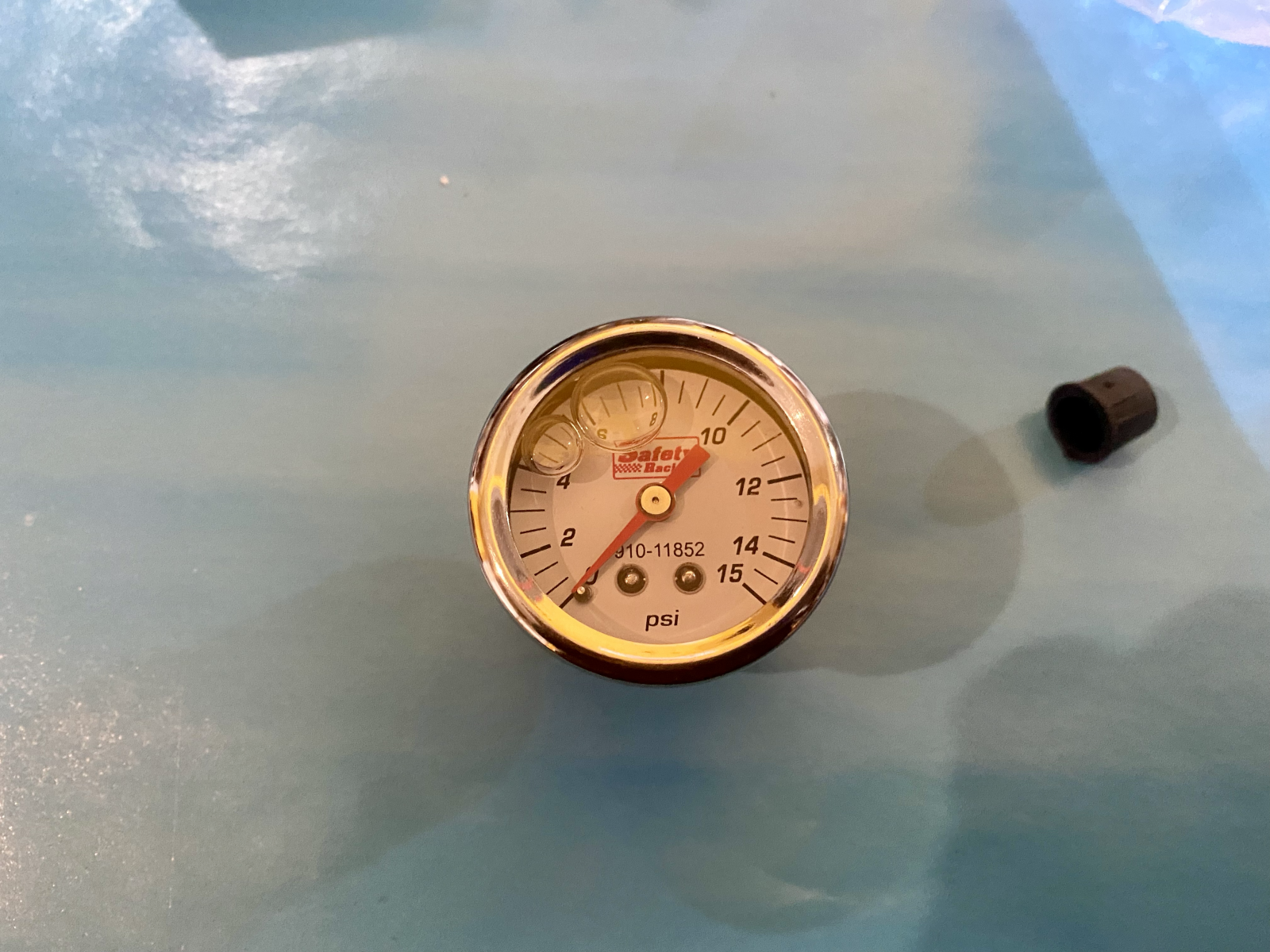

    Fuel pressure gauge came in… yay it’s resettable
  21. alchemy
    Joined: Sep 27, 2002
    Posts: 23,465
    alchemy
    Sorry to say, but that gauge will be basically worthless when you are trying to read in the one or two pound range. Find one of the low range gauges sold by ****ster in the HAMB cl***ifieds.
  22. pennafxu
    Posts: 2,263
    pennafxu
    from Kentucky
    Do you know I didn’t even look at that. ‍
  23. patmanta
    Posts: 3,882
    patmanta
    from Woburn, MA
    You would need to remove the A pillar bracket on the frame and make one to receive said A pillar 6" below the top of the frame rail. If you only want to do this for that particular cowl, just pull the metal over the brackets, the cowl will clear them by the time you get down 4", then put some kind of bracket to place them where you want. You will need to notch the firewall accordingly. The back half of a 27 T touring will mate to the A pillars and line up at 4" btw. You can't really see it in these pictures, but I did do it.
    I would bet that frame is not pie cut and that it has a flat front crossmember, notched frame, and a deep dropped axle.
    pennafxu likes this.
  24. A Boner
    Joined: Dec 25, 2004
    Posts: 8,285
    A Boner
    Put a piece of plywood across frame rails and set your seat on it. Sit on seat and you will be able to judge how much above the Cowl/windshield you will be looking. Move the cowl/windshield up and down to determine the amount of channel/non-channel, you will be comfortable with. If you are under 5’ tall, disregard the above and channel the **** out of it!
    patmanta and pennafxu like this.

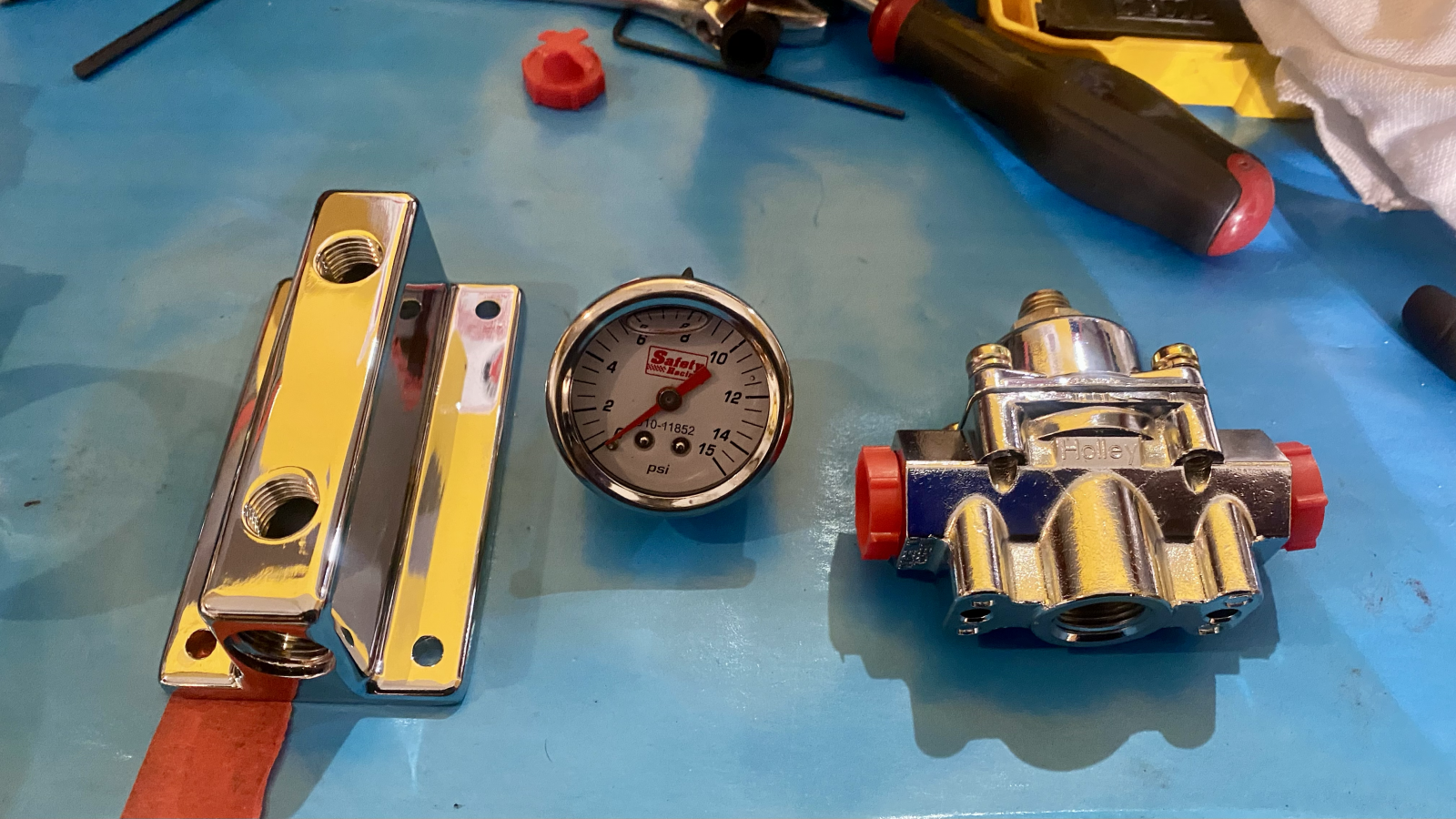

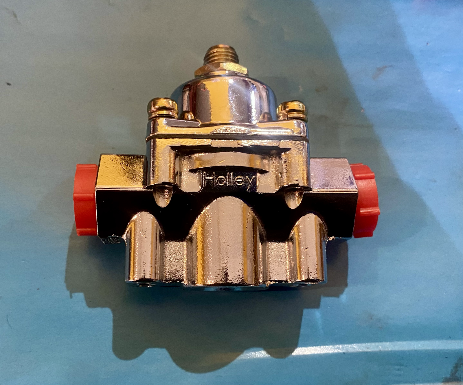

    More accurate fuel pressure gauge and regulator... Fuel block and fuel cell... tempImageVfuf4I.png tempImage1s3IkI.png tempImageZiU02U.png tempImageWPwWm1.png tempImage242MMr.png

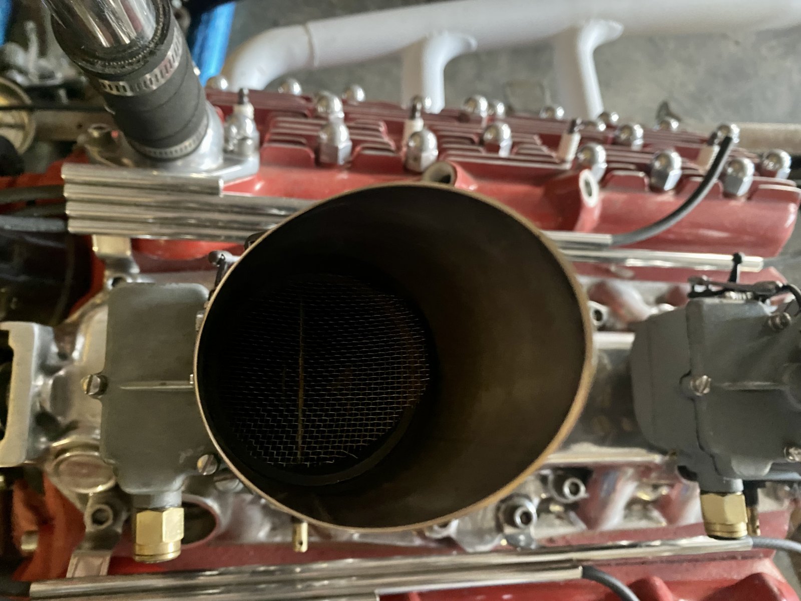

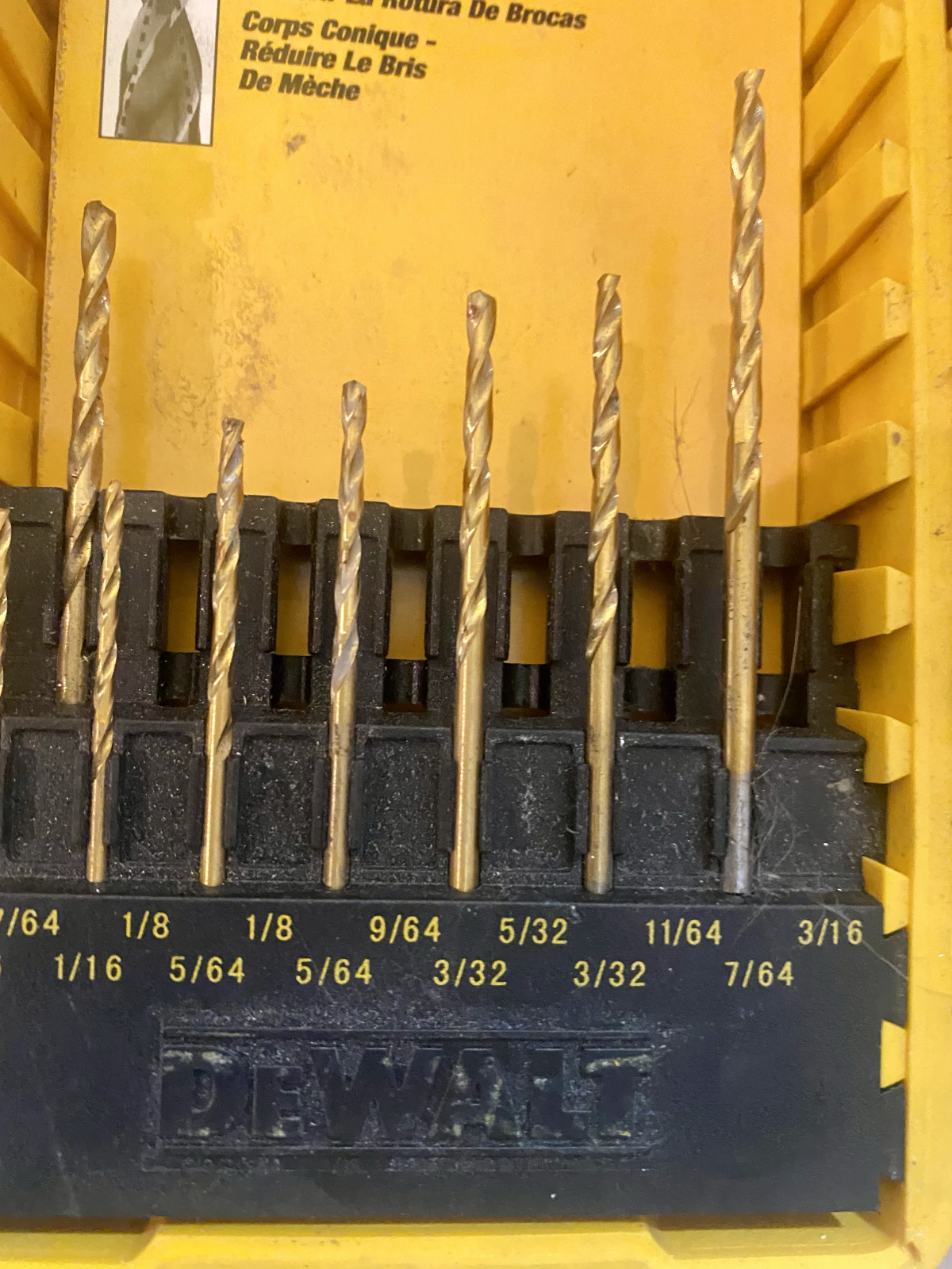

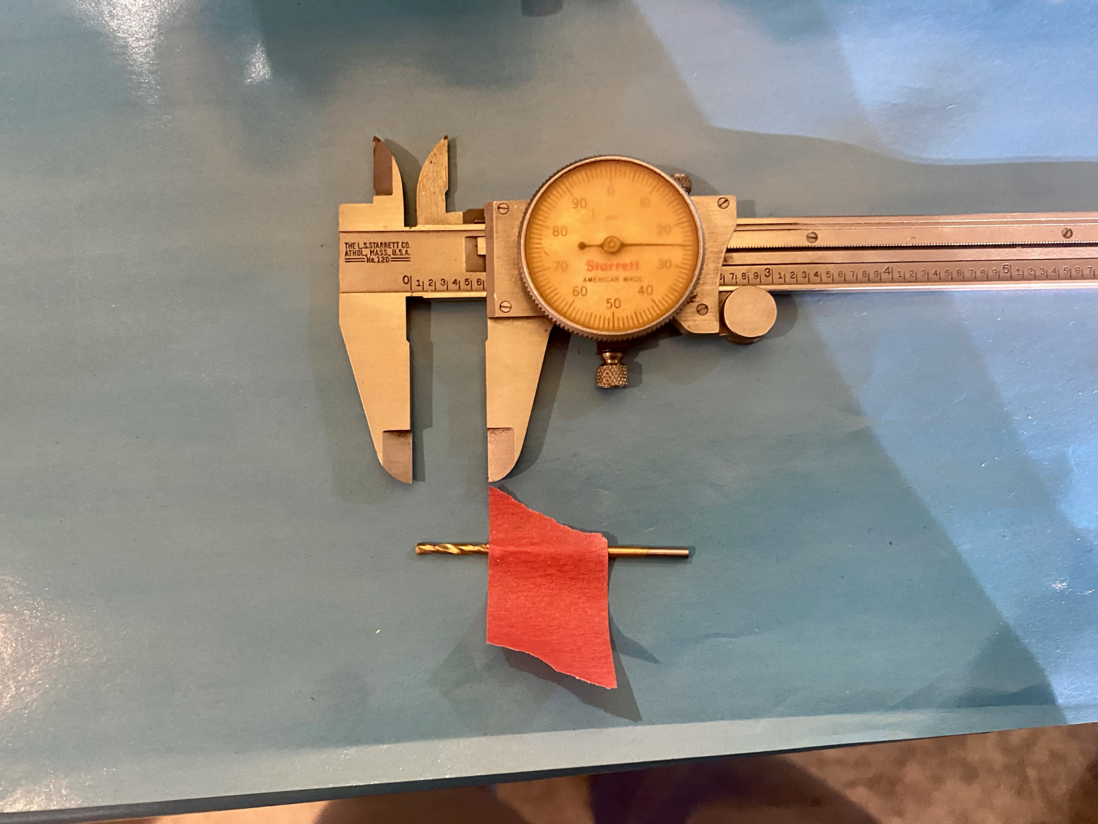

    tempImageZLOq5R.png tempImagenV1R4K.png tempImageextBgT.png tempImageNrLatI.png Got the linkage from Honest Charley's... 3/32 drill bit in the base 5/8" deep. Then the spring is inserted...

    Now for some reason this carb is not springing back on it's own or with the spring... any ideas?
    This is the finished set up, but it doesn't work... :mad:

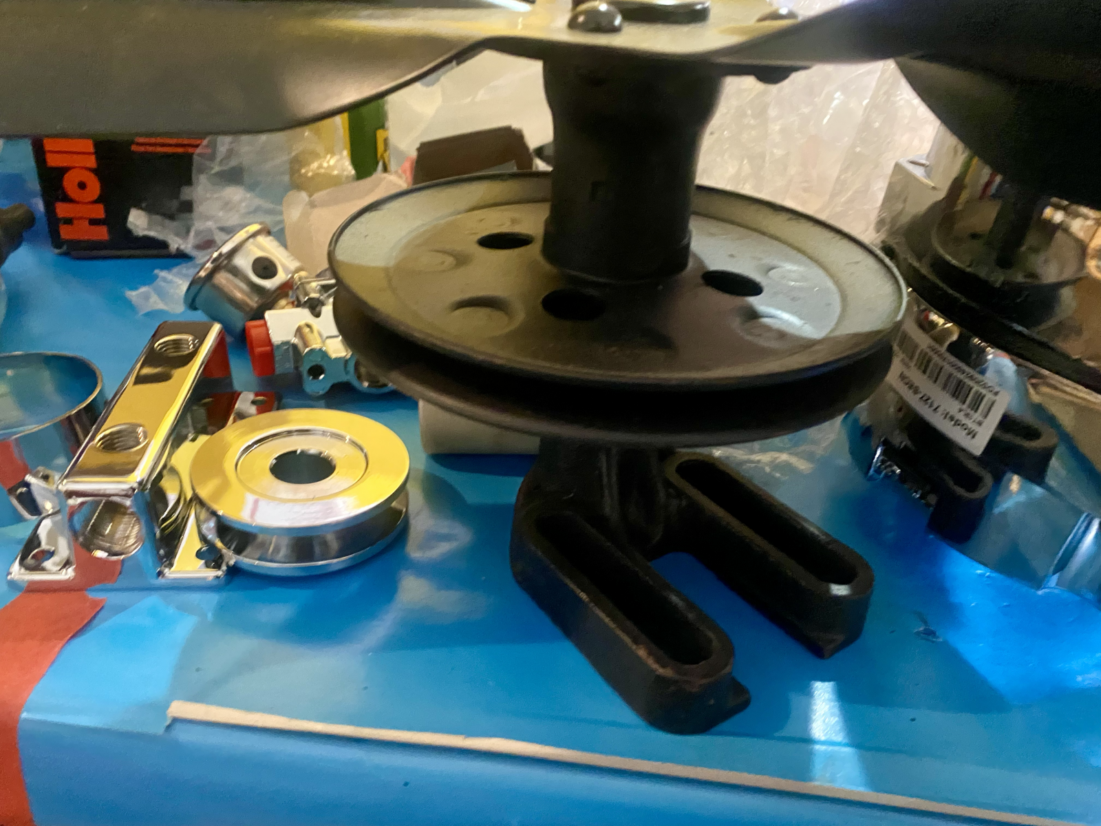

    I mounted the alternator and changed out the fan bracket. This isn't even close :rolleyes: Do I drill the fan? buy a different fan? Ditch the fan? Or is this a dual fan set up... What belt(s) do I need? tempImagesO4nZK.png tempImageDAXzu0.png tempImagelkqDjR.png tempImagezta6Aw.png tempImagejste7t.png tempImagesVCDHX.png tempImageGaRBPC.png
