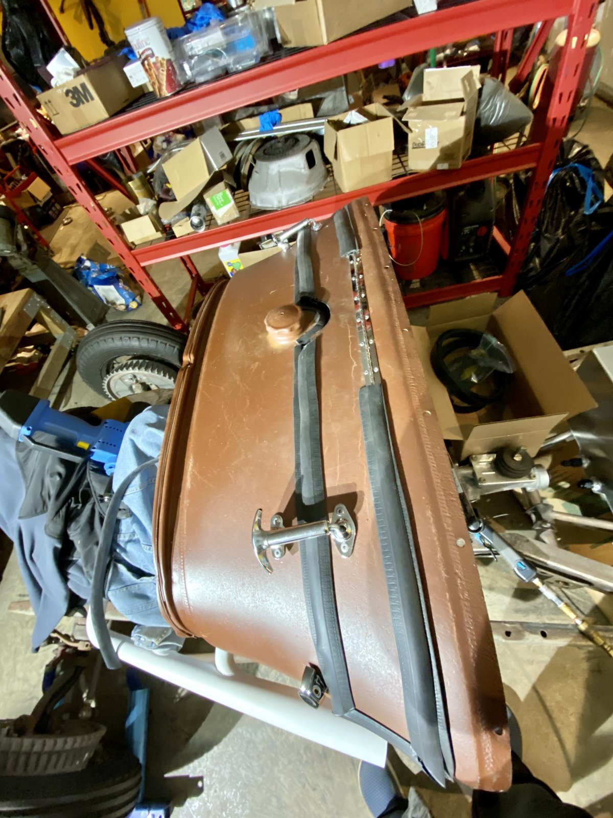

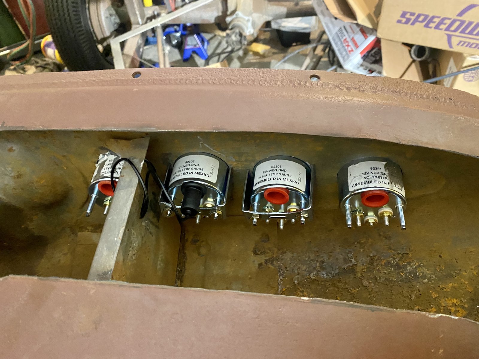

    pennafxu
    from Kentucky
    Finished up cowl frunk. AB538EBF-3ABB-4E5A-9E95-09AF3D11B546.jpeg 1D11BBE7-8606-4DCA-A88F-B1A8D093F9D1.jpeg D33C0656-7C12-4835-B709-B069A44ABAC0.jpeg 4F231F18-791B-4BF8-80D4-BF47AACC288E.jpeg 848B4298-80B9-4564-8628-E429554B6CB9.jpeg
