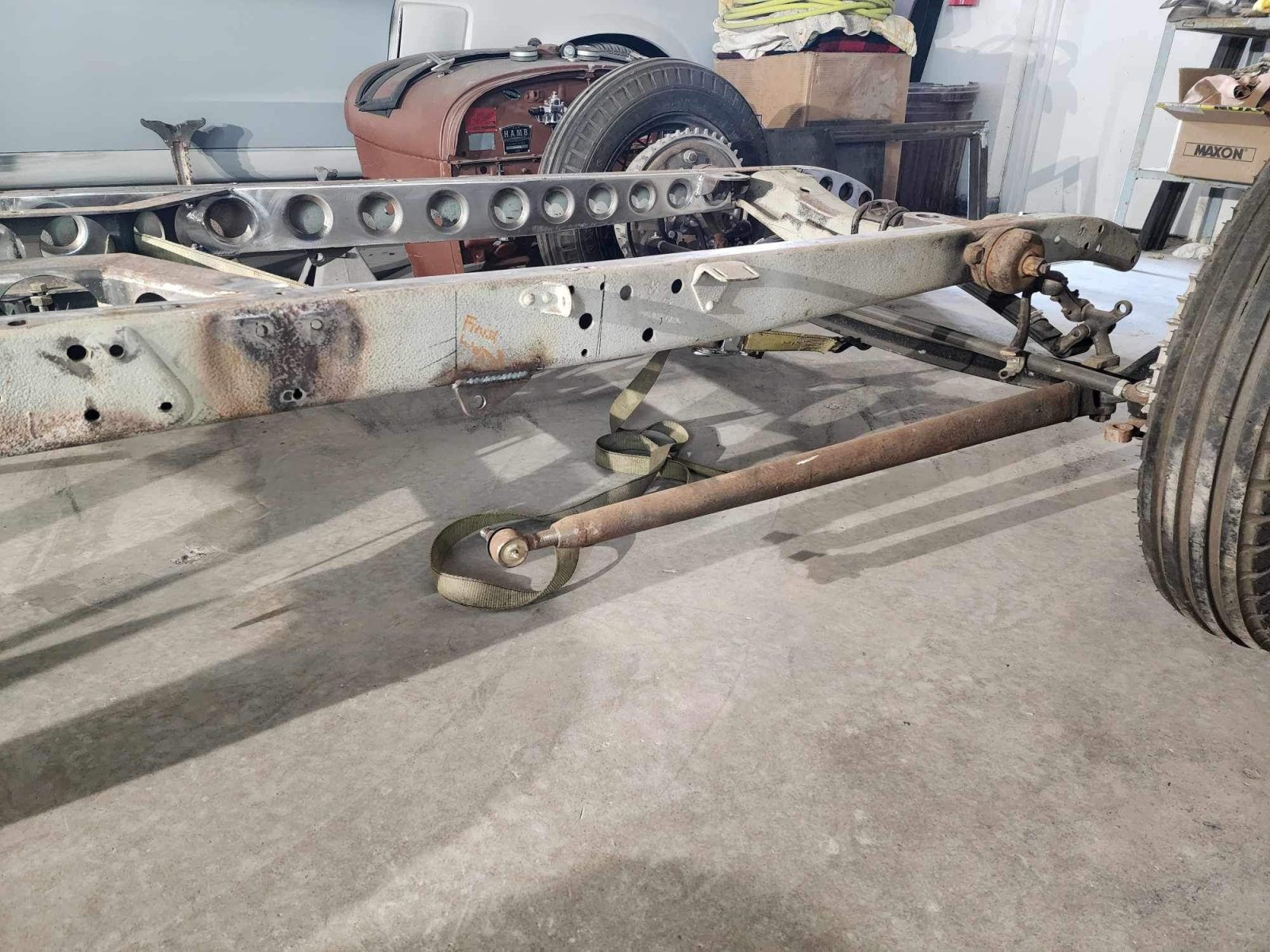

    Finished drilling holes.
    3E9A10EB-3A30-4C35-A005-E4D02A118FFC.jpeg 76D39D9D-4CE1-4545-88BA-FA5539A337AF.jpeg 05F557FB-02D7-479C-8FD0-EE2579CDC199.jpeg

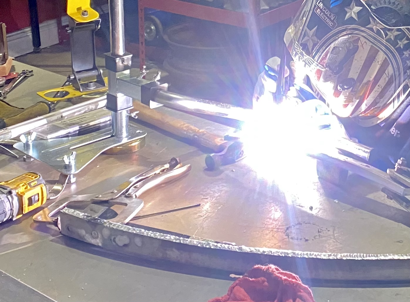

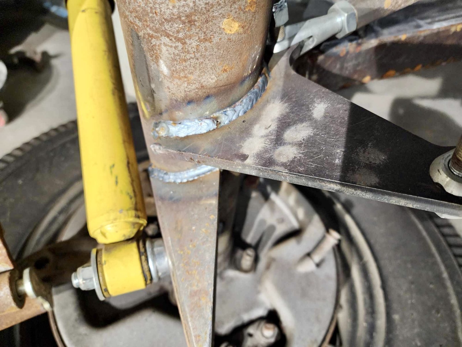

    BD05C909-AF86-4E2B-A8B3-CF7F0346991C.jpeg 4C0B3B08-55E1-49EA-AA63-5CF3E7B2143F.jpeg So started to practice my welding again… starting to practice with TIG and aluminum is a little challenging after 2 years… only one thing to do, and that’s just jump into the deep end! Man the preparation is where it’s at. I welded on some dirty 1/4” and it didn’t even break the surface to ball the tungsten. I’ve been using lanthanated as thoriated seems to be less recommended anymore. At 150 Amps and cleaned aluminum I started to get back in the groove. I had to increase the penetration though :D and turn down the cleaning. I just couldn’t dial it in so I just threw it on auto. I then started to practice on some coupons of similar pieces to the project. Ouch… not so good:(. I’m probably about 1 week away from dialing in everything to not **** everything up. This is a weaving drill…:)

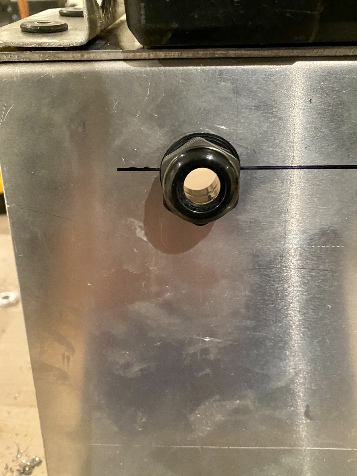

    Also created my through holes for my battery cables… A25D6A5B-80BA-46F0-9F24-8093ED318CEA.jpeg F1D55015-3F6F-4572-87E3-9EA84A7BE053.jpeg F2087E4B-1D29-49C6-B68B-76F28B6615F1.jpeg B7303015-F5C1-4930-A8B6-1A10F4F74DF5.jpeg A1887D4F-8897-49A4-9206-EE9A52A60B3A.jpeg D05C892C-0AF0-4C83-A425-D2A767A576D3.jpeg EC985E38-6FD0-49C2-890B-CB7FC34F3B7A.jpeg

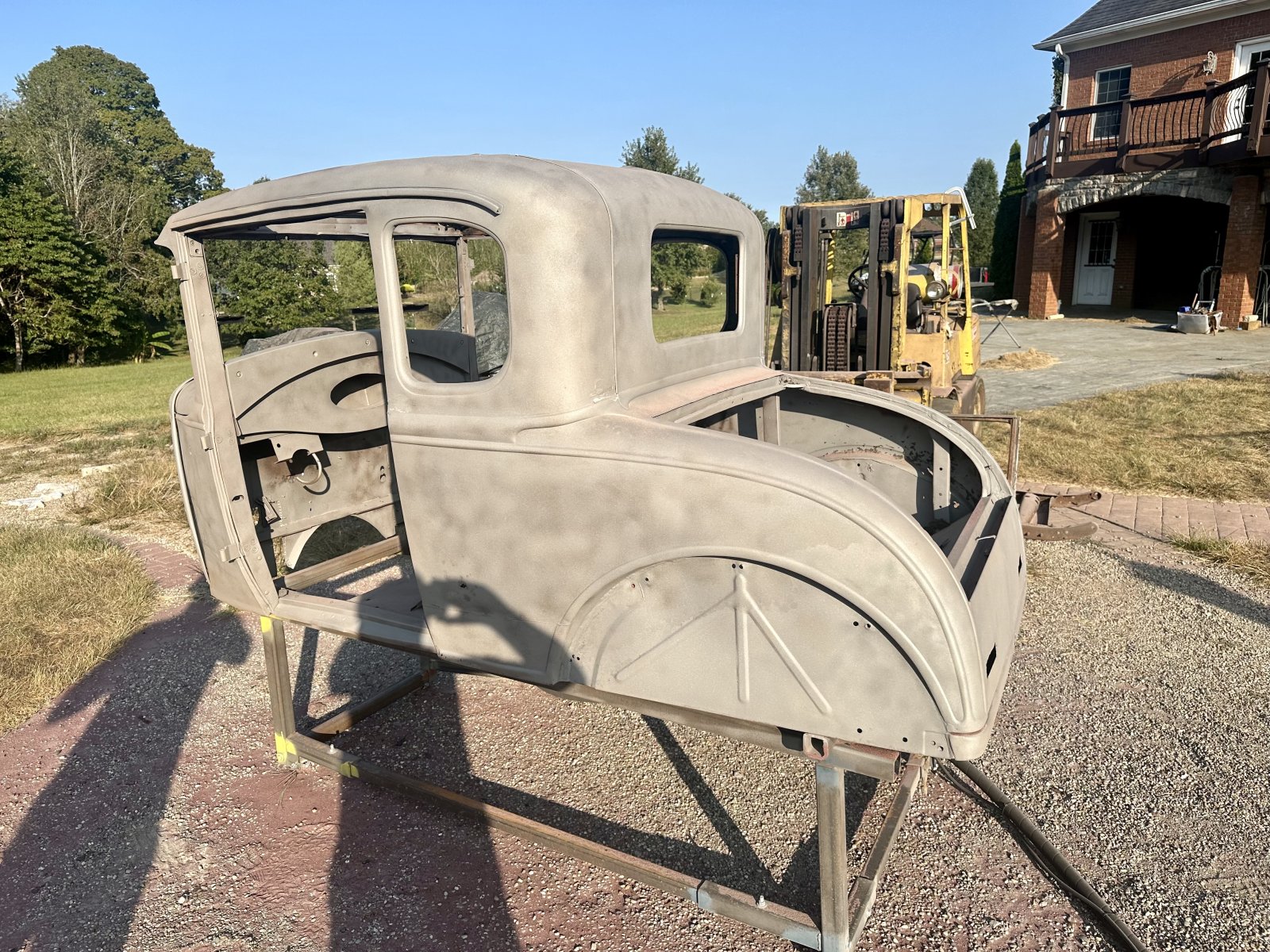

    To the machine shop to dyno the old stalwart... New to me 31 Model A coupe body in the background in great shape! IMG_5916.jpeg

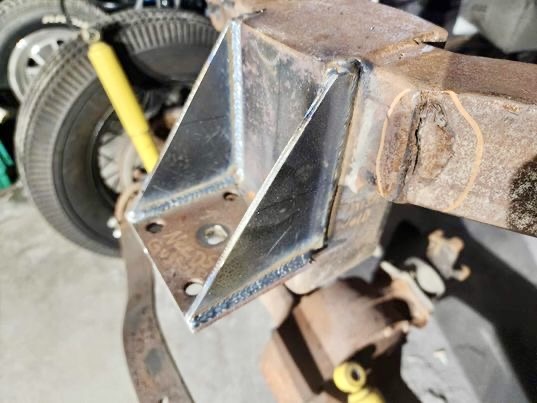

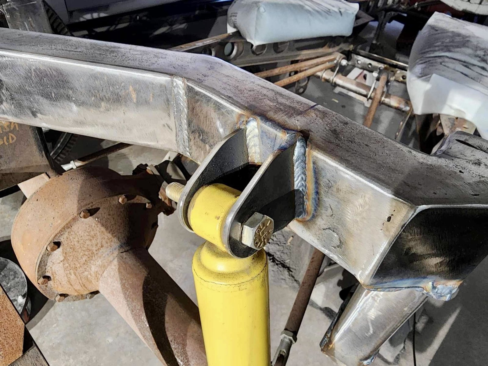

    Fish plates and final welds IMG_6090.jpeg IMG_6091.jpeg IMG_6092.jpeg IMG_6093.jpeg IMG_6094.jpeg

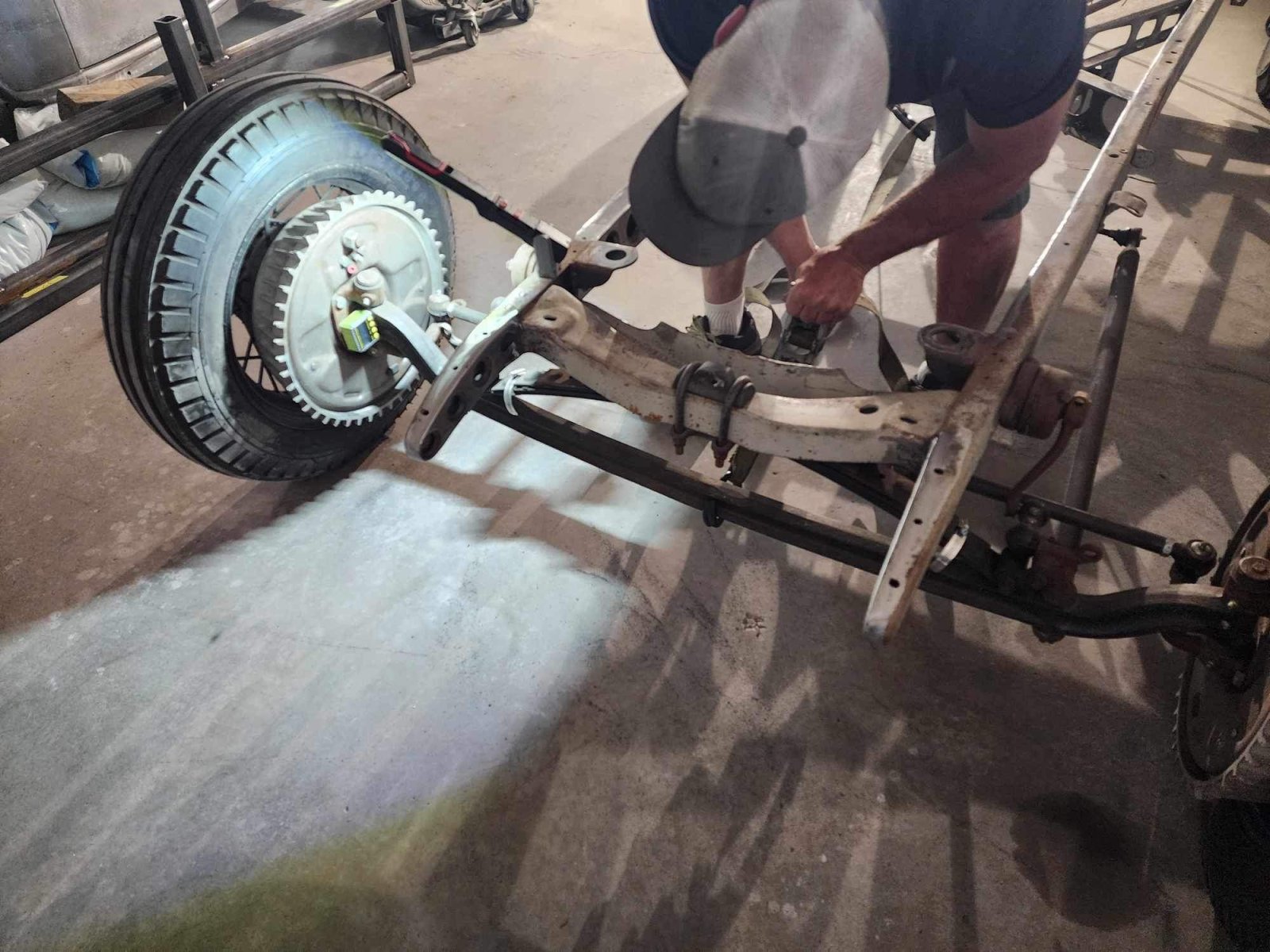

    Figuring the front angles… for final weldment. Killing the houidaille set up. IMG_6107.jpeg IMG_6108.jpeg IMG_6110.jpeg IMG_6112.jpeg

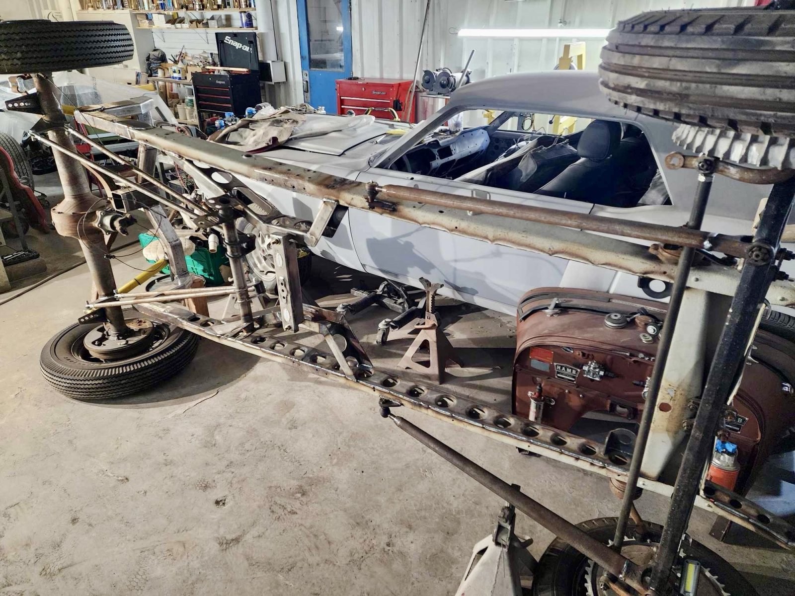

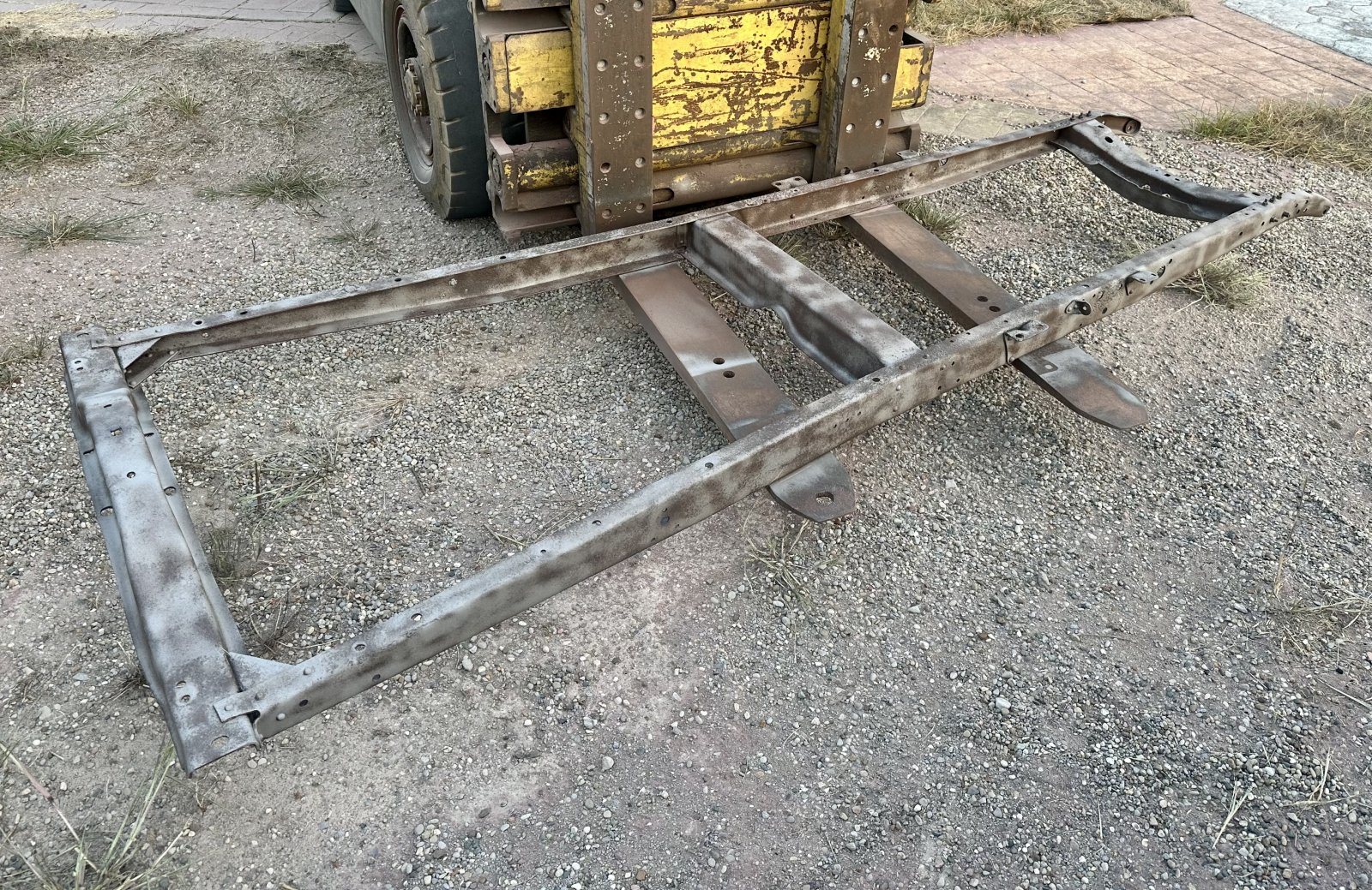

    Blasting body... new frame for the 27' Lots of metal work ahead... IMG_6387.jpeg IMG_6388.jpeg IMG_6389.jpeg IMG_6390.jpeg IMG_6391.jpeg IMG_6392.jpeg IMG_6393.jpeg IMG_6394.jpeg IMG_6395.jpeg

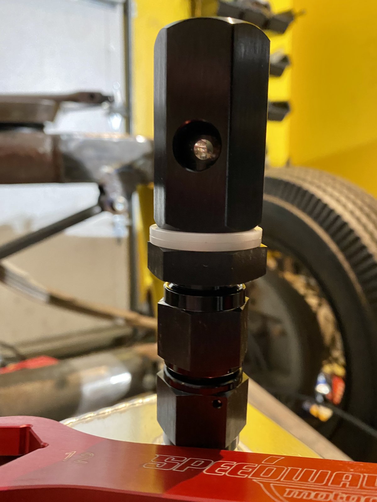

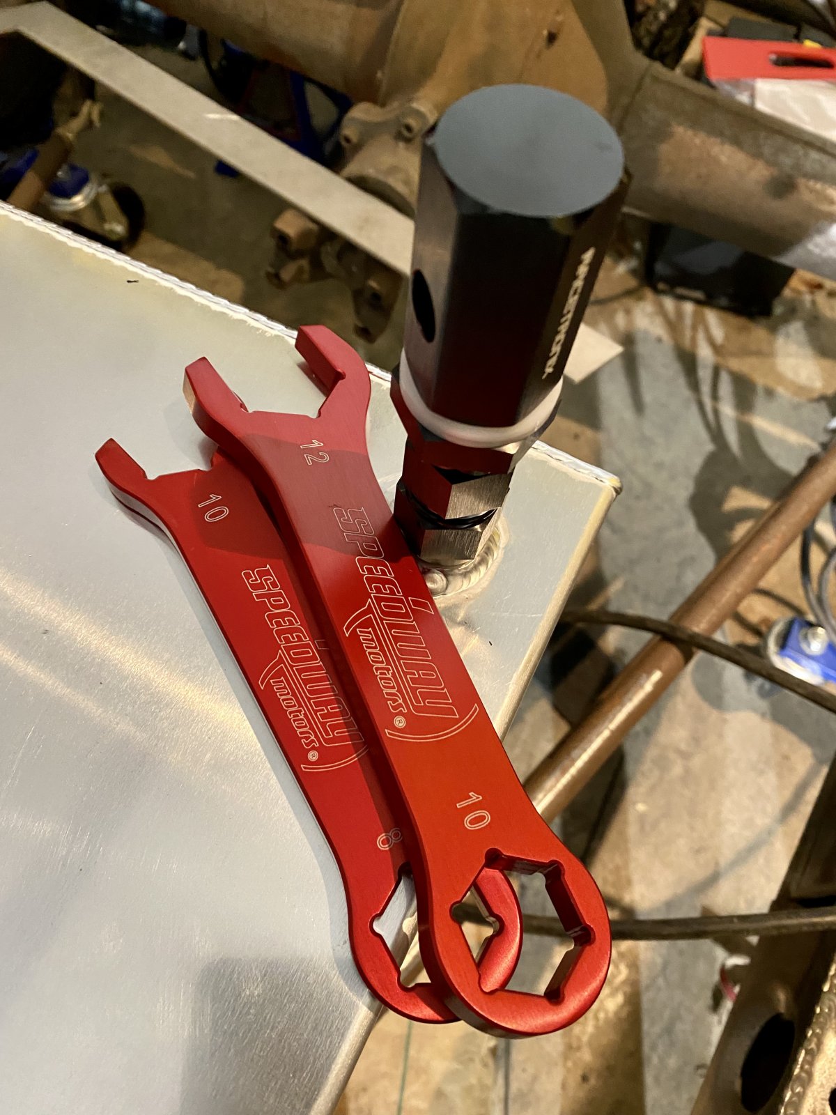

    I think your fuel tank vent is upside down - the body of it is meant to be in the tank with the fitting coming through and sealed by the white washers.
    The ball bearing allows the tank to breath but seals the breather in a rollover.
    pennafxu and Sharpone like this.
