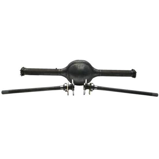

  26. pennafxu
    Joined: Aug 20, 2010
    Posts: 2,263
    pennafxu
    from Kentucky
    Rear end...
    I will need to create a custom drive shaft... Any clues on how I go about doing such a thing?
  27. budd
    Joined: Oct 31, 2006
    Posts: 3,477
    budd
    you need the rear and trans in place first, then any driveline shop can make you up a driveshaft.
