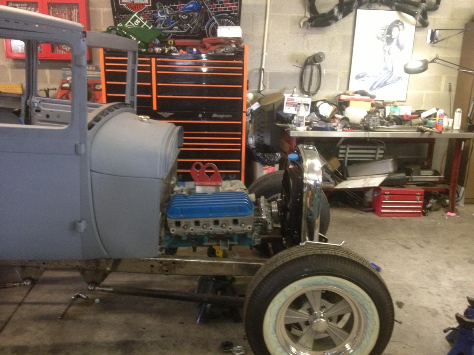

    I'm just starting my '30 Tudor build with a 302HO from a Ford Thunderbird 1992

    Here's mine 30 yrs ago. Garden wheelbarrow firewall, drag link 66 mustang steering box, pics yesterday and today.
