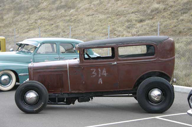

    I am having this dillema as well but I'm thinking traditional Hiboy style. On top of the frame, no fenders.
    I love this car! Whoever owns it, I would like to see more pics!!!!

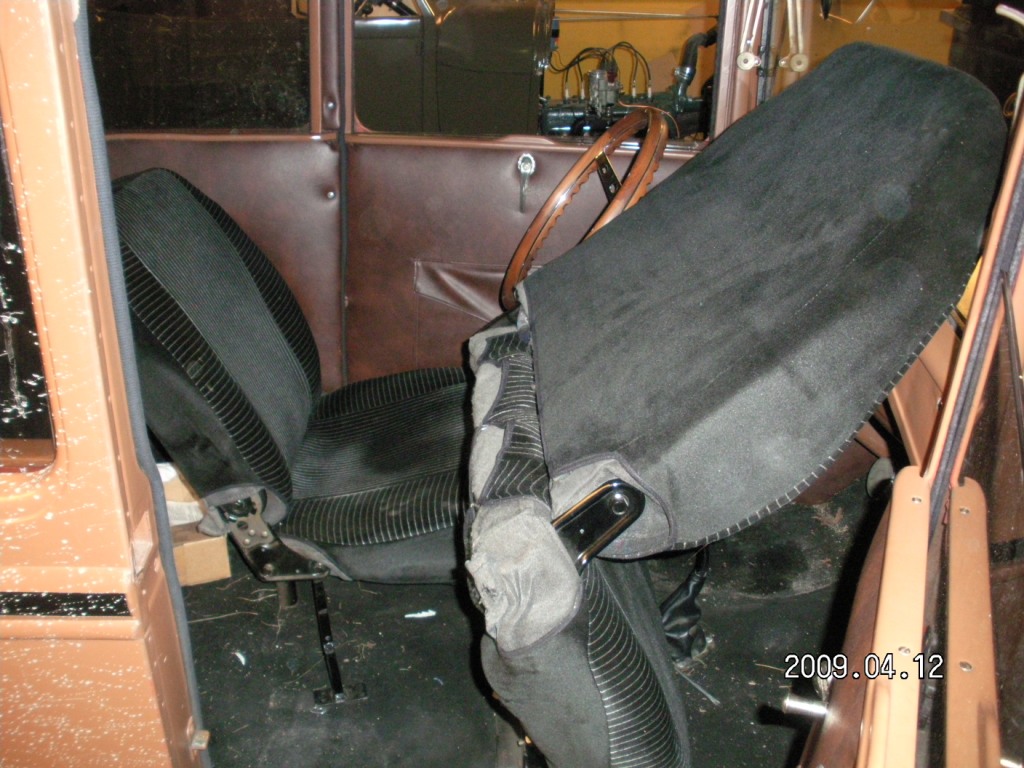

    Heres mine, stock body on -32 frame. 5" dropp axel, reverse eye, volvo rearend and coilovers in the back.
    I have Hyundai Atos back seat in the back, no mod to that to make fit, Hyundai atos split backseat in front to, only norrowed a littel bit in front of the seat and on the top of the seat to make the uppholstery to fit and the door to close.
    The best of those seats are that they have a metal skeleton in them so they are very stiff and dont need any more metal to it, they have "hings"
    som you can flip them forword to make the entrence to the backseat.
    I vill return with some pics, cant get it to work this time.
