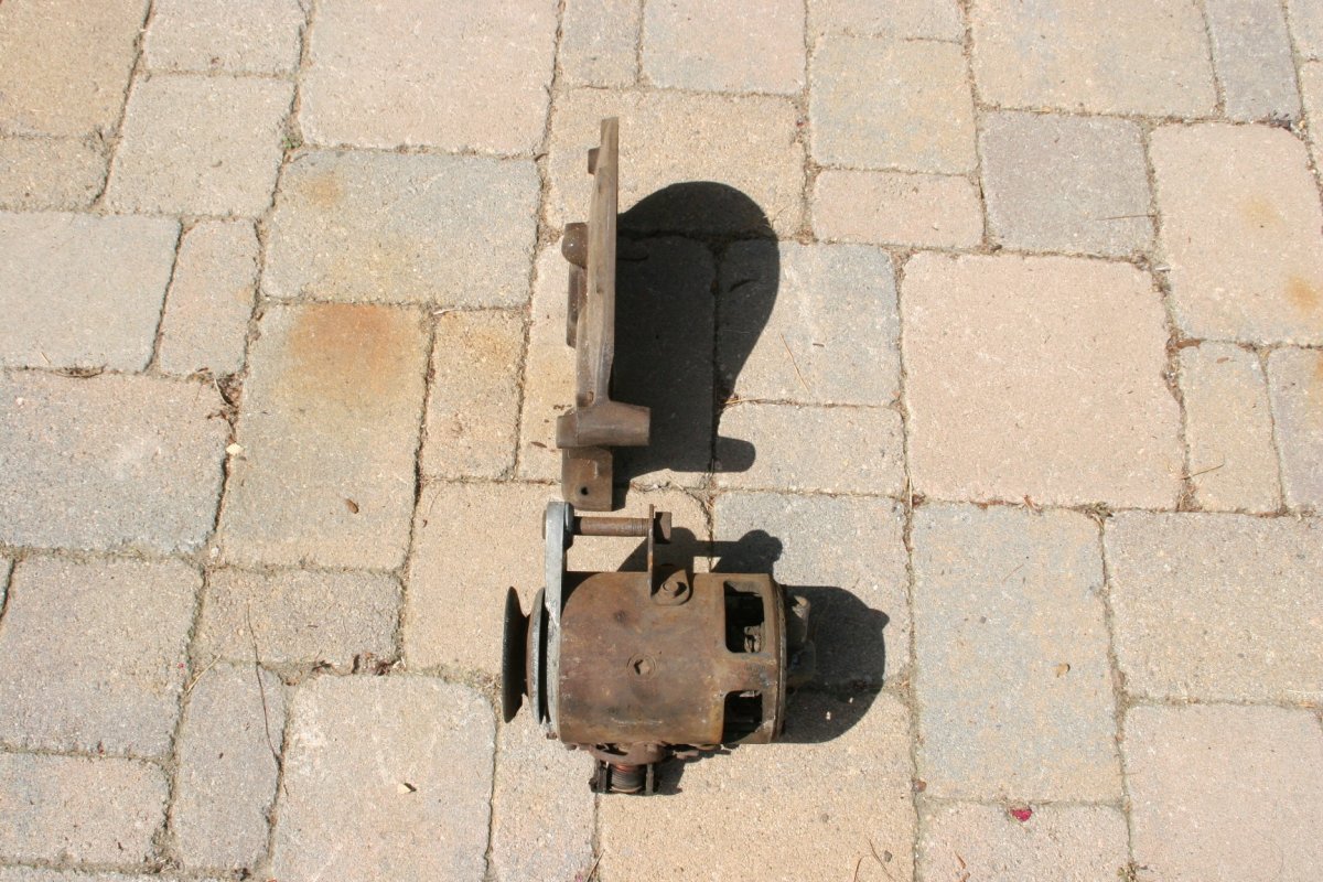

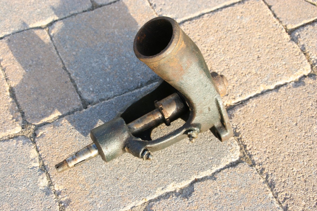

  5. A couple of pictures. First a 1932 water pump. Compare this with yours, the grease fittings should be closer together on yours if it is a 1933-34. IMG_5480.jpg Second is a timing cover and generator from a 1933-34. Note that the generator mount is moved back about an inch from its location on a Model A. IMG_5512.jpg Not shown is the shorter crank pulley.
    Charlie Stephens
