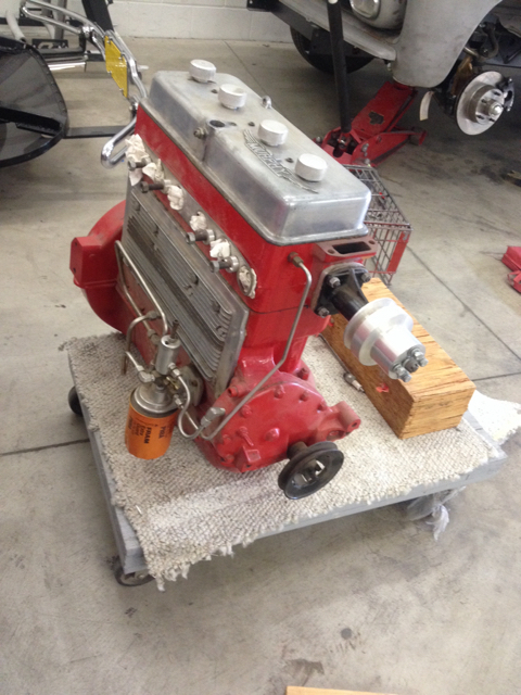

  11. I want to see some pics of that Murphy head. That's a brand I don't know

    ImageUploadedByH.A.M.B.1455305025.106768.jpg ImageUploadedByH.A.M.B.1455305047.623468.jpg ImageUploadedByH.A.M.B.1455305064.537913.jpg ImageUploadedByH.A.M.B.1455305080.183847.jpg ImageUploadedByH.A.M.B.1455305093.782959.jpg ImageUploadedByH.A.M.B.1455305110.381822.jpg
    I don't know anything about the head. The motor was built 10 years ago by a guy in Texas. I will try to track him down and see if I can get some engine details
