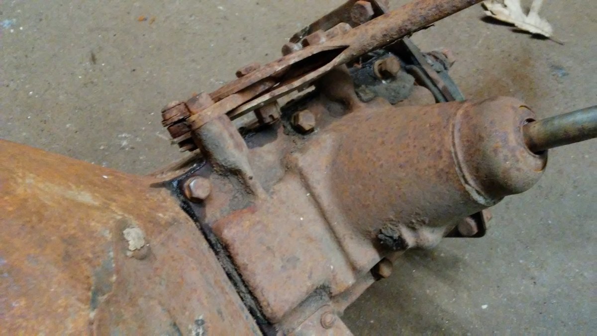

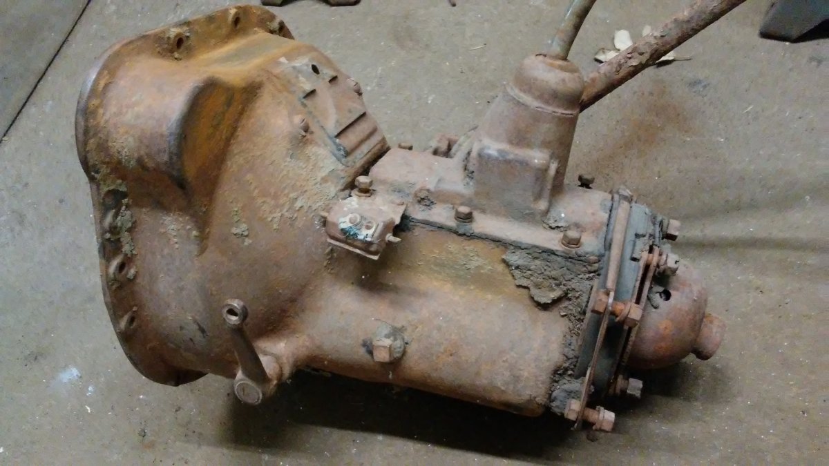

    I'm trying to figure out what I have here. It was sold as a '32 truck transmission. I'm ***uming that's incorrect. I can't find any numbers besides the 3.
    kidcampbell71 likes this.
  2. Will Kimble
    Joined: Feb 12, 2007
    Posts: 407
    Will Kimble
    Looks like a '32 Model B trans to me. Serial # would be on the upper flywheel housing, not the case.
    Beau likes this.
  3. I agree with Will. It looks like a Model B transmission used in p***enger cars and light commercials (pickup trucks). It is definitely not the "big" (Model BB) truck transmission (which is probably good). The '33-'34 4 cylinder transmission is the same except for the rear mount is different and the shifting tower will not have the place to attach the emergency brake.

    Thanks. The brake handle forged into the cover is what threw me off.

  7. If you will find any number it will probably be a casting number that won't tell you much. The two threaded bosses on the side of the shifter housing were '32 only. If you change to later gears you may need to change the housing. Gears will fit all the way to '39 with the '39 and up being the best. The expert on transmissions is Mac VanPelt and he posts on HAMB. His company address is

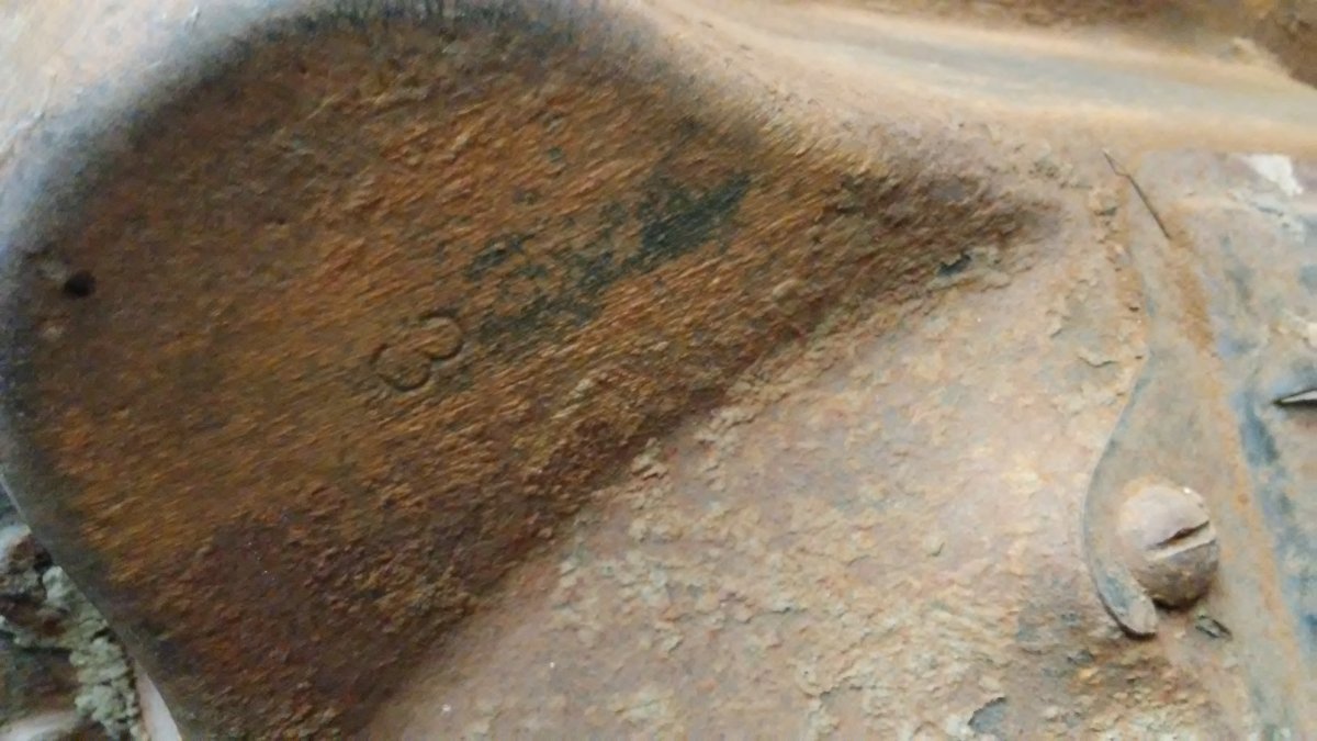

  9. Where on the flywheel housing?
  10. studebakerjoe
    Joined: Jul 7, 2015
    Posts: 1,179
    studebakerjoe
    There should be a cast in pad on top near the opening for the starter with the numbers stamped into it.

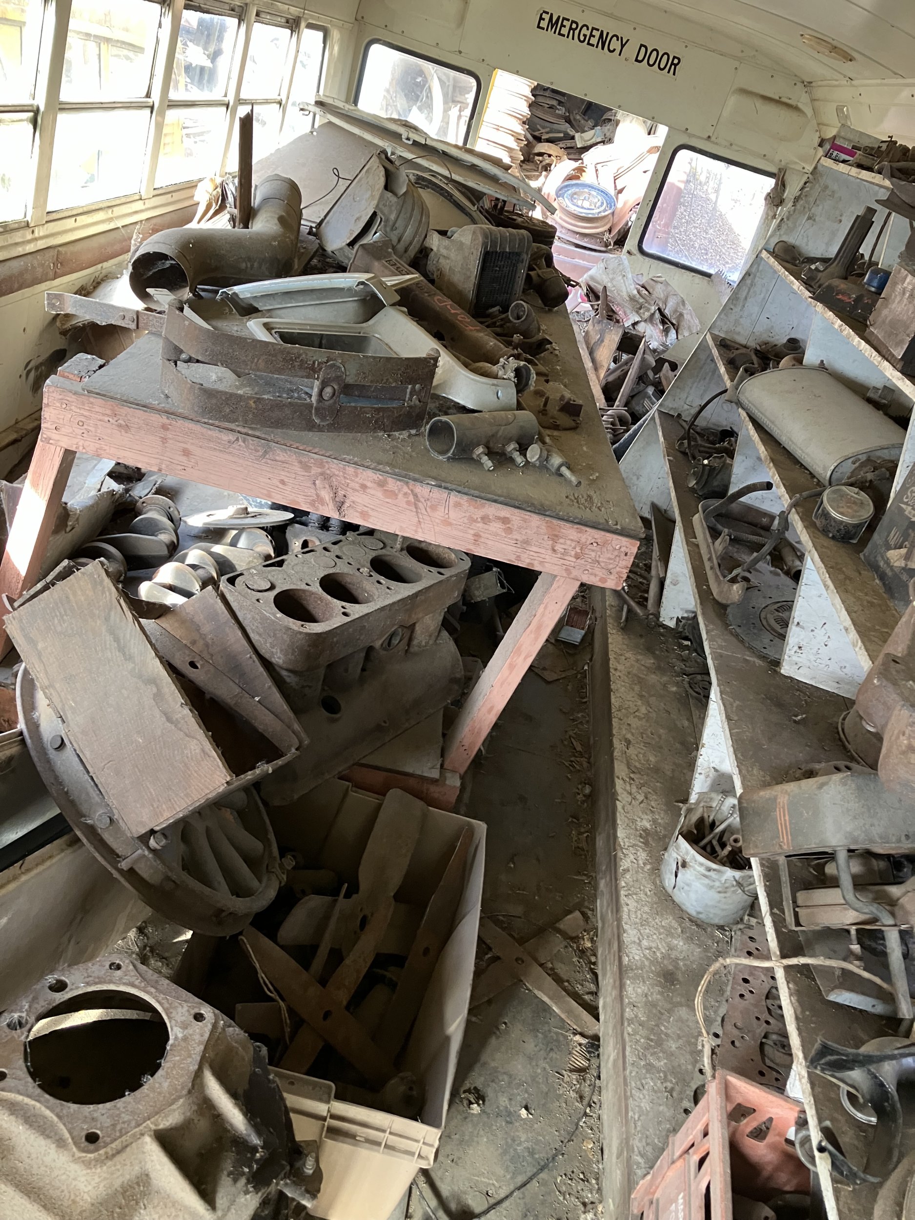

    and you will need the B top half of the flywheel house.

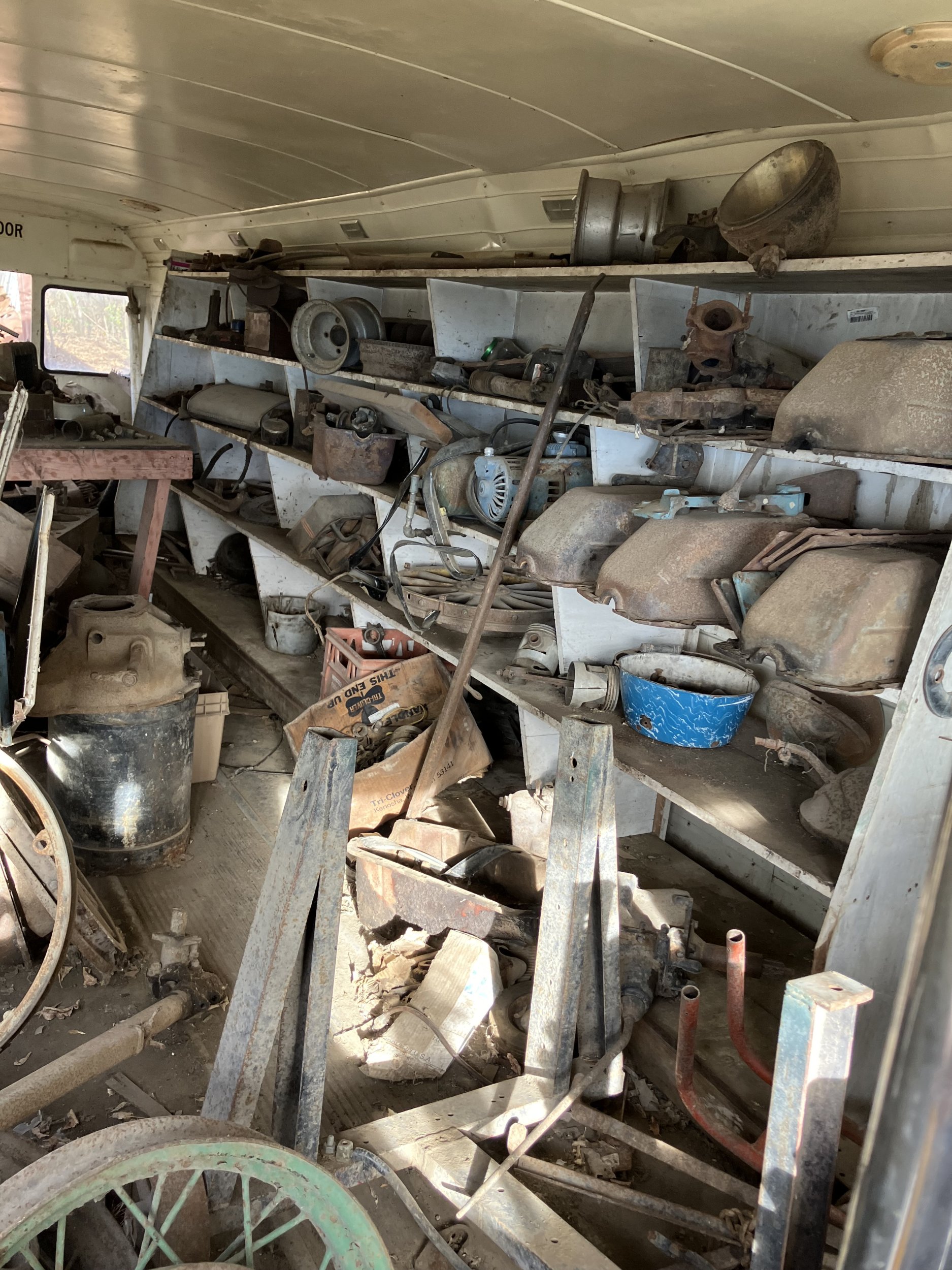

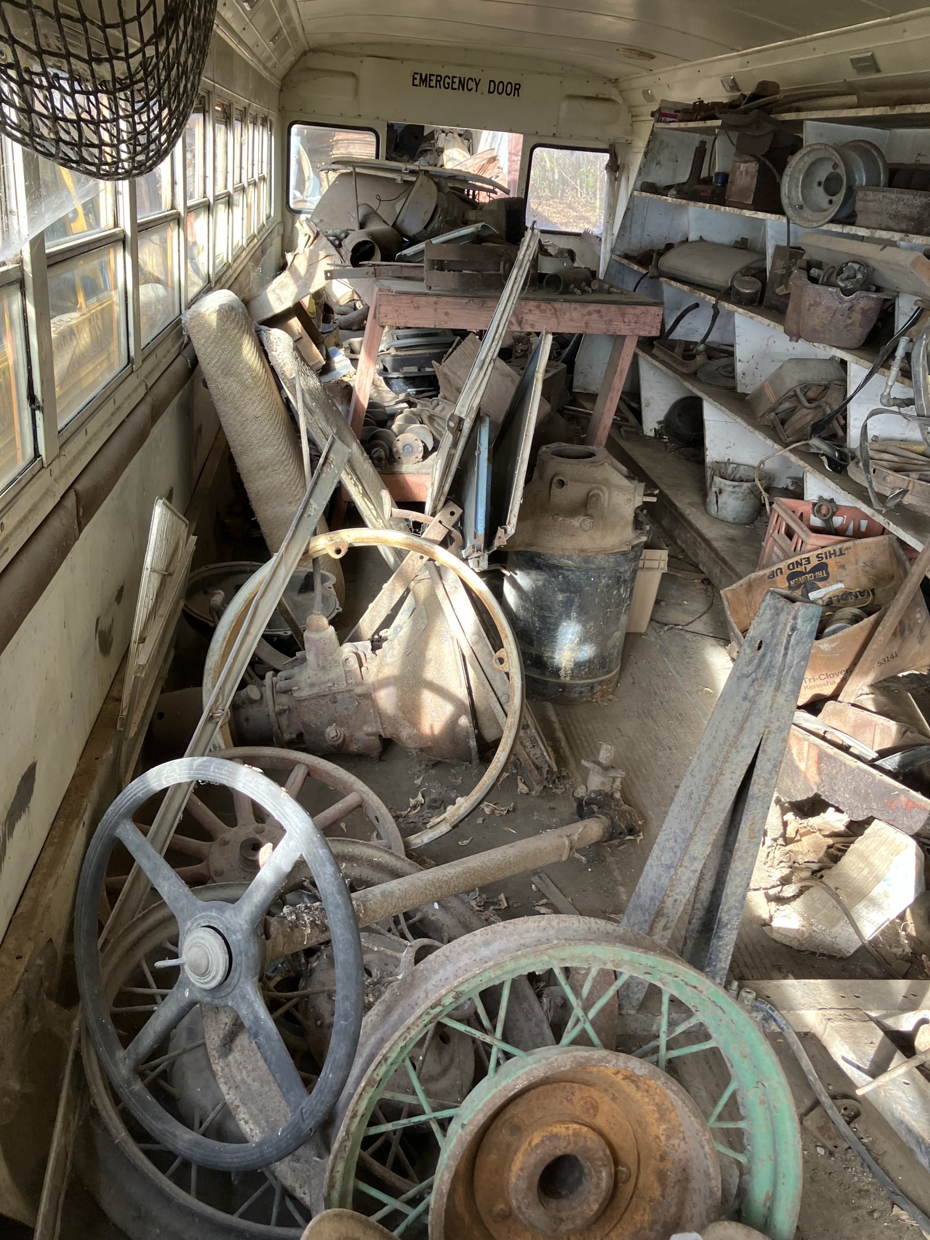

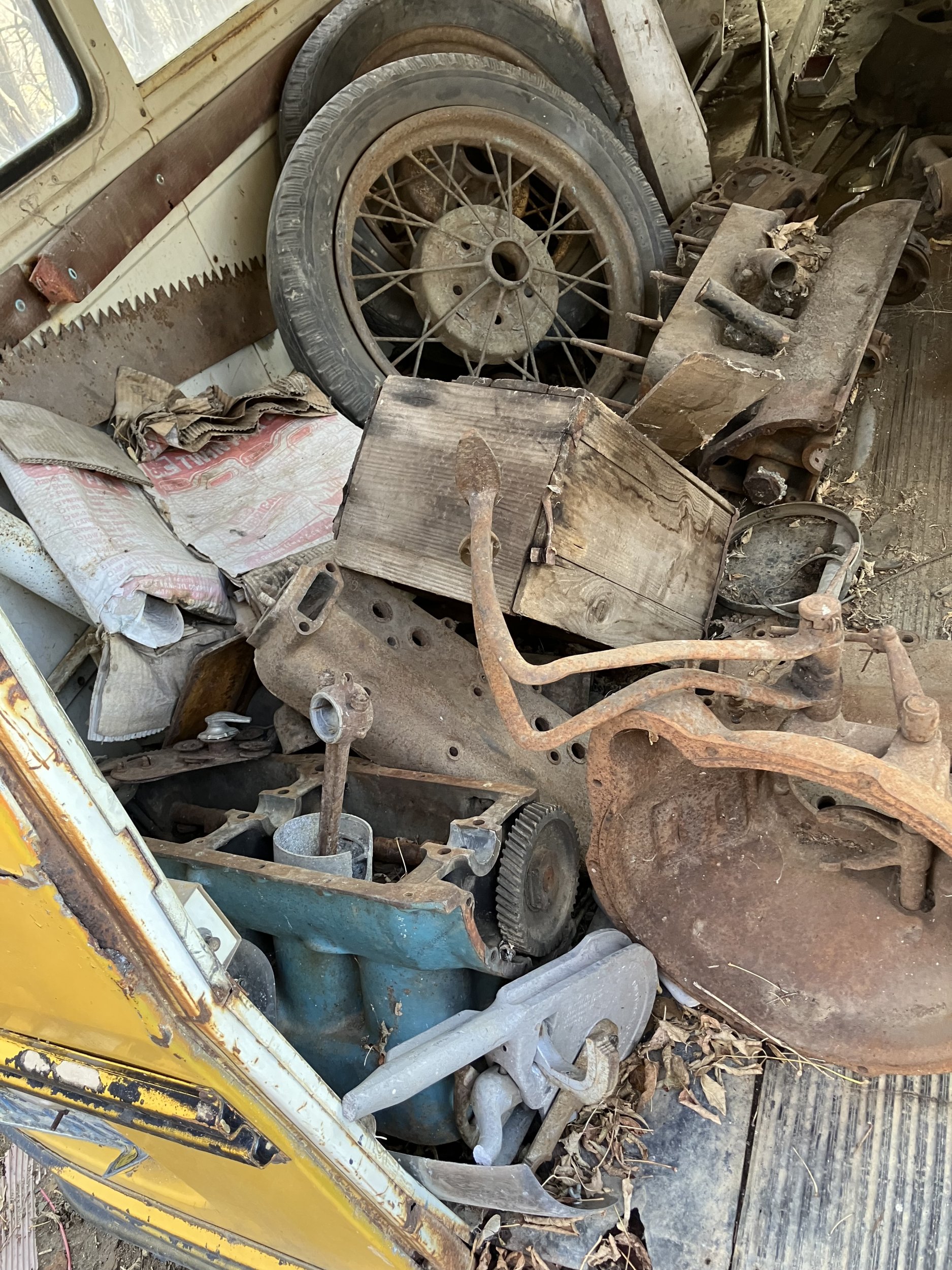

    Have you climbed around in the school bus at french lake? there could be something still under all the A stuff.
  13. brjnelson
    Joined: Oct 13, 2002
    Posts: 636
    brjnelson
    Photos taken last November
