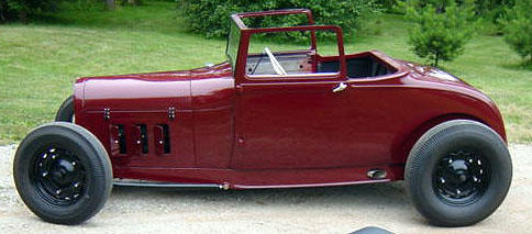

    Here's a steel 23 body with a narrowed 29 cowl grafted on, not so much for looks as for ergonomics, (with a floor on the bottom of the deeper 32 rails there is a little bit of footroom). The front end is done, but the project is leaning against the wall for now as I stole the engine to use in an old sprint car, which did, amazingly, get done.

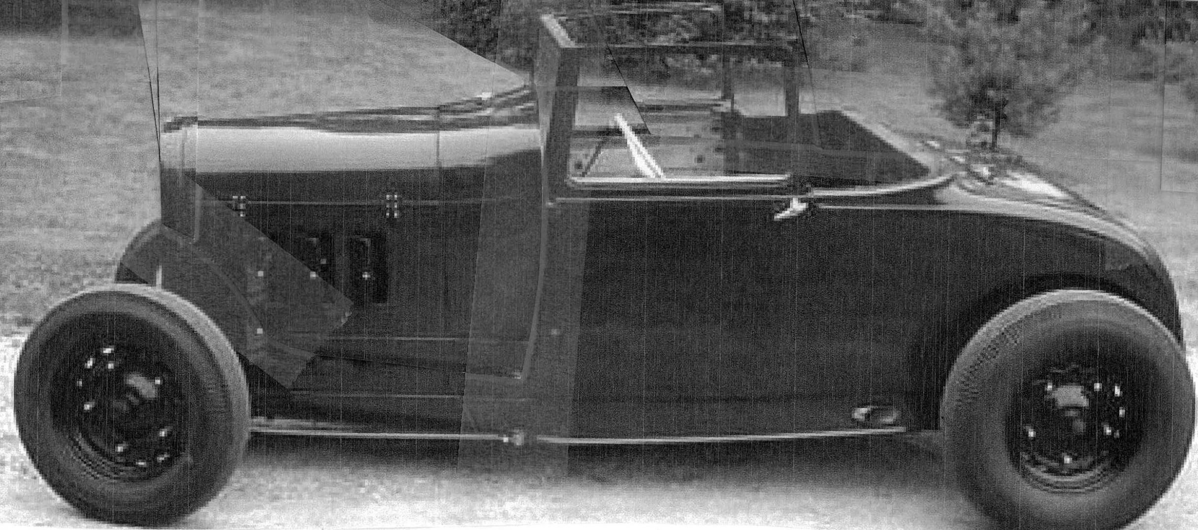

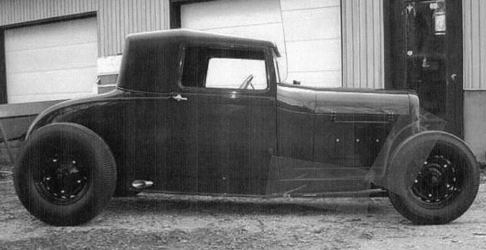

    So far, my best sketches (ha ha) are cut n paste deals based on Clarks Sport coupe (he said he didn't mind, really). Here are a few for you to get the idea, with the cowl raised just a little. Using a late T / early A cowl, it's a bit harder to determine just where the seam in the tank cover and cowl sides should be placed in relation to the belt line contour. That's why I was thinking about using a later A cowl. But the early, small cowl doesn't look so bad raised a little, either, eh? I'd guess a 2 or 3 inch rise in the cowl would not be so drastic to look wierd. I believe Clark had already chopped the top a little on his build so I didn't change that in these paste ups. He also laid back the windscreen a tad and curved upper door frames which I like a lot, too.
    I also plan to build the car low, regardless if it sits on the frame (probably a 32) or is channeled and I'd also drop the floor and toe boards in front of the seats to a level equal to the bottom of the frame rails for added leg / pedal / steering room, ala vintage race cars. Gary

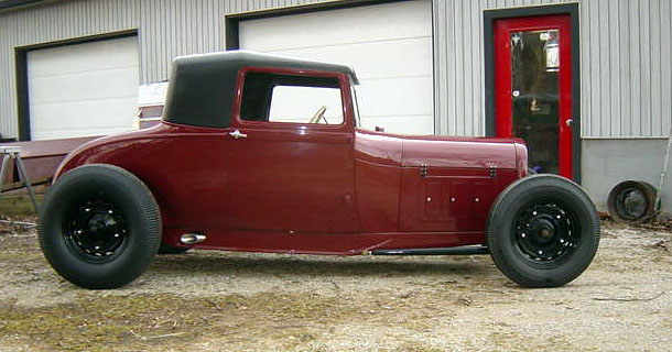

    here is one a local guy had at a show here.

    i like the looks of that coupe. works well together!
