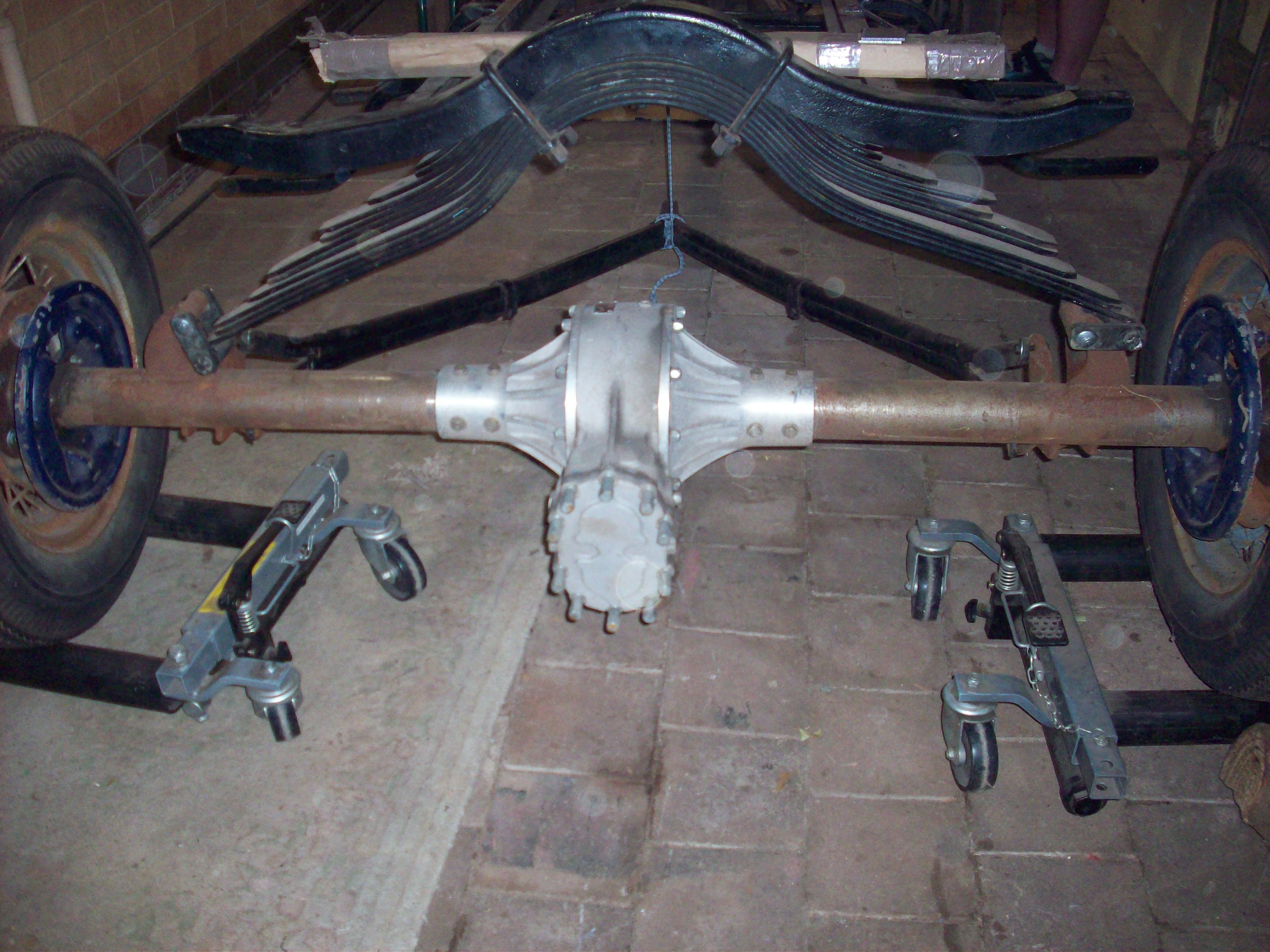

  8. fartman
    Joined: Sep 30, 2009
    Posts: 60
    fartman
    from adelaide
    the rear spring mounts will need to be moved further apart to fit the spring properly,as this rear end came out of another car. does anyone reconise the T front end as i havnt seen one like this before.

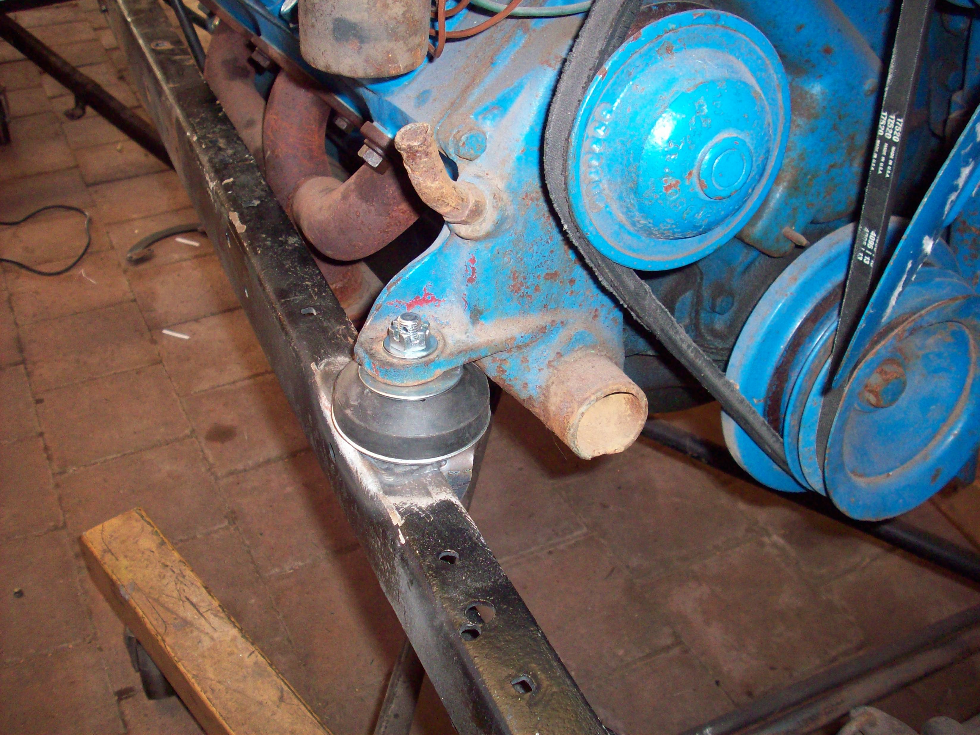

  9. fartman
    Posts: 60
    fartman
    from adelaide
    engine mount.

  10. Asphalt Demon
    Joined: Jan 19, 2014
    Posts: 362
    Asphalt Demon
    from Australia
    That is a stock T front with accessory shocks of some sought,I have seen lotsa different kinds.but am not a T man, post a thread and someone will identify them. I will try email you some pics. Is your email Australian because it would be almost impossible to register with t rails and the v8? Or is this a race car? My chassis is stepped 10inch in the rear and I am running Schroeder sprint car steering . Johnny

    The shroeder steering is still available brand new around $600 last time i looked. they do pop up on ebay occasionally. mine came from an old sprint car friend.
    If that is on the expensive side for you, look at alternatives like f1 boxes, a lot of early push pull boxes can be converted to cowl type steering. a friend has a hk box in his 32 he used as well as it was cheaper.search on here i,m sure theres lots of alternates.Looks like you have just enough room to run lakes headers? I am curious whats that quick change brand? photos a little blurry,but i have been considering one for my car Johnny

  20. fartman
    Posts: 60
    fartman
    from adelaide
    Thanks for the reply Johnny,im not sure what to do with this,wheather to stop with the T chassis and build it on a Model A chassis.the car is for my 13 yr old son and it needs to be able to get regestered and i dont think it will pass on the T chassis,and i dont know how to put hydraulic brake onto the T spindles,the quick change is a Winters.cheers Martin
