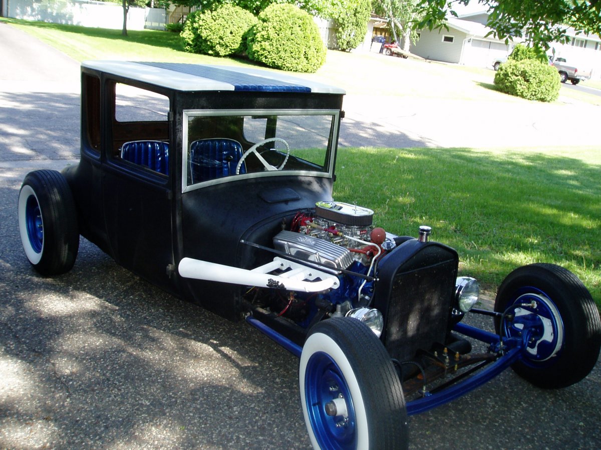

    My old T, 8” chop, 3” channel....

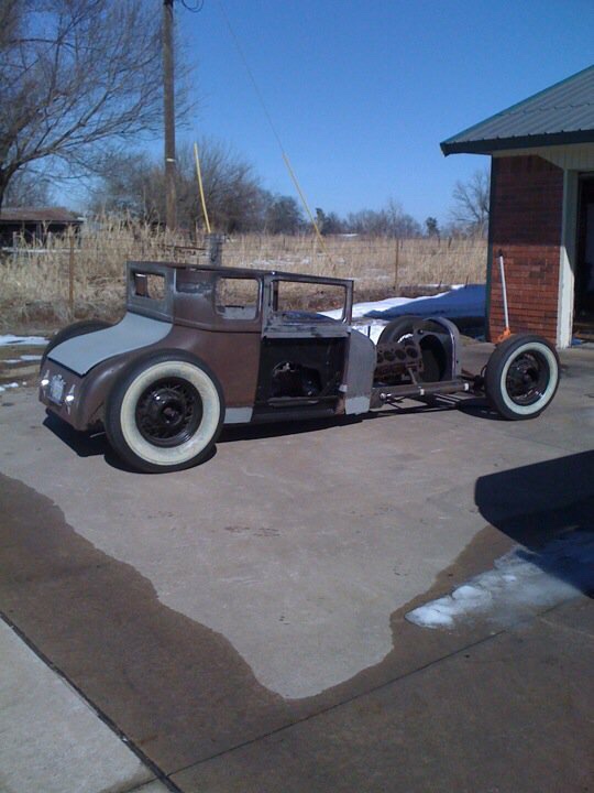

    Otherwise here are a couple of leads, non of which are mine.. 101_6114.jpg image001.jpg ImageUploadedByTJJ1357971384_245822.jpg Tall%20T%20basic%20frame.jpg TmercurtyCharliecopy.jpg ZEE%20FRAME%20FLYER.jpg .

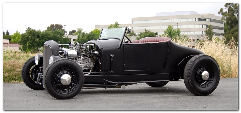

    Here is a picture of a friend's coupe; just have to imagine the chop, tho.
    Another option would be to build it as a highboy on deuce rails. Flat front crossmember, spring over dropped axle, along a "T" rear crossmember and spring in the rear. Low; but not overly so, and your quickchange would show. Could be a pretty righteous hot rod.

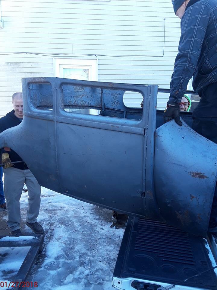

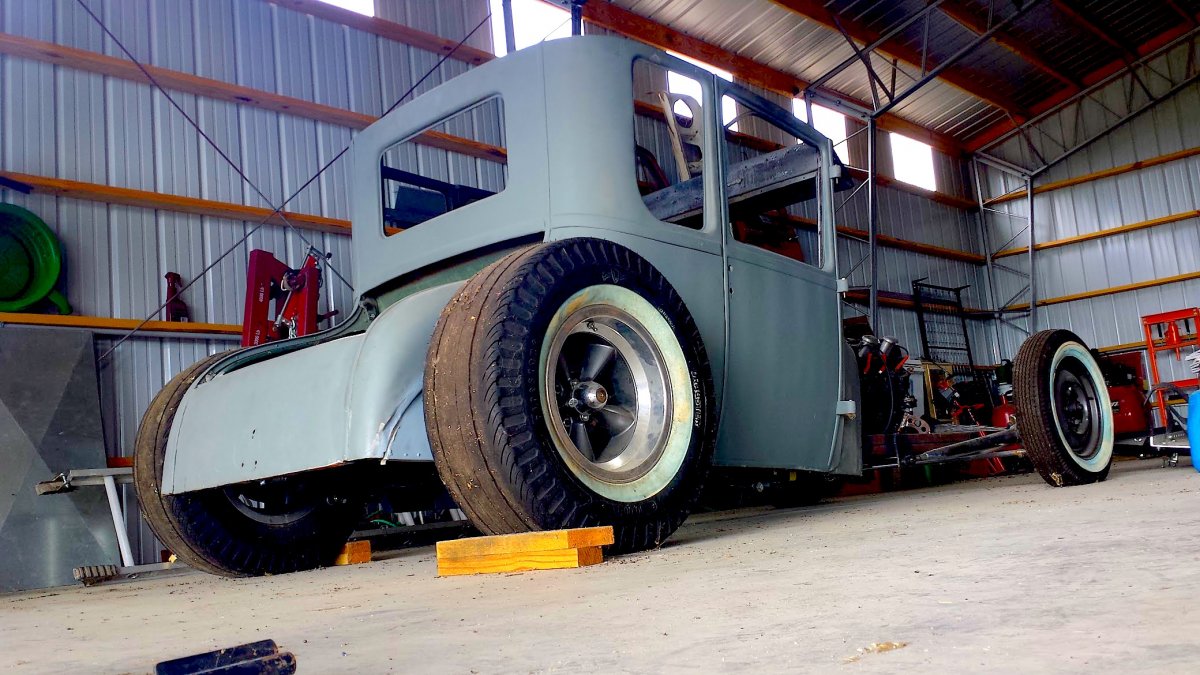

    So the project is taken a few turns and twists since I started this so here’s some updates. I now have 2 bodies 1st is not chopped , 2nd has a 10” chop(I’m using this one). In the process of hunting stuff down I changed the direction of the car a bit, now using a set of torque thrusts and a 9” keeping it as a traditional build, and switching to a 3 deuce setup. The quick change I have is from a sprint car so it would be a bit out of place with the traditional look I want finish with. May keep it in the stock height body though. Hers a pic of them [​IMG][​IMG]
