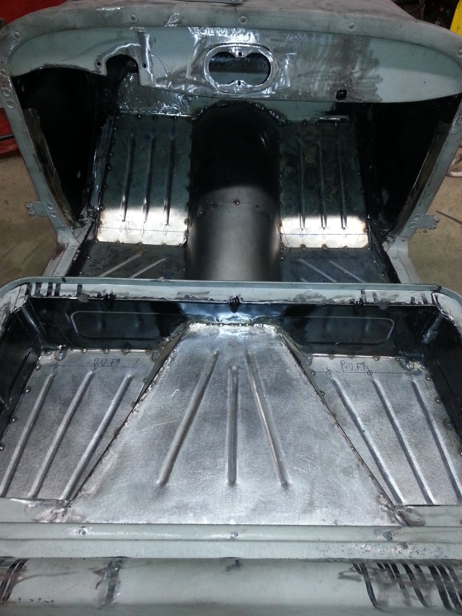

    This is a roadster, but the firewall is the same. You can see how it does not go all the way down:
    Here is the same body, with a floor installed:

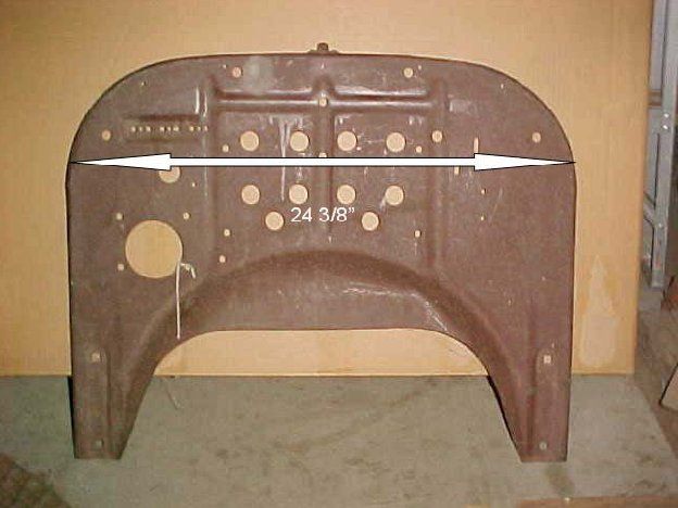

    Take a look at a 1925 T firewall, I've attached a pic and see one if you like the look and two if it will go close to fitting.
    I'm sure there are guys out there who can possibly confirm or otherwise whether the 25 firewall could work.

    I think these are why I am having problems haha. I mean that by I have been looking around and the measurement in the pic is where I measured my opening at (roughly), I think my ultimate goal is to get the firewall to look correct like Ford built it around the area where the hood and hood sides meet up.
    Do you know of a later car with this firewall installed? I would like to see a pic if possible.

    Personally, I think these 1925 firewalls look more hot rod, if there is such an expression.
    I think we will need to ask the audience regarding seeing one installed in a car, but they are out there, when I saw one a few years back, I was sold on the idea and it seems to be more friendly for the ****** etc.
    I think you may have to pay a few $'s more but I'd say it would be worth it.
