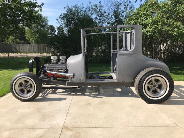

    Here's my project...

    @ALLDONE
    Thanks, It's Z'd 8" and swept 4". I wanted to channel it but I couldn't get an effective sized radiator short enough to look right with the low cowl. At 6'2 I didn't want to lose that much foot box.
