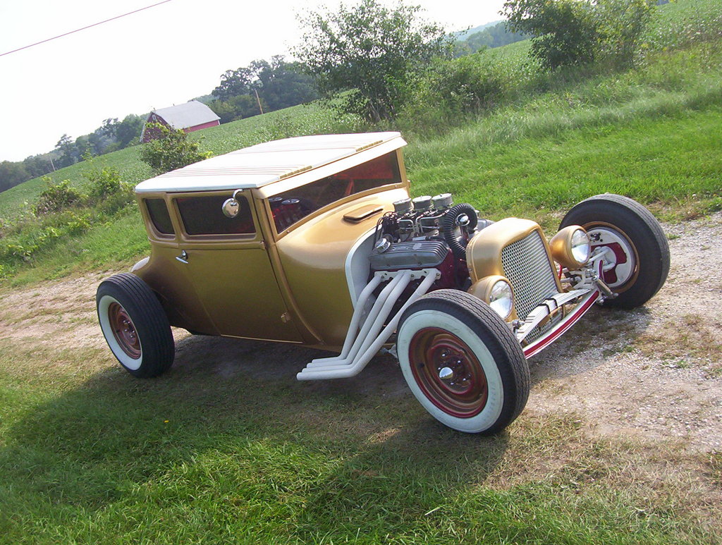

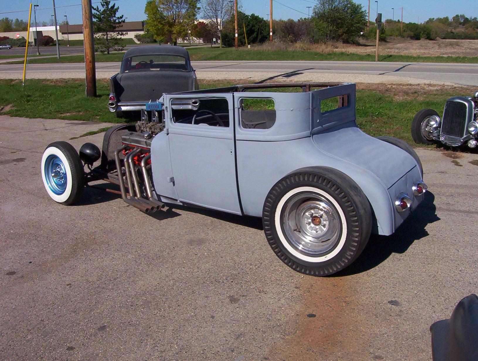

    Here are some pics that I have grabbed of it, off of here.

    Thanks guys!! I do love that car...the way I understand them, this frame isnt Z'ed...it just has a pie-cut, he spread it to make an angle, and then welded it back up. It's just a raked frame with a kick-up in the back for the rear suspension. Other than that it looks like a basic speedway T frame. I just dig it cuz it give the car a tough look, but isnt channeled, and is simple. Thanks!!
