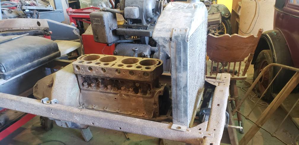

    Here is the mockup of most of the car, so its going to be rather light. 20200920_153647.jpeg

    I'm building a speedster myself using a T frame. I didn't know you could use the rear crossmember in the front (or just spin the frame). Will the front spring clear it or would you need something with more arch?

    I'm using the rear as the front and adding a perch on the top of the of the crossmember to get it where I want it... I'm also doing a quarter elliptical rear set-up on my T, so its not quite the same as what you're probably building. There are bolt on brackets you can buy, or replicate, but its up to you what you decide.
