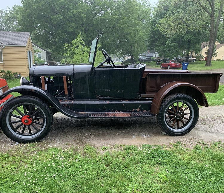

    @Austin kays has picked himself up a sweet little 26 t rpu and we quickly realized we need some go to stock T guys go go to for trouble shooting.

    It was a running driving car, then a trailer ride in the rain and an afternoon sitting out in it the coils don’t make any noise.
    He by p***ed the switch and tried to run power straight to the coils but it didn’t make any noise. He put a brand new battery in it as well. I’d think by p***ing the switch would rule out the switch being the issue but I’m new to this t stuff as well.
    My thought is a ground problem or maybe some moisture snuck under the cover and the contacts on the top of the coils need cleaned?
    The electric starter will turn it over and I’ve hand cranked it as well thinking maybe it would just bump to life but no luck

    part of regular maintenance for a t is the timer on the front. its like a distributor cap sort of, take it off, clean it, and check that the wheel inside turns nice and has no flat spots, thats if it is the original style, it may be a flapper type, same deal clean it up. then when clean and looking good, grab a two finger gob of Vaseline and scmoosh it in there. the flapper type is preferred by many, and the best new ones are the anderson timer. good coils are a must. they can be easily rebuilt by you, but should be set up on a machine to get the best spark. parts to rebuild are about 20 bucks, and several places just exchange for a rebuilt ready to go unit for 50 with your core. if you have the modern plastic coils, find some real ones. best wishes

    Run Power straight from the hot side of the battery to the connection on the bottom of the coil box- should make the coils buzz

    They buzz. If you jiggle the key when you run a jumper from batt. And I think the MAG side is jus 100% non functioning

    Cause it try’s to fire and pop but it’s just getting random ignition from the coils and not timed from the MAG

    coils will only buzz when the timer is on its contact position. so, as you crank the motor over by hand there will be dead spots with no buzz between each cylinders ignition time. as mr fargoguy says, you could power up the box, then with all plugs out and laying on the head, crank the motor and watch each plug fire and its coil buzz. the mag position will not usually make any power at cranking speed, you start on battery and then switch to mag. if you have a good mag the motor will pick up rpm and sound happier when running on a good mag. you could drag some fine sand paper thru the coil points, but i would not try any adjustment without the proper machine to do it
