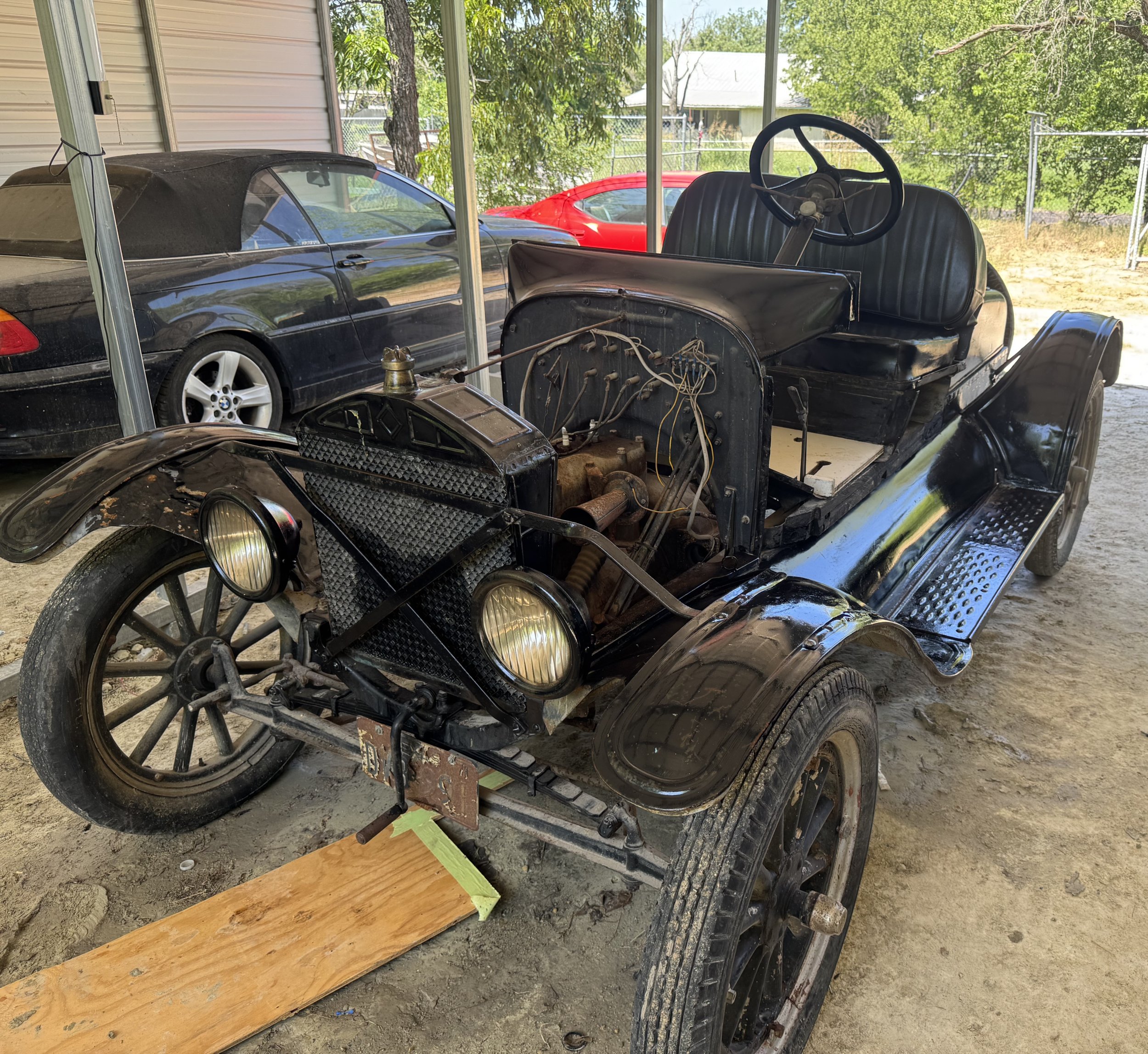

    I recently acquired a Model T, but I’m not entirely sure of its exact year. While I’m grateful to have Trevor’s expertise in sharing this project, I have numerous questions. For instance, I’m trying to figure out how to convert the distributor to make it easier to service the car. Additionally, I’m curious about any specific details or recommendations.

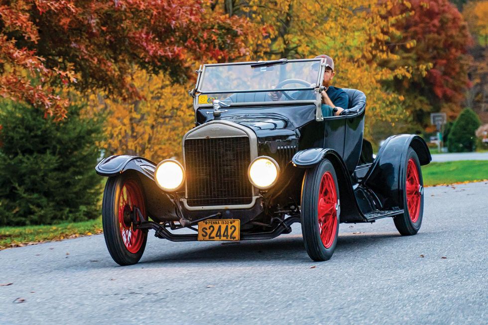

    My goal for the project is something drivable and cl***ically tasteful. IMG_7047.jpeg My main goal is something of the lines of this, IMG_7093.jpeg I am uncertain about where to commence.

    We think the car is an August of 1923 going off the engine number. In trying to get it steamed up we found all but one of the ignition coils is toast. Rather than rebuild them he is thinking about converting to a distributor for drivability, since it looks like it would cost about the same. There probably aren't a lot of T engined gow jobs running around but he would appreciate advice from anyone who has done it (is there a specific kit that is best or one to avoid?)
    The car will probably get a Z head if the bottom end seems healthy. He would like it to more or less keep up with traffic around town, so wheel brakes are gonna be necessary.
    Also, we need to lower this thing... pronto.

    Thanks. I've never known the differences within this generation, that helps a lot. We got a hood with the car but no radiator shell and no sides for the body. But what's there, including the turtle deck is in really great shape.

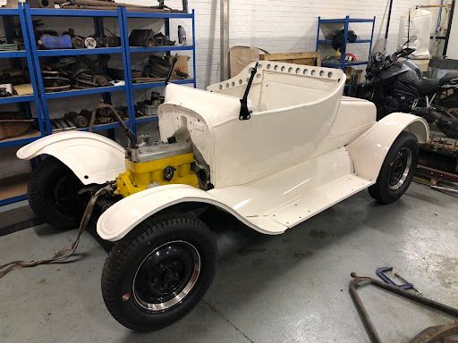

    I can't find the thread from the guy with the white model T from the UK, really neat car.
    Thought it might be a good attachment to this thread.
