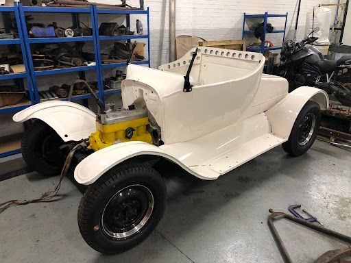

    IMG_8088.jpeg Saul - Trevorsworth and other previous responders are giving you good advice - get what you have running - learn the T’s strengths and weaknesses. Though manufactured from 4th quarter 1908 thru 1927, the Model T is still mainly 1908 technology.
    Wire wheels were an option staring in 1926; Ford also lowered the front end through revised spindles in ‘26, so ‘26/‘27 axle, hubs, spindles and wires may give you what you want - though still not designed for front wheel brakes. I have a ‘26 T RPU and a ‘31 A Sport Coupe - they don’t have a lot in common…and that’s the fun part. ☘️

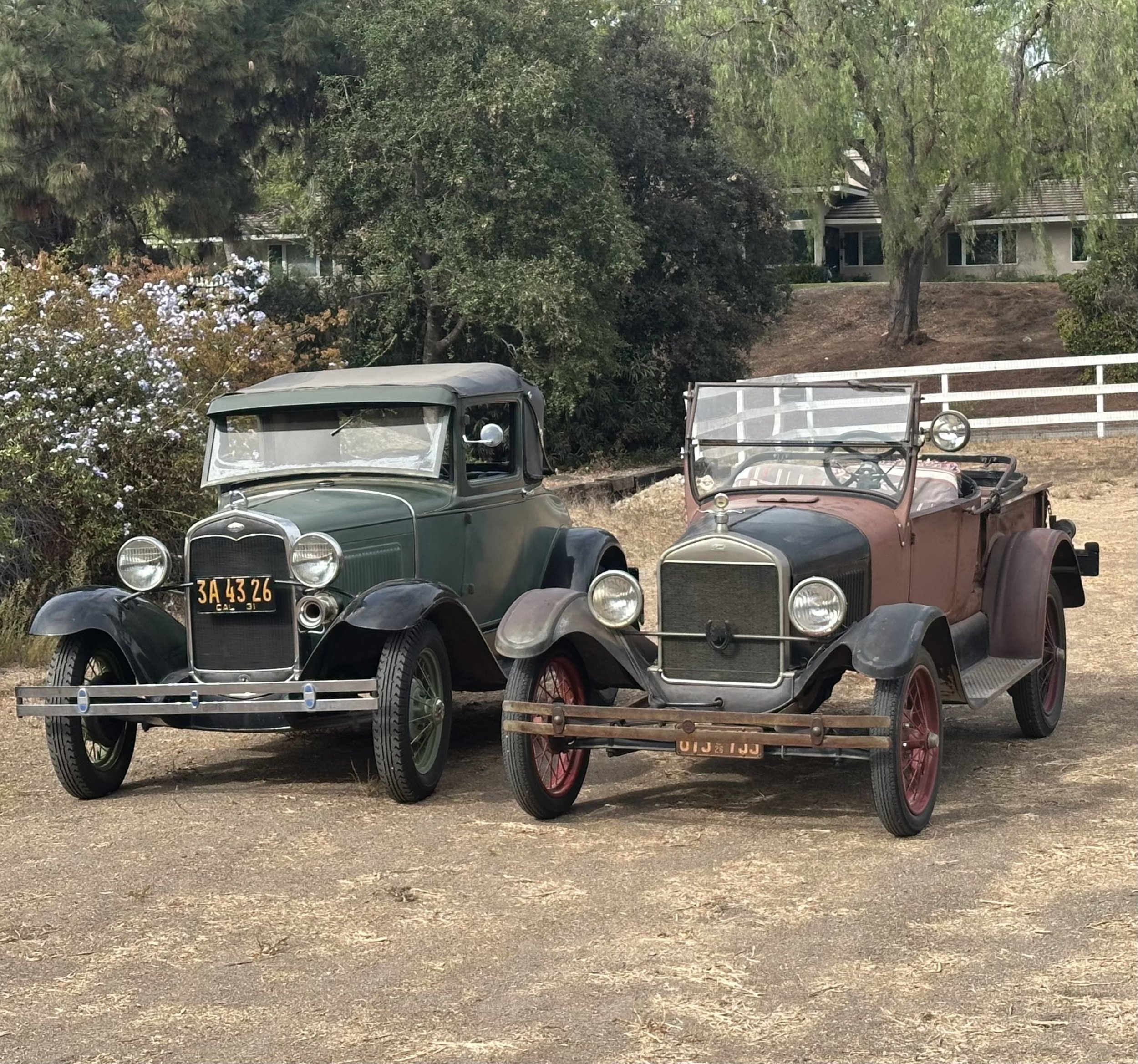

    Up until somewhat recently I drove a 25 T roadster a few days a week and planned on converting to A wire wheels. I didn't see anyone bring this up but A wheels can be used on a T spindle the A drum/hub/bearings will be used, your washers locating tab will also need to be filed some to fit in the SLIGHTLY smaller key way. The T spindle is also quite long so it needs to be shortened and drilled for a cotter key hole. Other wise you are stacking nuts/spacers and it'll look like a farmers haywagon. The rear is tricky the T wood wheel rear hub is relatively weak so it dosent lend itself to being modified for wire wheels because of the larger 5x5.5" A spacing <t wires are 5x5" not leaving much room for redrilling patterns. Langs does sell A wire wheel conversion hubs and at one time would sell them separately from the fronts this would allow you to keep the T rear end.
    My plan was always to marry the T torque tube and drive shaft to A rear end reusing the T spring. This marriage would gain you a much stronger rear axle/radius rods and most importantly brakes. "A" rear gear ratio would also be improved for spirited driving with T engine. The splice would need to be made at the front or the rear but it seemed to me a rear splice would be easier. The pinion flange of the A and T share the same bolt pattern. Unlike a V8 banjo the A used a drive shaft splined on the trans end and a tapered end that the pinion gear attaches to, the T also used the same type drive shaft but uses a square slip fit at the trans end.
    The marriage of drive shafts would be best made with a union welded connecting the two halves <this is often done when shortening V8 banjo torque tubes.>
    When I was figuring this all out for my T the upgrade to "A" brakes was a huge selling point. Driving in down town traffic was always a hair raising event for me relying on the T trans band brake with more than one close call.
    The A rear brakes could still be actuated by rod much like T accessory "rocky mountain brakes" would. This would require use of a equalizer bar and tab welded to stock brake pedal like the rocky mountain brakes. To take it a step further 32-34 brakes seem to be a improvement to model A mechanical brakes and could be used but the A brakes properly adjusted would have no trouble locking up the rear wheels. As for front brakes I don't think the incredible effort would be worth the added stopping power
    With all this being said I never made this conversion before selling the T . I did lots of reading on speedster builders groups and I did have the majority of the parts in my hands it seemed like the conversion would have been relatively straight forward with minimal machine work and a basic understanding of fabrication and welding. But none of this stuff is ever easy you really have to want it. *ramble over*
