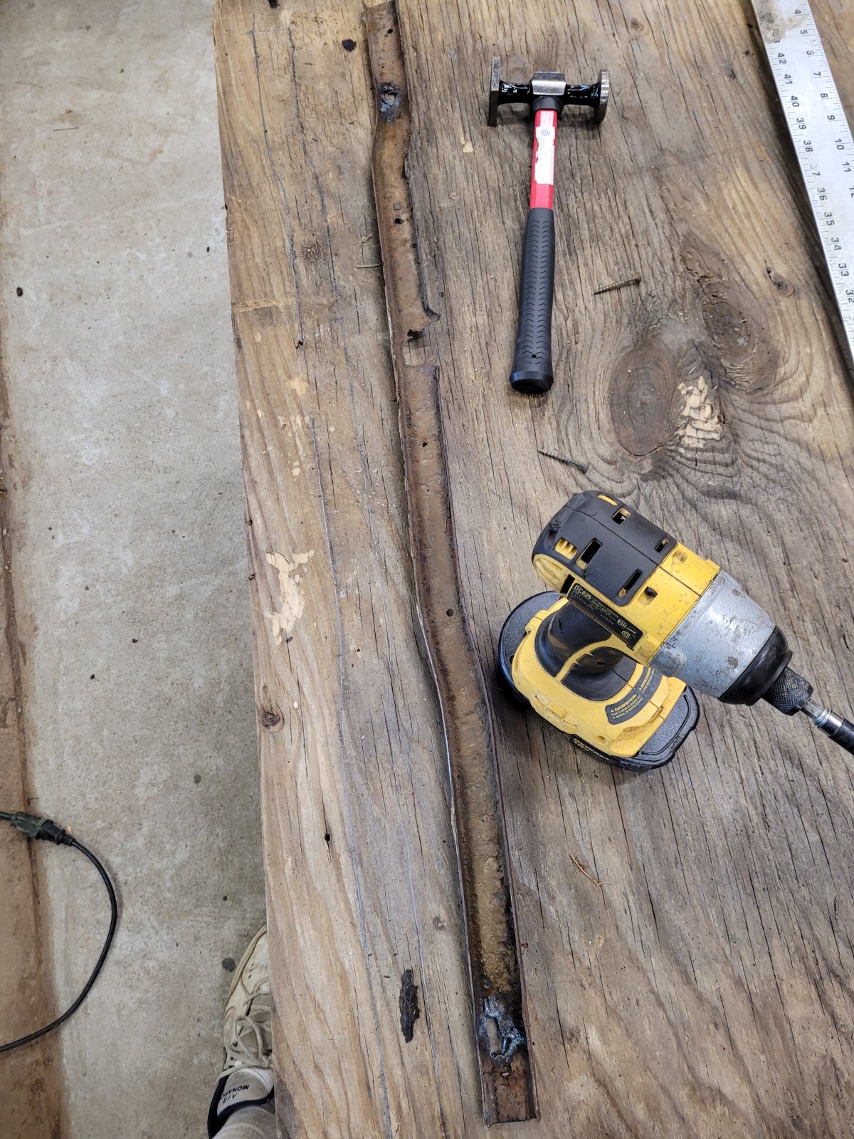

    Made it over to my friend's house today and was able to get some hammer forms cut out on his bandsaw and router table. This should help make reproducing the channel that the turtledeck side panels sits in, and is welded to, a piece of cake. I have always wanted to try the hammer form thing. I made 2 sets just in case the plywood doesn't hold up. 20220517_132549.jpg
    We cut 4 strips of plywood to the proper width and length. We used a piece of hardboard as the template. We traced the shape of the piece onto the hardboard, then cut that out on the band saw. Then we used a spindle sander to fine tune the template. Next we used two sided tape to stick the hardboard template to one of the strips of plywood, and then rough cut the plywood to the shape of the pattern on the band saw, to within 1/8". Then we stuck the hardboard template to the first strip of plywood, then ran that through the router table. From there, we used the first plywood hammer form as the template, and cut out the remaining three. Thanks to my friend Ben for the use of his woodworking knowledge and wood shop.
    I thought I would wait for Trevor to come over this weekend so we can both make one of these that we need. Trying out the hammer forming technique will be great learning experience for both of us!

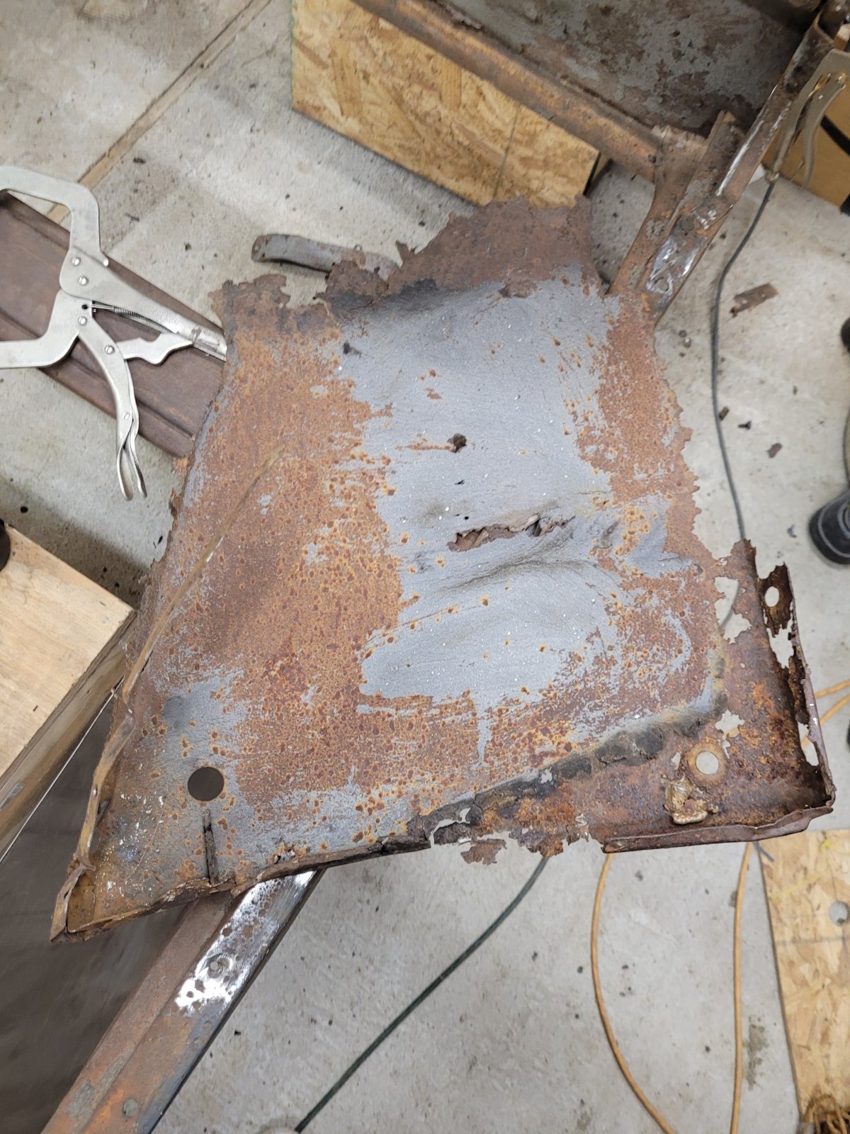

    Today we got the turtle deck broken down to its constituent pieces.
    The driver side quarter is nice, and all the complex internal structural elements are intact. We will have to recreate the bottom channels as mentioned above (didn't get to it today) but everything else is very solid.
    Driver side is pretty nice... OK, see that lip? That fits inside a structural rib/rain gutter. When we removed the rivets holding the passenger side quarter at the bottom, the whole quarter just fell off. That lip is completely rotted off on that quarter...
    At first we were thinking this whole panel was a write-off. It needs attention on all the edges and the inner fender is junk. But after probing it a bit we realized the compound curves are all intact and most of what needs to be replaced is just flat, smooth sheet metal. So we cut the rot back about 1/2" to good thick metal...

    Did a little work tonight. This was my first attempt ever at hammer forming. It needs a little tune up along the edges but this will never be seen once the quarters are revived and made to fit. I cut these long until we can get a final measurement. 20220523_221354.jpg 20220523_221428.jpg

    Did a little more tonight. Got the roached passenger bucket side off. Trevor is going to wake up in the morning and shit himself when he sees I am tearing his car apart! 20220524_002439.jpg 20220524_002508.jpg 20220524_002500.jpg

    Building the new bucket side is going to be challenging but I think we can come up with a reasonable facsimile. I'm thinking about flattening what is left of it and then tracing it out on either cardboard or maybe even poster board. My hopes are that we can bend the flanges and angles on the poster board and tweak the poster board as needed until we have the right fitment, and then transfer the pattern to metal and recreate the shape(s). Does that sound reasonable? I have a 3' break, an English wheel, shrinkers and stretchers, and a bead roller with several dies including a tipping die.

    This body was pretty much made with the tools you mentioned. No reason not to make that panel. Watching this thread to see the great outcome. Keep at it!
