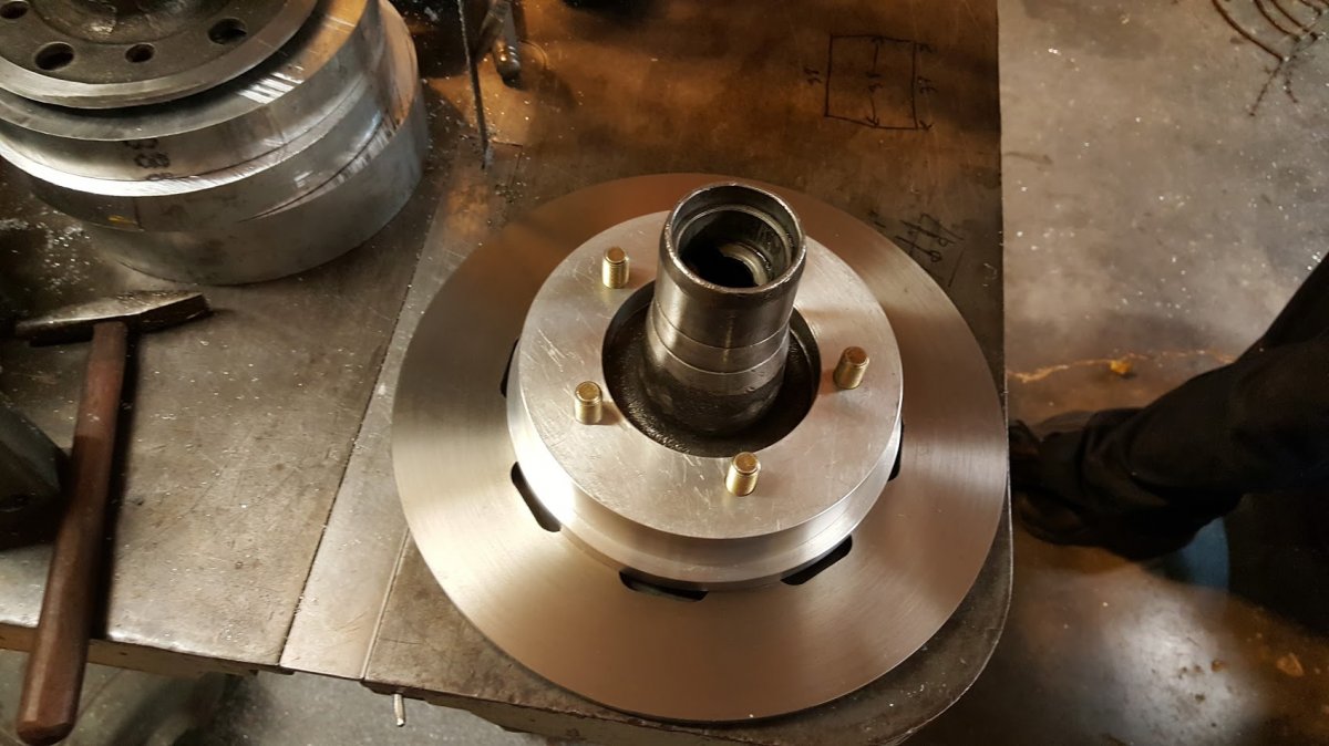

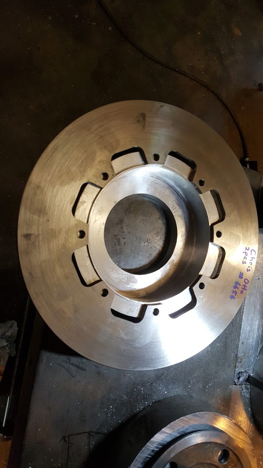

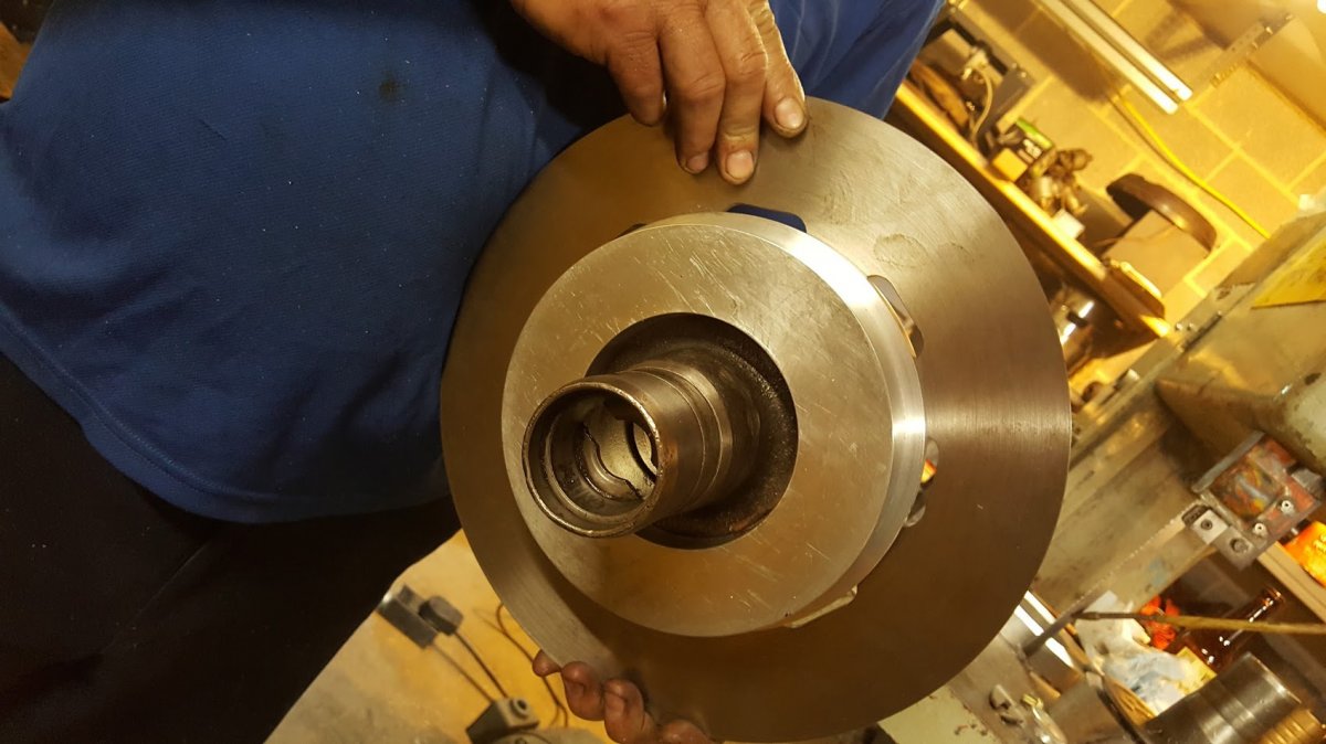

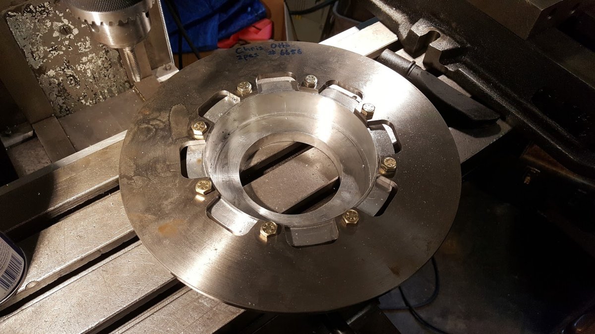

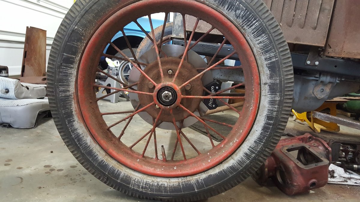

  3. 20170702_171530.jpg 20170702_161803.jpg 20170702_165112.jpg 20170703_170951.jpg 20170703_171001.jpg 20170708_184546.jpg 20170703_175638.jpg Well, this may be where I loose a few of you. With the Warford having a proper neutral and whether it's rolling in the driveway or running down the street.I need a way to make sure I can properly stop. Disc brakes seem like a simple solution. Please don't fear, this will be the only non-traditional T part on it. Let's get to it.........
  4. In the previous post you can see that I trued up the hub. Cut some aluminum round stock. Lipped it for the rotor to ride/seat and finally tapped the aluminum for the bolts to hold the rotor. In the next set of pictures you can see that the aluminum round stocks ID was increased to match that of the hub. Tapped the aluminum again for the lug studs. The studs come in through the inside holding the hub to the aluminum.

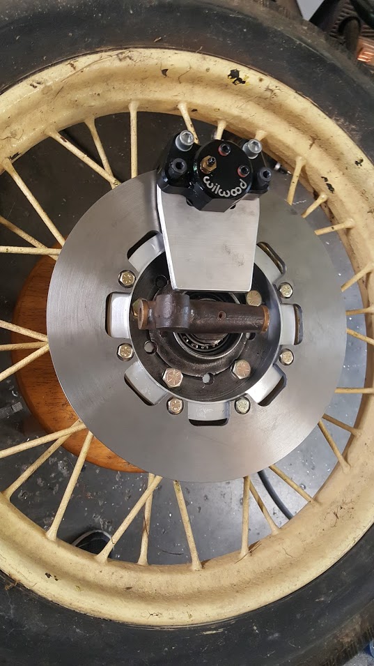

  8. With the hubs finished, time to make caliper mounts.
    20170717_194104.jpg 20170722_103340.jpg 20170722_103402.jpg 20170722_163240.jpg 20170722_163244.jpg 20170722_163812.jpg 20170722_163820_001.jpg 20170722_171814.jpg 20170722_182218.jpg
    S1B, Stogy and indestructableforce like this.
  9. In the previous post you can see that the caliper had to be clearanced a bit and each bracket is side specific (in the pictures you can see two dimples in the aluminum caliper bracket). Pressed in some new bushings, hone to fit, and time for a mock up. While at it, lets throw in a dead perch. 20170723_103153.jpg 20170723_103202.jpg 20170723_151536.jpg 20170723_151550.jpg 20170730_163601.jpg

  14. With those cool disc brakes I strongly advise beefing up the front wishbone. I know a couple of T guys that wished they did!
    Chili Phil and GuyW like this.

    I have zero experience with this combination but I am more concerned about those wheel spokes living with the grip from the disc brakes.

  18. No need to be sorry. I haven't performed all of this on my own. I have great friends helping!
    Stogy likes this.
  19. My disc brakes are a copy of my friends on his 26 T. He has many many miles on this set up. A book just came out about his T. 51WXUzTO3UL__SX258_BO1,204,203,200_.jpg

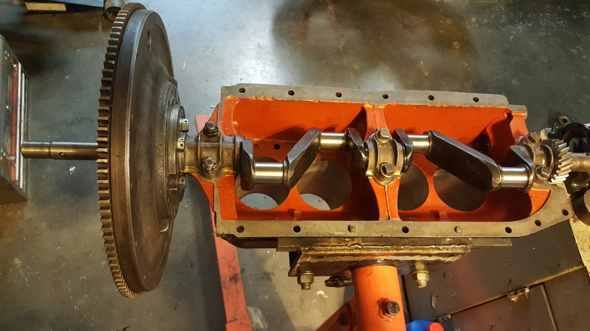

  28. Time for a little procedure called "aligning the transmission". True the end of the crank and transmission input shaft. Put a center dowel in. Stuck the together and checked for proper alignment.
  29. Crank then laid into the block, flywheel added and check many, many, many times for proper alignment.
