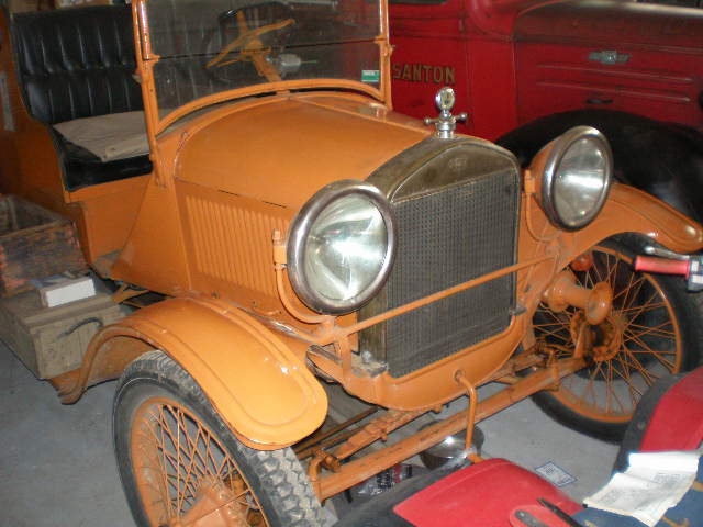

    Here's my '26 speedster. I picked it up cheap with a stuck engine. That was an easy fix. Waukesha Ricardo head, aluminum pistons, distributor, 30" wire wheels from Overland, I have no idea what the cowl is. Big wood box body for hauling stuff in while touring around. It ran the perimeter of Missouri in '91. For making kids smile it has a firetruck siren. :D
    I have a 16 valve Laurel Roof head that may go on it one day. Lots of open rockers wiggling every which way would be fun to see! The engine needs major work to withstand the head, although if babied (yeah, right) it would probably last a while.

    Hope you have an idea how rare those headlights are. They are '15 electrics. Henry, true to form, wanted to use up all the yoke type mounts from the br*** lights, so the first few electric lights had the cast brackets to fit on the yokes. When the supply of yokes was used up, the normal stanchion mounts appeared. I looked for a couple of years to find a pair of those for my '15 speedster. Never did.

    Dean. I agree with everything you said about the early '15 T electric lights.....................but I think the lights on that speedster are Dodge items, just too big for T lights. :)

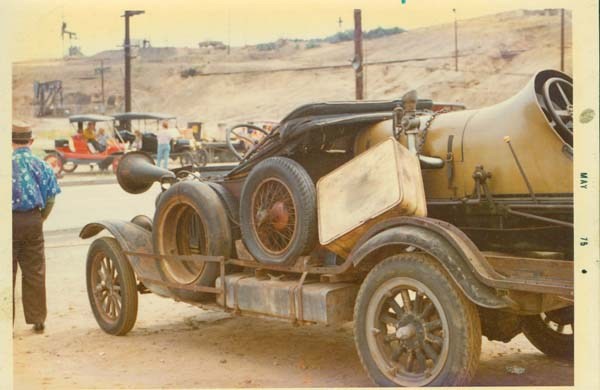

    The photo you have posted is of one of the most legendary Model T racecars in existance. This original racecar is powered by an overhead camshaft Frontenac cylinder head. It was discovered and owned for many, many years by Chris Eggsard of California. He mounted in on this 1920s era Model TT truck and drove this to many So Cal events during the 1970s and 1980s. Chris was one of the first people I met in the old car hobby as a kid and was one of the true legendary collectors of all time. He was known by his friends as Billy Poobah and raced another Fronty powered speedster for many years at the Shell Hillclimb in Long Beach, California where he earned the prestigious King of the Hill trophy at least once.He p***ed away about five years ago and his collection was sold. I believe this car has Dayton wire wheels.

    Thanks for teh info,,would love to see more detail pix of the car but could'nt seem to find any

    I think you are right. I didn't click the pic to see the larger version. The mounts are on a rod type light bar that is non Ford. . The yokes are like a T, but yeah, they are bigger than Ford lights. :confused:

    '37 Kid, I have to disagree. DB didn't have mounting like that, always had a center mount underneath the headlight. The headlight rim is not DB either.

    Gas4blood any better pictures of your Speedster? On Gas4blood speedster the headlight bar is a 27 T modified for the overland lights, The headlights are 1914-1917 Overland. the grill shell and hood is 26-27 T. the front axle is 25 or olderT 26-27 spring. the front fenders are 23-25, the upper and lower windshield is 26-27 T open car, front apron is 26-27, horn is A model

    Good eye Speedsterinc, I thought Johnnie Cash only built Cadillacs? It's a '15, '16, '20, '23, '24, '26, '27 Model T. I like it!

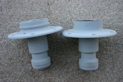

    So by looking at that , A stock Model T hub could be used to mount the wheels if you installed proper guide pins to fit the wheel ?

    Are talking about stock wood spoke hubs or the 26-27 wire wheel hubs? What would you hold the wheels to the hub with? The threads for the hub cap wouldn't be strong enough on a wood spoke hub.

    Could'nt you thread the end of the stock hubs?

    From what I understand the car hasnt been off of the truck in many many years.
  26. CoalTownKid
    Joined: Mar 12, 2005
    Posts: 2,024
    CoalTownKid
    That's a real shame!!!
    I'd be magnetically drawn to it if it was in my garage!!
    I'd do everything in my power to get it running, restored and roaring down the dirt!!!

    Heres what you got for the front hubs and the rears are different with having the drums attached. There not enough meat to them. The strenght for the T hub comes from having the wood spokes sandwiched between the back flange on the hub and a front flange.
    The stock ford T hubs can be redrilled for use with a Chevy disc wheel. Utilizing the front and back flanged with the disc sandwiched between.

    To put it in a nut shell. You would be better off machining a new hub that fits the wire wheel properly and safe, or get the correct hubs for the paticular wheel.
