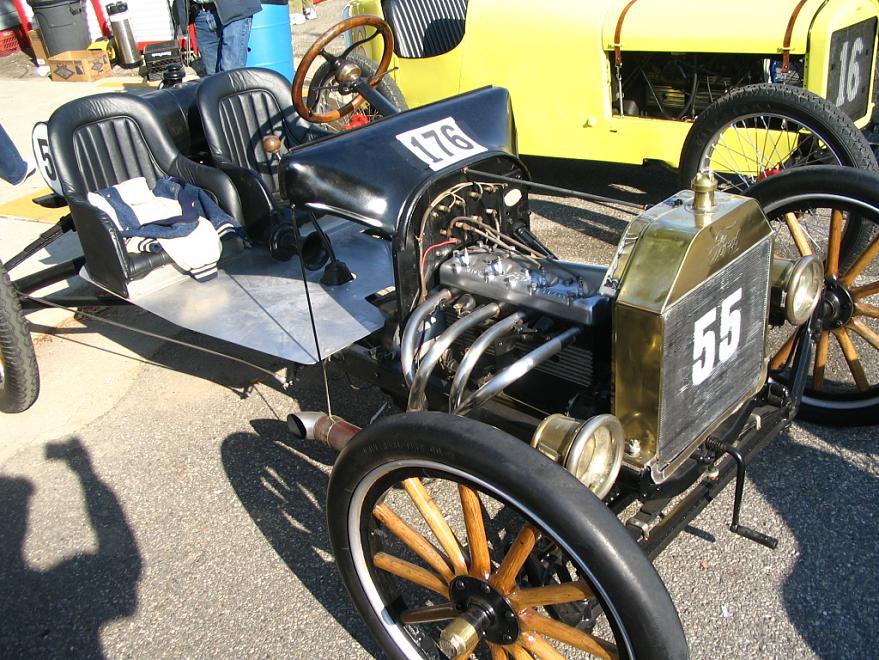

    I took these at the Newport, IN hillclimb back in October! What a beautiful day it was, perfect in every way!

    390 Merc, that little blue ditty number 55 is ***s. Thanks for posting.

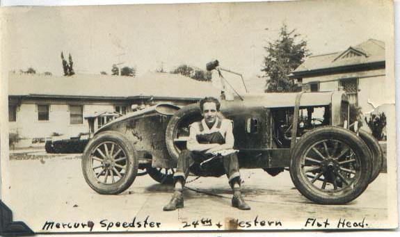

    I know - it's not a "T" but a Mercury Speedster - - My dads down in L.A. Cal in the late 30's early 40's

    Mercury Speedsters are after market bodies on "T's"

  23. Lightning- Like fur biscuit said, that's a T alright... but how'd you get Christopher Lloyd to pose for the pic?

    Ah - ya found out - ha ha - I was just going by what my dad had written on the photo.

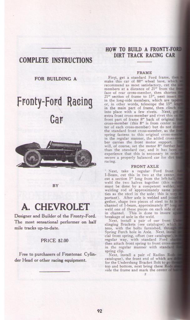

    Found some info Mr. Dake
