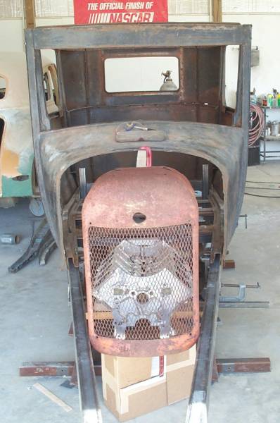

  6. 26/27 Model T coupes and sedans have the same cowel, "A" pillar, windshield, and windshield surround. Picture shows my body head on.

    How far are you choppin' it? What are you doin' for top material?Resto rod or hot rod style?
    By the way your crank hole is to high. I wonder if the tractor guys get pissed when seein'their parts on hot rods.
    I'd have to look at thinnin' that panel all the way out and usin' a real thin (2 1/2' or so) visor. The front roof edge may look funky with out something there. Have fun,Smokey

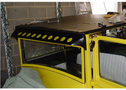

    I used a peice of 3/4" tubing for my header and made a visor. I made it small. Just enough to cover the hinge on the windshield and add some flair to it. Sorry I don't have any good pics of the car now that it's done.

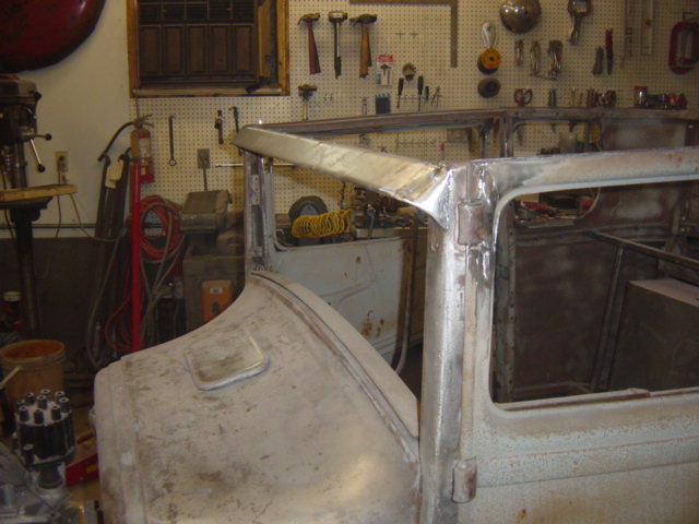

    Would have attatched this to my first reply but it was still on my camera. I just put this on my coupe last week. Im not sure what the visor is from, got it off of e-bay. It was 2.5 inches too short so I lengthened it. I like it better than the original, its alittle sportier looking.
