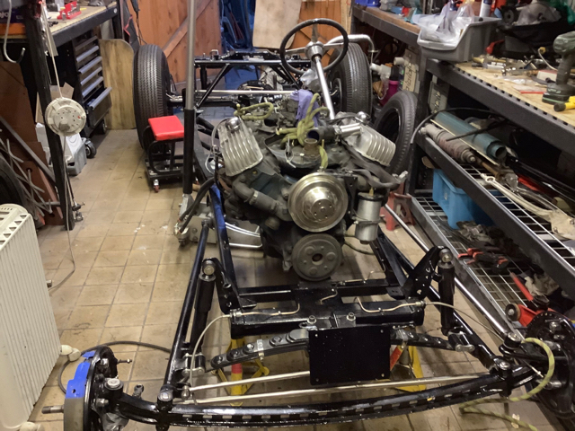

  4. My Modified has a TT frame and I have a 347 Pontiac in it.
    Frame is boxed, pinched and zeed with tubular cross members.

    Blackjack that is outrageous motor for the frame, but cool.
