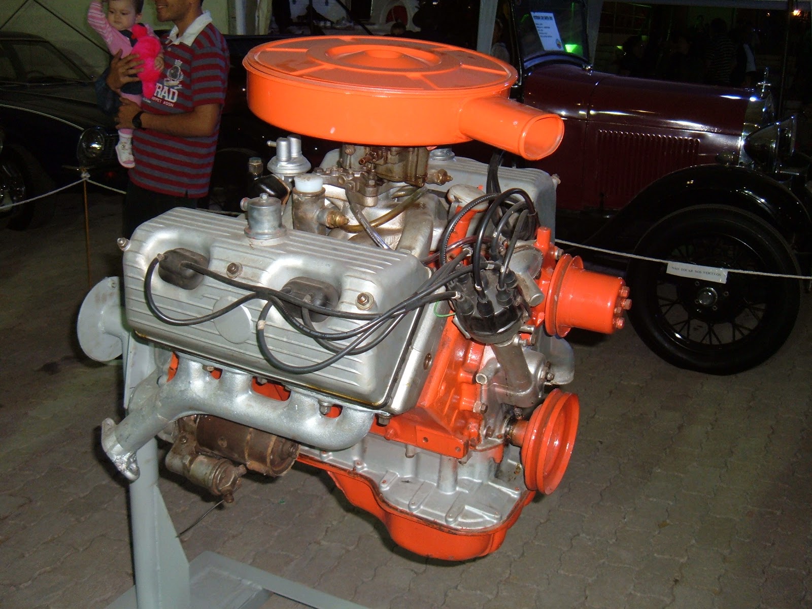

    Daimler 2 1/2 litre hemi is 23 5/8" long overall from tip of water pump snout to back of block. It is 5/8" longer than the Willys L134 engine that Flat Ernie mentions.
    If you could find one the killer engine for this would be the V8-60 derived EmiSul which was in Brazilian Simcas from 1964-1968. Even if you could find one it is almost impossible to get them out of Brazil....

    Here's another shot of an EmiSul V8-60 hemi....

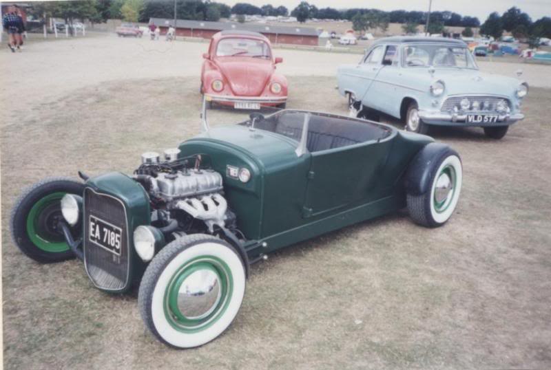

  25. Have a good look at Kuztoms car (post 16) as the chop on his is perfect.
    And please don't ditch the fenders as they look **** without them.
    I like the Alpha running gear. Looks cool.

    oooohhh, now thats the exact look i wanna go for on mine, except its gonna be in the original paint. that chop is just right too.
