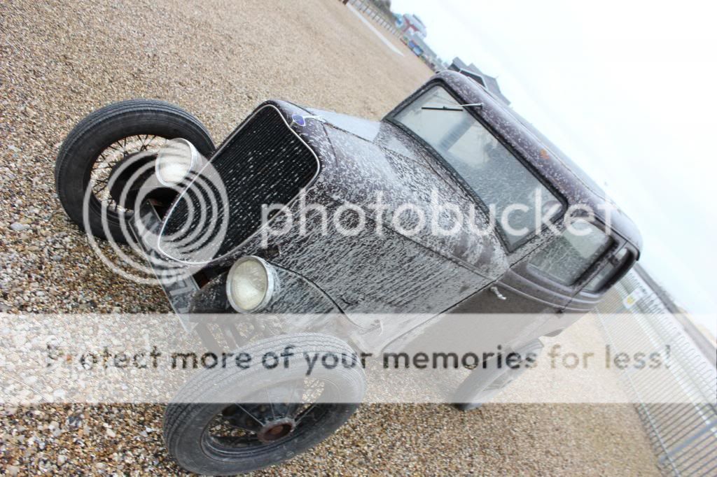

    got home from work tonight and quickly fabricated these little headlamp brackets.
    pretty happy with the placement of the lamps!
    just gotta remove the rear valance thingy and make up some rear lights and she's good to go again.... couldnt really do alot else tonight as i suddenly had to weld the fart canon up on my mates Honda Civic haha

    Nice job on the headlamp mountings.
    Looks great already with just the fenders off
