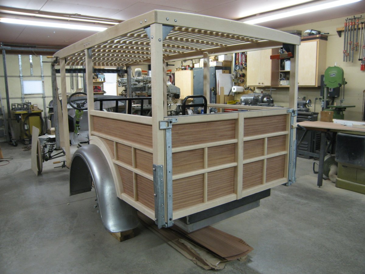

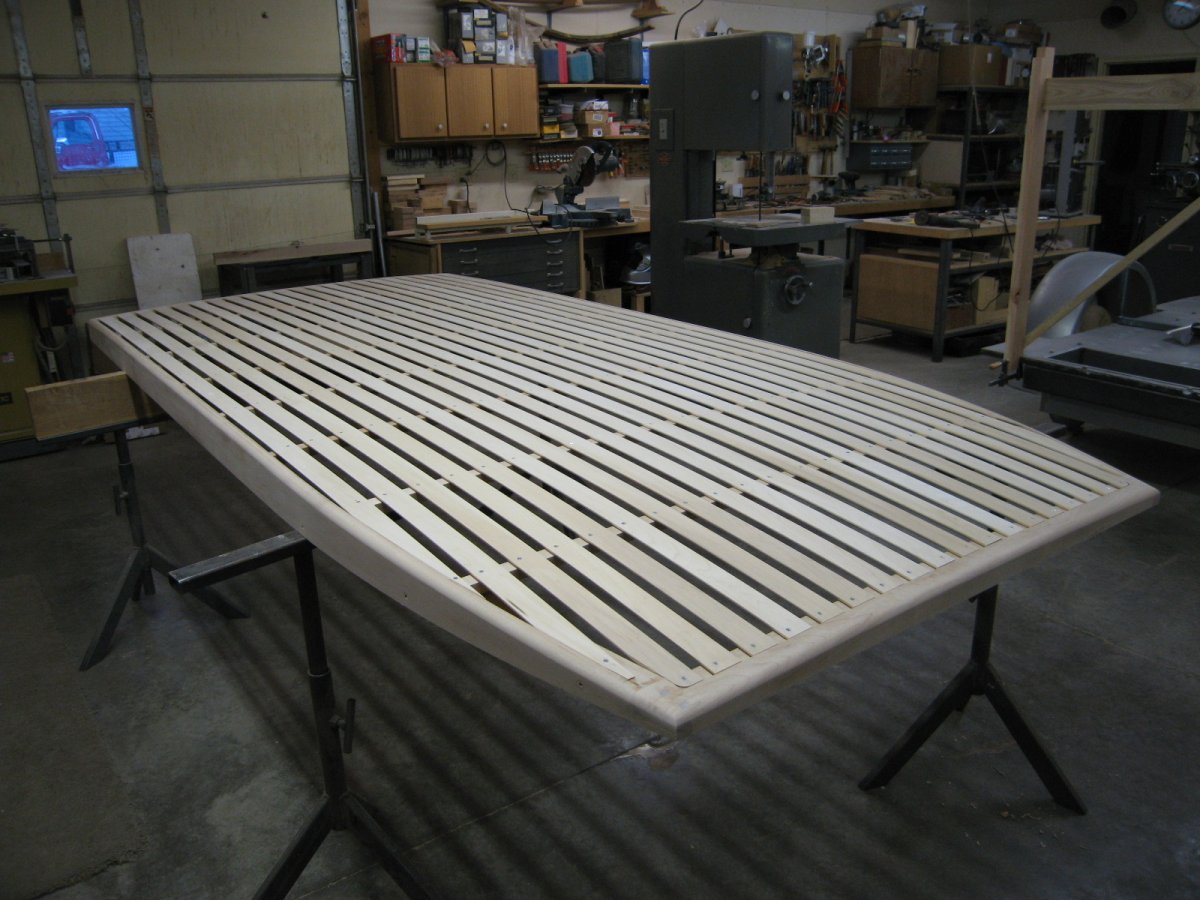

    Pretty straight-forward, not nearly the project that the post war roofs are. IMG_2639.JPG
    Going to need something to hold it up though. Quarter panels next. IMG_2640.JPG IMG_2651.JPG
    The idea was to keep the original look, at least for the most part. Didn't have any original hardware but was able to find some reproduction parts. Not everything was available so I had to make a few parts. In some cases, door latches for example, we decided that new was better so used bearclaw latches. Overall though, and especially from a few steps back, it will be hard to mistake it for anything other than a model A.

    Very nice work, what did you use to cut those finger joints? Have you joined the National Woodie Club yet?

    Thanks. I had a set of finger joint cutters made for my shaper. NWC member for about 10 years.

    Skipping ahead just a little bit, have the insert panels and trim made. IMG_2707.JPG
    And these. Obviously not an original floor, and we have stretched and widened the body slightly so original wheel wells wouldn't have worked anyway. IMG_2718.JPG
    Back end pretty much wrapped up, I'll get to the doors in the next installment.
