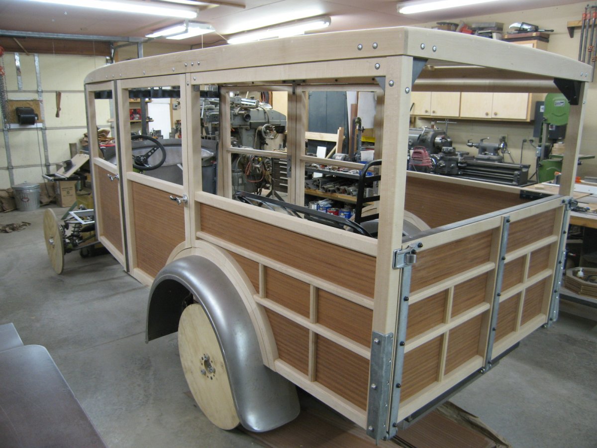

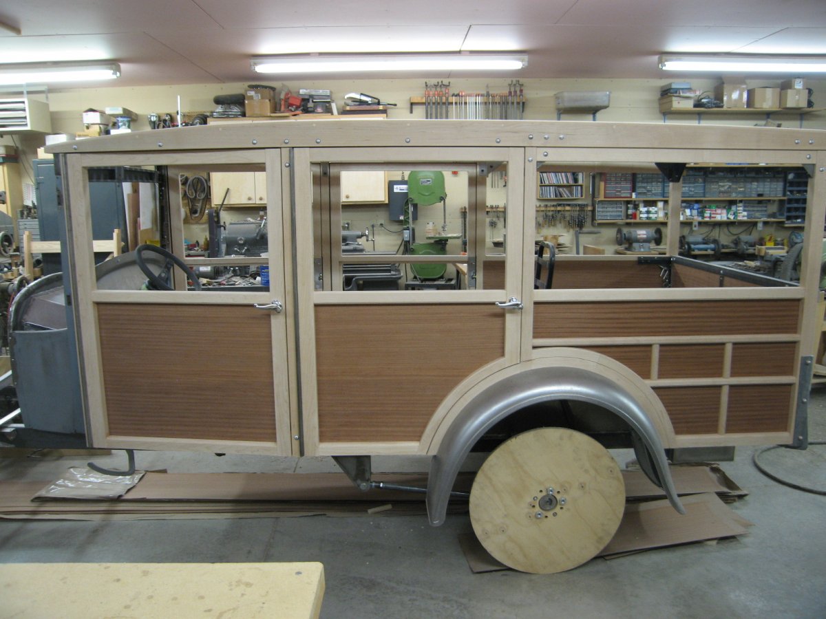

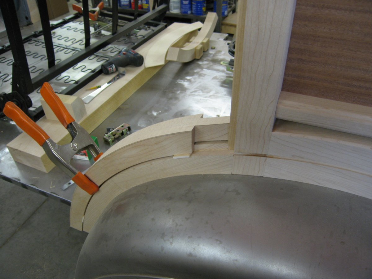

    I dropped the ball. I normally try to keep a complete photographic record, but. About halfway through building the doors the owner stopped in and took pictures while he was here. Since he already had some, I didn't take any. I have a few, but not much. The car is apart at the moment, the ch***is is back at the builders being finished and I am sanding the wood parts so they can be sprayed. Plan is to re***emble it probably early June, will have more pictures then.
    This is it for now. IMG_2728.JPG IMG_2733.JPG IMG_2734.JPG IMG_2735.JPG IMG_2736.JPG IMG_2705.JPG
