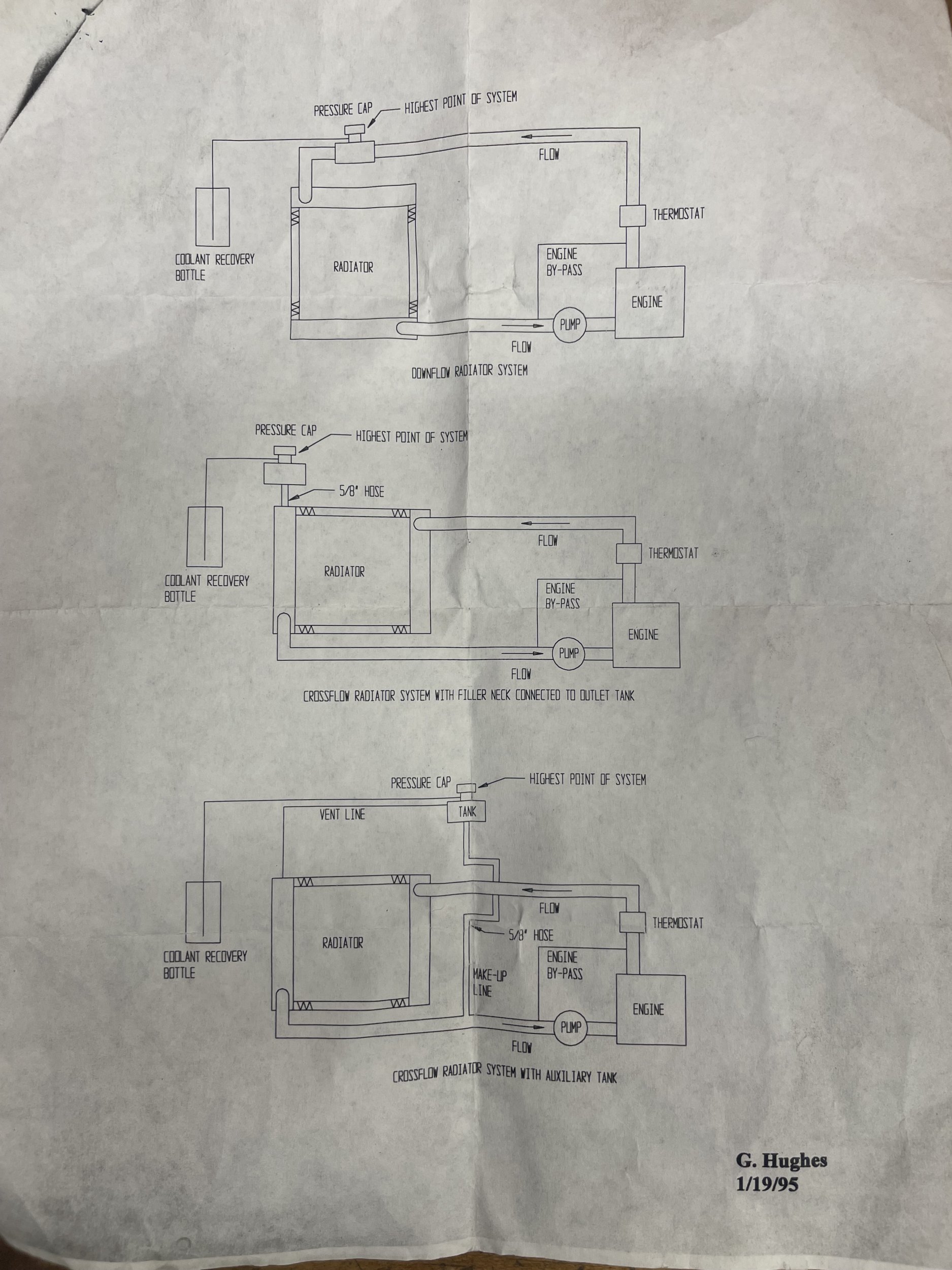

    IMG_2053.jpeg My uncle worked at modine forever he was an engineer. Lost him in 2013. He made this drawing. Hope it helps.

    That is exactly what I needed.
    Many thanks to you and your dad. He obviously knew his stuff and enjoyed sharing that knowledge. My dad was an engineer and also loved to share the stuff he thought was cool.

  5. Those drawings are correct as far as they go, but that's not quite what you'll have. Note that in each case, it's an always-upward path to the expansion tank. If at any point that path goes down then back up, you'll have an air trap. Unless you're planning on running that line through the car at the lower of the two connections on each end. I went through this on a LT4 swap into a Jag....
    Crude drawing, but you can see the issue. If you run the front-to-rear piping low, you'll have traps at both higher ends. The expansion tank will cover one, but you'll still need a way to bleed the air out at the other end. Wherever you mount the expansion tank, it'll need to be the highest point and I suspect the front will be best. I'd also drill a 1/8" hole in the thermostat to allow easier initial filling; that won't affect cooling. Do run a coolant recovery tank. I'd run the expansion tank inline with the upper radiator hose, that will make it easier to fill/purge the system.
    Hope this helps...
