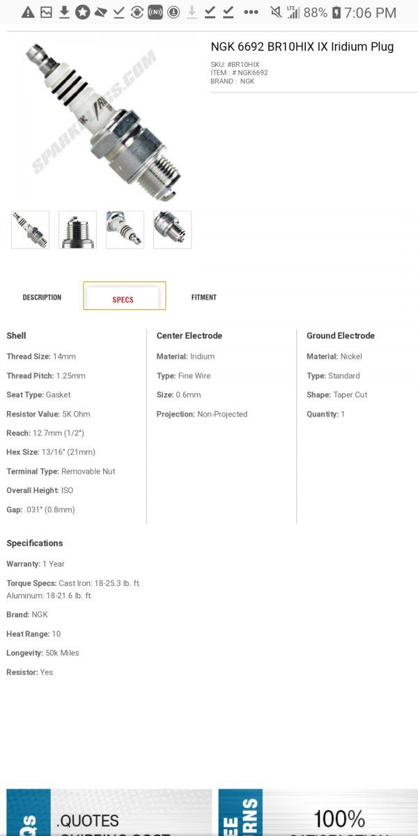

  22. studebakerjoe
    Joined: Jul 7, 2015
    Posts: 1,176
    studebakerjoe
    Nyall, as far as I know there are only 2 choices of reach in iridium plugs right now both about 25-26 mm or so. The h10c is 11mm reach. If you've got your heart set on iridium plugs the only thing I could see doing would be to have some spacers machined up.

  24. studebakerjoe
    Joined: Jul 7, 2015
    Posts: 1,176
    studebakerjoe
    Screenshot_20200216-190604.png This might do it.

  29. tubman
    Joined: May 16, 2007
    Posts: 8,141
    tubman
    "Nyall" - I guess I should apologize for my previous post, but it was primarily done in humor. It seems that you have done your homework but have come up against the weakest link in the ignition system. I had a similar problem with a flathead I built for my '36 about 25 years ago. On that engine, I installed an MSD "Ready to Run" distributor with the matching control box and coil. My problem wasn't with spark plugs, but with the cap. The spark was so hot that it would eat through the coil tower on the distributor cap in a couple of weeks. The first time it happened, I bought a new cap from MSD ($$$) and cleaned everything up and made sure the wires were well separated. After a few more weeks, I had the same problem. Luckily, I found out that standard GM caps fit the distributor so I didn't go broke. Ever since then, I have used Mallory "flattops" on my builds. I figure I'd rather look cool than get the last 2% from the ignition system.
    The 1/2" reach Iridium plugs mentioned above were not available when I looked, which admittedly was several years ago. They should work with a proper spacer (or maybe a couple of extra washers).
