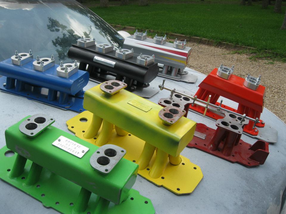

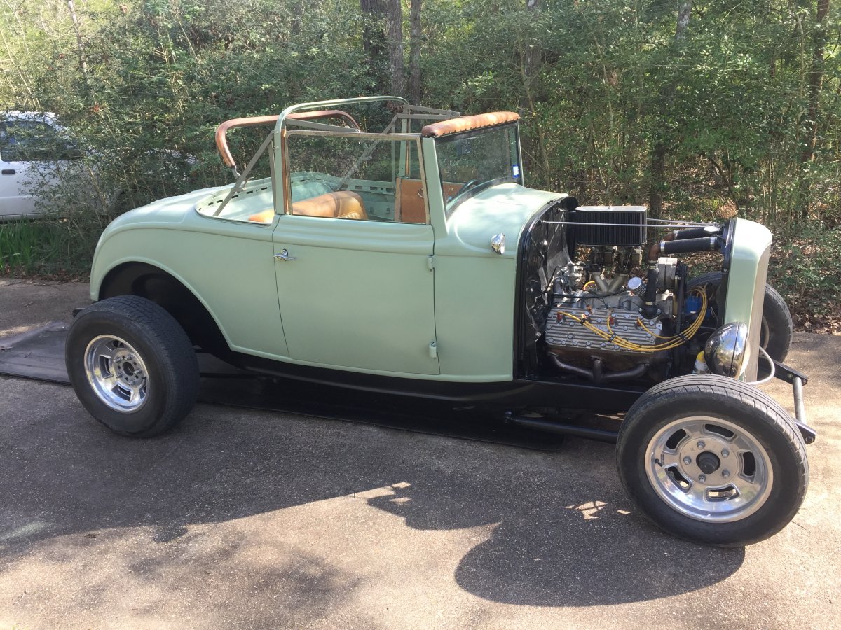

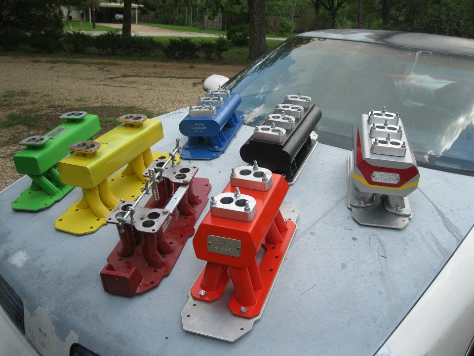

    056CC377-B4D7-498E-A485-3935F07DECD8.jpeg 15A34556-20C1-4774-A28A-A428BCFCA8AD.jpeg A1EB02F7-3E07-489C-BCC2-37C18A99B3EC.jpeg Tubman, the spark plugs are closed via the exhaust valve,NOT the pistons on a flathead as you so stated.By the way, pay attention here: My “stupid flathead intakes” are running on a t bucket in Oklahoma and my 32 cabriolet is NOW painted. What else you want to comment on you Minnesota JERK!

    ^ Thanks! That was fun trying to figure out that rant and the colored intake pictures. Delayed retaliation from a 13 day old attack. I’ll check back in two weeks to see where this is going.:)

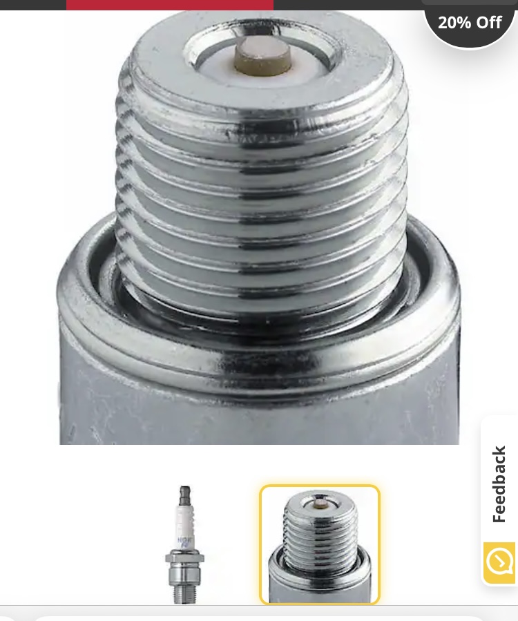

    I was looking for a good replacement plug for my used Mercury 2 stroke outboard and was wonder how these NGk (surface gap) plugs would behave in a flathead with an electronic ignition?
    @tubman, are you still running these?
    Just curious has anyone else tried these?
